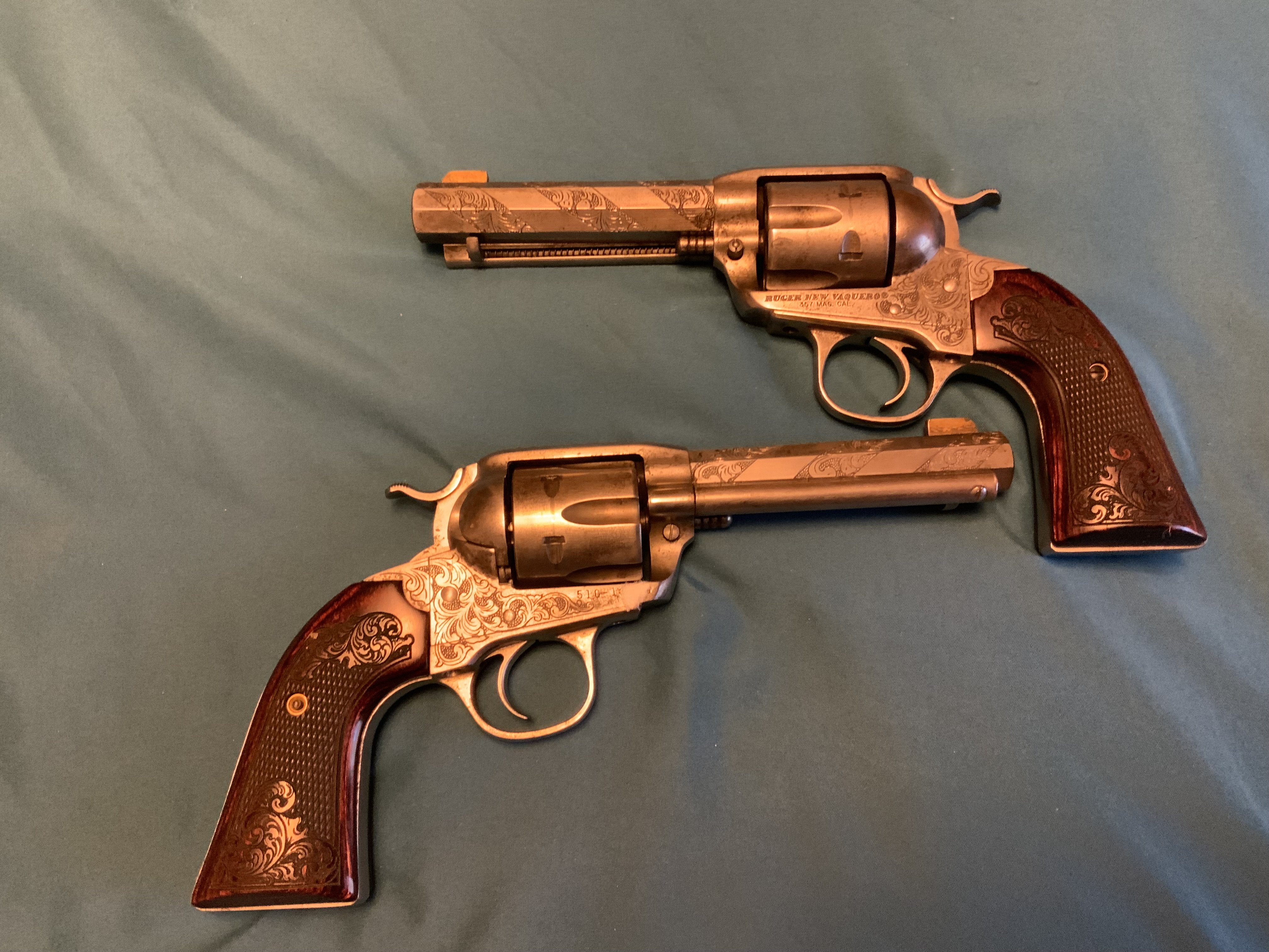

Yul Lose Posted March 31 Posted March 31 Here’s a pair of my New Vaqueros that started out as .357 and are now 44-40 with Octagon barrels. 3 1 Quote

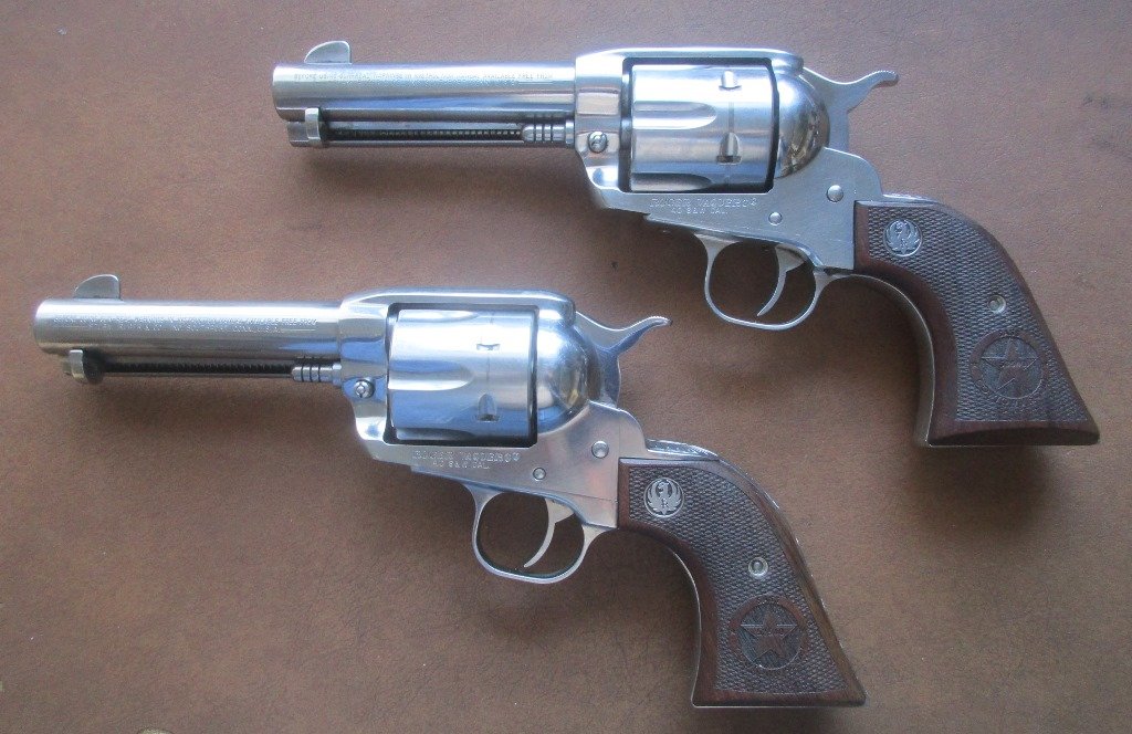

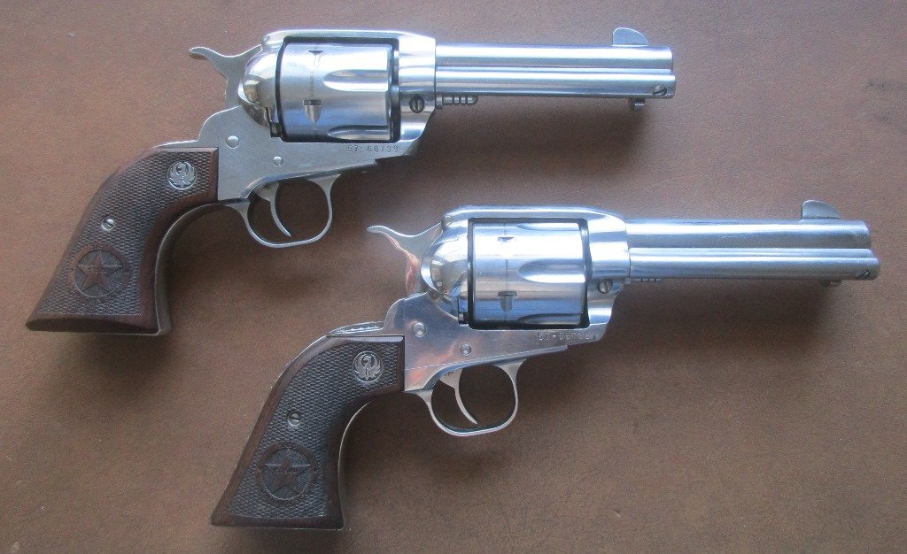

Cowtown Scout, SASS #53540 L Posted March 31 Posted March 31 Here are my pair of OMV that started life as .40 cal and then had the cylinders bored to 38-40 before I purchased them many years ago. 2 1 Quote

Dantankerous Posted March 31 Posted March 31 5 hours ago, Yul Lose said: Here’s a pair of my New Vaqueros that started out as .357 and are now 44-40 with Octagon barrels. I could get used to something like this. I shoot something very similar in 45 Colt, Bisleys. Those octagonal barrels and that engraving... perfécto! Quote
