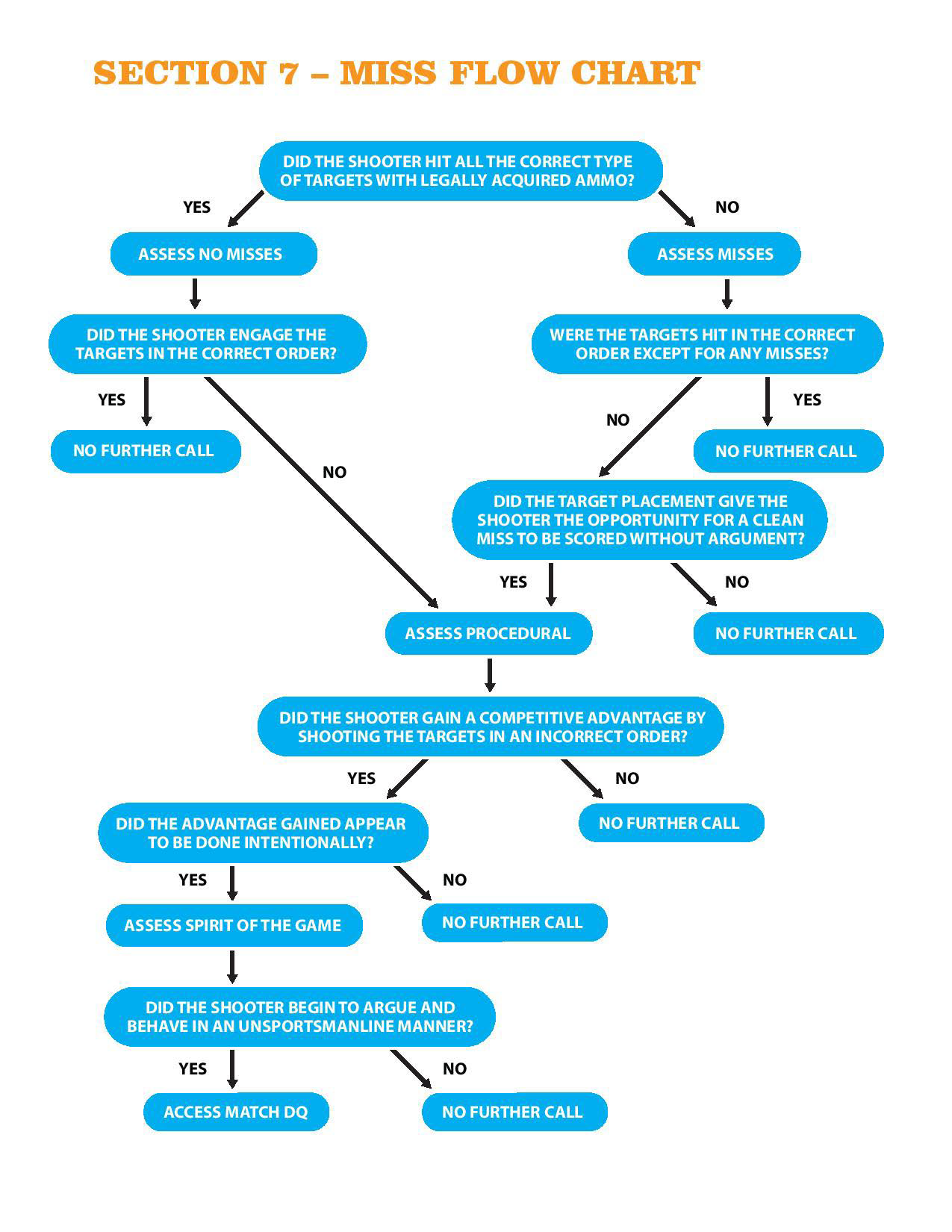

Rafe Conager SASS #56958 Posted March 21 Posted March 21 This is just for my information and not trying to cause a big debate, stage description states shoot targets in a double tap Z, 2 shots on top left, 2 on top right 2 on the middle 2 left bottom left finish with 2 on the right bottom. Shooter starts first 2 on left top then aims at middle target and misses, TO tells him top right, shooter corrects himself puts the next shot on right top and continues with the correct sequence, shooter even jokes glad I missed. I though this was a P as shooter clearly aimed at the middle target but missed, and shooter was awarded a miss as the argument was you can't judge shooters intent. What should have been the call this is the 1st time I have heard this argument; I don't think anyone intends to shoot a stage wrong. Again this is just for my clarification and not intended to call anyone out or start an argument! Rafe Quote
Boggus Deal #64218 Posted March 21 Posted March 21 A miss can’t cause a P. One miss. Next shooter, please. 11 1 Quote
John Kloehr Posted March 21 Posted March 21 (edited) Follow the flow chart. 1 miss, next shooter. I find the flow chart incredibly helpful. Without it, just reading the rules, I get led into the same thought trap you ran in to. Here is scoring by the flowchart: Did the shooter hit all of the correct type of targets with legally acquired ammunition? No Assess misses (1 miss) Were the targets hit in the correct order except for any misses? Yes No further call Edited March 22 by John Kloehr Undid edit, see the chart. 7 2 Quote

Rafe Conager SASS #56958 Posted March 21 Author Posted March 21 (edited) It was a pretty straight forward stage, double tap the top 2 targets left to right double tap the middle then bottom 2 left to right double tap, my big confusion was shooter aimed at the middle target and missed then when coached bt TO to that the target was top right and an audible reaction by shooter of "oh ya" that's where I thought it was a p. I've read the rule book and taken a ro class, guess I need to download the flow chart Edited March 23 by Rafe Conager SASS #56958 3 Quote
El Sobrante Kid Posted March 21 Posted March 21 1 hour ago, John Kloehr said: Follow the flow chart. 1 miss, next shooter. I find the flow chart incredibly helpful. Without it, just reading the rules, I get led into the same thought trap you ran in to. Here is scoring by the flowchart: Did the shooter hit all of the correct type of targets with legally acquired ammunition? No Assess misses (1 miss) Where the targets hit in the correct order except for any misses? Yes No further call Is there a .PDF or .DOC downloadable Flow Chart??? Thx 2 Quote
Rafe Conager SASS #56958 Posted March 22 Author Posted March 22 (edited) All I can find is a miss flow chart is there a procedure flow chart? I know we can't remember all the rules I'm just trying to be the best to/spotter i can be. So if he hit the middle target it would have been a p but since he missed it's just a miss no procedural? Edited March 22 by Rafe Conager SASS #56958 1 Quote
Garrison Joe, SASS #60708 Posted March 22 Posted March 22 34 minutes ago, El Sobrante Kid said: Is there a .PDF or .DOC downloadable Flow Chart??? Thx In the back of the PDF version of the Shooter's Handbook. good luck, GJ 1 Quote
John Kloehr Posted March 22 Posted March 22 (edited) 36 minutes ago, El Sobrante Kid said: Is there a .PDF or .DOC downloadable Flow Chart??? Thx It is page 44 of my downloaded pdf copy. At the moment, the top sass net.com website seems to be off-line, but the current manual should be one click away from: https://sassnet.com/the-shooting/cowboy-action-shooting/handbooks-rules Edited March 22 by John Kloehr 1 Quote
Flying W Ramrod Posted March 22 Posted March 22 As I understand, he hit top left twice, top right once (with a miss), middle twice, bottom left twice and bottom right twice. Miss only. 2 Quote
John Kloehr Posted March 22 Posted March 22 12 minutes ago, Rafe Conager SASS #56958 said: All I can find is a miss flow chart is there a procedure flow chart? I know we can't remember all the rules I'm just trying to be the best to/spotter i can be. So if he hit the middle target it would have been a p but since he missed it's just a miss no procedural? I do not know of a procedure flow chart, but yes, I think the bolded part is what makes the difference. Unless there was something about target placement which made the miss on the intended target hit the unintended target. Paraphrasing the rules to my vague understanding, target placement is to allow for a clean miss. 1 Quote
Flying W Ramrod Posted March 22 Posted March 22 Here it is. Follow the entire flow chart to find P's 2 1 Quote
Garrison Joe, SASS #60708 Posted March 22 Posted March 22 There is NO procedural flow chart. The decision to make is: Did the shooter engage the targets in the correct order? as called out in the Miss Flow Chart. Since we do not try to read the shooter's intent, the targets are in a close array (giving not much hint which was being aimed at), and we have the rule of thumb that "a miss cannot cause a P," then the miss was considered an engagement of the correct target. Other procedurals are invoked by the context of the shooter's actions, and not needing a sequence to define by a diagram, as they all stand independently, and shooter only has to have committed one to be awarded a P. No multiples. good luck, GJ 3 1 Quote

Ciderbarrel Posted March 22 Posted March 22 3 hours ago, Griff said: Why? I don't see it. If the targets are too close together, the shooter does not get a chance of a "clean miss". Missing the wrong target is 5 seconds. Missing the correct target and hitting a target right next to the correct one, imor directly behind or in front, is a P. Hence, a P trap. Obviously it has to be the opinion of the TO, and this should be caught and addressed in thr pre-shoot walk-through, but this should be a No Call, not a P. It does not matter what the spotters say, only the TO can declare a P. Quote

Randy Saint Eagle, SASS # 64903 Posted March 22 Posted March 22 4 minutes ago, Ciderbarrel said: If the targets are too close together, the shooter does not get a chance of a "clean miss". Missing the wrong target is 5 seconds. Missing the correct target and hitting a target right next to the correct one, imor directly behind or in front, is a P. Hence, a P trap. Obviously it has to be the opinion of the TO, and this should be caught and addressed in thr pre-shoot walk-through, but this should be a No Call, not a P. It does not matter what the spotters say, only the TO can declare a P. Possibly I missed something in the original post, but I don't see anything to indicate that the targets were too close together to get a clean miss? I don't see a "P" trap? Randy 6 Quote
Griff Posted March 22 Posted March 22 21 minutes ago, The Original Lumpy Gritz said: Just going by the instructions, seeing the target layout could well change my feeling. In it's most simplistic form, I see the following as the layout. Quote shoot targets in a double tap Z, 2 shots on top left, 2 on top right 2 on the middle 2 left bottom left finish with 2 on the right bottom. At the Bar-3, T-Bone had a target array very much like this, but with additional targets to make it 3 rows of three. Often using different instructions using the same array. 6 1 Quote

Rafe Conager SASS #56958 Posted March 22 Author Posted March 22 (edited) Thanks Griff, this is exactly the layout, about 1-2 feet between targets and a 2 foot step down between target lines, no p trap from what I saw. targets set up provided enough space for a clean miss, my only question was I was behind the shooter so I had a plain view of where his muzzle was pointed and shooters audible "glad I missed" that is where I thought it was a P, but as stated a miss can't cause a P, I would have called the P on myself but I'm only in this game for fun not the golden Cadillac or million dollar check. Rafe Edited March 23 by Rafe Conager SASS #56958 1 Quote
Randy Saint Eagle, SASS # 64903 Posted March 22 Posted March 22 2 minutes ago, Rafe Conager SASS #56958 said: Thanks Griff, this is exactly the layout, about 1-2 feet between targets and a 2 foot step down between target lines, no p trap from what I saw. targets set up provided enough space for a clean miss, my only question was I was behind the shooter so I had a plain view of where his muzzle was pointed and shooters audible acknowledgment as aiming at the wrong target and "glad I missed" that is where I thought it was a P, but as stated a miss can't cause a P, I would have called the P on myself but I'm only in this game for fun not the golden Cadillac or million dollar check. Rafe He was correct and lucky that he missed it as we can't judge what he intended to do, only what actually happened. I like this discussion and most WTC's as they make us think what we would do at the spur of the moment. I've told lot's of folks in RO classes that I can almost always make the correct call, Tomorrow, after I've had time to go home and reread the handbooks, check flow charts and Glossary of Terms. 🤠 Randy 6 1 Quote
