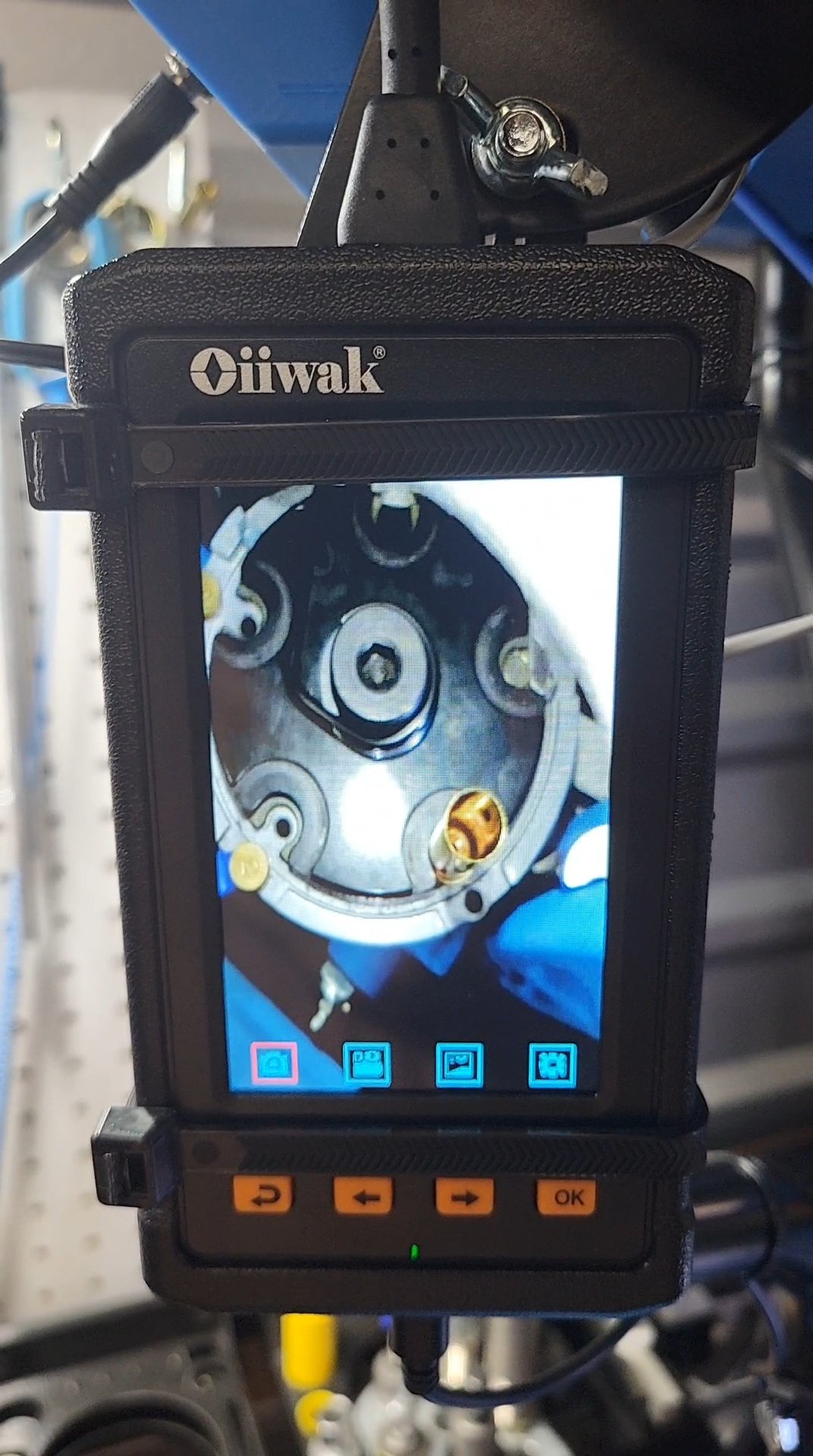

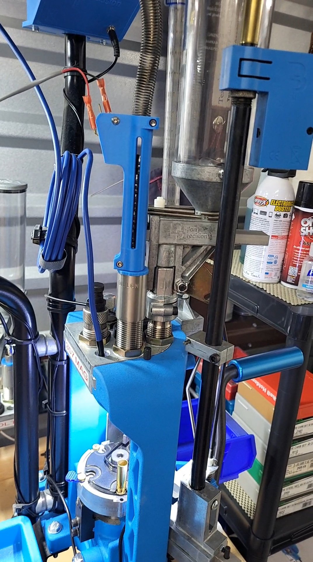

I added this to my XL750 back in December.  A few days ago the price (on Amazon) jumped from $36 to $50, but presumably it will come down again.  I use it the same way -- the display shows the view looking down into the case before the shell plate lifts the case up to bullet drop die.  It is great.

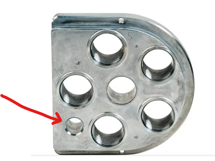

I have the screen part zip-tied to the support post for the bullet feeder, and the camera end of the fiber fitted into a hole I made in a small cork that fits very nicely into the hole shown below.  It would be better if that hole was between stations 2 and 3 but it is still good enough where it is to see partially into the case to see that there is in fact powder in it.

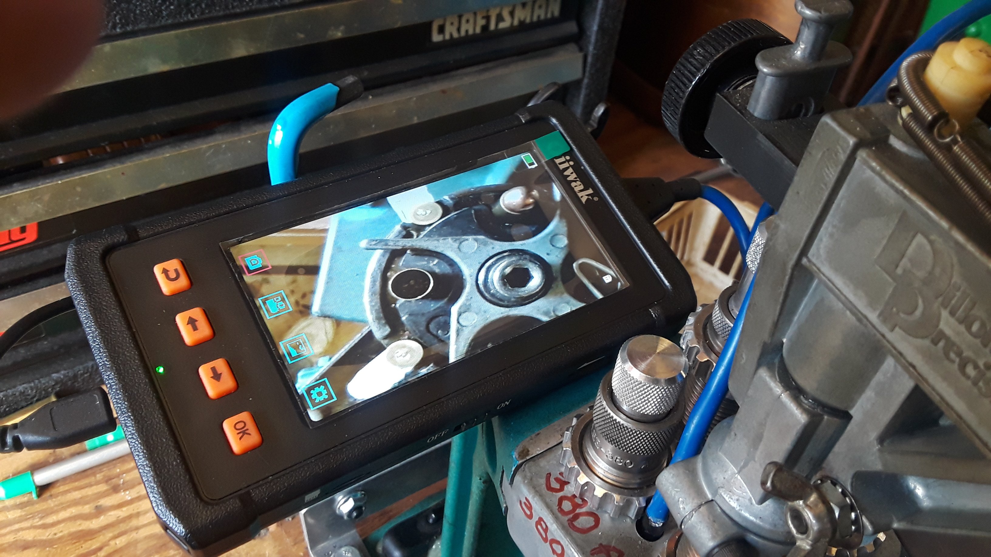

This is the setup on my 550. It works great.

Here's how mine is set up.  Also works great.
I wet tumble my brass with stainless steel pins so the insides of the cases are bright and shiny.  It is very easy to see the difference between a bright shiny empty case and one with a dark powder charge in it.
