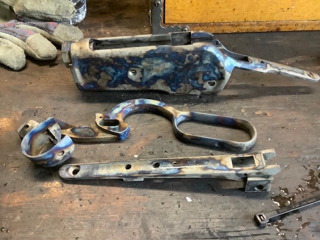

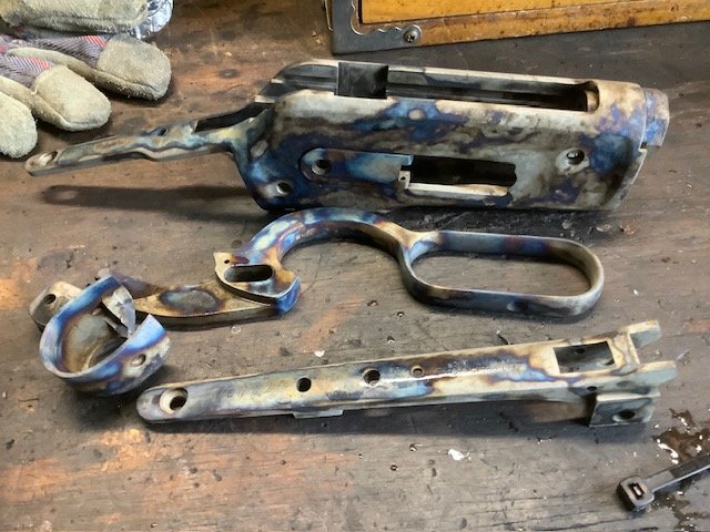

 My buddies Winchester 1895 we color cased hardened and refinished it was a wreck sometime in it’s past life someone fitted a old trap door 45/70 barrel to it poorly and made it a perfect refinish rebuild project ended up as a 50-110 but man with the crescent butt plate you don’t want to pull the trigger too muchIMG_2272.jpeg.dc300f1a825e257b5108f45eda80a6e9.jpegIMG_2271.jpeg.5088cab9e4785ff27745597aee0114a5.jpeg

Wow!  That looks like it's well on the way to  being very beautiful.    Good luck with it.

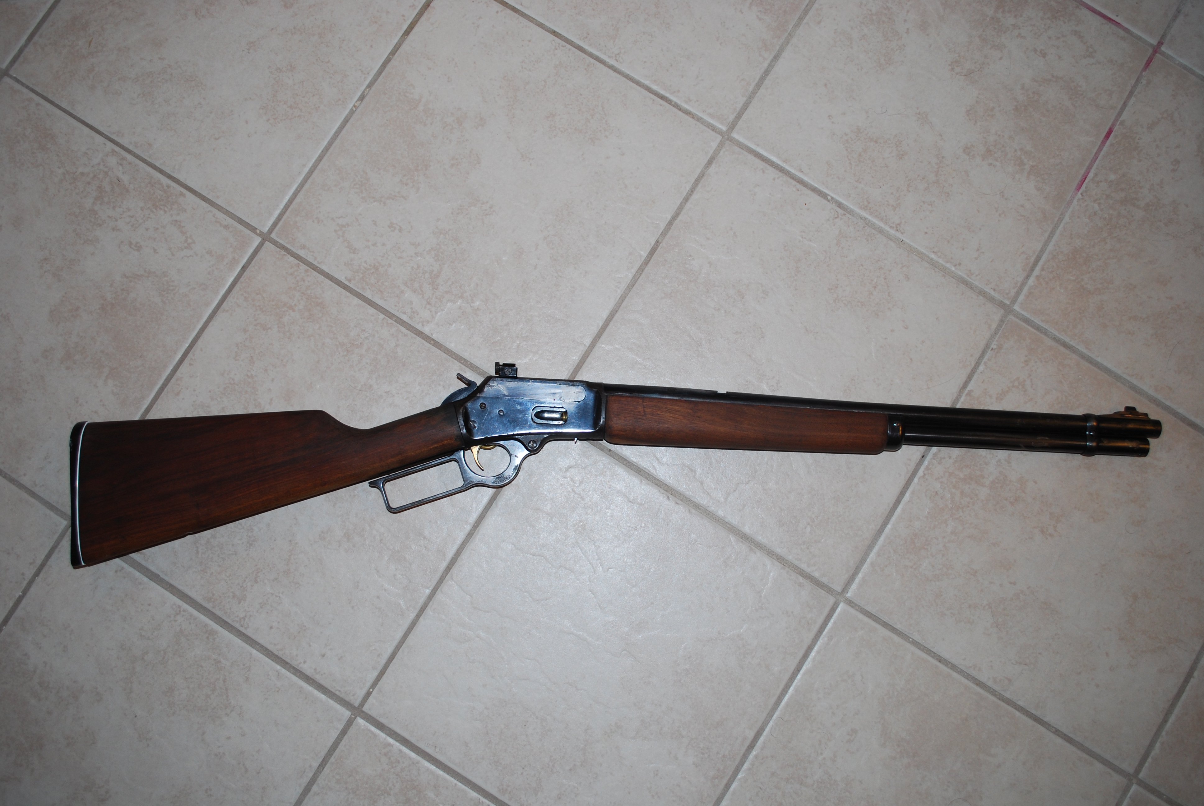

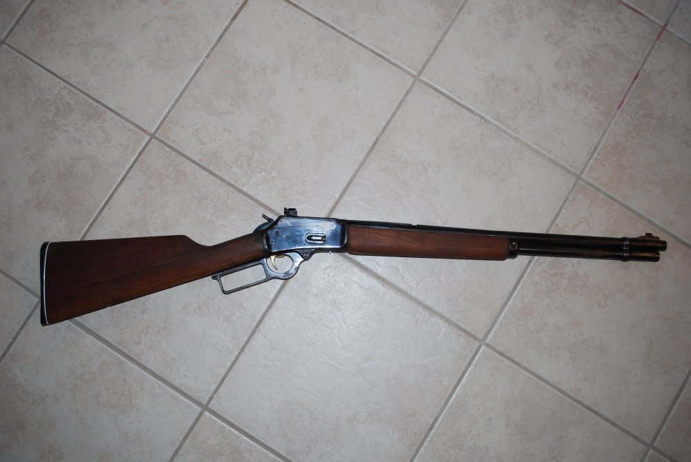

As is this carbine:
Picture doesn't do it justice.  the receiver is badly rusted, the bbl & mag tube also.  Wood, while most of its finish is bad, the actual wood is sound.  (Donated to someone else's project).

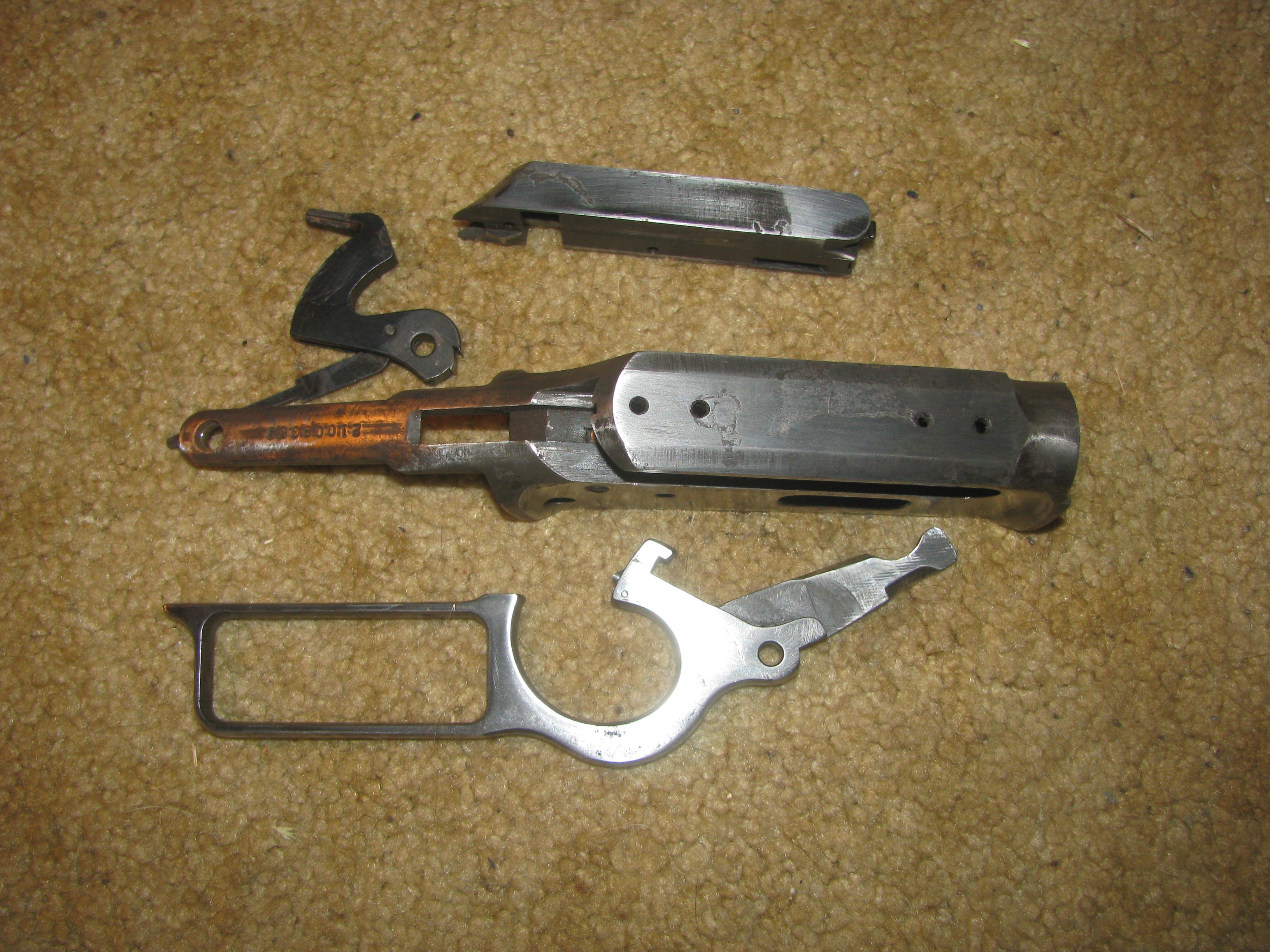

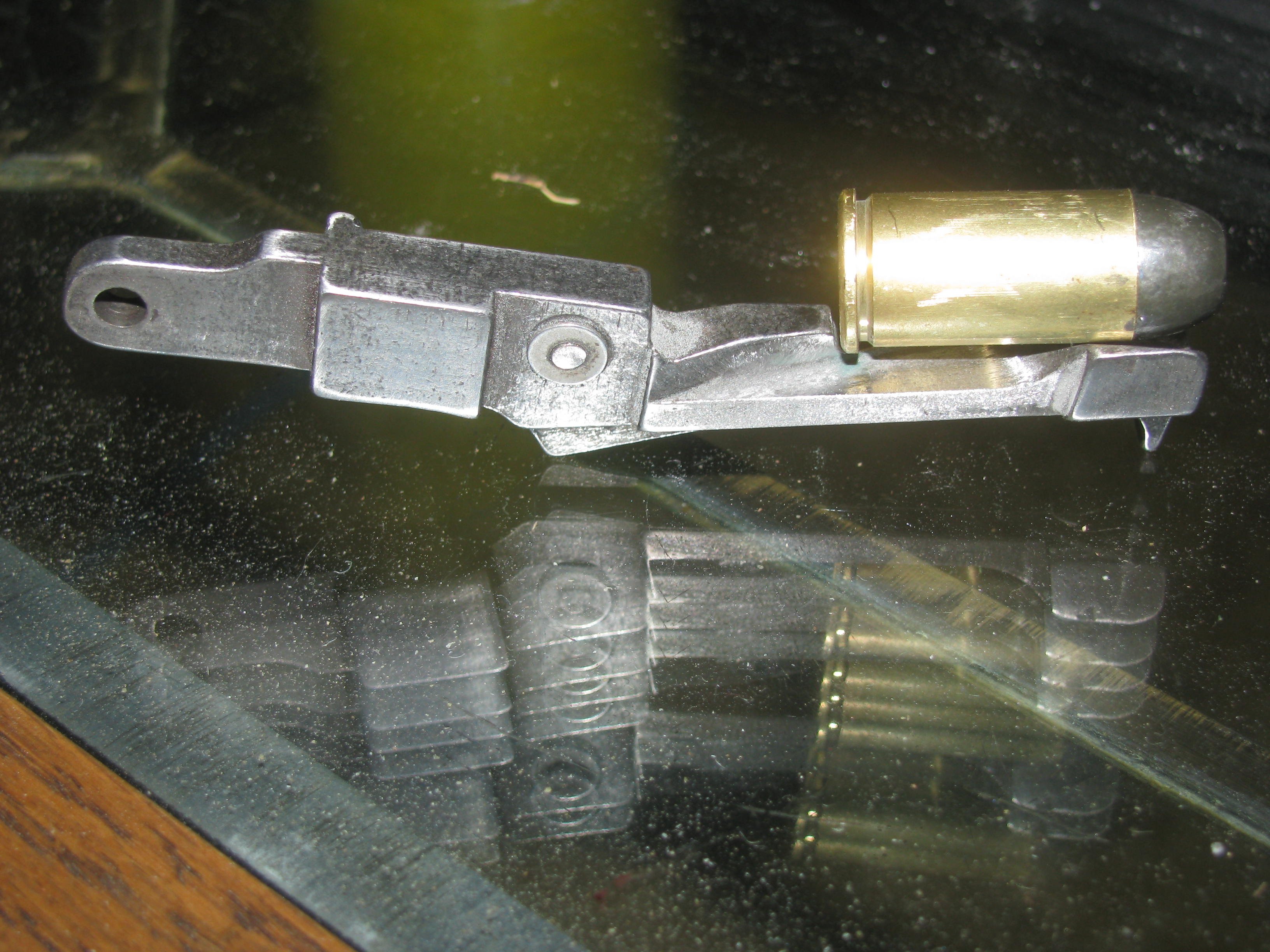

This photo shows some of the damage to the receiver & bolt, after some sanding to removed most of the surface rust.

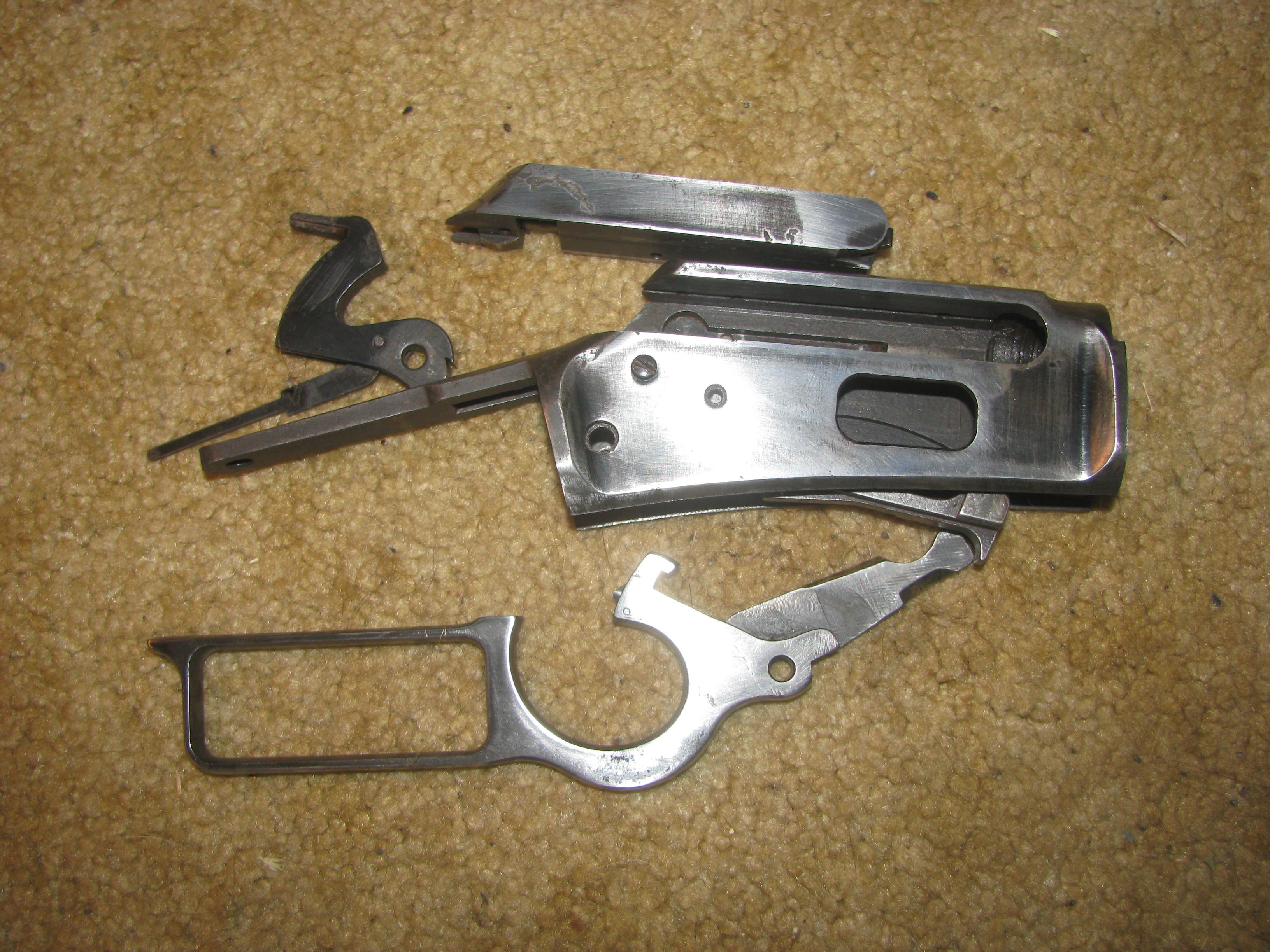

side view after initial sanding.

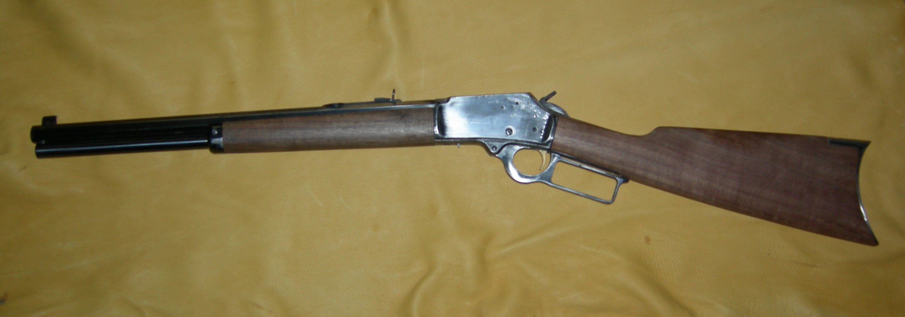

Shown here in it's new configuration before refinishing.  Where its been stalled for a number of years as I get the action perfected.
Previously it was a 44 Mag carbine, now it has a Cowboy Competition bbl in 45 Colt, cut to 17-½" with a recessed crown, Marble's front sight, a Uberti rear sight, forend, (that's undergone a severe diet), buttstock & buttplate from Precision Gun Works.  Planned enhancements are to CCH the receiver, lever, lower plate, jewel the hammer, trigger and (maybe), the right side of the bolt.  Can't decide between that and a deep blue on the bolt.  But, first it has to function as a "Widderma'jik".
Still workin' on it:
Oh yea, even tho' it can't be seen, the carrier'll get jewelled too.  Nuttin' like puttin' lipstick on a pig!
