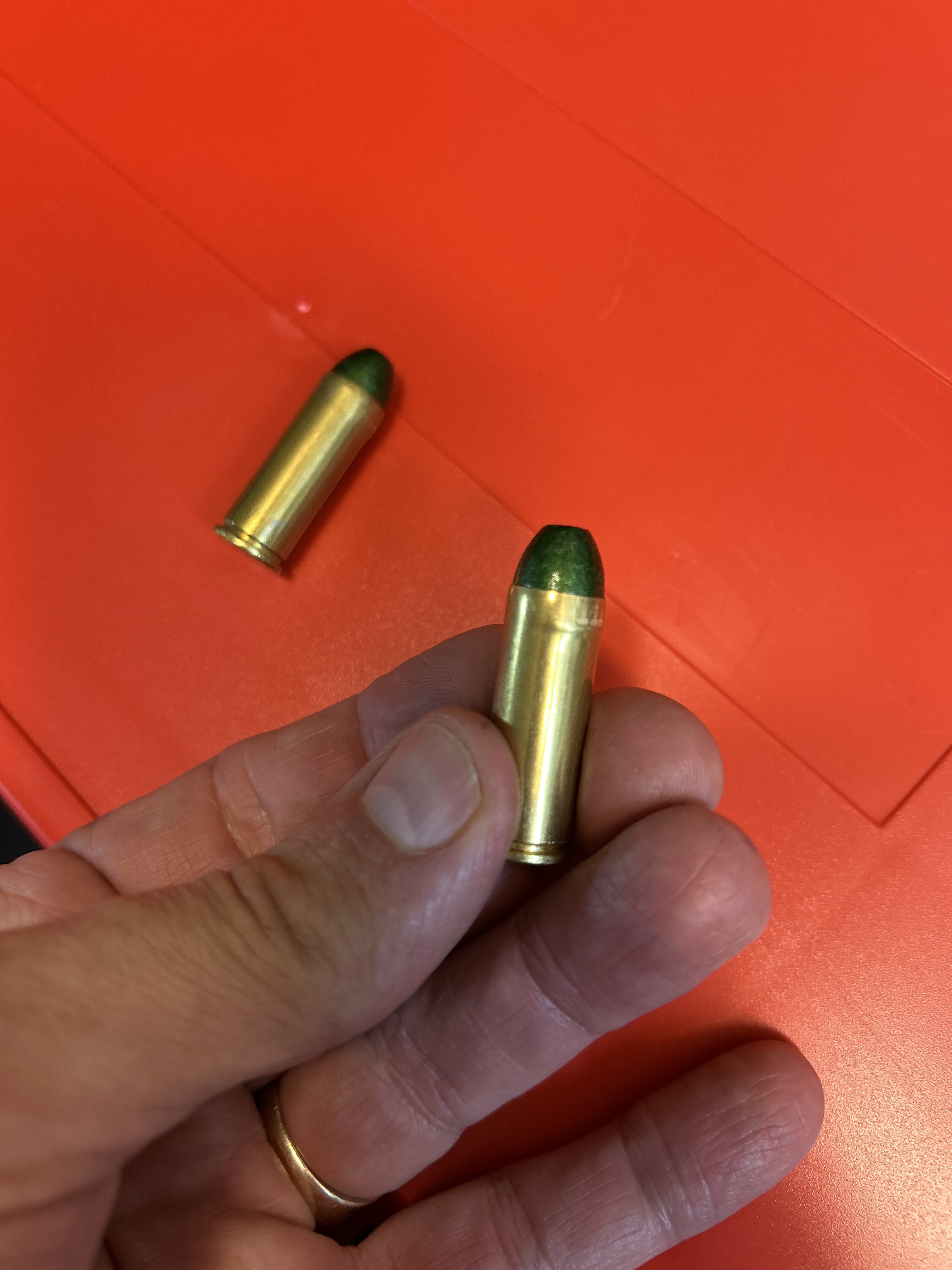

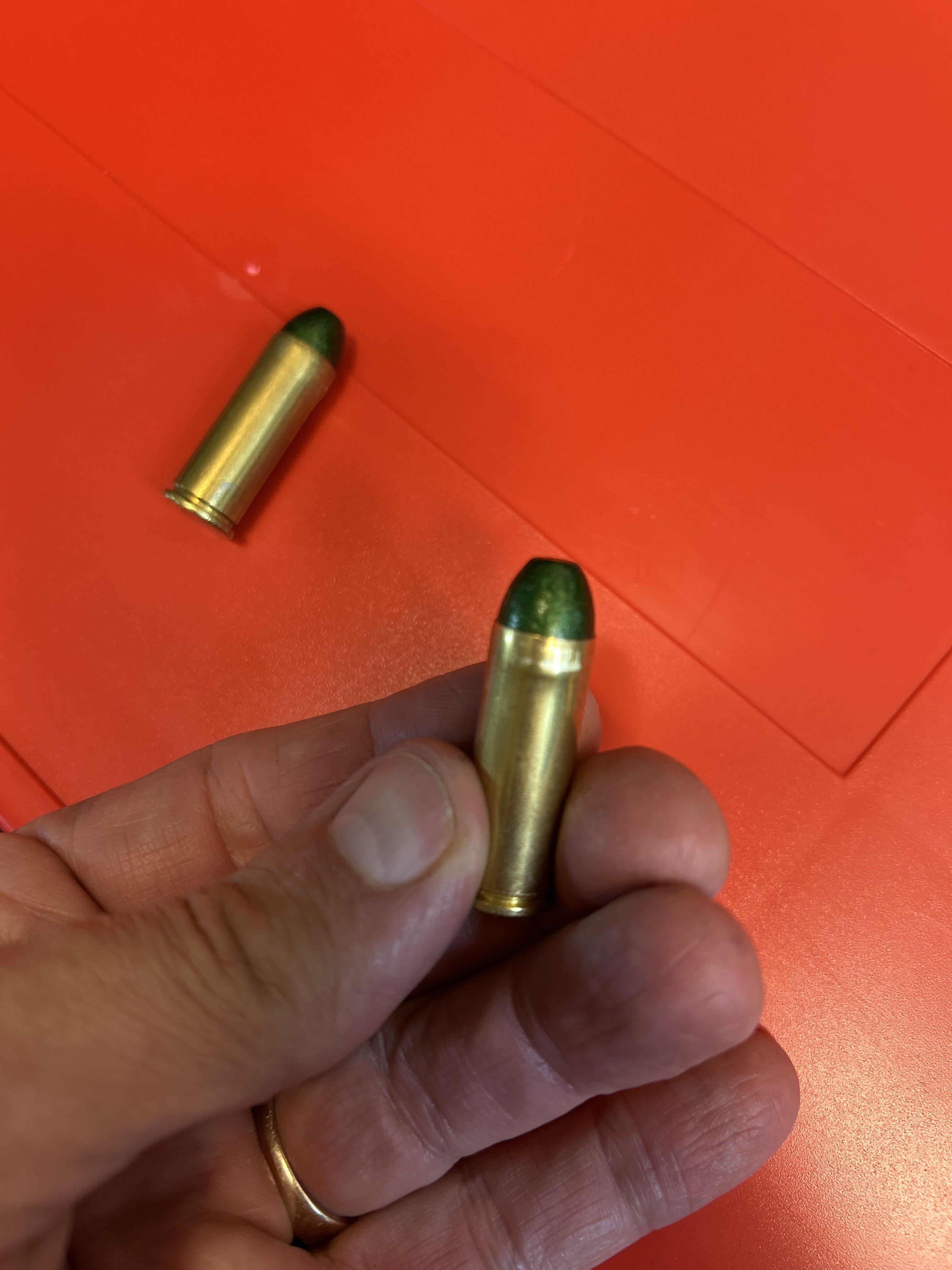

Tall John Posted March 7 Posted March 7 Im reloading .45 Colt on an XL650 with Dillon sizing, seating dies and a Lee FC die. The press has most of the most common upgrades including a Uniquetek powder funnel designed for cast bullets vs the prescribed Dillon E funnel. I’m getting random bulges on my .45 Colt reloads (Starline brass with 200grn HT coated LRNFP, flat bottom .452” bullets, 1.577 OAL ). See pics. Any thoughts on the cause? Quote

Griff Posted March 7 Posted March 7 It appears as though your crimping die is set too low, or if you're crimping/seating in one step, you are too low. OR... your case lengths are inconsistent. I've used the Dillon powder funnel/expander since 1987 with no problems. I loaded about 250 rounds of 45 Colt yesterday. 4 1 Quote
Tall John Posted March 7 Author Posted March 7 I’m using the Lee Crimp die in a separate stage. I wondered about case length due to the fact that the problem is very random and very small, like 10 rounds out of 1,000 loaded. I just went and measured the OAL on these loads and they all range between +0.003 and +0.006 longer. I separated my brass by HS but didn’t check length of them before loading. Thanks! 1 Quote

Nostrum Damus SASS #110702 Posted March 8 Posted March 8 First try raising the Lee FCD 1/8 turn and see if the problem goes away. It is probably a bit too tight and is thus engaging the case mouth too early and is crushing it downward to make the bulge. Obviously this will happen first on the longest brass cases in your batch. Quote
Preacherman Posted March 8 Posted March 8 You show a seated/crimped completed round. If it bulges before the crimp stage it could be the funnel. If not bulged before the crimp stage, back off your crimp a bit. Sometimes if the bullet catches the mouth upon seating it will deform the case too. Quote

Blackwater 53393 Posted March 14 Posted March 14 (edited) I had a VERY similar issue with some .45s a few weeks ago. Ended up with a half dozen that looked exactly like those in your picture. I had recently gone from a smaller, lower profile bullet to what I had the problem with. All of my brass was new Top Brass during both sessions I too am using the Lee FCD and I backed off the setting a quarter turn and it went away. If you feel a slight “tug” as you raise the lever, (lowering the shell plate/platform) you might be over crimping you cartridges. Look carefully at the round as it comes out of the seating die and again as it comes out of the crimp die. NOTE: I ran the offending cartridges through a separate sizing die on my Rock Chucker and they straightened up nicely and fed and fired flawlessly. YMMV Edited March 14 by Blackwater 53393 1 Quote

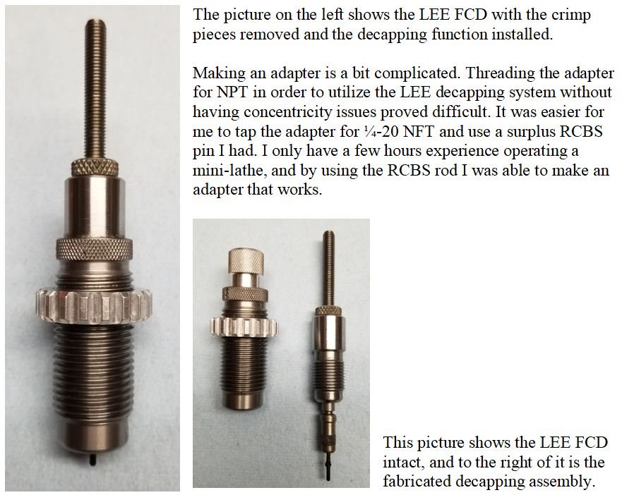

"Big Boston" Posted March 15 Posted March 15 49 minutes ago, The Original Lumpy Gritz said: More like setting a straight wall case sizing die. The FCD is a fantastic tool. Agree. I adapted a decapping pin to one and use it to size the body, then a normal die to neck size. I do wish that the crimping sleeve was a bit more precisely made, but it does work. BB 1 1 Quote
The Original Lumpy Gritz Posted March 15 Posted March 15 3 hours ago, "Big Boston" said: Agree. I adapted a decapping pin to one and use it to size the body, then a normal die to neck size. I do wish that the crimping sleeve was a bit more precisely made, but it does work. BB VERY NICELY DONE 1 Quote
