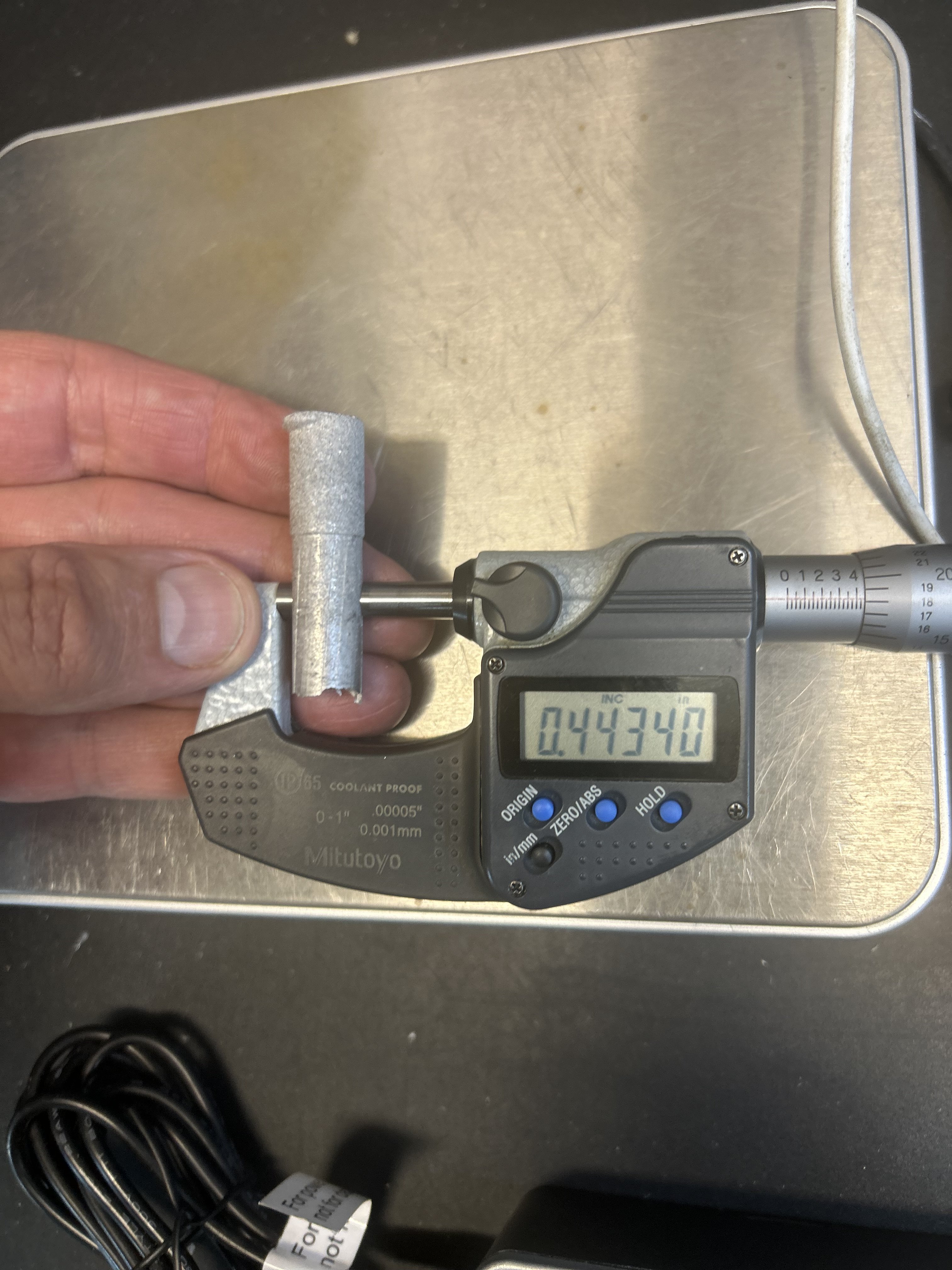

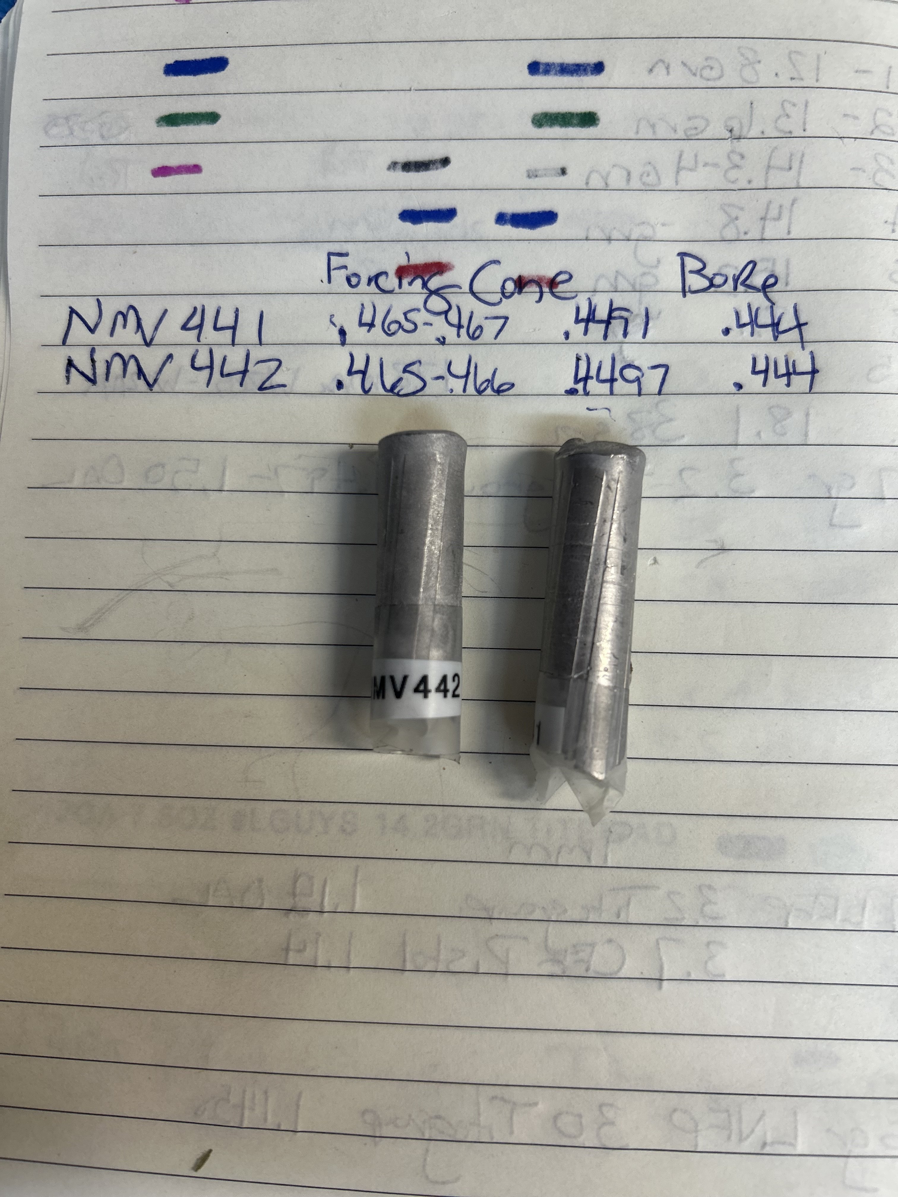

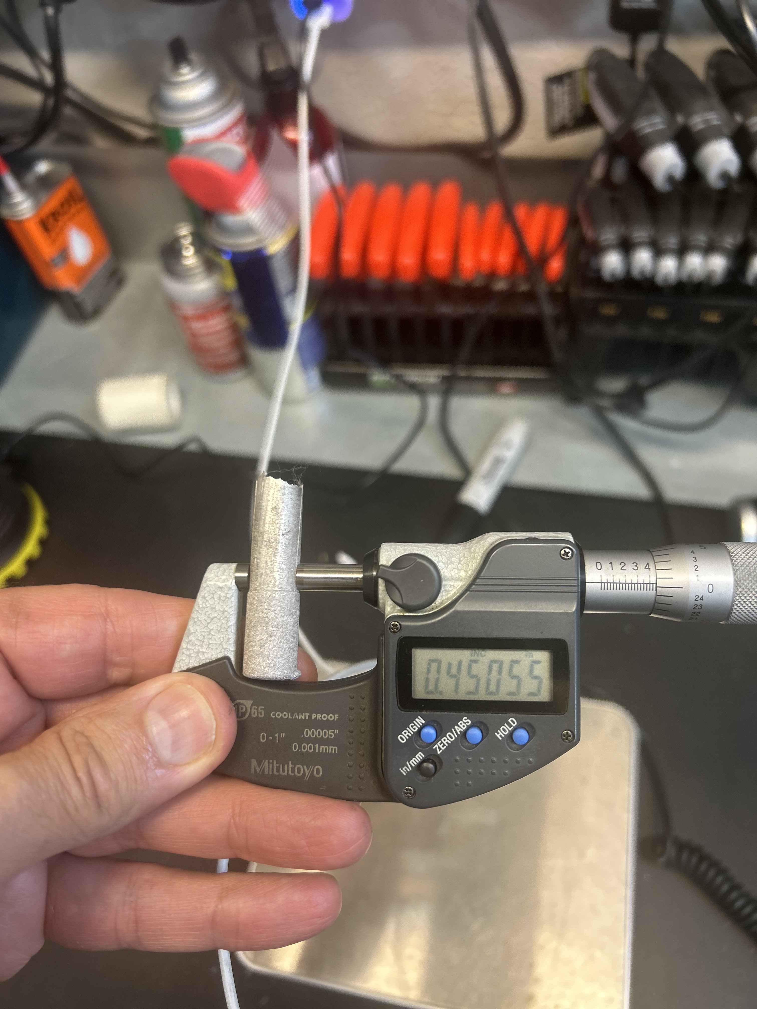

Tall John Posted March 7 Author Posted March 7 Well, my new SR1911 slugs really tight to spec. Grooves 0.4434” Lands 0.4505” F.C. 0.4515” so now what? Size down to 0.451” or stick with 0.452” Quote

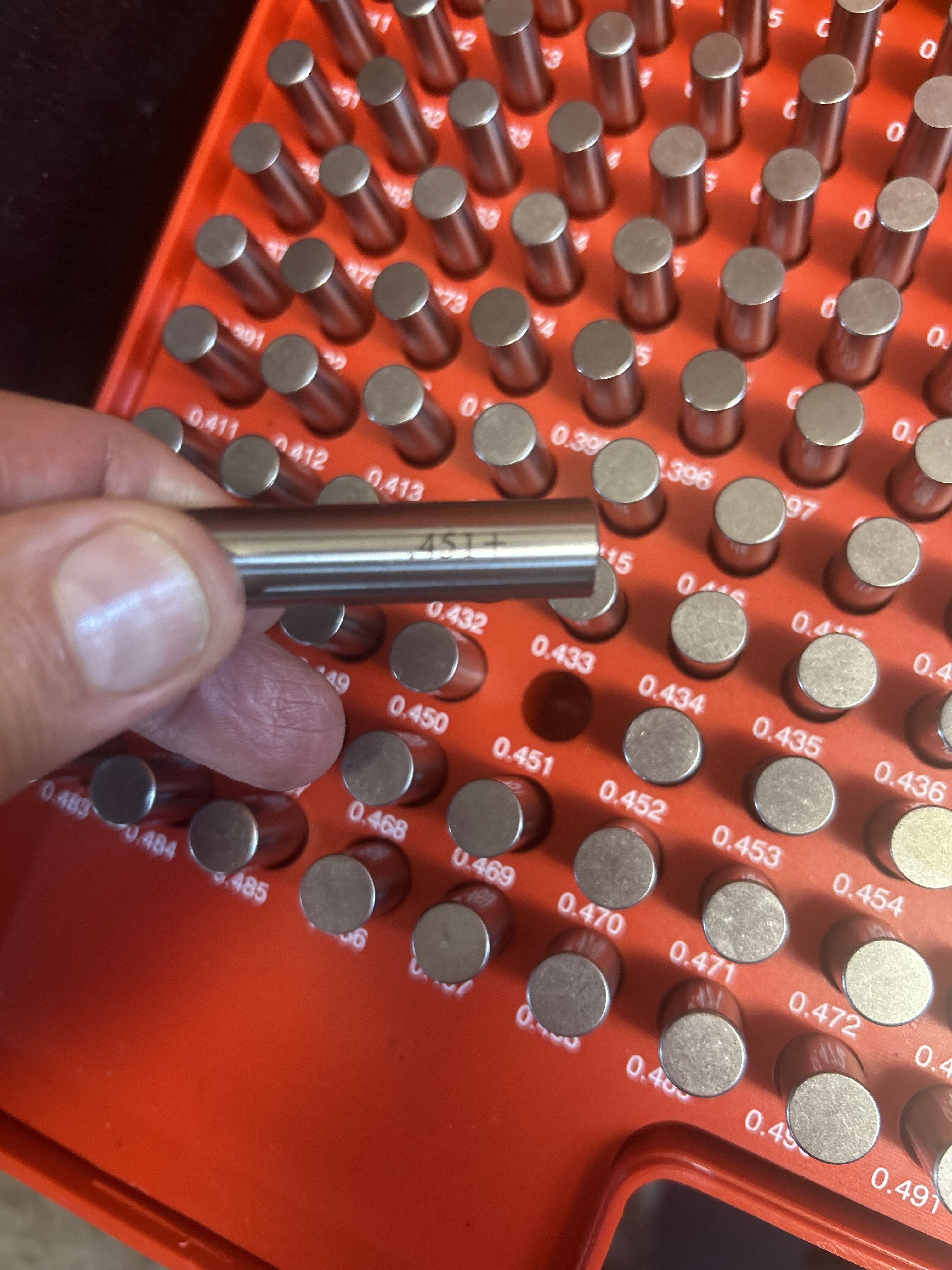

Tall John Posted March 7 Author Posted March 7 (edited) .45 Colt NMV SLUGS Forcing cones are 0.465-0.467" (rotating slug w multiple measurements. Lands are 0.449-0.4518" Grooves are 0.444 - 0.4460" Depending where the readings are taken down the length of the slug.  shouldn’t I size my bullets at 0.452” after powder coating? cylinder chambers fully accept a +0.451” pin gauge but not a +0.452” gauge from my +0.0002” to -0.0000”gauge kit  Edited March 7 by Tall John Quote
Griff Posted March 7 Posted March 7 Over thinking most anything will lead to ulcers, heart burn and stress you don't need. Basic rule of thumb for decades has been: .451" for jacketed, .452" for cast. Powder coated cast bullets are just that, cast. If your groove diameters are .4515", then anything up to .002" over that .4515" will be just fine. I run a 200 RFN in my 1911s @ around 825fps just so I don't have to cast or buy two different bullets for WB & cowboy. These run thru 7 different 1911s, 3 Colts, a Rock Island, 2 Taylor's & a Remington Rand slide on an Interarms frame with Wilson internals & Bar-Sto barrel. 18 hours ago, El Chapo said: ... 9mm... 'Nuff said. Does not translate to anything .45 auto related. Quote
Garrison Joe, SASS #60708 Posted March 7 Posted March 7 4 hours ago, Tall John said: Lands are 0.449-0.4518" Grooves are 0.444 - 0.4460" The names on the barrel features are backwards. Lands are the small diameter - what the barrel was bored to. Grooves are cut into the barrel with a cutting tool that goes deeper than the bore (lands), thus the groove diameters are a larger number! good luck, GJ 1 Quote
