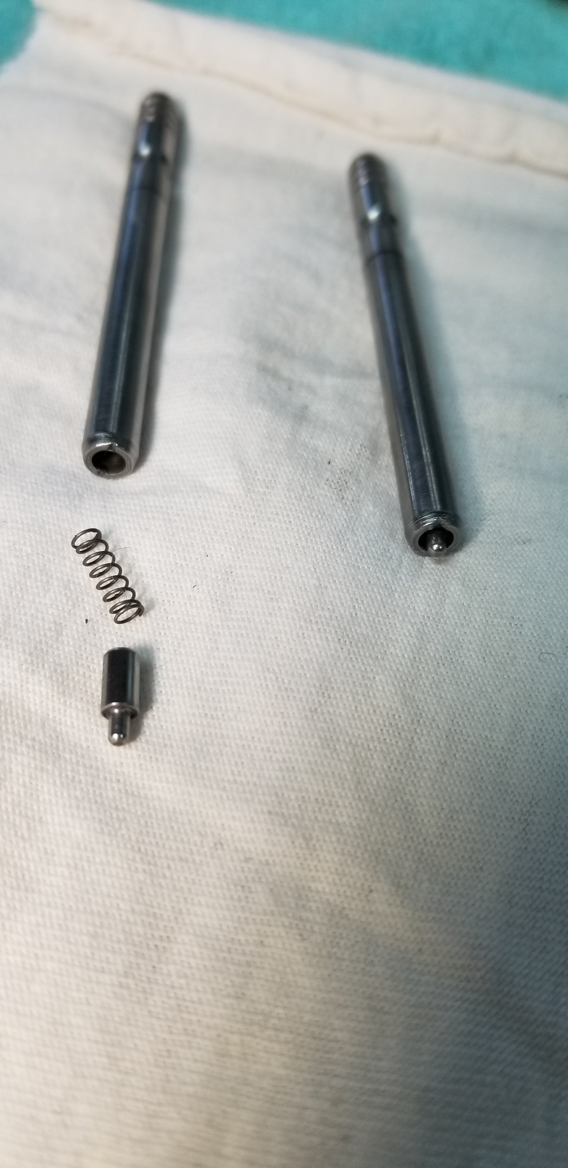

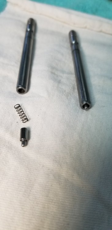

Jackalope Posted March 6 Posted March 6 Boomstick Jay removed the transfer bars from my wife's .32 Rugers when he did a short stroke job on them. They worked really well and she shot them for several years before she noticed one of them didn't function quite like it should. When I disassembled the gun trying to diagnose the issue, I found a tiny spring and another small piece jammed into the loading gate spring. These pieces were intermittently binding up the gun when she tried to cock it. As it turned out, the spring and plunger from the cylinder pin (which originally kept the transfer bar from hanging up on the firing pin) had worked their way loose and, with no transfer bar to retain them, they immigrated their way to the internals. I imagine some folks intentionally remove the spring and plungers when they convert Rugers, but for whatever reason, Jay didn't. Might be something to ask about if you have your transfer bars removed. 1 Quote
