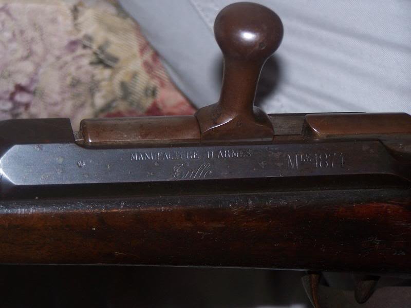

Hm.  When I get home tonight I'll drag out my 11 mm Gras and take a look at it. 🙂

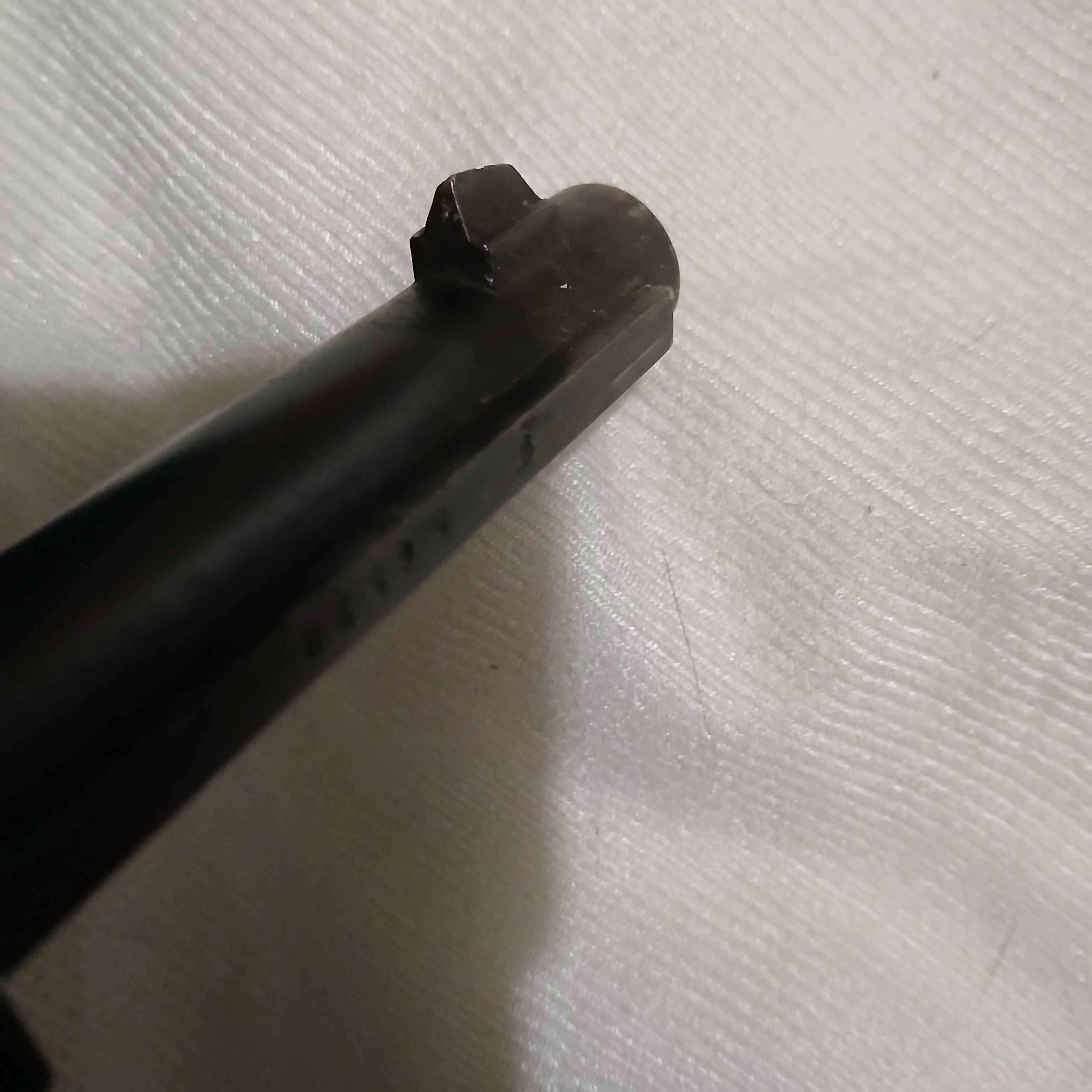

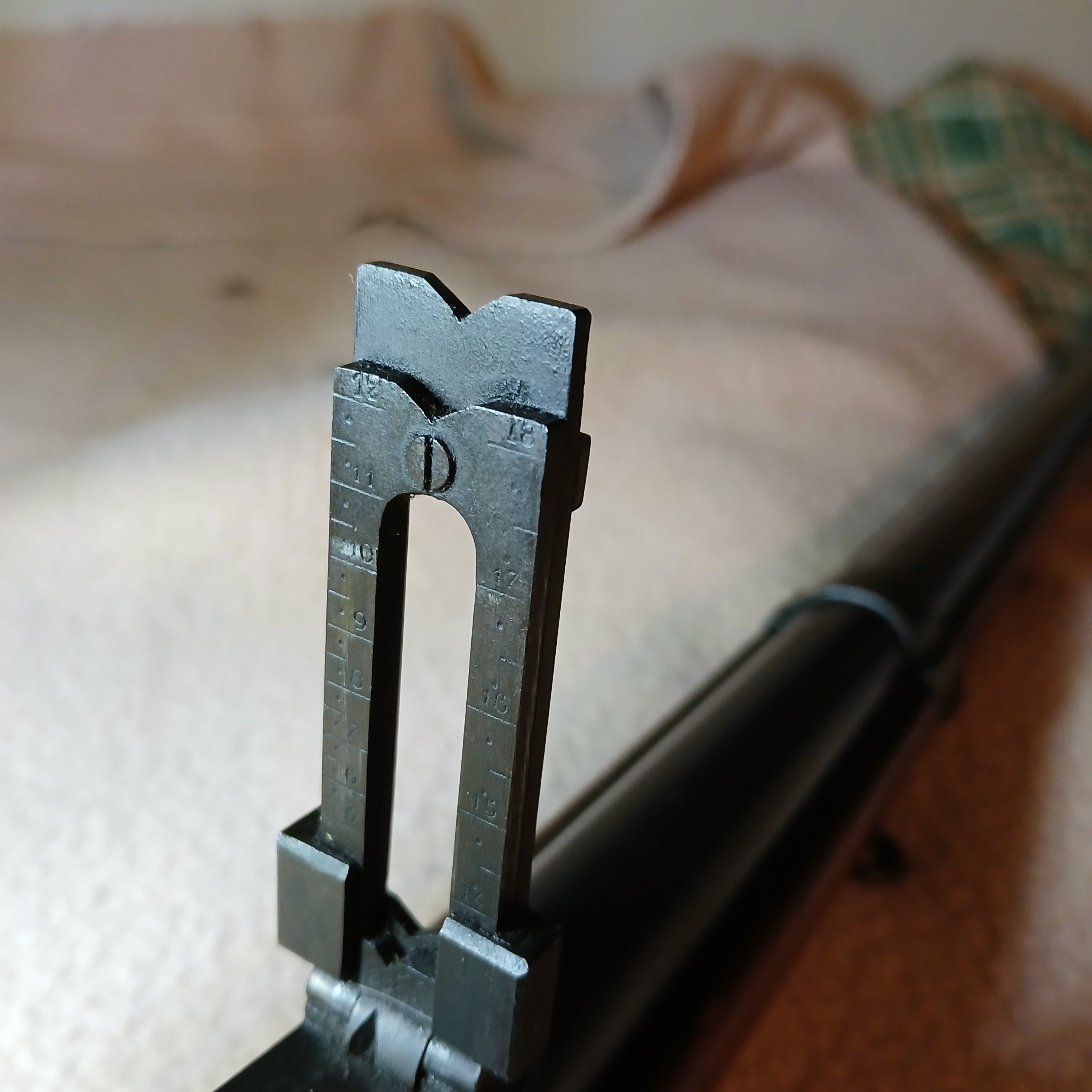

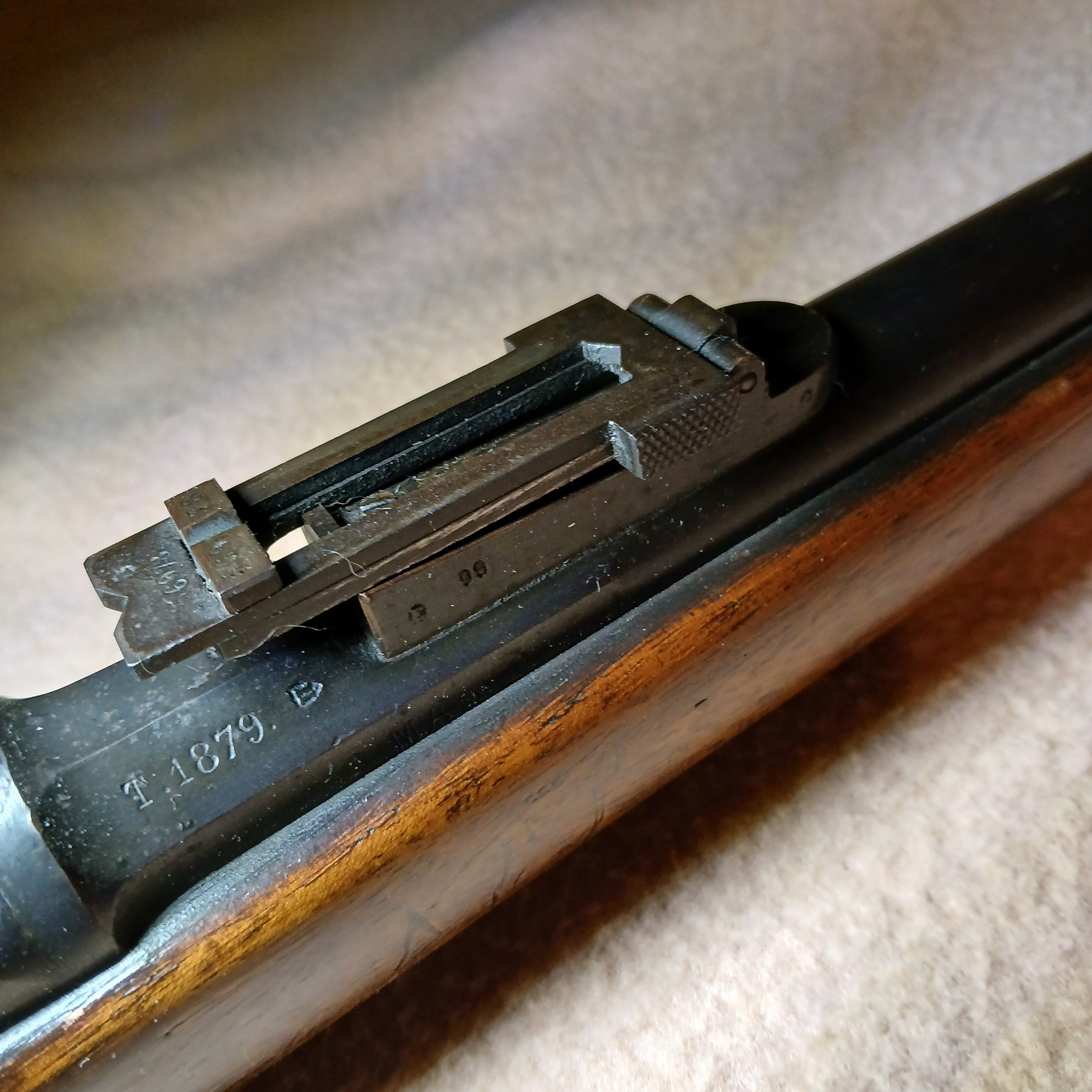

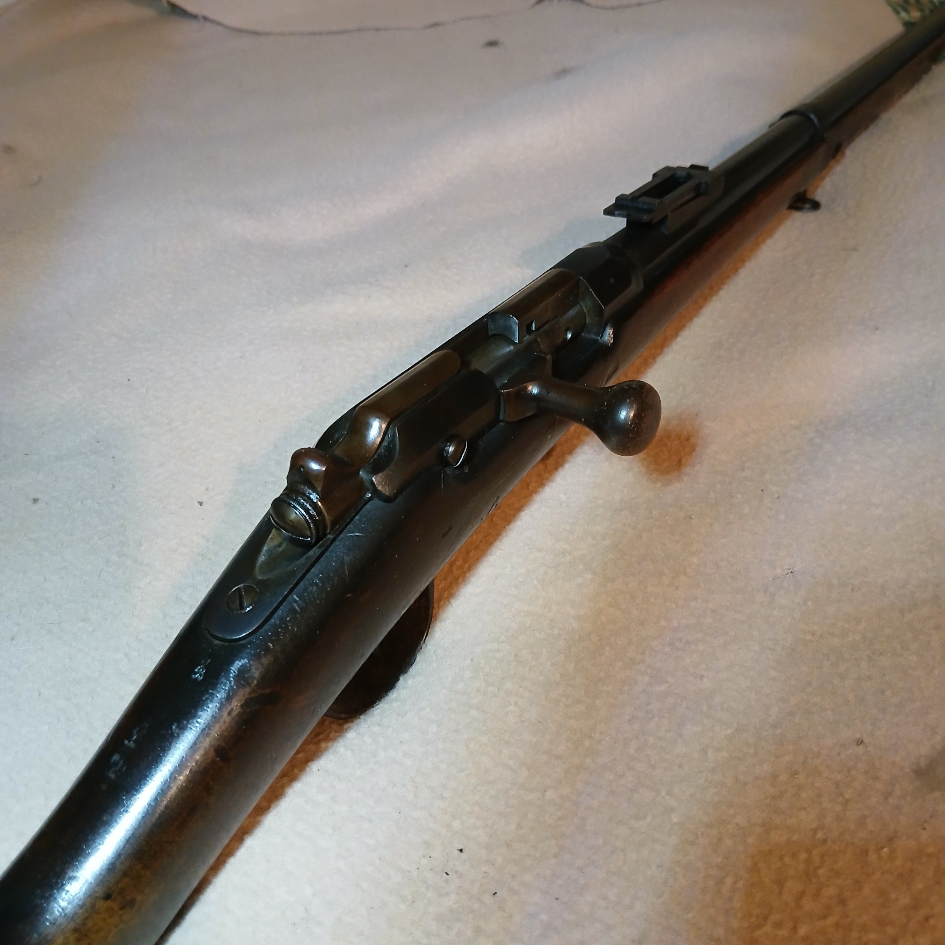

Took me a while to get home, but here be the Gras.  :)

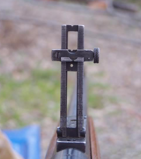

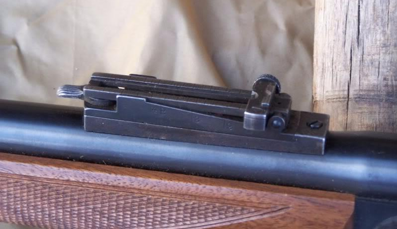

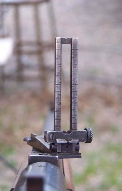

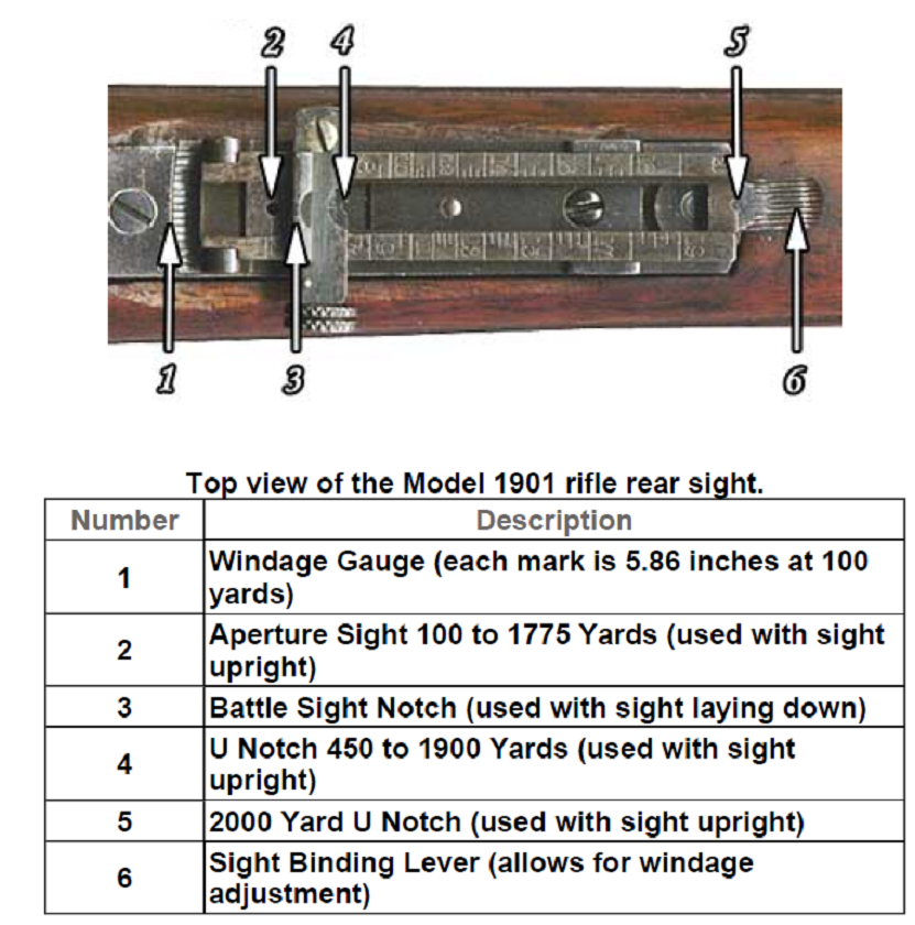

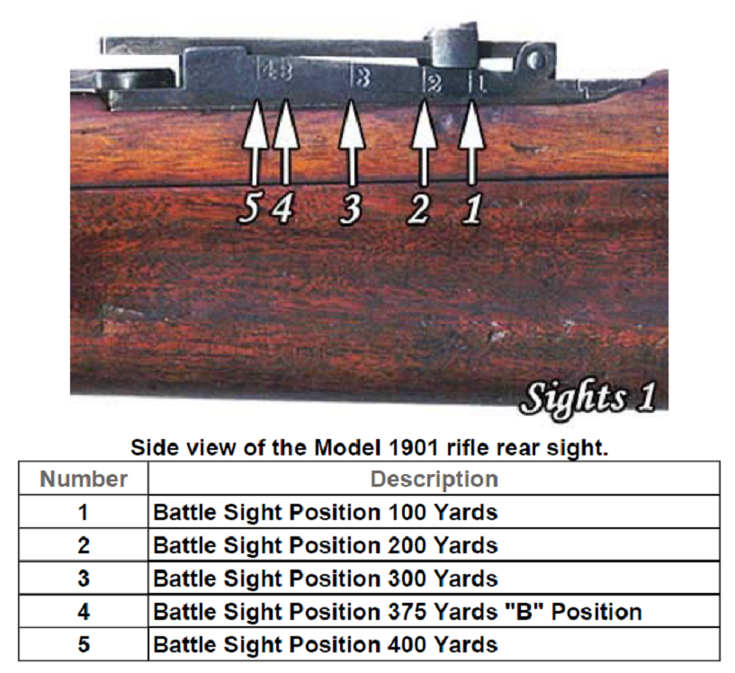

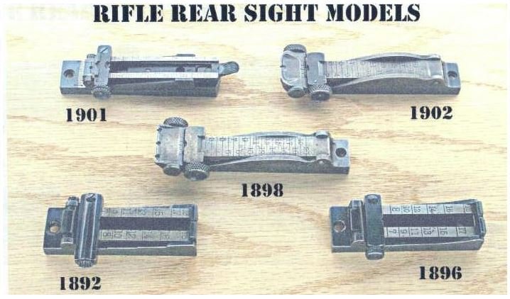

The 1901 Krag rear sight was essentially an upgraded Buffington-style, as installed on 1884 Springfield (Trapdoor) rifles, and retrofitted to some earlier models.  The 1903 Springfield sported a similar sight.
Many years ago I was searching for a Buffington, when my old pard @Palouse sent me a 1901 Krag sight.  It immediately was mounted on my Buffalo Classic and paired perfectly with it's globe front sight.  Literally, TONS of elevation and windage!

For all three of my Buffalo classics in both 45-70 and 38/55 I mounted a krag 1901 carbine sight. It has a ladder and left right adjustment. Also mounted it on my H&R Shakari. I have won ten state long range matches with them seven in Virginia and three in Delaware. You can usually find them on eBay or gunbroker for around $100.

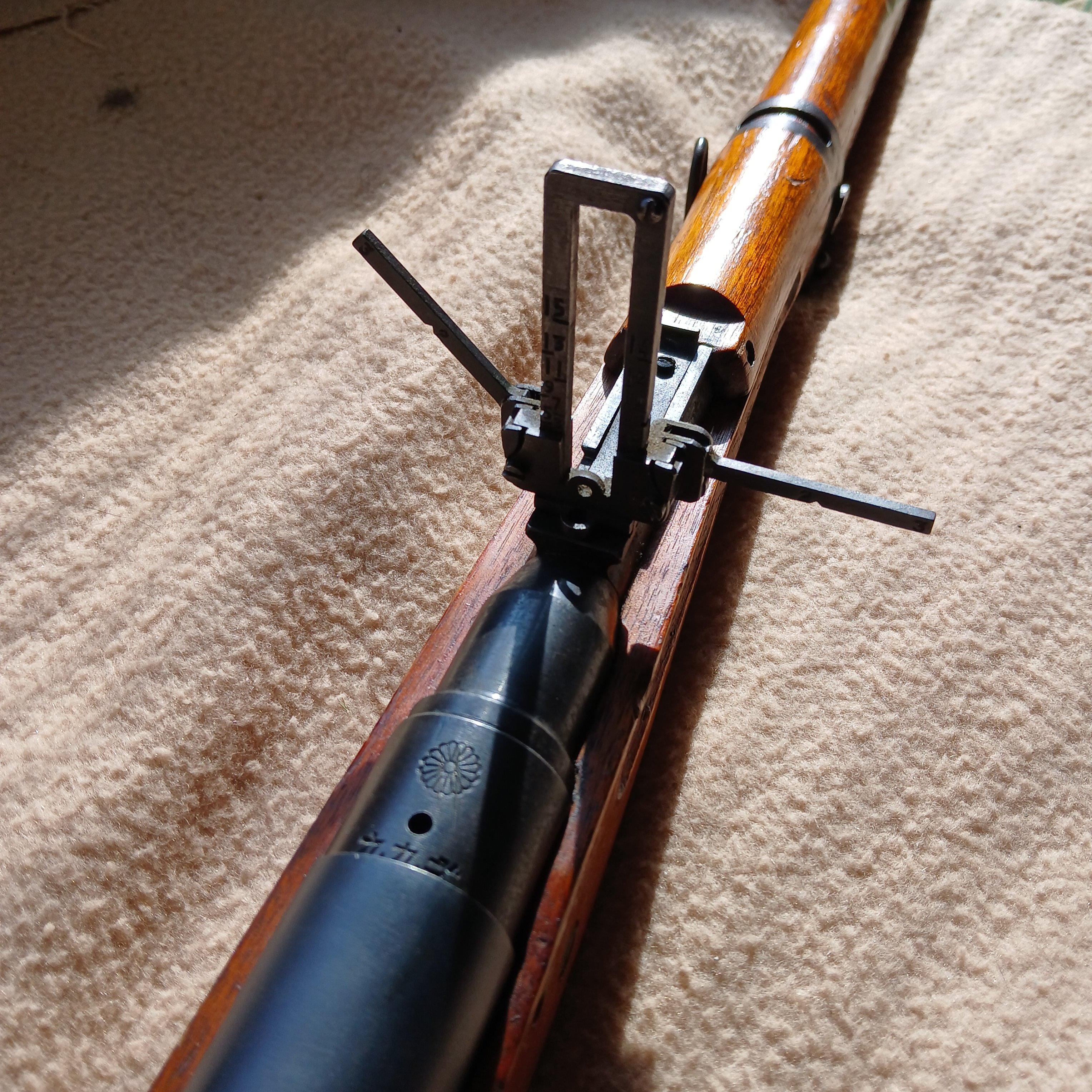

So they anticipated shooting at aircraft.
"Airplane Sights."  :)

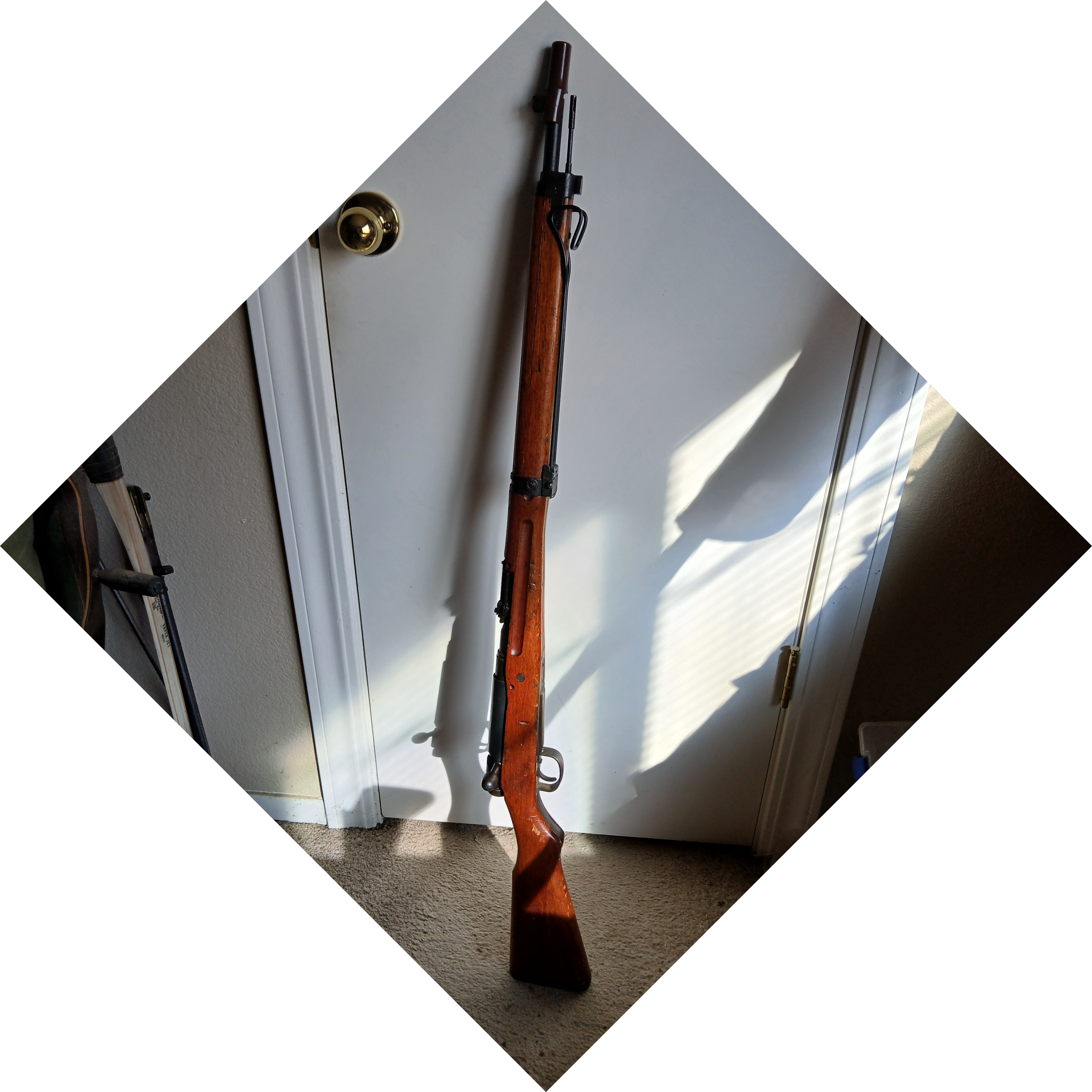

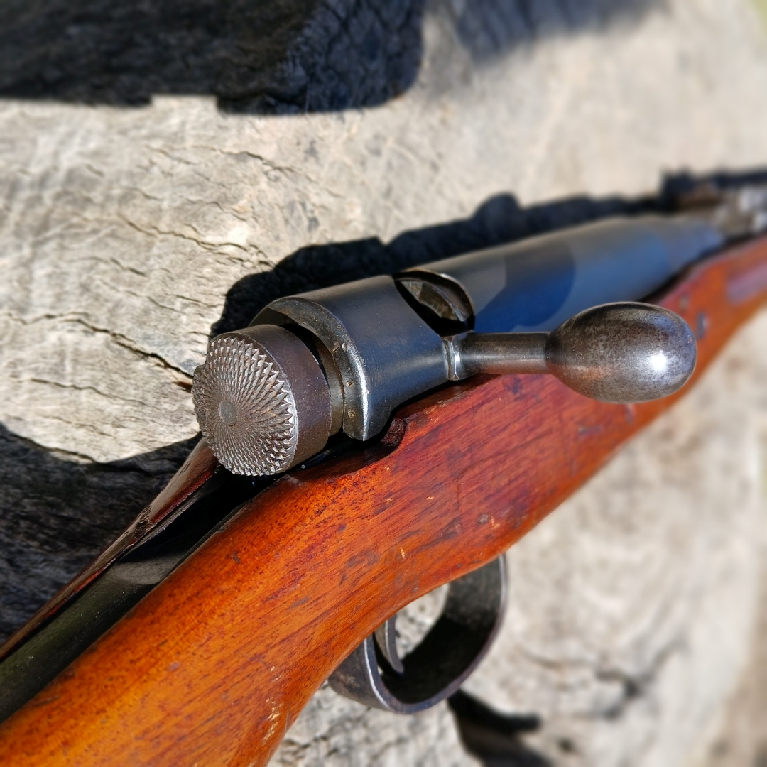

I recovered this Arisaka from my aunt's garage roof in 1971, where it had evidently been lying for years.  Covered in rust, mud, and crud, and ugly as sin.  All moving parts frozen.  Couldn't even give it away, but reluctant to toss it in the trash (or the bay) as some folks suggested.
Set it in a corner; about once a week I'd hit it with either Liquid Wrench or WD-40.  Did this for months.  Then one day, I picked it up, and on a whim whacked the bolt handle.  It moved!  Not much, but there was definitely some give!  So I worked at it, pried the bolt release open with a large screwdriver, and eventually got the bolt out.  Swung it up to look down the bore, expecting to see stalactites of corrosion growing out of huge pits.  Nope.  That was when I learned that the Japanese had SO wisely lined the bores with chrome.  Many hours of work with oil and 0000 steel wool and bronze brushes disclosed that the original bluing was still intact under the chrysalis of petrified grime.
It shoots well - and at a hundred yards, the sights are every bit as accurate as any of my iron-sighted lever action rifles.  But I have NOT tested it on any aeroplanes!  :lol:

i had an arisaka with the aircraft sights and the monopod , it was a good idea but in practical application i dought it worked well , i sold it a long time ago ,
