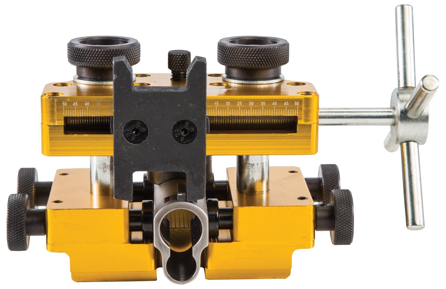

El Vato Posted February 24 Posted February 24 (edited) Hello ladies and gentlemen. Im looking for any recommendations for a front sight tool to remove and replace dovetail sights, specifically on octagon rifle barrels? I don't want to use the brass punch method. Thankyou for your time! El Vato. Edited February 24 by El Vato Misspelling Quote
Sedalia Dave Posted February 24 Posted February 24 Wyoming Sight Drifter Works 1000% better than a hammer and punch. 1 1 Quote
WOODFOX , sass#34179 Posted February 25 Posted February 25 I use a copper punch it won't mark your sight Quote
KingSnake Posted February 25 Posted February 25 I have a Wheeler sight pusher for those times that I don’t just use a brass punch. 1 Quote

Garrison Joe, SASS #60708 Posted February 26 Posted February 26 17 hours ago, WOODFOX , sass#34179 said: I use a copper punch it won't mark your sight Neither will a brass punch, the tool of most professionals I know. A calibrated sight press (like the Wheeler) is handy if you are shooting rifles with a drift sight and need to make precision adjustments at a match without a zeroing session. good luck, GJ Quote

Shawnee Hills Posted February 27 Posted February 27 Seems like Uberti's rifle dovetails are hit and miss with regards to size. I've ran across a few that would not allow the installation of a front or rear sight without widening the dovetail slot on the barrel itself. Filing the base of the sight worked until the sight bottomed out on the top of the barrel. A little work with a dovetail file on the barrel was needed to finish the job. Sedalia Dave is on point with his recommendation. The Wyoming Sight Drifter is a joy to use when working with iron sights. It would not, however, scare the sights on a S&W Shield X. Those must be installed at the factory with a 40 ton press. 1 Quote
