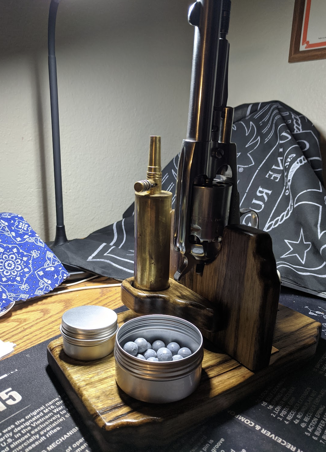

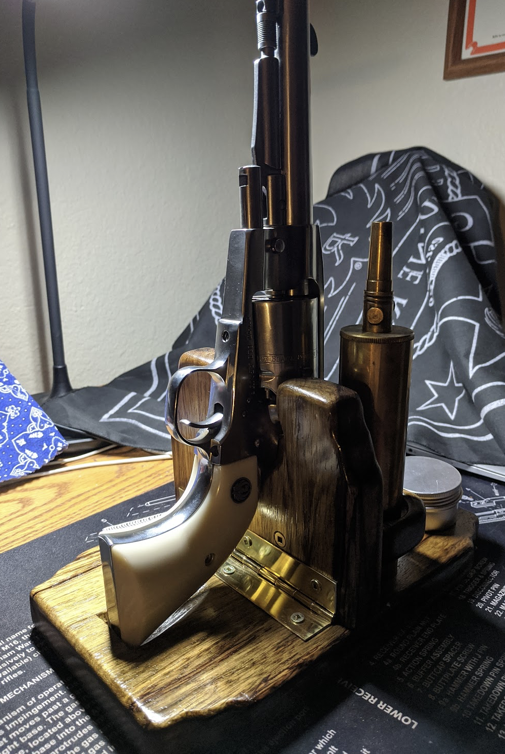

Yul Lose Posted February 19 Posted February 19 Back in 2018 I was going to get into the cap and ball game with this pair of nice engraved Old Armies so I built this loading stand. I got it built and decided cap and ball wasn’t my thing and I never used it. J-Bar ended up with the loading stand. 11 3 Quote

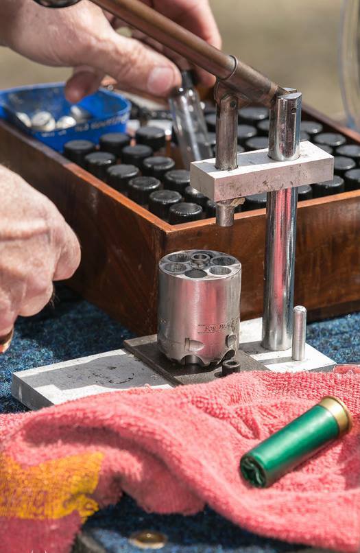

Lucky R. K. Posted February 19 Posted February 19 (edited) This what I use, usually at the unloading table. Everything is home made except for the vials. Lucky 😁 Edited February 19 by Lucky R. K. 1 Quote

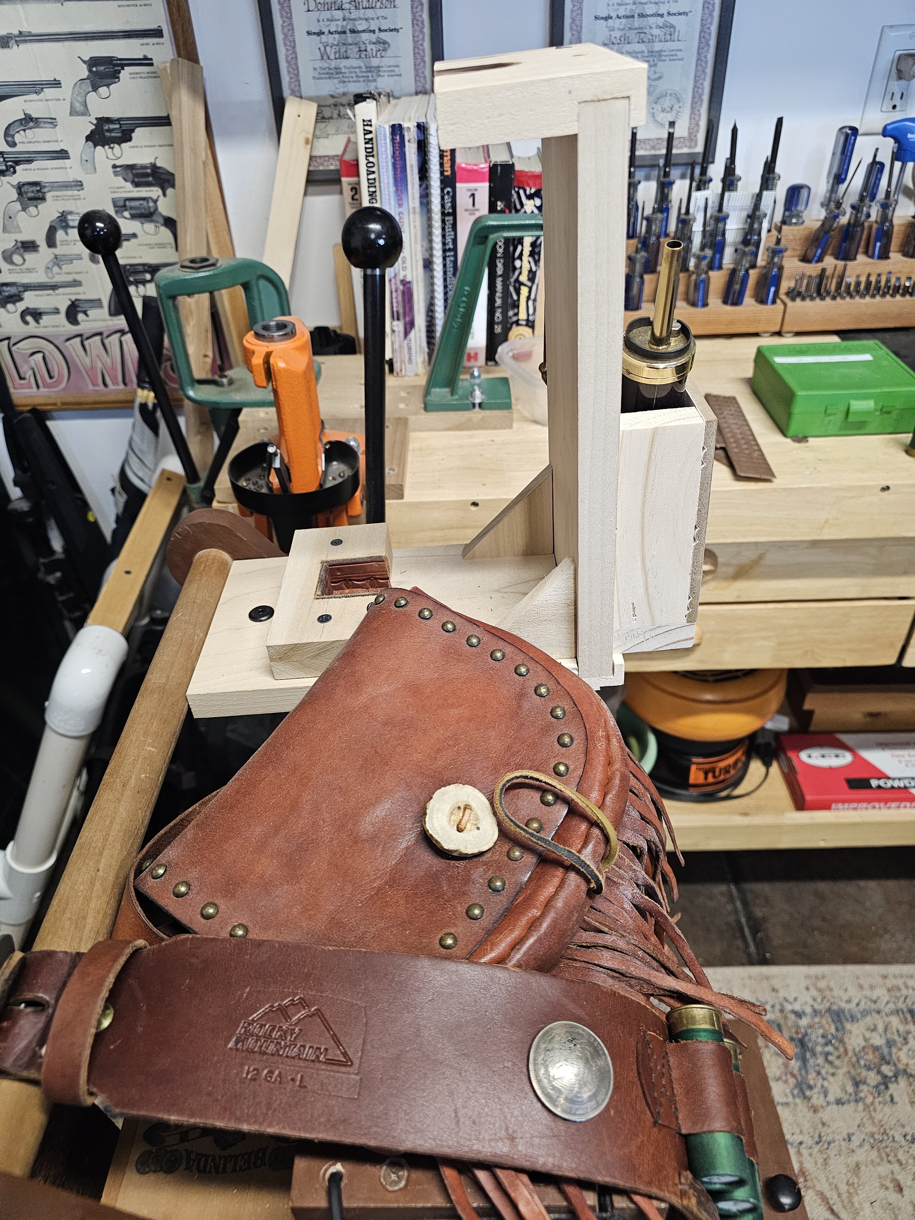

Rustler, SASS #33316 Posted February 21 Posted February 21 (edited) I was fortunate enough to get Yul Lose to create a smaller version of his setup. I have used it at my cart and also the unloading table to charge my Old Army's. Edited February 21 by Rustler, SASS #33316 2 Quote
Wyatt Earp SASS#1628L Posted February 21 Author Posted February 21 Interesting option for cylinder loading off the gun, using a woodworking clamp as a ball seater. Quote
