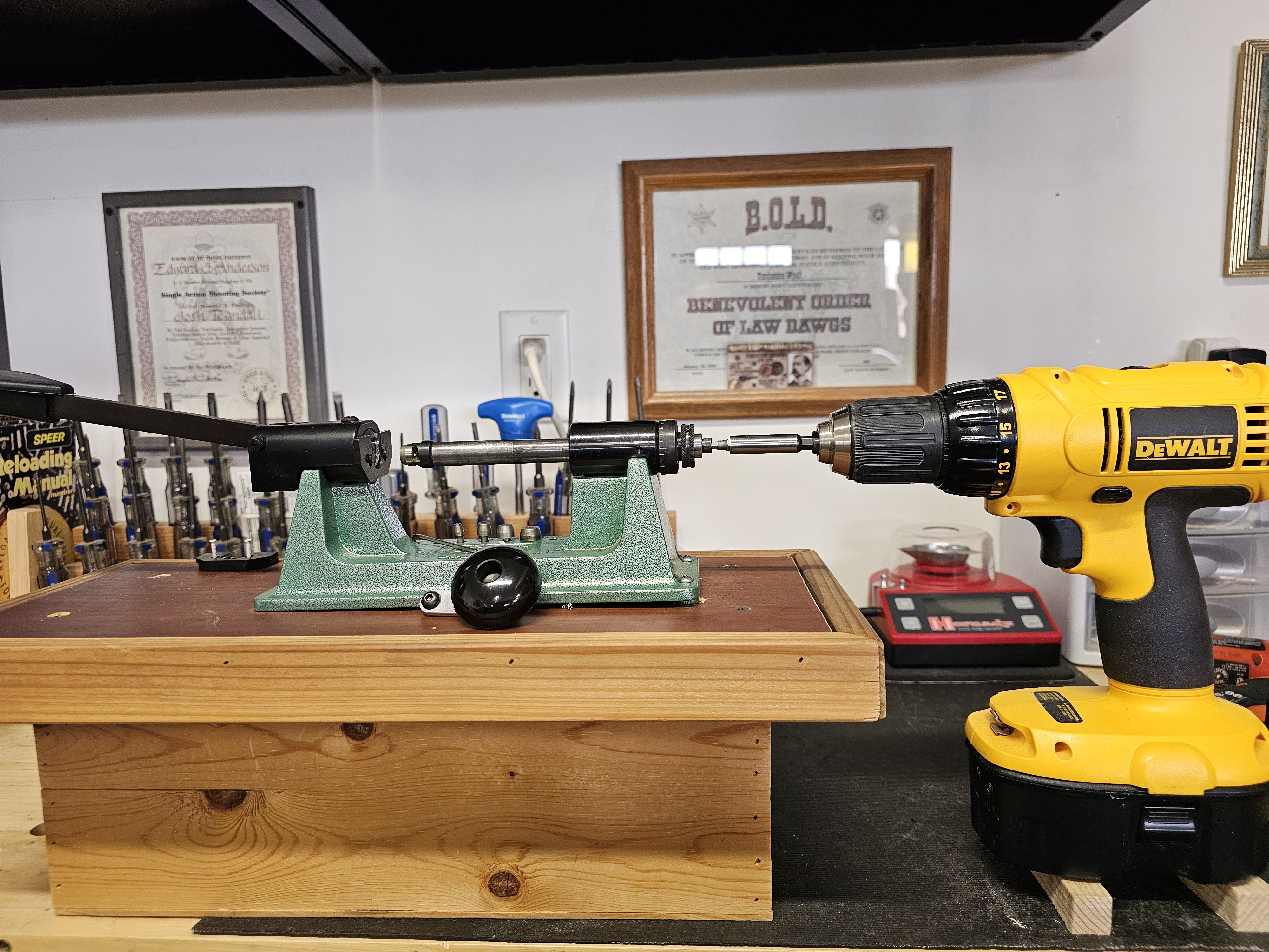

Lucky R. K. Posted February 12 Posted February 12 On 2/10/2026 at 12:18 PM, Old Man Graybeard said: A friend uses a Forstner bit in a drill press to cut 45 colt to 45 cowboy special. He has had pretty good luck that way. Just set the depth adjustment on the drill press This is the method I use also. I stop the cut a few thousands short and finish cutting to length with a Lyman case trimmer. As the Maker of Coffins would say, "it works a treat". Lucky 😁 2 Quote
Eyesa Horg Posted February 12 Posted February 12 (edited) 6 hours ago, Lucky R. K. said: This is the method I use also. I stop the cut a few thousands short and finish cutting to length with a Lyman case trimmer. As the Maker of Coffins would say, "it works a treat". Lucky 😁 How are you holding the brass when using the drill press/first er forstnerbit combo? Edited February 12 by Eyesa Horg Fricken otto 1 Quote
Lucky R. K. Posted February 13 Posted February 13 20 hours ago, Eyesa Horg said: How are you holding the brass when using the drill press/first er forstnerbit combo? I take the shell holder off the Lyman case trimmer and mount it onto the table of the drill press. I set the depth of cut with the stop on the press and cut the brass down. Then I camphor the mouth. I have made pilots for 38, 44, and 45 calibers that screw into the end of the cutter. You can trim a bunch of brass in no time. I will try to get a picture the next time I trim any brass. Lucky 😁 2 1 Quote

Colorado Coffinmaker Posted February 15 Posted February 15 Well, not quite. Many Lustrum ago, During the time frame Adirondack Jack and I were developing short .45s, cutting down 45 Colt and 45 Schofield (I did Schofield) to 45 ACP length was the only way to get those short cases. Very time consuming. I used my Lathe and a Forster Case Trimmer (for 'lectric drill motor). I made several thousand. Boring. Then AJ went to Starline to ask for a commercial version. Starline said OK, but that custom head stamp is gonna cost ya. AJ took a great leap of faith and agreed, bought FIFTY THOUSAND cases stamped Cowboy 45 Special. Gambled he could sell enough to at least break even. AJ was successful and ordered another batch. Then Medical problems reared an ugly head and AJ sold the business. Starline continues to produce the Cowboy 45 Special to this day. AJ also developed the Carrier Block for the Toggle Link Rifles in concert with Bill English of the Smith Shop as well as designed the .45 Barnstormer Bullet. ALL of which are great additions to Our Game. With the C45S commercially available, I would never again spend that kind of time to make those cases DIY. Doesn't make good sense (to me anyway). I haven't talked to AJ in several years. Wonder how he's doing these days. 1 1 Quote

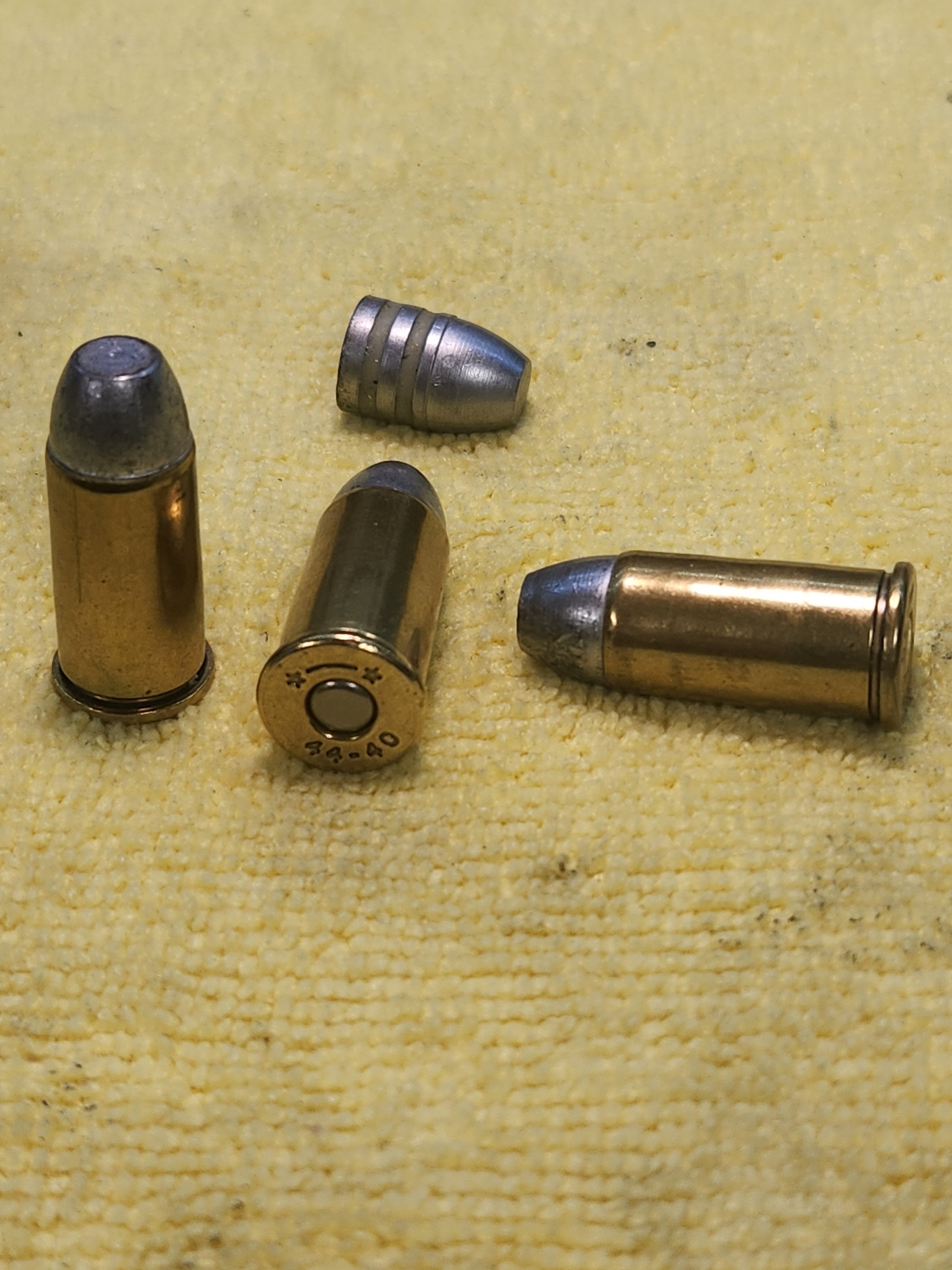

Long Gulch, SASS #53035 Posted February 17 Posted February 17 On 2/15/2026 at 10:30 AM, Lucky R. K. said: The process would be the same but, why would you want to cut down 44/40 brass? Lucky 😁 Ta make .44 Cowboy Short. (Thanks to and inspiration from Springfield Slim.) Quote
Griff Posted February 17 Posted February 17 Forgive my ignorance, but would those be shot from a .44-40, or? Quote
Long Gulch, SASS #53035 Posted February 17 Posted February 17 50 minutes ago, Griff said: Forgive my ignorance, but would those be shot from a .44-40, or? Yes 44WCF. 185 or 210 (pictured) grain bullet seated to approximately 1.20 inch OAL for use iin rifle with The Smith Shop's modified carrier. Works good in rifle and revolver. Quote
Yul Lose Posted February 17 Posted February 17 15 minutes ago, Long Gulch, SASS #53035 said: Yes 44WCF. 185 or 210 (pictured) grain bullet seated to approximately 1.20 inch OAL for use iin rifle with The Smith Shop's modified carrier. Works good in rifle and revolver. I’m going to try some of those in my Lightning rifles, what case length do you use? Quote
Long Gulch, SASS #53035 Posted February 17 Posted February 17 I am using 0.900 inch simply because that length works in my toggle link carbine with the modified carrier from The Smith Shop. You may have to experiment with the Lightning rifle. I resize as usual and then use a .44 Russian sizing die to neck resize. Use the distance from the point of crimp to the bullet base for the measurement to neck size. Neck sizing is needed because the shortened brass at this point will not retain a .427-430 diameter bullet. Expand the case mouth just enough for a good bullet start. Since this round retains some taper it will seal the chamber and keep the carrier area relatively clean. The bullet in the picture I posted is 210 grains from a Lyman mold that I use only for blackpowder and is crimped ahead of the front driving band. I shortened a Lee die in order to get a good crimp. The outcome of all this is a cartridge OAL similar to 44 Russian. For smokeless I used Hogdon's 44 Russian data as a guide. 1 Quote
