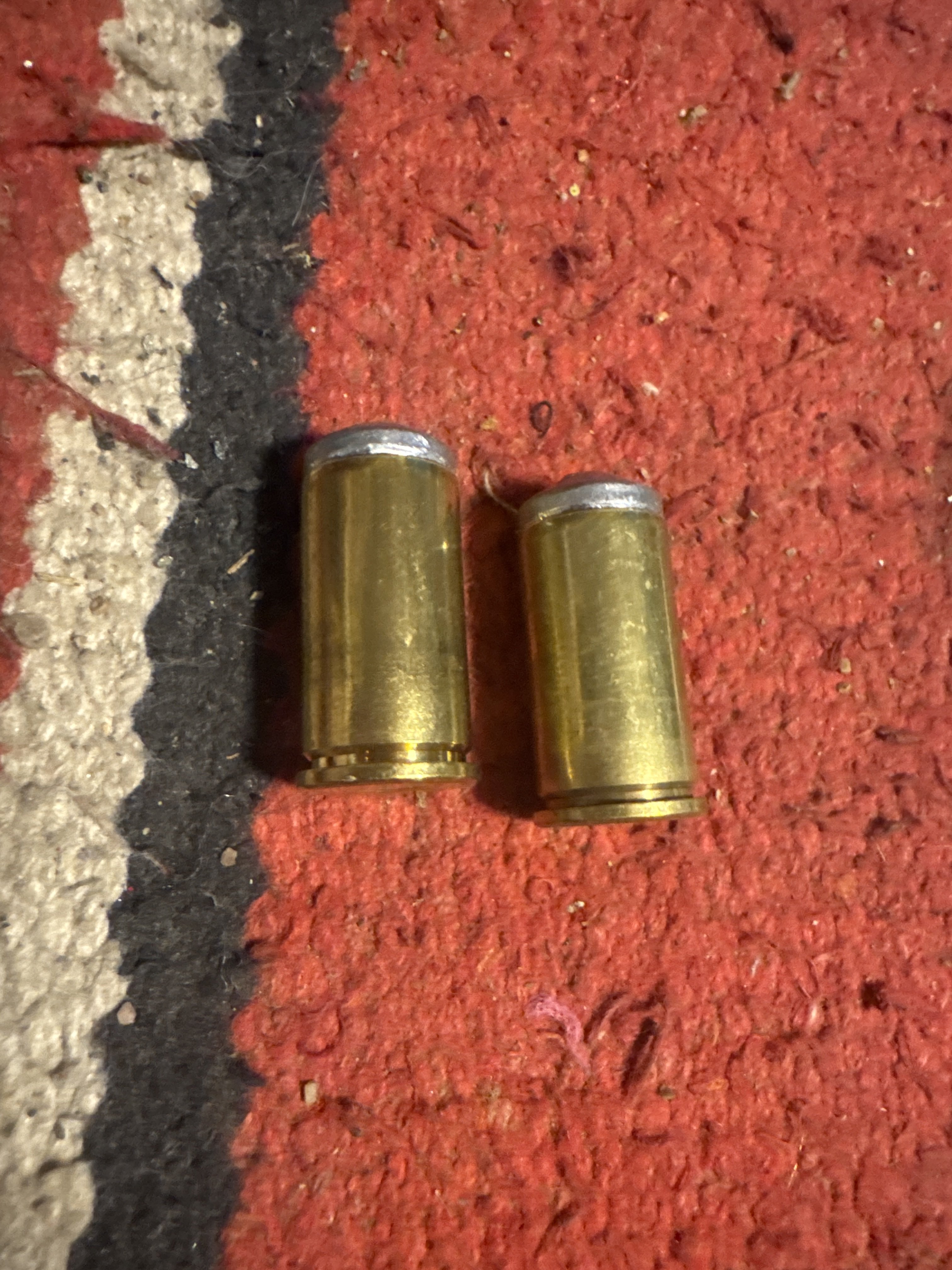

Tall John Posted March 8 Posted March 8 Ok boys next question. While it’s been made clear to me that OAL isn’t that important with the C45S, where do you seat your 130 grain Barnstormers? the American Cowboy, Cowboy Special Commercial rounds are 185 grain LRNFP bullets and loaded to 1.755-6” OAL. A club mate loads their 165grn to 1.102” the 130 grain Hollow Base Barnstormers have two canelures or grooves. If I seat/crimp to the: Bottom groove, OAL is around 1.70” The middle band, OaL is 1.40” The top groove, OAL is around 1.059” I’m now planning on using Trail Boss for these loads! where would you seat? Quote
Leroy Luck Posted March 8 Posted March 8 All the pictures I’ve ever seen of the barnstormers loaded look exactly like the one of the far left. The 2nd groove. Pictures from previous posts on the Wire through the years. 2 Quote
Cemetery Posted March 8 Posted March 8 7 hours ago, Leroy Luck said: All the pictures I’ve ever seen of the barnstormers loaded look exactly like the one of the far left. The 2nd groove. Far left for me as well. 1 Quote
Colorado Coffinmaker Posted March 8 Posted March 8 As originally designed, the "top" groove is intended as the crimp groove. The lower groove was intended as a lube groove and the original Barnstormers, as cast and supplied by AJ, had the lower groove carrying Lube. On all the Barnstormers I have loaded, I seat to the topmost groove and crimp into what was intended to be the crimp groove. Overall length of Cowboy 45 Special is meaningless. Where to crimp is basically based on the design of the bullet regardless of propellent choice. 2 Quote
Gateway Kid SASS# 70038 Life Posted March 8 Posted March 8 Another vote for the far left cartridge. That is what the ones I loaded for my wife looked like. 1 Quote
Eyesa Horg Posted March 8 Posted March 8 I'd go for the crimp groove as well. The one in the very left. 1 Quote
Griff Posted March 8 Posted March 8 2 hours ago, Colorado Coffinmaker said: As originally designed, the "top" groove is intended as the crimp groove. The lower groove was intended as a lube groove and the original Barnstormers, as cast and supplied by AJ, had the lower groove carrying Lube. On all the Barnstormers I have loaded, I seat to the topmost groove and crimp into what was intended to be the crimp groove. Overall length of Cowboy 45 Special is meaningless. Where to crimp is basically based on the design of the bullet regardless of propellent choice. Right... again! LOL! 1 Quote
