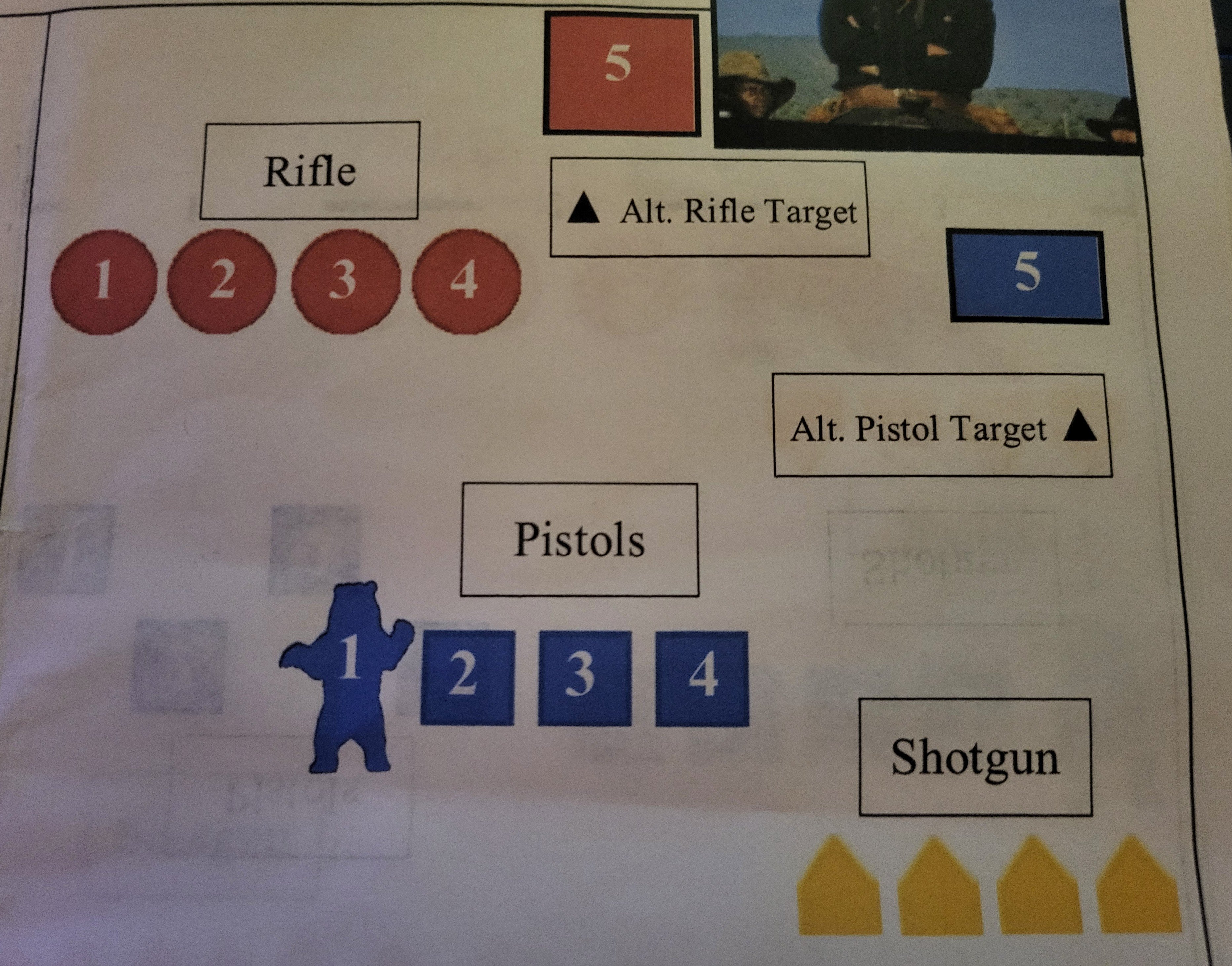

Nostrum Damus SASS #110702 Posted February 1 Posted February 1 (edited) Equipment: Rifle -- 10, on table at leftmost of three positions (Position 1) Pistols -- 5+5, holstered Shotgun -- 4+, on table at rightmost of three positions (Position 3) Targets: Rifle at Position 1: 4 targets at rifle distance, a 5th target at about twice rifle distance Pistol at Position 2: 4 targets at pistol distance, a 5th target at rifle distance Shotgun -- 4 KDs at shotgun distance Instructions: At the buzzer -- With rifle, triple tap the first three targets, then with 10th round shoot EITHER the 4th target at rifle distance OR the 5th more distant target; a hit on the more distant target earns a 5 second bonus; a miss on either the 4th or 5th target is a MISS. THEN ... With pistols, similar to rifle instructions, triple tap the first three targets, then with 10th round shoot EITHER the 4th target at pistol distance OR the 5th more distant target; a hit on the more distant target earns a 5 second bonus; a miss on either the 4th or 5th target is a MISS. THEN ... With shotgun, knock 'em down, any order. Earning BOTH bonuses is allowed. Black powder Shooter starts his smoky string at Position 1 and correctly shoots his rifle and earns a 5 second bonus, and having raised a huge cloud of smoke, he moves to Position 2. He shoots his first pistol correctly (1-1-1-2-2), holsters it, and then with his second pistol shoots 2-3-3 and then the more distant target with his NINTH round (having only double tapped the third target; he holsters his revolver with the hammer down on the spent case. He moves to Position 3 and knocks 'em down, and then gathers his long guns and proceeds to the unloading table where he discovers a live round in his second pistol. (By the way, the TO thought only four rounds were shot with the second pistol, but when he asked the counters about it, none of them noticed it so the TO assumed he was mistaken when, in fact, all three counters just missed it.) What's the call? A miss? A procedural? A miss and a procedural? And does the shooter get 1 bonus or 2? ND Edited February 1 by Nostrum Damus SASS #110702 Quote
Garrison Joe, SASS #60708 Posted February 1 Posted February 1 (edited) A P when the 9th revolver round did not get shot on the last of the triple-tap targets, and a miss for not firing the 10th round. I'll say no bonus earned for the revolver set, as the bonus could only be earned by firing the tenth round (and that shot hitting the distant revolver target). So, P and a miss (for round not fired). And only the bonus for the rifle set can be awarded. good luck, GJ Edited February 1 by Garrison Joe, SASS #60708 13 Quote
Nostrum Damus SASS #110702 Posted February 1 Author Posted February 1 OK, I need to write the instructions EXACTLY because someone thinks it makes a difference. Here is what it says, exactly, next to the illustration seen below. If this means something other than what I wrote above, what does it mean, exactly -- in other words, what is the difference? Also, does the following statement on p.21 of SHB ver. 28 have anything to do with this situation and, if so, how and why? "Double Jeopardy applies -- a miss cannot cause a procedural. To help understand this concept, please reference the Miss Flow Chart in Section 7 of this handbook." ATB POS 1: Rifle 1-1-1-2-2-2-3-3-3-4 or 5* *Shooter may engage either T-4 OR T-5 alt. target. (T-5 is worth a 5-second reduction in time. Either T4 or T-5 target must be engaged. A miss on T-4 or T-5 target is a miss. POS 2: Pistols Same as rifle but using Alt. Pistol target. POS 3: Shotgun Any Order Quote
Major BS Walker Regulator Posted February 1 Posted February 1 Just 2 misses no P. 9th round missed the 4th target. One miss for unfired round. Quote
Griff Posted February 1 Posted February 1 (edited) A "P" for hitting the #5 target out of order and a 5 second penalty for not firing 10 pistol rounds. And yes, only getting the rifle Bonus. The intent of the shooter is impossible to discern. So the only call to be made is what happens. Ergo, whether the shooter missed target 3 with the 9th shot or intended on hitting target 5 is immaterial. The fact remains that he hit target 5 with that 9th shot, clearly out of sequence, ergo, the "P". Since target 5 was a pistol target it still counts as a hit, but by not firing a tenth round, the shooter earns a 5 second penalty for not firing 10 pistol rounds. Which is the same as a miss. As for a bonus on the 5th target, I wouldn't award it as it was hit out of sequence. Whether stated or not, it was implied thru the instructions that to earn the bonus you must have fired all 9 rounds on targets 1-3. Edited February 1 by Griff 6 Quote
Garrison Joe, SASS #60708 Posted February 1 Posted February 1 The instructions as printed in the stage instruction sheet seem to me to say exactly what you wrote in the OP. No difference in the target order, the round counts, or the requirement needed to be awarded a bonus. "A miss cannot cause a procedural" - this "shorthand" rule of thumb is not applicable here. The P was earned by the 9th shot being placed on a target other than the one specified (target #3). When the shot #9 was fired at target #5, that was the P. The "round not fired counts as a miss" is due to the 10th round found in the revolver at the unloading table. good luck, GJ 6 Quote

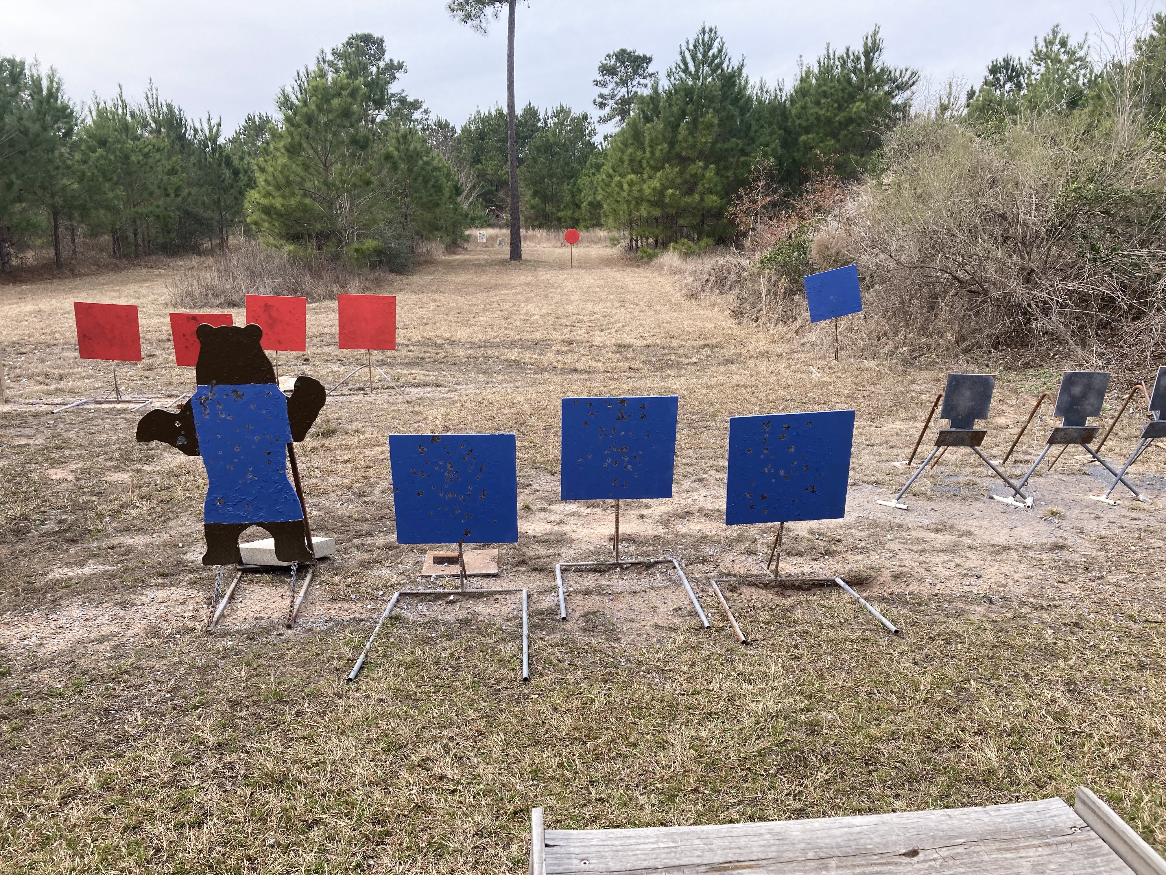

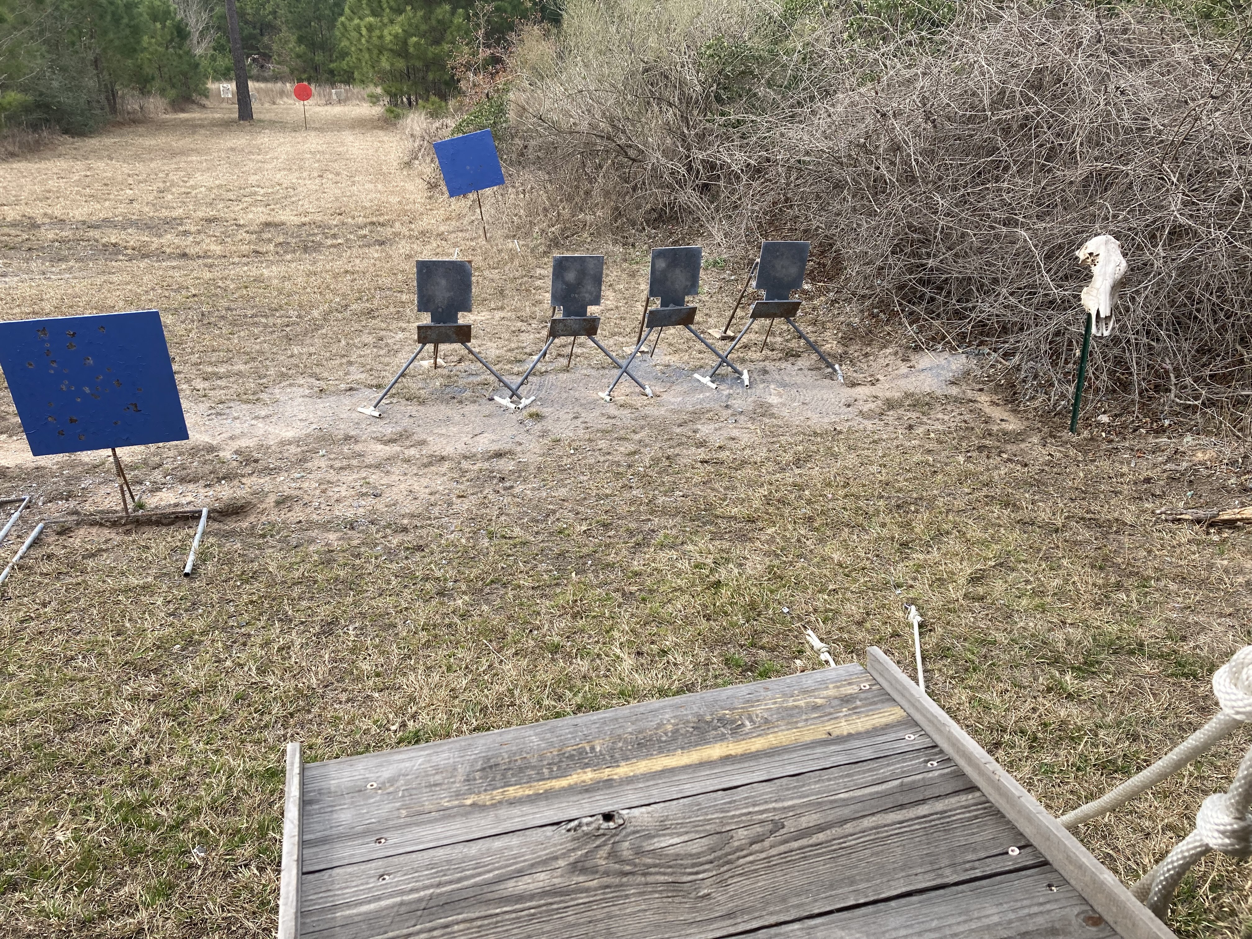

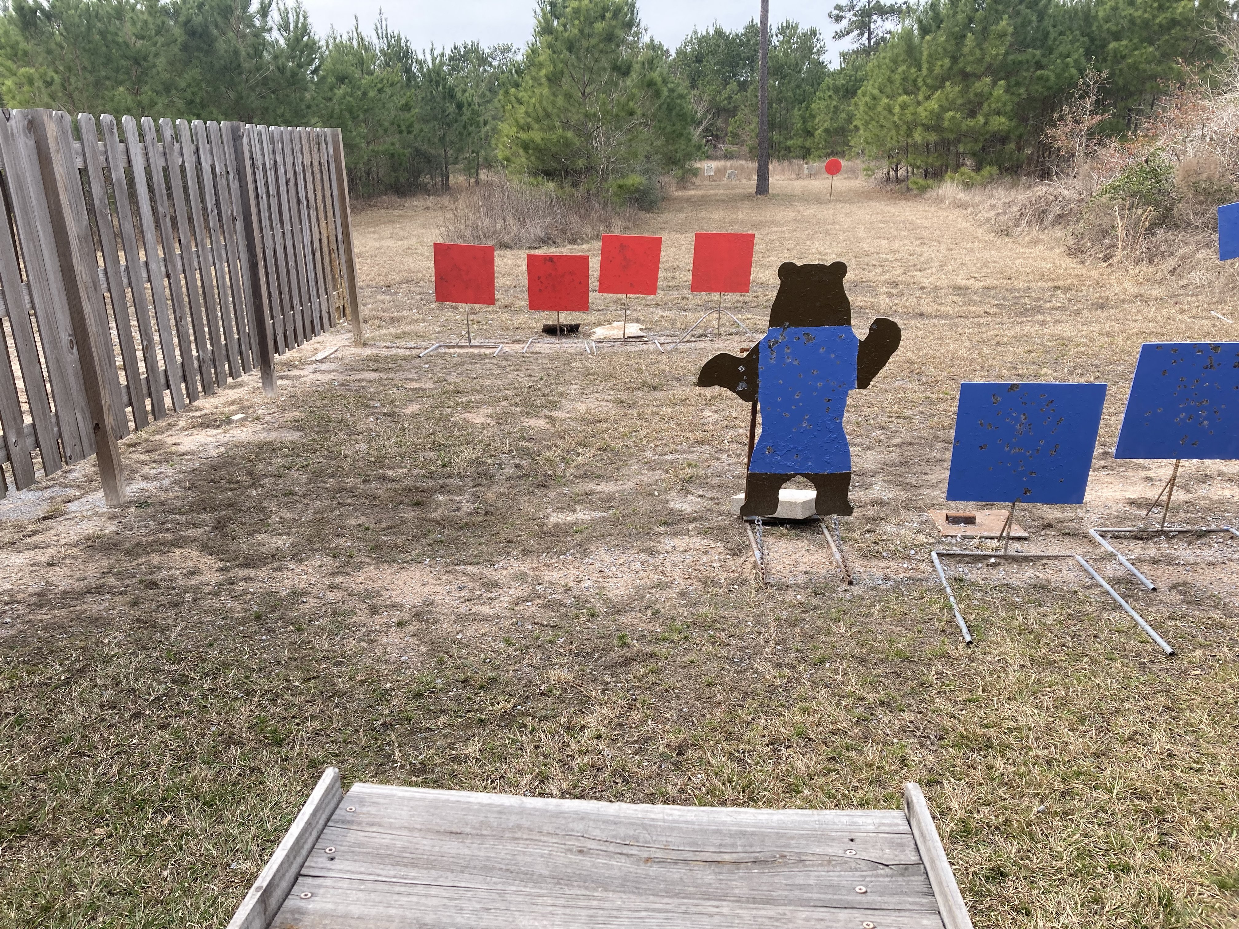

Cowtown Scout, SASS #53540 L Posted February 3 Posted February 3 Just so folks can see the actual targets on that stage here you go. By the Way I hit both alternate targets and thus gained the bonus reduction time for both. Rifle Targets Pistol Targets Shotgun Targets 2 1 Quote
