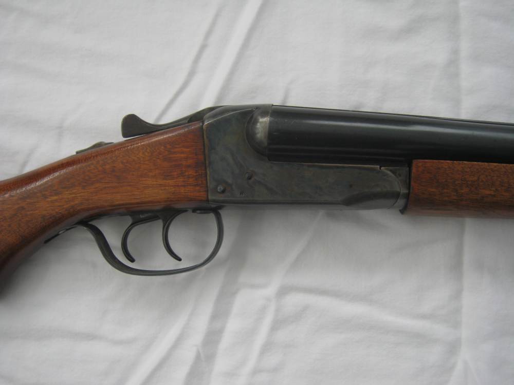

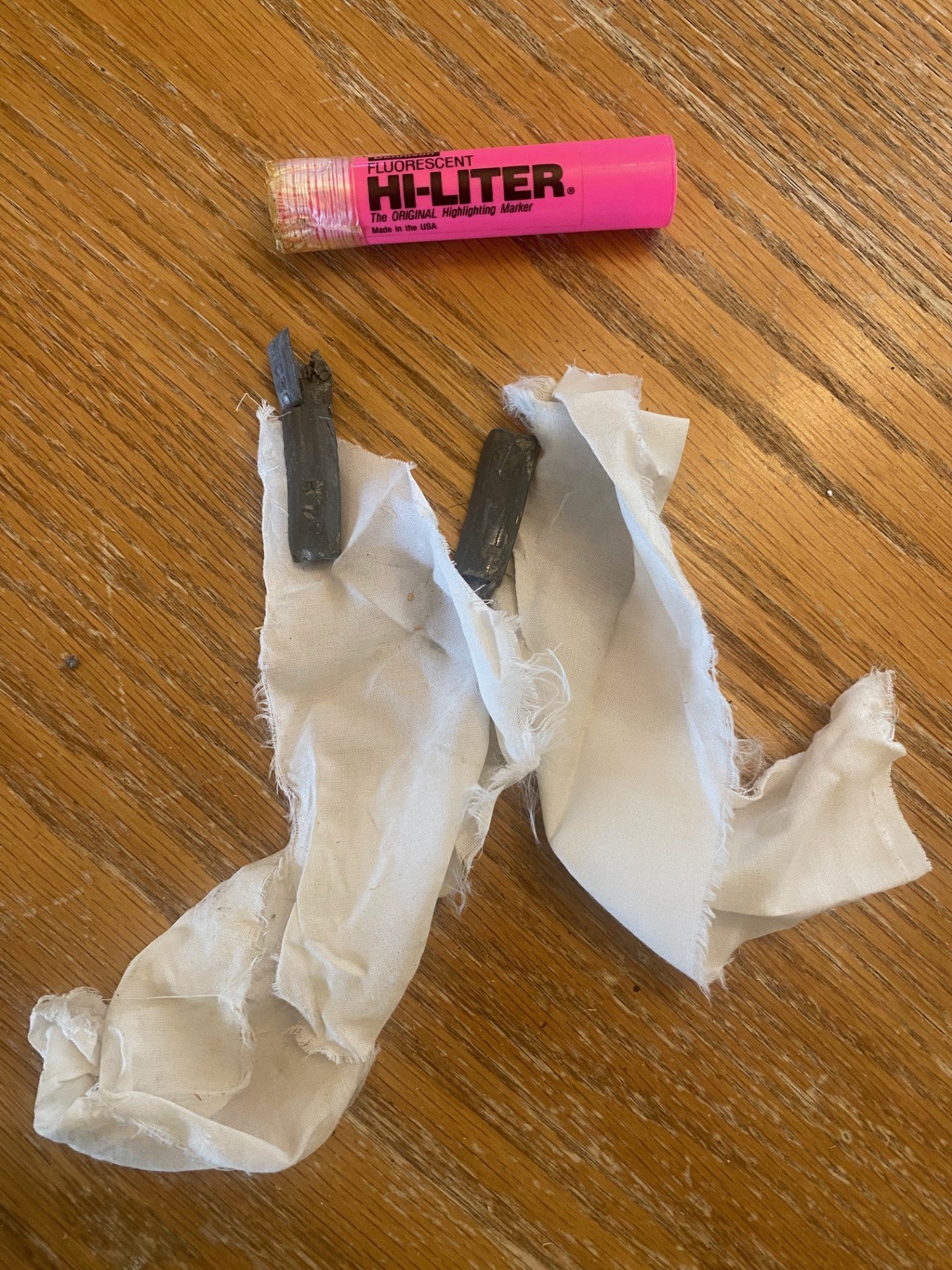

Cyrus Cassidy #45437 Posted January 19 Posted January 19 (edited) I bought a Sevens 311 on Gunbroker. If you've been paying attention, you know I've become a complete 16 gauge cult member, so this is a venerable 16 gauge. The chokes are modified (right) and full (left). As you can see in one of the photos, the right firing pin was stuck and would not retract. I looked this up on YouTube and it's a somewhat known phenomenon, usually caused by dry firing. But there is a fix, so because the rest of the gun looks to be in great condition I took the risk and bought it. Anyway, I finally picked it up and brought it home. I followed what I learned from YouTube to disassemble the gun and polish up the firing pin and its associated hole. As expected, it was a LOT more challenging than the video maker made it seem, but I got it done. I haven't done any live fire testing because I'm leaving the country tomorrow, but I put some primers into empty shells with my reloader and test fired it that way. It works fine, and the firing pin retracts as it should. What made me post, however, was the wild stuff I found inside the stock when I went to disassemble it. The highlighter is full of lead shot, probably as a recoil absorber. The other two things are fragments of wheel weights (these went into my melt bucket to become bullets!), wrapped up in what seems to be old bed sheets or pillow case material. I've heard tons of stories about people taking apart old guns and finding $20 bills, etc., but this was plain weird. Edited January 19 by Cyrus Cassidy #45437 2 2 Quote
