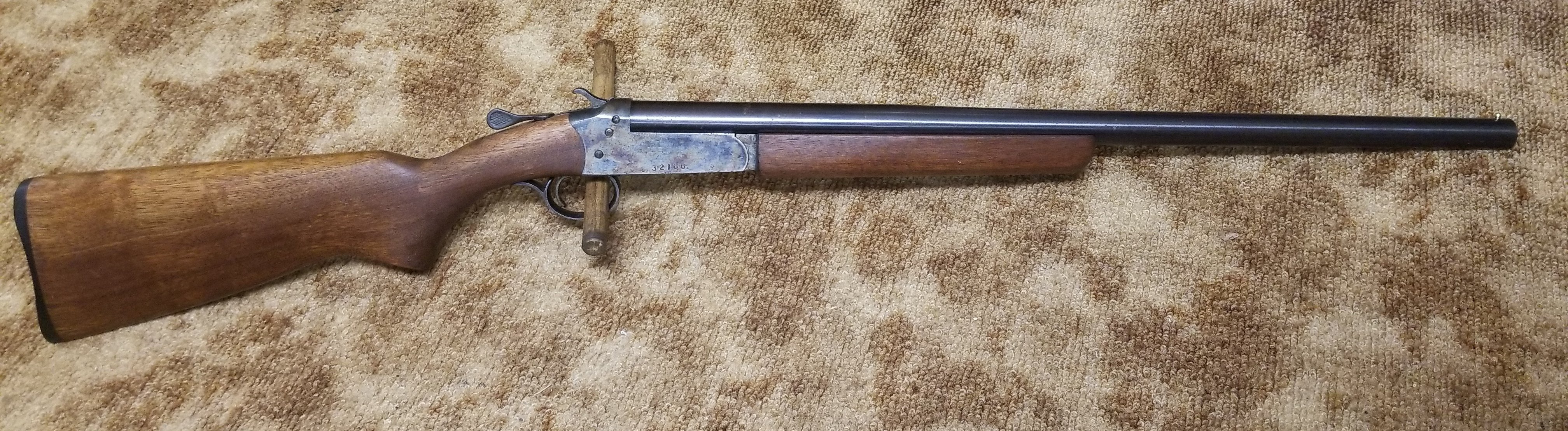

"Big Boston" Posted January 16 Posted January 16 I have a single shot 12 ga. I has a 3" chamber. I've tried to shoot BP shells in it but am thwarted by the amount of crud that is left in the barrel. I had chalked it up to my ammo or just the nature of the beast, but the other day it occurred to me that the issue may be with the wads/cards not sealing properly as they jump the gap. I'm considering sourcing some 3" shells, but before I do, I'll ask for for insite here. Could the 3" chamber be the issue? BB Quote
