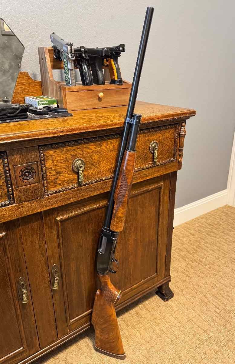

Wild Eagle Posted January 12 Posted January 12 The image below is a picture of a shotgun being sold as a Winchester model 12. I have never seen a model 12 with anything other than a "corncob" forend. Is this gun legal for Wild Bunch? Quote
Two Dot, 14911 Posted January 12 Posted January 12 That appears to be a model 12. Model 12s are not required to have the corn cob forend. In fact, none of my competition model 12s have one. 2 1 Quote
Garrison Joe, SASS #60708 Posted January 12 Posted January 12 (edited) Looks to be PERHAPS a Black Diamond grade Model 12. But I don't see the inlaid black diamond in the grip area. Anyway, pretty fine woodwork on it. That would explain the long fore end, skip checkering on butt and a grip cap. Definitely a higher grade model 12. And it is NOT a Model 25, since this one has the take-down barrel. Nor is it a featherweight Model 12. Might want to post up the serial number (with last three digits starred out). And any markings on the barrel. Make sure it is not marked as a 3" chambered Duck Gun. Those are hard to run in Wild Bunch because they are tuned to run 3" shells. good luck, GJ Edited January 12 by Garrison Joe, SASS #60708 1 1 Quote
J.D. Daily Posted January 12 Posted January 12 From the Wild Bunch Shooters Handbook: "The Winchester model 1897 and model 12 pump in 12 gauge, civilian or military style are allowed." 1 Quote
watab kid Posted January 12 Posted January 12 MOD 12s where made in a variety of grades and intended uses , it looks a trap/sporting clays model to me , a bit to nice to just be a duck gun or upland field gun although it could be , i had a much later mad 1200 as a kid that was for upland game - pretty but not as pretty as that one 2 Quote
Three Foot Johnson Posted January 12 Posted January 12 That must have been a higher grade with the fancy wood, pistol grip, grip cap, & checkering. Standard pointed checkering on the fore end and skip checkering on the pistol grip seems odd to me, but maybe it wasn't uncommon. 1 Quote
Boggus Deal #64218 Posted January 12 Posted January 12 Yes, it’s legal. Looks like a standard grade gun that had fancy wood added at some point. A factory high grade gun would likely have had a rib. 3 1 Quote
