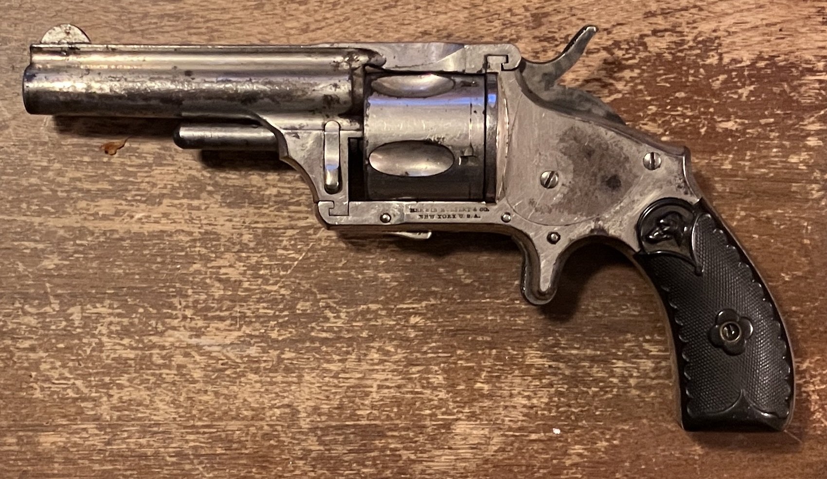

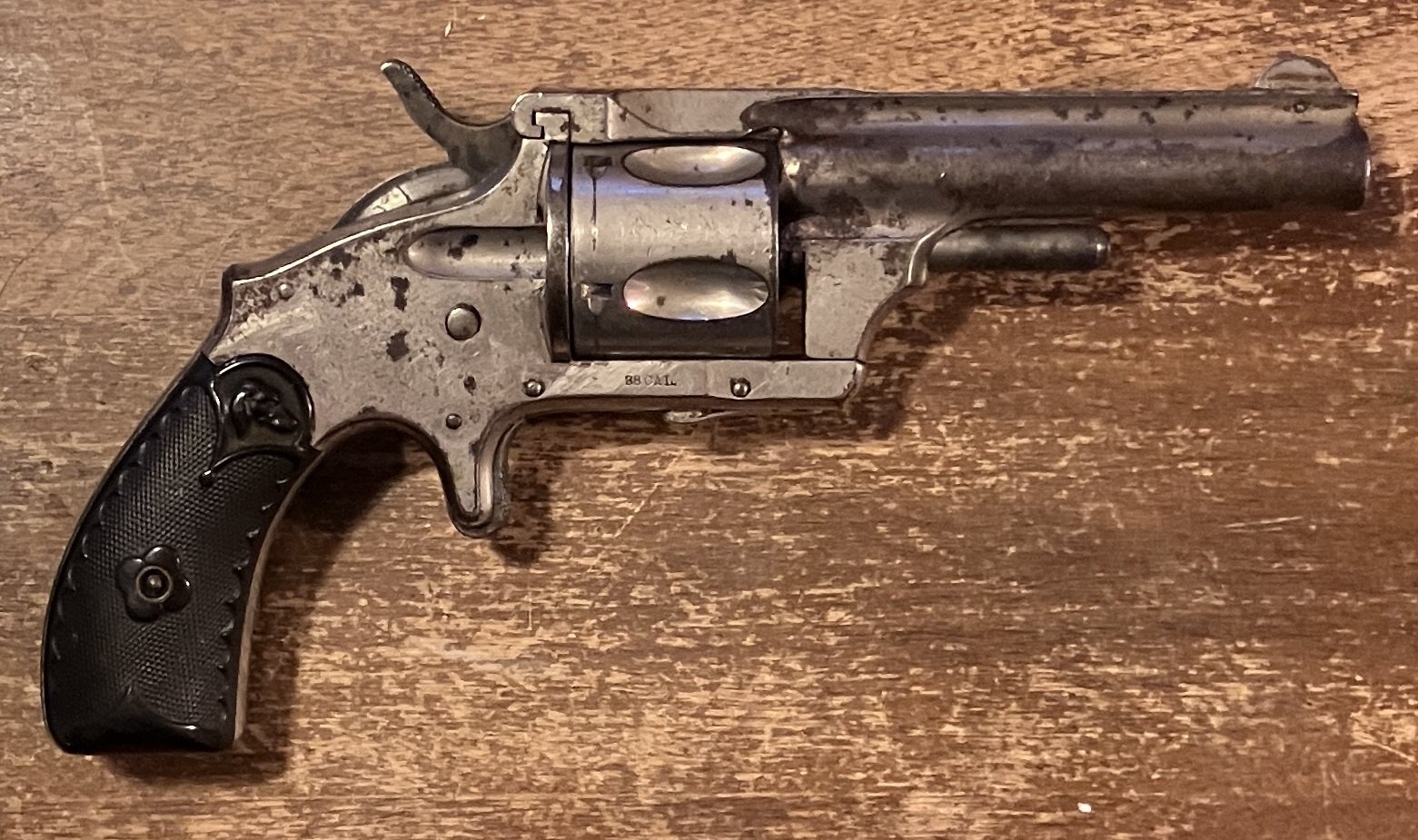

H. K. Uriah, SASS #74619 Posted January 11 Posted January 11 I have this Merwin & Hulbert in my collection. Mechanically, this gun works exactly as it should, and is a very nice shooter. Caliber is .38 S&W, and this is the gun that started my interest in that chambering. But as you can see, it is rather ugly. I have made no decisions yet, but I have recently been thinking of having it restored. I contacted Turnbull, but they don't do nickel refinishing. I'm wondering if there is anyone out there who does. And of course, who can do it right. I don't wanna have the markings all scrubbed away, for example. Obviously, I am not looking for a simple "refinish" but a proper restoration of the finish. Any suggestions? Quote
Rip Snorter Posted January 11 Posted January 11 Pretty rough for a refinish - you want what you want. If I were you I'd keep an eye out for a better example, maybe one that doesn't need a refinish. Quote
Earl Brasse, SASS #3562 Posted January 11 Posted January 11 Thoughts... It's yours' but I'm with Rip. Super clean examples come up they hold their value & increase the most. With the money you have in it plus the cost of an actual "restoration" you may well exceed the price of a fine original. A restored gun is just that, the "collectors" won't value it for as much as you paid as it isn't original & the "shooters" won't either as it's nicer than they want to pay for. Save your money up, buy a "looker" & keep this one as a "shooter". 1 Quote
H. K. Uriah, SASS #74619 Posted January 11 Author Posted January 11 I should point out that this gun was obtained for free. Many years ago, my father was helping a lady clean out her house, and this was found in a drawer. Lady wanted it gone, so Dad took it off her hands. To be honest, I have seen other examples that look fantastic on the market, and I was shocked at how expensive they are! I had no idea that these old M&Hs were so valuable. But seeing some images of ones that still look factory new had me wondering about getting this little guy fixed up right. That's shy I contacted Turnbull. But they don't do nickel anymore. Believe me, this is all very much in the "research" phase. If it's too expensive to redo it, I'll probably not do it. I guess nickel refinishing is actually more complicated that bluing/case hardening. That being said, I was wondering if there is anyone out there that specializes in it. It's good to have projects under consideration. 1 Quote
