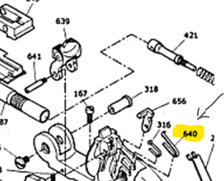

Injun Ryder, SASS #36201L Posted January 14 Posted January 14 My guess would be that the stud latch spring may be damaged/broken. The latch should be a little stiff to pull back. If it is easy to pull back, there is a problem with the spring. If it is a Uberti, see the schematic below (part #640). VTI gunparts may have them. S&W PC 2000 Schofields have a different spring setup and may be available from S&W.
theperson Posted January 14 Author Posted January 14 3 minutes ago, Injun Ryder, SASS #36201L said: My guess would be that the stud latch spring may be damaged/broken. The latch should be a little stiff to pull back. If it is easy to pull back, there is a problem with the spring. If it is a Uberti, see the schematic below (part #640). VTI gunparts may have them. S&W PC 2000 Schofields have a different spring setup and may be available from S&W. i had a similar thought, so i opened it up to see any damage/weakening in the spring, and to me the spring still seemed pretty stiff, it may potentially be weaker than it should be, so i may as well order another spring, thank you for your help!
