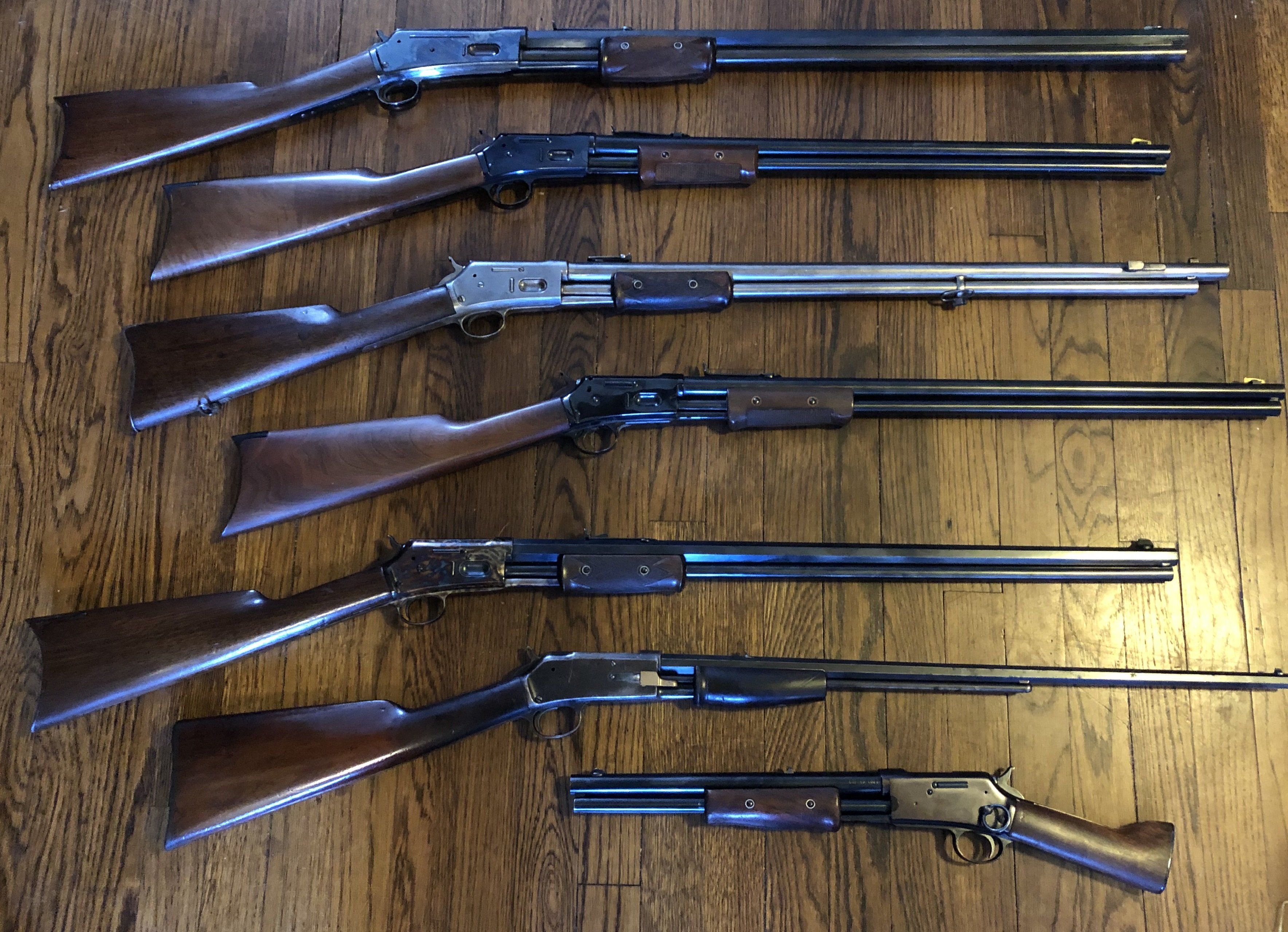

H. K. Uriah, SASS #74619 Posted January 11 Posted January 11 The AWA Lighting is, in my opinion, a good one. I have two, a .45 and a .44-40, and they have been very good to me. The .45 was the first rifle I shot a clean match with, for example. It also infected me with the Lightning Bug. Beware the Lightning Bug. Once it gets ahold of you, it will never let you go. The next thing you know, you'll have seven or more of the things! Now in all honesty, opinions here on the Wire of the AWA are mixed. My experience has been very positive. Others will tell you they have not fared so well. A lot of it depends on "which" AWA you have. If it's an AWA International, it is more likely to be problematic, but if it's an AWA USA, it more likely to be one of the good ones. Mine are USAs, so maybe that's why they work right. I don't know. If you like the .38, and if you really wanna try the Lightning, I'd say go for it. Let's assume it works fine as is. You will never regret it, and it'll wind up being a favorite rifle. If it's got issues, you can always send it to Lassiter for tuning. He can even make a Taurus run, which are universally regarded to be useful tomato stakes. So, you have options. Good luck. 1 Quote

H. K. Uriah, SASS #74619 Posted January 20 Posted January 20 15 hours ago, watab kid said: id like to have one in my collection of cowboy rifles but i want one that works , my observations of friends that had the lightening is that they just barly limped along Just one? That's what I thought... Once you start down this path, you'll never got off of it. Quote
watab kid Posted January 20 Posted January 20 16 minutes ago, H. K. Uriah, SASS #74619 said: Just one? That's what I thought... Once you start down this path, you'll never got off of it. that is a great collection of rifles , how do yours work ? id be happy with just one that works well , i have a fair sized collection of cowboy rifles but each one is different - models , calibers , mfgrs as well Quote
H. K. Uriah, SASS #74619 Posted January 20 Posted January 20 3 minutes ago, watab kid said: that is a great collection of rifles , how do yours work ? id be happy with just one that works well , i have a fair sized collection of cowboy rifles but each one is different - models , calibers , mfgrs as well Thank you. They all work quite well. Now, before I get into specifics, let me just say this; there is a part of the action of the Lightning that Lassiter has described to me as "a kind of a teeter totter." He feels there is a design flaw in this part, as it has a tendency to crack. It CAN be repaired, and it doesn't seem to matter who made your rifle. I will refer to this as the "teeter totter problem." Best way to describe is as follows. Everything seems to work. Then, after you fire the gun again, it jams. You can't open the action because the teeter totter cracked. You can get it open with mixture of wiggles and brute force, but at the point, don't try to shoot it again, it'll just jam again. Unload the gun and send it to Lassiter for fixing. Okay, that being said, here's how mine work... From Top to Bottom Colt, Large Frame. .45-85. The .45-85-285 is a Colt proprietary cartridge that use a case of identical dimensions to the .45-70. If you try to load .45-70's with 405 grain bullets, the cartridge will be ever so slightly too long to get in through the loading gate, but if you use 300 grain bullets, it'll fit. Other than the teeter totter problem, this gun has given me no trouble. The action is as smooth a butter, and it is tack driver accurate. AWA, Medium Frame, .45 Colt. My first Lightning. Yes, it had the teeter totter problem. Wanted to have a Lightning, just to have one, and this is what I got. Quickly became my favorite rifle. First gun I ever shot a clean match with. Learned the hard way with this gun about keeping it clean in order to run properly. It'll run .45 Schofields to a clean match with no problems. Colt, Medium frame, .44-40. Costa Rica surplus. These are kinda rare. They were issued to the Costa Rican army in the late 1800's. Ever since I heard of them, I wanted one, and was happy to find one. But I can't find a bayonet for it. Cycles ammo just fine, but has extraction problems. Being fixed by Lassiter. AWA Medium frame .44-40. I liked the .45 so much, I said that if I ever found an AWA in .44-40, I'd buy it. I found one, and I did. Had the teeter-totter problem, but other than that, no issues. Colt, Medium Frame, .32-20. Was advertised as "Lovingly restored with an expert action job." It is a very sweet shooter. In fact, this is the gun in the above video of me shooting. Only trouble it has is that it's a genuine antique, and the original magazine spring was worn out. Once I replaced it, everything has run flawlessly. Colt, Small Frame, .22 Long. Well, I had a Large Frame, and several Medium frames, so I had to get a Small Frame. While the Large and Medium have basically the same action, the small is very different. It's got more in common with the Winchester 73 than its larger siblings. I have had no problems with it. It's a nice gun. AWA Lightning Bolt Pistol. .45 Colt. (Formerly owned by Happy Trails.) These are extremely rare, and are absolutely the most fun Mare's Leg type pistol there is. When allowed to use it, I get more "what the heck is THAT?" comments than you can shake a stick at. I'd love to have another one or two of these, but they are so few in number, I doubt I'll ever SEE another one, let alone to be able to afford one. Let's just say that the perfect alignment of stuff allowed me to get this one. For more on the Lightning Bolt, see this old thread. That's all Quote
