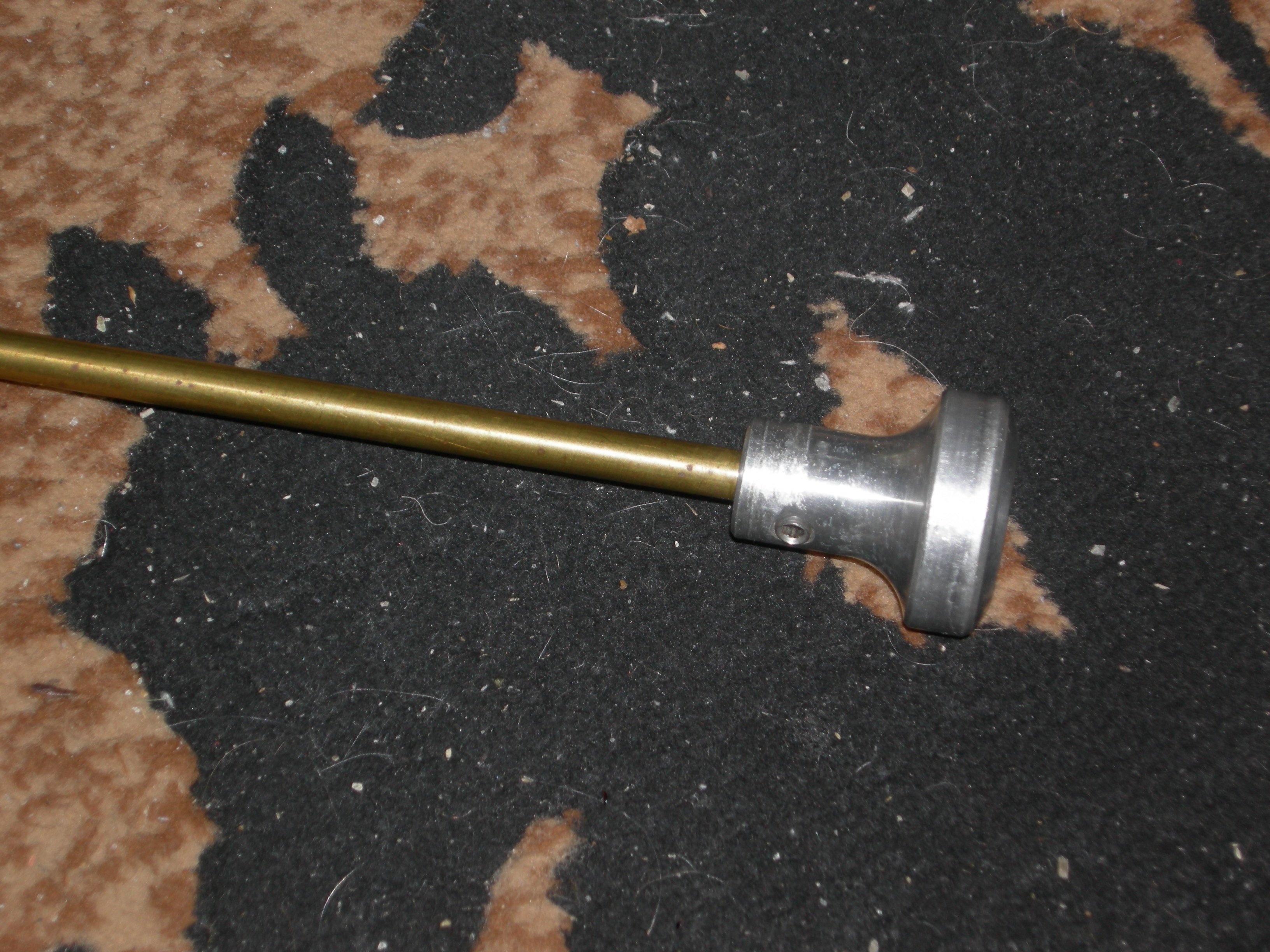

Griff Posted January 9 Posted January 9 My squib rod I received from T-Bone at CAC 2020... It's a solid rod .315" in diameter, 24-½" long and has an aluminum knob at the end. It's a slip fit in my .38s, Heavy enough that one drop is usually enough to dislodge a bullet in the barrel if close enough to the chamber. It rides around for free on my gun cart, used on several occasions, by myself and others, Easily worth far more than the few hours I spent setting up a Plainsman side match for T-Bone. Easily made from a 1-½" brass or other metal furniture knob and a 26" length of brass rod. Drill an appropriately sized hole in the knob, another thru the side, thread the one on the side and viola! Instant custom squib rod! 2 Quote
