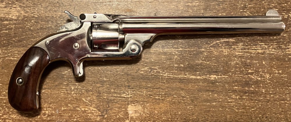

The real question arises over the various single action 5 shot revolvers.   For example, a Smith & Wesson 1-/2 in .32 S&W is "clearly" a pocket pistol.  Right?
Well...
This has got a 6" barrel, so it's not a pocket pistol according to the definition in the rules.
The fact is that while a pocket pistol is defined with a maximum size,  a main match revolver does not have a minimum size.   And since 5 shot revolvers and .32 caliber are main match legal, the above clearly would be okay, as long as it is loaded with 4 and the 5th is loaded on the clock, which in this case would mean shooting 4, ejecting the empties and loading the 5th.
But what about a gun identical to this one in every way, but with only a 4 inch barrel?  Is that a pocket pistol and not allowed to be a main match pistol, or a very small main match pistol?   The rules say you can't convert a pocket pistol to use as a main match pistol, so if you used one in a pocket pistol side match, you could not use it, but what if there was no side match you used it in?  Or does that "conversion" just apply to a gun used as a pocket pistol in one of those elusive main match stages that include a pocket pistol as a third gun that the Handbook does say happens from time to time?
In other words, there are a lot of undefined variables.
Personally, as far as I am concerned, if it has not been used as a pocket pistol at the match, and is a single action, I feel it's main match okay.  If you wish to handicap yourself with a gun that has to have the 5th round loaded on the clock just for the fun of it, knock yourself out.
But there are a lot of guns from .32 to .45 that are five shooters that range from very small to "full size" that can be safely loaded with 5 according to the definitions in the rules.  You don't see them at shoots very often, but they do exist.  :)
