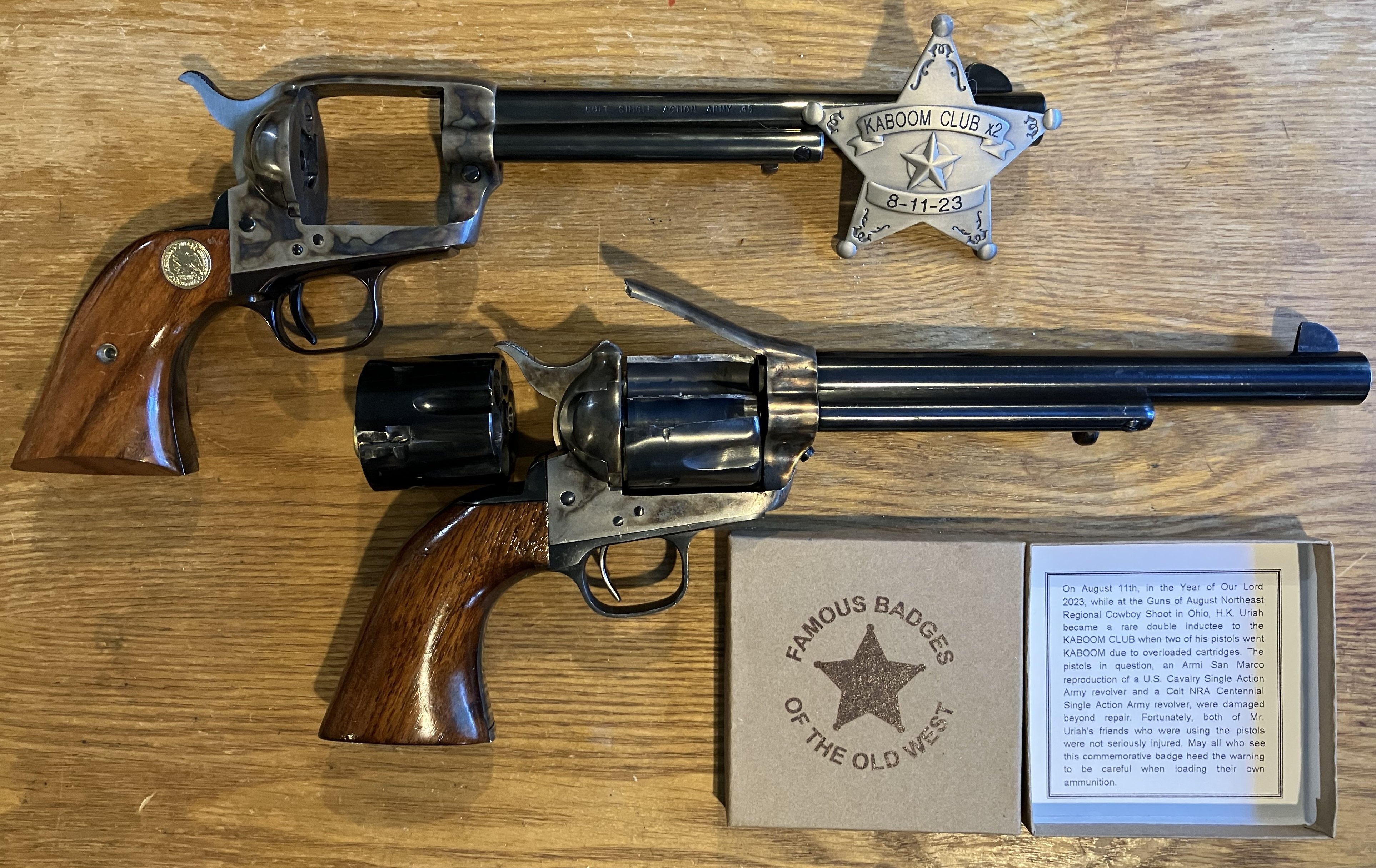

H. K. Uriah, SASS #74619 Posted January 5 Posted January 5 I have heard that the 2000 series Schofields do not mix well with Black Powder. I've had at least one shooter who had one tell me this in person. I've not tried it myself. This is the first time I've heard about one of them breaking when using the stuff though. Here is a thread by Driftwood Johnson from a few years back that explains well why reproduction Schofields do not work with black powder. Driftwood really knows a lot about the old S&W Top Breaks and how/why the work. Much more than I do. I just shoot 'em. 2 Quote

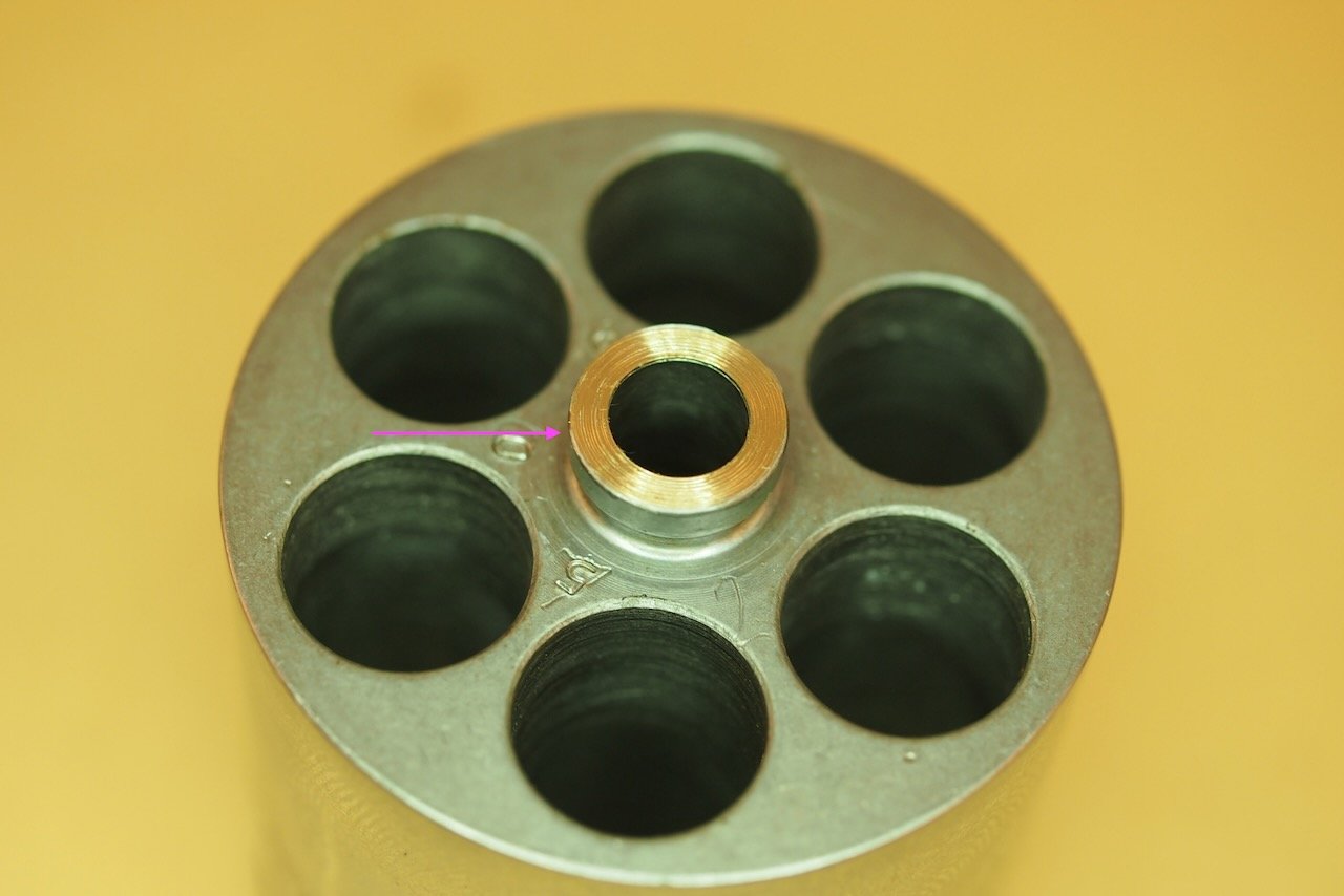

Larsen E. Pettifogger, SASS #32933 Posted January 5 Posted January 5 Yes. The reproductions donot have a gas ring on the front of the cylinder and gum up with real black fairly quickly. Without a gas ring to block the blast the gases from the cylinder gap between the barrel and cylinder blow directly onto the cylinder base pin. 1 1 Quote
Larsen E. Pettifogger, SASS #32933 Posted January 5 Posted January 5 Cylinder gas ring. Arrow. Modern S&W Schofilds (and Uberti) are flat on the front so gases and dirt blow directly on the base pin. 1 Quote

H. K. Uriah, SASS #74619 Posted January 6 Posted January 6 8 hours ago, Rooster Ron Wayne said: I did wright about this a year ago and moderators deleted my post because they said it was not safe. I tried to dispute this fact because it was also done back in the day . But they run this sight and I using there platform . So it is what it is . https://youtube.com/shorts/An5xioGclaA?si=ImUBy7XmlSJdcz6n Rooster, I assume you are saying that duplex loads are safe. I will, provisionally, agree with you. If you have the right kind of smokeless and know what you are doing, it very well could be safe. That being said, I can foresee too many people making a catastrophic mistake. There are just to many variables. Which smokeless? How much do you use? Even if it's safe for a gun made last Tuesday, is it safe for one made in 1884? On the one hand, I am a firm believer that when it comes to safety, it is the responsibility of the shooter, not SASS. And while I really don't believe it is up to SASS to guard against "stupid," for lack of a better term, I can understand why the organization would be very opposed to duplex loads. For one thing, if the guy making them DID screw up, he puts not only himself and his guns at risk, but anyone near by. So, I get the "no duplex" rule. And even the most careful of reloaders can make a mistake to deleterious effect. Once this has happened, you tend to want to eliminate any possibility of something like this happening again. The above is why I won't use Win231 anymore, for example. Believe it or not, I was able to have the top gun, a real Colt, repaired. The bottom Armi San Marco, remains dead. And with all of THAT being said, let's just say for the sake of discussion that you figured out a safe duplex load for .45 Colt using a specific amount of a certain smokeless and oh so much black. Clearly there is no reason why you should not use it when you go the range for fun, and even share the data with people who ask about it. But that's a different animal altogether. And now, setting everything else aside, I really hope you and I get to shoot together some day. 2 1 Quote
