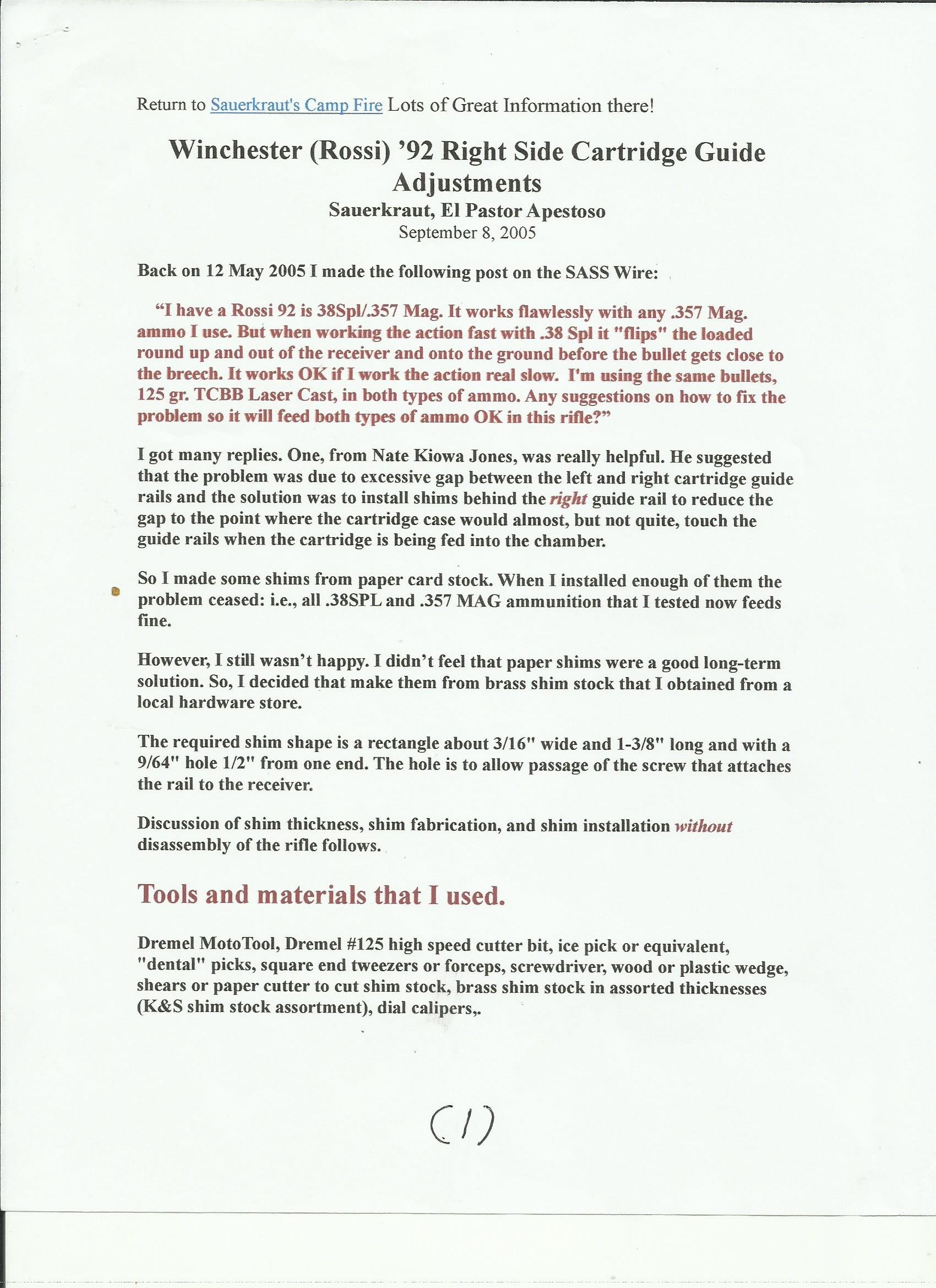

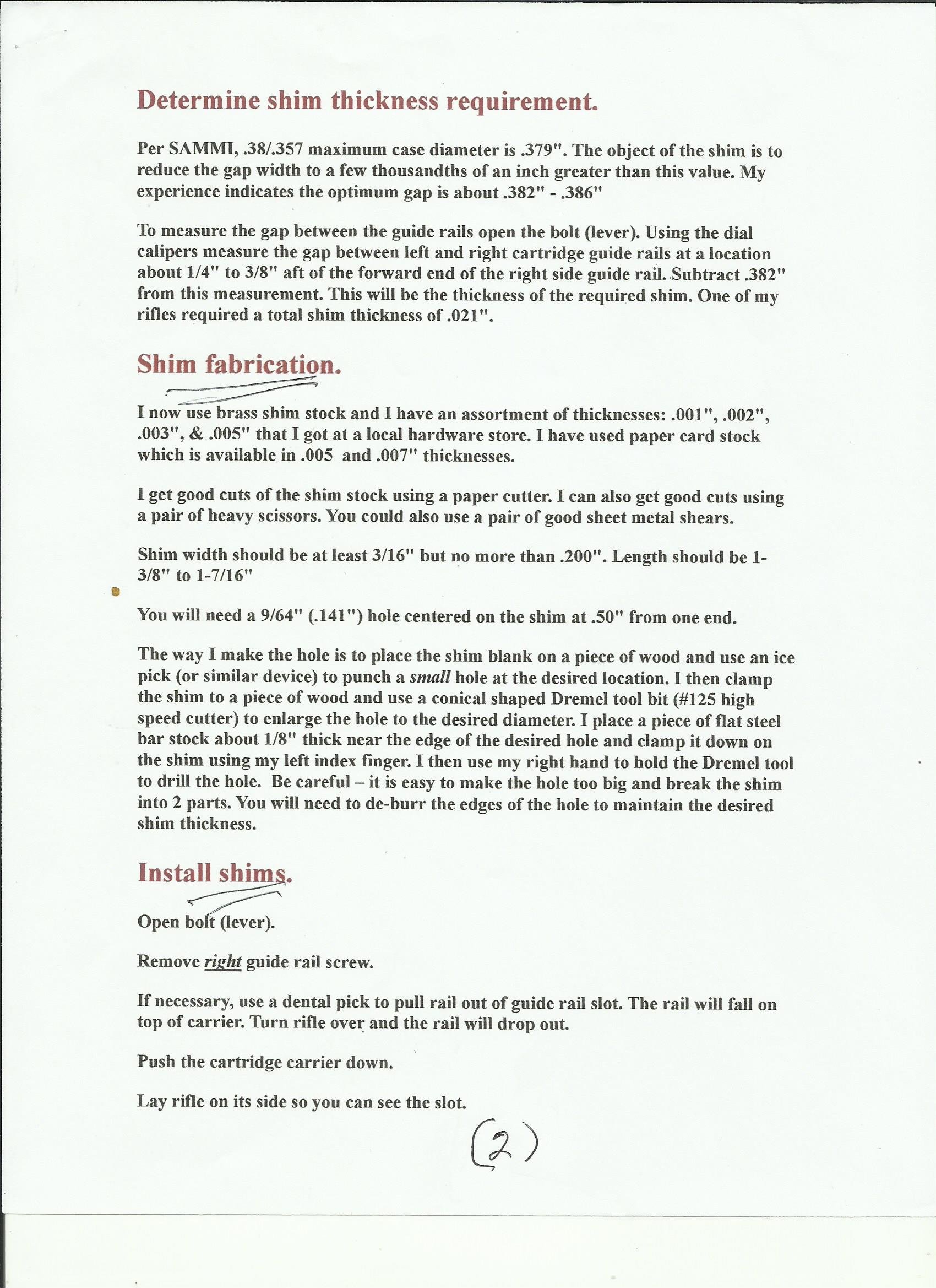

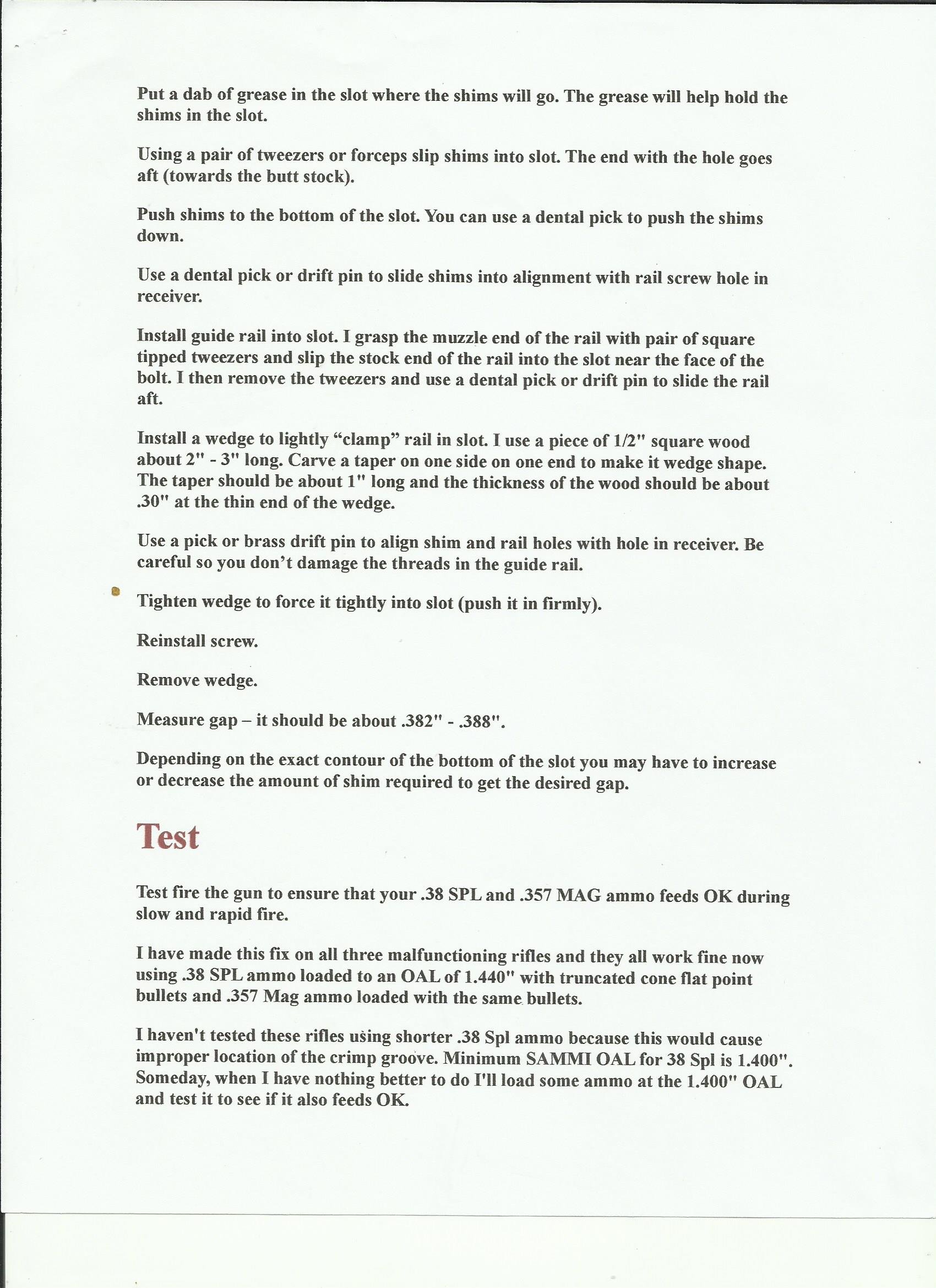

Jackrabbit Joe #414 Posted January 2 Posted January 2 HK Uriah semt you e-mail. Sounds like what I had with my Rossi Puma 1892. Have a fix maybe lhelp you with your 1892.
Jackrabbit Joe #414 Posted January 2 Posted January 2 Yo Ho H.K. Uriah sent you the info 4pages long. Pless advise to me that you did receive. Widder knows me pilgrim. Jackrabbit joe SASS #414
Cotton Eye Joe Posted January 2 Posted January 2 40 minutes ago, Jackrabbit Joe #414 said: Yo Ho H.K. Uriah sent you the info 4pages long. Pless advise to me that you did receive. Widder knows me pilgrim. Jackrabbit joe SASS #414 He's talking about the Marlin Model 1892, not the Win1892 style. Very different guns!
Jackrabbit Joe #414 Posted January 2 Posted January 2 6 minutes ago, Cotton Eye Joe said: He's talking about the Marlin Model 1892, not the Win1892 style. Very different guns! Ok thanks pilgrim just trying to help.. That's what I like about SASS folks helping out folks.

H. K. Uriah, SASS #74619 Posted January 2 Author Posted January 2 Thanks for the post, Jackrabbit. As others mentioned, it's not the same animal, but I appreciate the post all the same. If this problem ever come up with my Rossi, I now know what to do!
