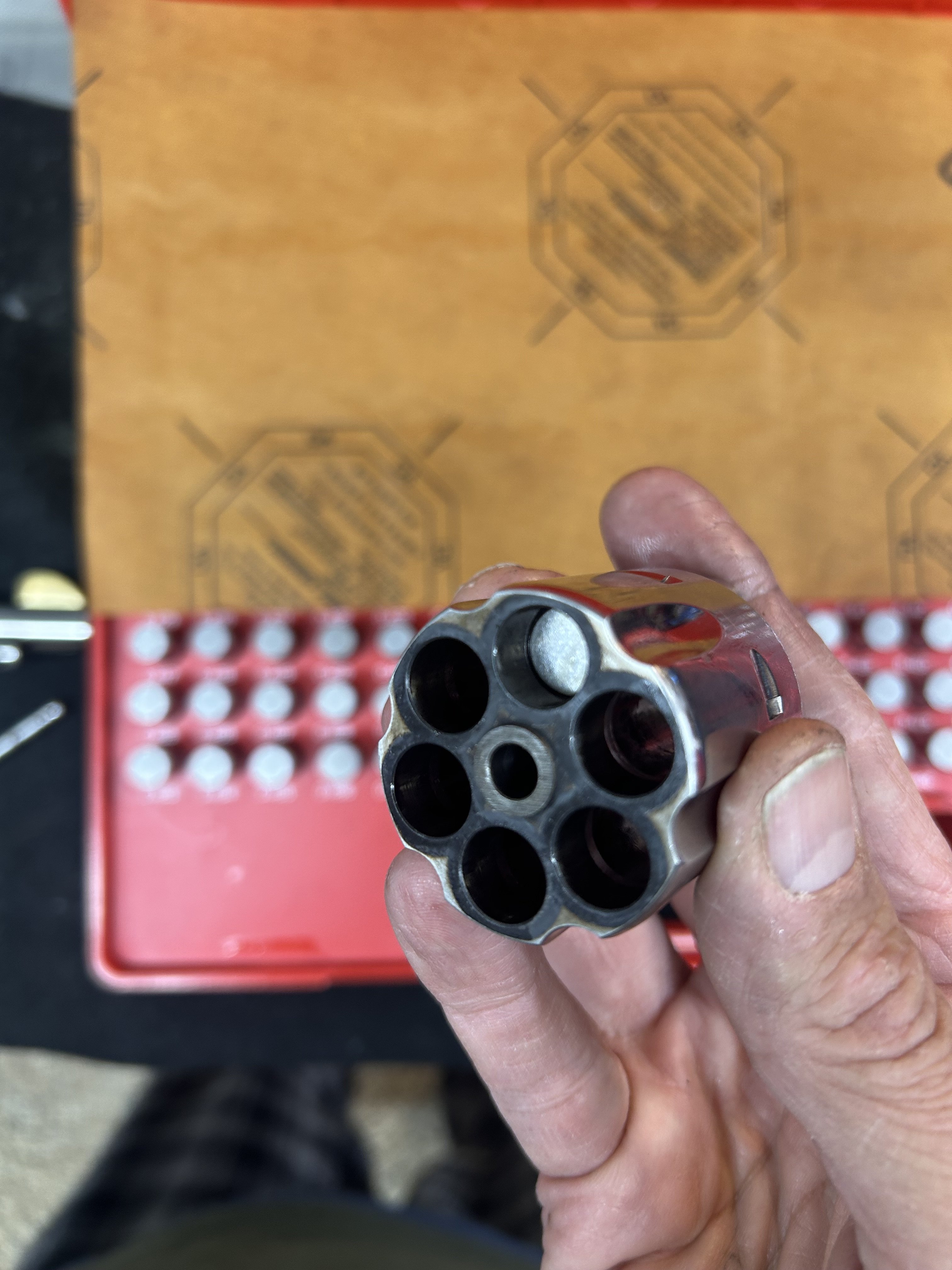

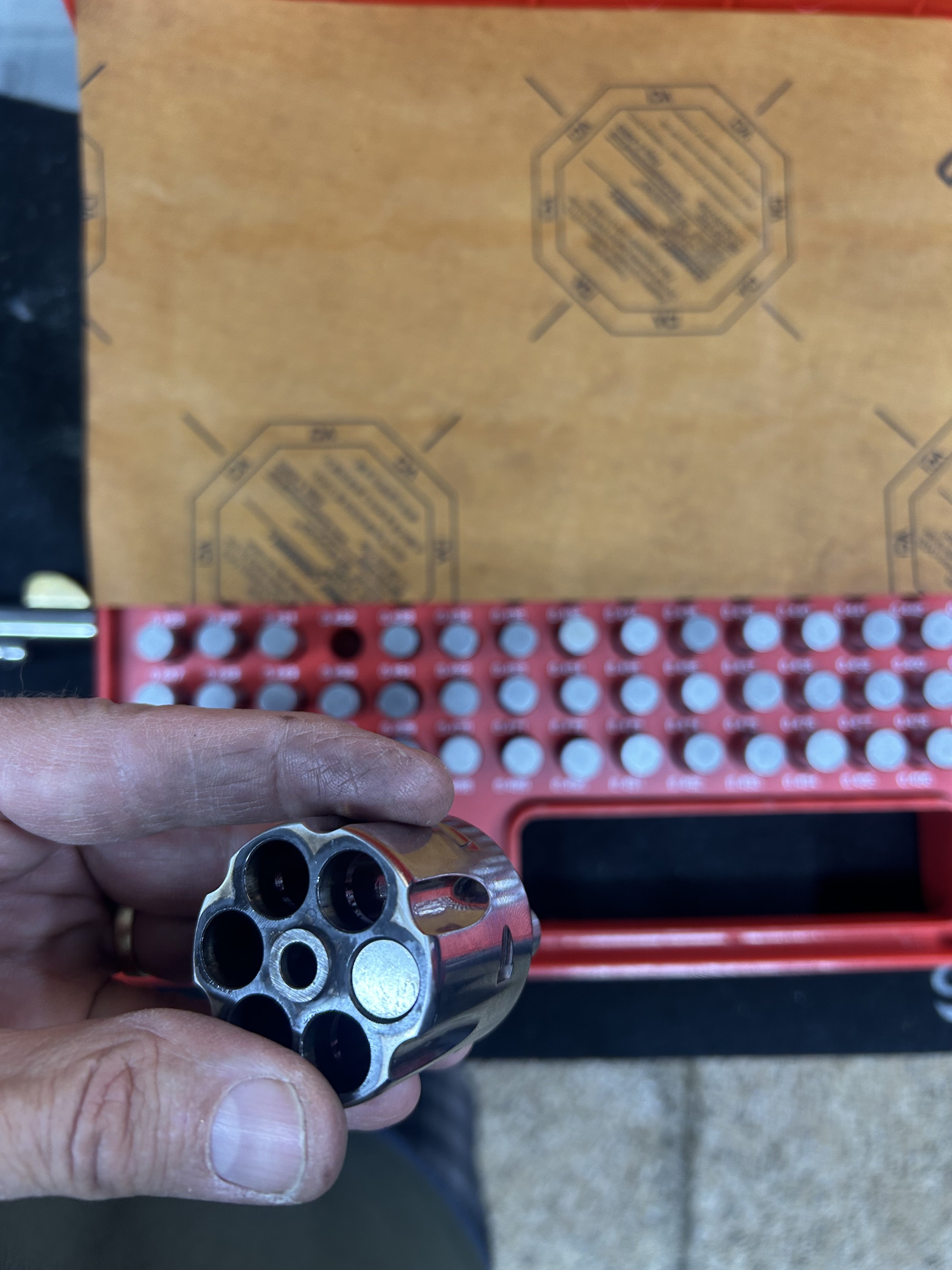

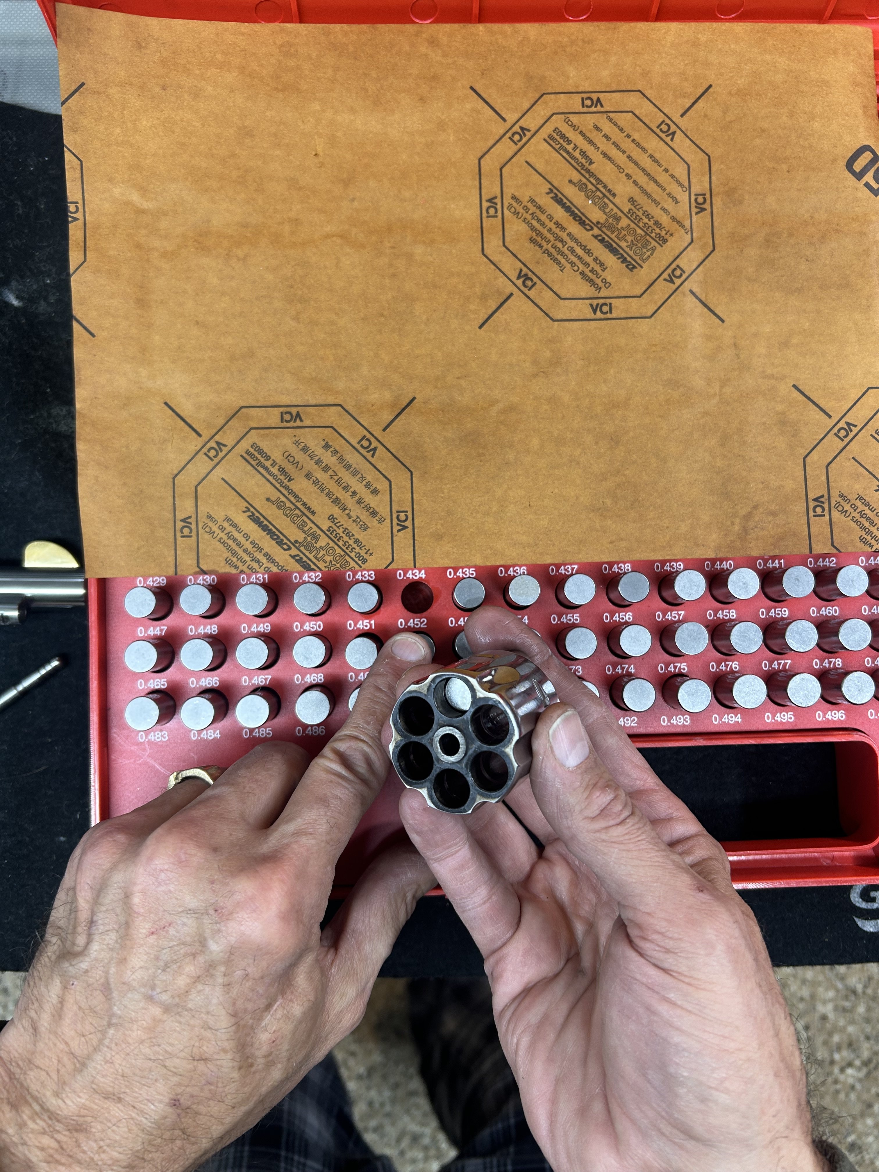

Tall John Posted December 31, 2025 Posted December 31, 2025 What should be the cylinder chamber exit diameter Ruger NMV 45 Colt pistol. I bought the gun used, but noticed when I took it to the range that I was having some difficulty both loading and extracting the cases after shooting from the cylinder. This is with OEM loaded ammunition from choice ammunition 200 grain RNFP bullet I also noticed the same thing with six of my dummy rounds that I’m preparing to reload. Both the Choice OEM ammunition, and my dummies drop in and out of a case gauge with no problem and they also cycle and plunk test in my 1873 with no problem so I don’t think I have a crimp issue. When loading, I’m having to push the round into the last 1/8” on about half of the chambers on my NMV. When I use a pin gauge on the cylinder chambers, a 0.450” pin slips right through, a 0.451” pin will slip through with some pressure, but a 0.452 “ pin stops solidly where the case ends in the cylinder. Is this normal? Do I just need to use a hone on the chambers to polish them or have them reamed? See the pictures below… Note that My unloading issues, seem to be the case rim scraping on the frame when trying to extract the empty case. I do not have have the ability to test the cylinder for its concentricity to see if is out of round. thoughts? .450” .451” 0.452”

The Original Lumpy Gritz Posted January 10 Posted January 10 8 hours ago, Tall John said: it is interesting that the problem is now limited to ONE chamber. I bought this gun used, yes it has been a problem since acquisition, I currently only have 1 45 Colt NMV so I didn’t switch the cylinders. No chamber issues any longer since I honed them, just this clearance issue on one of the six chambers remains. Can you post pictures showing the interference?
El Sobrante Kid Posted January 10 Posted January 10 12 hours ago, Tall John said: it is interesting that the problem is now limited to ONE chamber. I bought this gun used, yes it has been a problem since acquisition, I currently only have 1 45 Colt NMV so I didn’t switch the cylinders. No chamber issues any longer since I honed them, just this clearance issue on one of the six chambers remains. It is not very likely, but it is a possibility, that the one chamber was cut off-center. A metal chip in the clamping fixture would cause that particular issue. Since you have a set of pin gauges, and hopefully a feeler gauge, insert the pin gauge into the chamber, and measure the minimum gap for each of the chambers between the pin and the frame. If the cylinder was cut off-center, the gap will be the tightest at your problem chamber, and the largest at the chamber on the opposite side.
