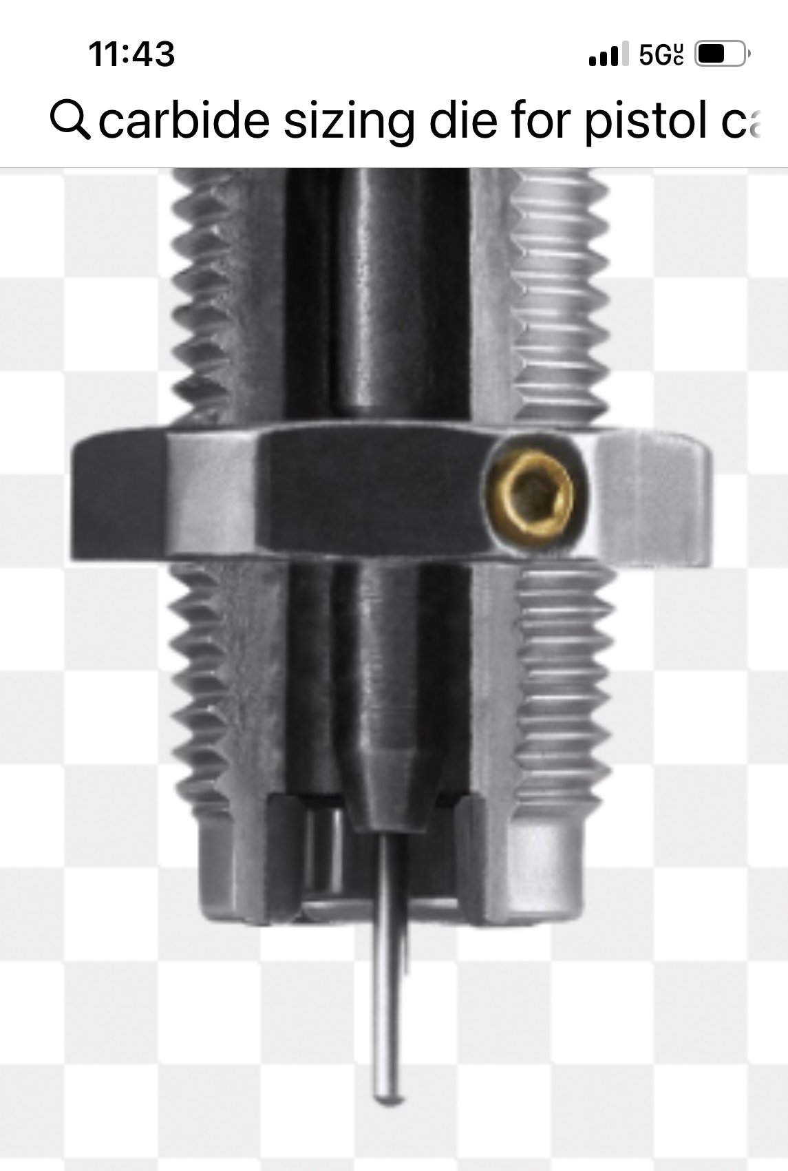

Widder, SASS #59054 Posted December 18, 2025 Posted December 18, 2025 Well, contrary to popular belief, especially mine, there does appear to be a slight taper even with carbide dies. In my situation, I was getting some extreme stretching of brass when reloading the .460 S&W mag brass. Soooooo, I sent RCBS an email and their reply was that the OPENING of a carbide die was actually larger (greater in diameter)than the inside upper edge of the carbide piece. Please note: this was in reference to my .460 dies. If you want to know if your particular CARBIDE die is actually straight or taper, measure your brass at the case mouth and also about 5/8 inch back. Then, resize just the upper 5/8 inch of your brass to see if the dimensions are the same.....OR to see if there is an actual taper built into your carbide die. Of course, mileage varies. But atleast you will know more about your own die, versus other die sets. ..........WIdder 1 Quote
Boggus Deal #64218 Posted December 18, 2025 Posted December 18, 2025 1 minute ago, Widder, SASS #59054 said: Well, contrary to popular belief, especially mine, there does appear to be a slight taper even with carbide dies. In my situation, I was getting some extreme stretching of brass when reloading the .460 S&W mag brass. Soooooo, I sent RCBS an email and their reply was that the OPENING of a carbide die was actually larger (greater in diameter)than the inside upper edge of the carbide piece. Please note: this was in reference to my .460 dies. If you want to know if your particular CARBIDE die is actually straight or taper, measure your brass at the case mouth and also about 5/8 inch back. Then, resize just the upper 5/8 inch of your brass to see if the dimensions are the same.....OR to see if there is an actual taper built into your carbide die. Of course, mileage varies. But atleast you will know more about your own die, versus other die sets. ..........WIdder If all or most of that cartridge case is pushed through the smallest diameter of that carbide, it’s gonna be sized that diameter. Obviously brass is somewhat malleable and can spring back but a carbide sizing die ring will not put a taper on a case over the whole length. 2 1 Quote
Smokin Gator SASS #29736 Posted December 18, 2025 Posted December 18, 2025 56 minutes ago, Widder, SASS #59054 said: Well, contrary to popular belief, especially mine, there does appear to be a slight taper even with carbide dies. In my situation, I was getting some extreme stretching of brass when reloading the .460 S&W mag brass. Soooooo, I sent RCBS an email and their reply was that the OPENING of a carbide die was actually larger (greater in diameter)than the inside upper edge of the carbide piece. Please note: this was in reference to my .460 dies. If you want to know if your particular CARBIDE die is actually straight or taper, measure your brass at the case mouth and also about 5/8 inch back. Then, resize just the upper 5/8 inch of your brass to see if the dimensions are the same.....OR to see if there is an actual taper built into your carbide die. Of course, mileage varies. But atleast you will know more about your own die, versus other die sets. ..........WIdder Everything above the upper edge of the carbide piece would be sized smaller then the small part of the brass at the very bottom that might barely enter the carbide sizer. How brass reacts to the sizing ring may be slightly different depending on the brass wall thickness. We know that commonly it's thinner at the neck and thicker as it nears the base. 3 Quote
Widder, SASS #59054 Posted December 18, 2025 Posted December 18, 2025 3 hours ago, Boggus Deal #64218 said: If all or most of that cartridge case is pushed through the smallest diameter of that carbide, it’s gonna be sized that diameter. Obviously brass is somewhat malleable and can spring back but a carbide sizing die ring will not put a taper on a case over the whole length. 2 hours ago, Smokin Gator SASS #29736 said: Everything above the upper edge of the carbide piece would be sized smaller then the small part of the brass at the very bottom that might barely enter the carbide sizer. How brass reacts to the sizing ring may be slightly different depending on the brass wall thickness. We know that commonly it's thinner at the neck and thicker as it nears the base. True and true. In my 460, which is an extreme example, I was trying to resize just the upper 1/3 of the case to help eliminate excessive stretching. That was the reason I contacted RCBS and only conveyed what they told me. According the RCBS, the dimensions of a carbide die used for a straight wall case can vary from the entry to the upper end of its sizing process. Like many, I was surprised with this revelation. ..........Widder 1 Quote
Boggus Deal #64218 Posted December 18, 2025 Posted December 18, 2025 6 minutes ago, Widder, SASS #59054 said: True and true. In my 460, which is an extreme example, I was trying to resize just the upper 1/3 of the case to help eliminate excessive stretching. That was the reason I contacted RCBS and only conveyed what they told me. According the RCBS, the dimensions of a carbide die used for a straight wall case can vary from the entry to the upper end of its sizing process. Like many, I was surprised with this revelation. ..........Widder Widder, I understand what you’re saying. I understand what RCBS told you. Even in the picture I posted above you can see that taper in the carbide part. What I’m saying is everything that is pushed through that smallest diameter portion of that carbide is sized to that diameter. The whole length won’t be tapered. The very small length of brass that is not pushed completely through will, or should, be tapered to match. What was implied earlier was the case, from case mouth to case base, would be tapered. 1 Quote

Smokin Gator SASS #29736 Posted December 19, 2025 Posted December 19, 2025 Sounds as if the carbide sizing ring is slightly larger at the entry point then at the top final portion. Probably to aid in the case smoothly entering the die similar to belling a case before seating the bullet. 5 Quote
Boggus Deal #64218 Posted December 19, 2025 Posted December 19, 2025 7 hours ago, Smokin Gator SASS #29736 said: Sounds as if the carbide sizing ring is slightly larger at the entry point then at the top final portion. Probably to aid in the case smoothly entering the die similar to belling a case before seating the bullet. Exactly! 1 Quote
