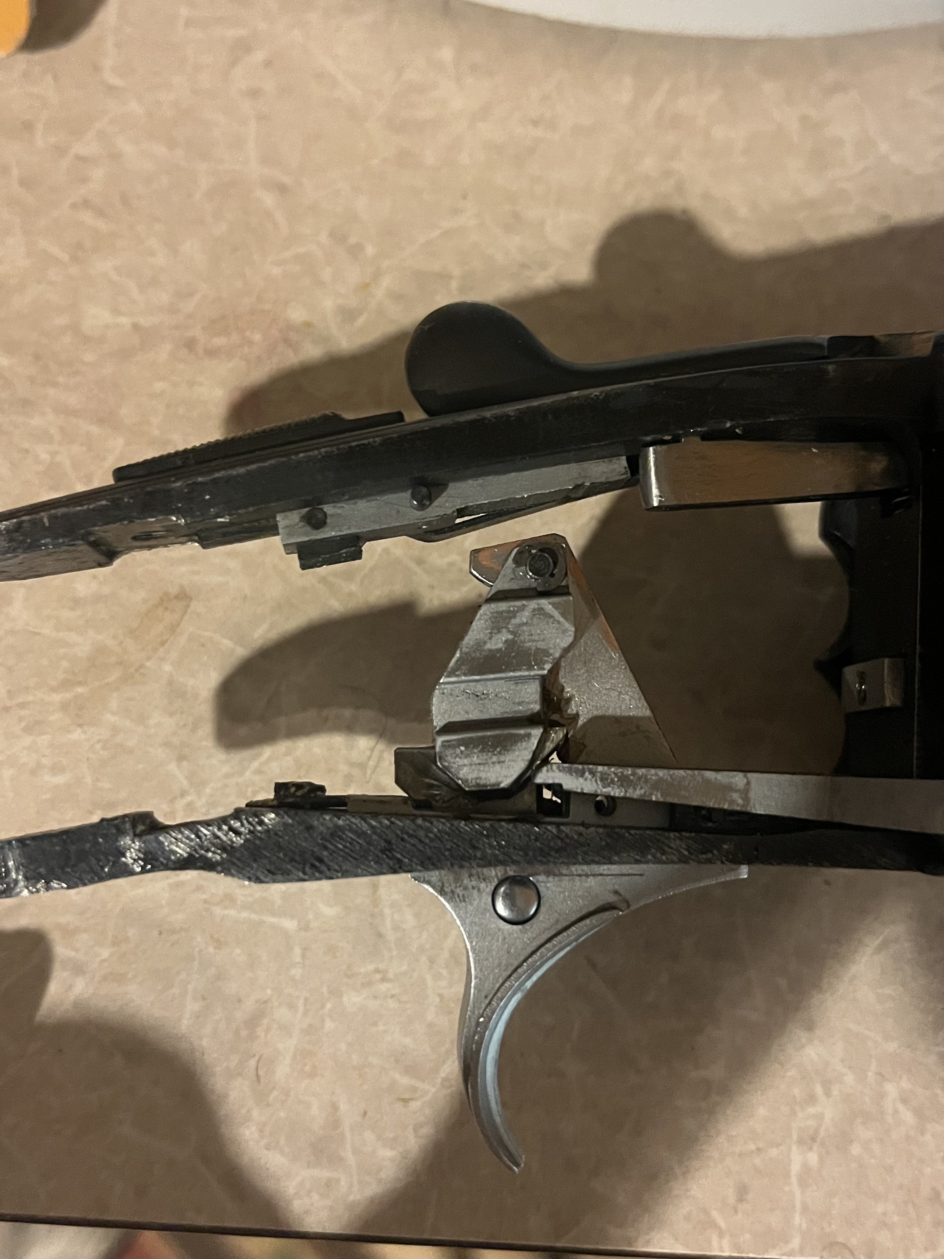

KatfishKid Posted December 8, 2025 Posted December 8, 2025 Looking for some advice from folks who know their way around an SKB. I’ve got an SKB 400 SxS. Recently the right barrel quit firing, so I had someone look it over and he replaced the trigger and a couple springs. Now it fires the first barrel just fine, but it won’t switch over to the second barrel under recoil. Doesn’t matter which barrel I start with. The only way it’ll transfer is if I smack the buttstock, so the inertia parts do move, they just aren’t moving on their own. The first rounds I tried were Winchester LNLR and thought maybe they just weren't enough to activate the transfer, so I tried some pretty stout Black powder rounds and it made no difference. The barrels still wouldn't transfer. I tried holding the shotgun tighter against my shoulder and I also tried making sure my finger was coming completely off the trigger before trying to fire the second barrel. I’m thinking it’s something like the inertia block spring being too tight, or the travel/stop screw(assuming there is such a thing in this gun)not being set correctly after the work was done. I’m comfortable with light gunsmithing, but I’m not very familiar with the internals of this shotgun. I’m planning to take it back to Dan if the fix ends up being more involved, but before I do that, I’d really like to understand what’s actually causing this and learn how to fix it myself if it’s something simple. So for anyone who’s tuned SKBs before: Which screw or adjustment controls that inertia block movement? Does anyone have pictures of the trigger group showing the correct area? And what are the risks if I adjust it too far—doubling, light trigger pull, anything like that? Any guidance or photos would be greatly appreciated. Quote

Boggus Deal #64218 Posted December 8, 2025 Posted December 8, 2025 There is no screw that affects the inertia mechanism. Can you fire the second barrel by switching the selector? 1 Quote
KatfishKid Posted December 8, 2025 Author Posted December 8, 2025 6 minutes ago, Boggus Deal #64218 said: There is no screw that affects the inertia mechanism. Can you fire the second barrel by switching the selector? If I fire the first barrel, I can open the gun, switch the selector to the other barrel, close the gun and it will fire the selected barrel. Or I can fire the first barrel, Smack the butt of the gun and it will then fire the second barrel. Quote
Boggus Deal #64218 Posted December 8, 2025 Posted December 8, 2025 If you fire the gun, leave it closed and switch barrels, will the second fire? You should not have to open the action. 1 Quote

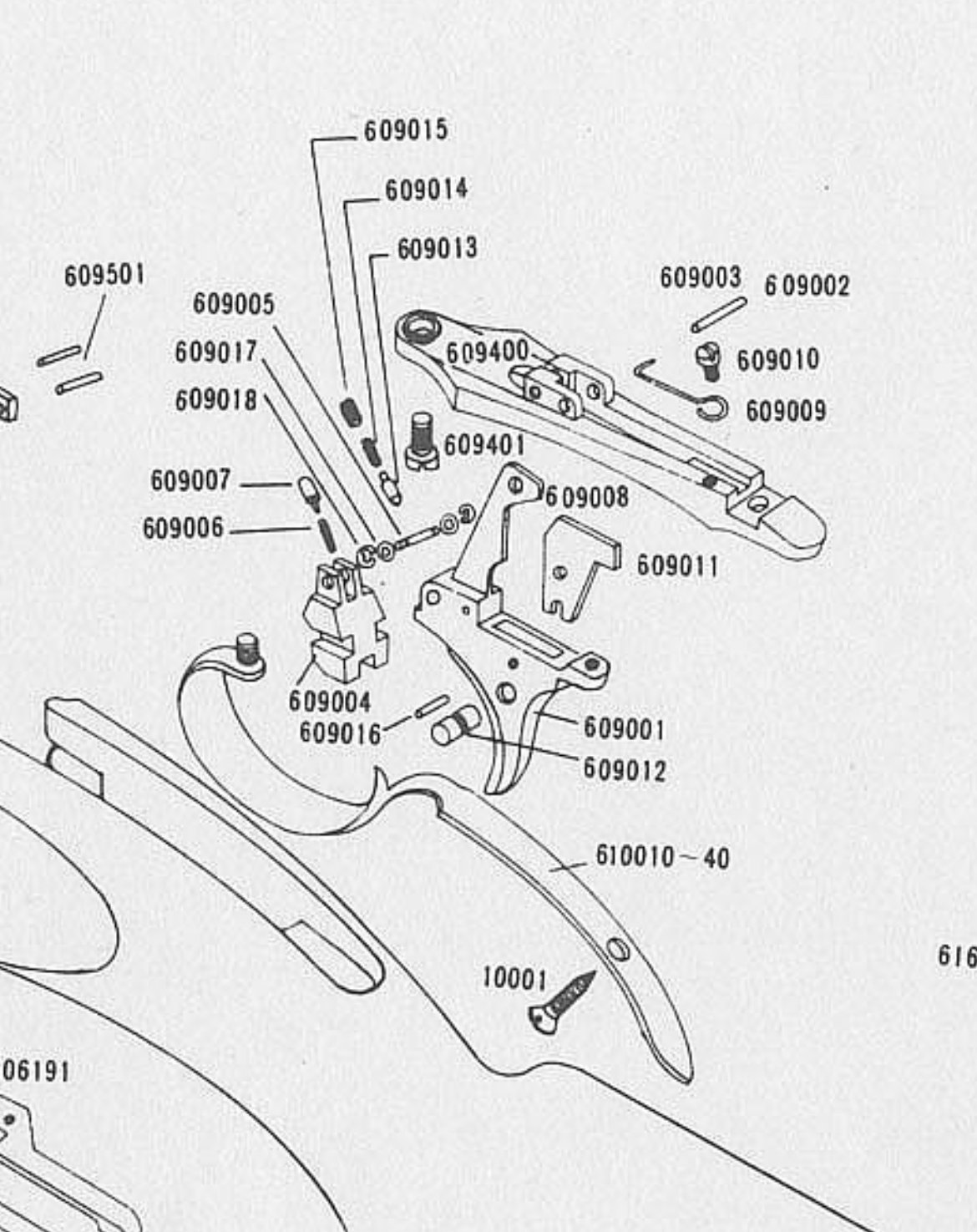

Larsen E. Pettifogger, SASS #32933 Posted December 8, 2025 Posted December 8, 2025 Assuming nothing else is binding the little spring part #609006 is what controls the interia block swing. A lighter spring will often fix your problem. 1 Quote
KatfishKid Posted December 8, 2025 Author Posted December 8, 2025 1 hour ago, Boggus Deal #64218 said: If you fire the gun, leave it closed and switch barrels, will the second fire? You should not have to open the action. No, it will not fire. I have to switch it, open the action and close it in order for it to fire. Quote
