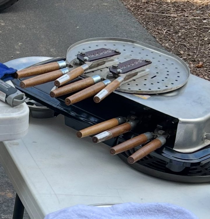

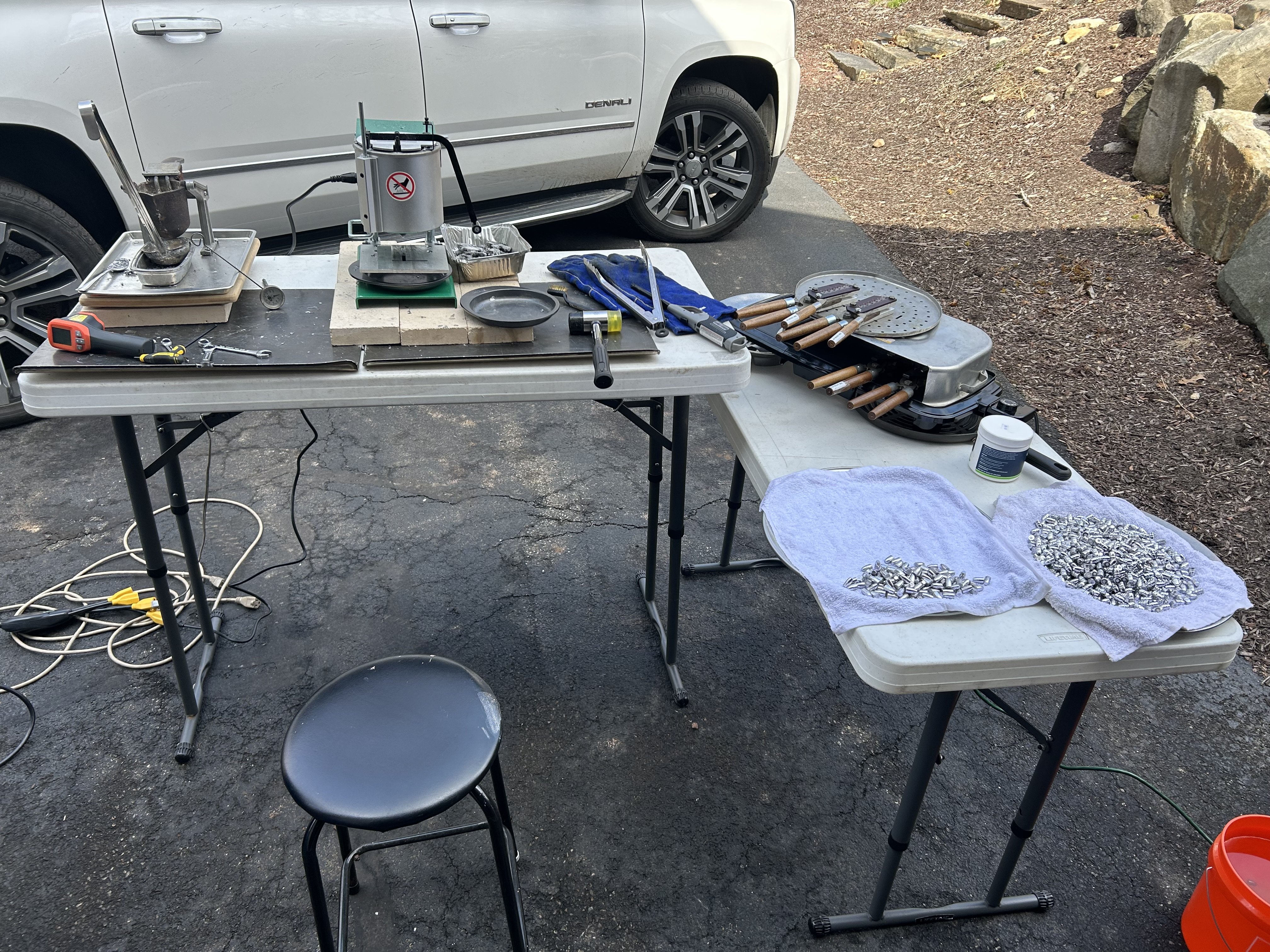

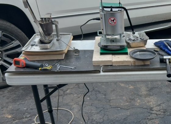

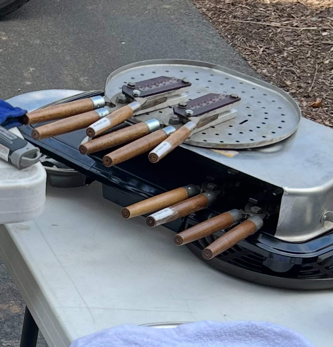

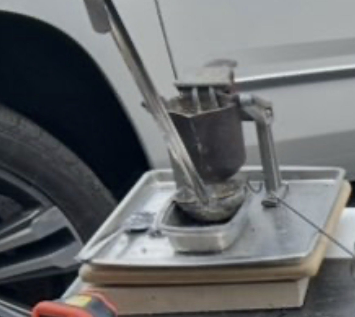

Tall John Posted December 7, 2025 Posted December 7, 2025 I did this 👆👆and found it to be a hassle. I cast outside of my garage and have to use extension cords for power. There is a limit to how much you can draw. 15 or 20amps. UNLESS YOU CAN BUILD YOUR OWN PID controller, consider purchasing an RCBS PROMELT 2 or the Lyman bottom pour furnace. A prefab PID controller will cost between $150-200 whereas both the Lyman and RCBS furnaces have them built in. So one less box on your bench, one less plug, one less hassle. use your current pot to preheat your lead and transfer it to the furnace as needed. i can cast couple thousand bullets in an afternoon with this set up. My small pot in the picture is an antique 10lb tipping pot. I melt cold ingots there and transfer to my PROMELT furnace as needed which keeps that pot at temperature. Ive seen pictures of the double pot set up but they were scary looking and take Unio space. I can store all of my casting equipment on a four foot shelf when not in use. I’ve since replaced the griddle with a small toaster oven to preheat my moulds. Quote
