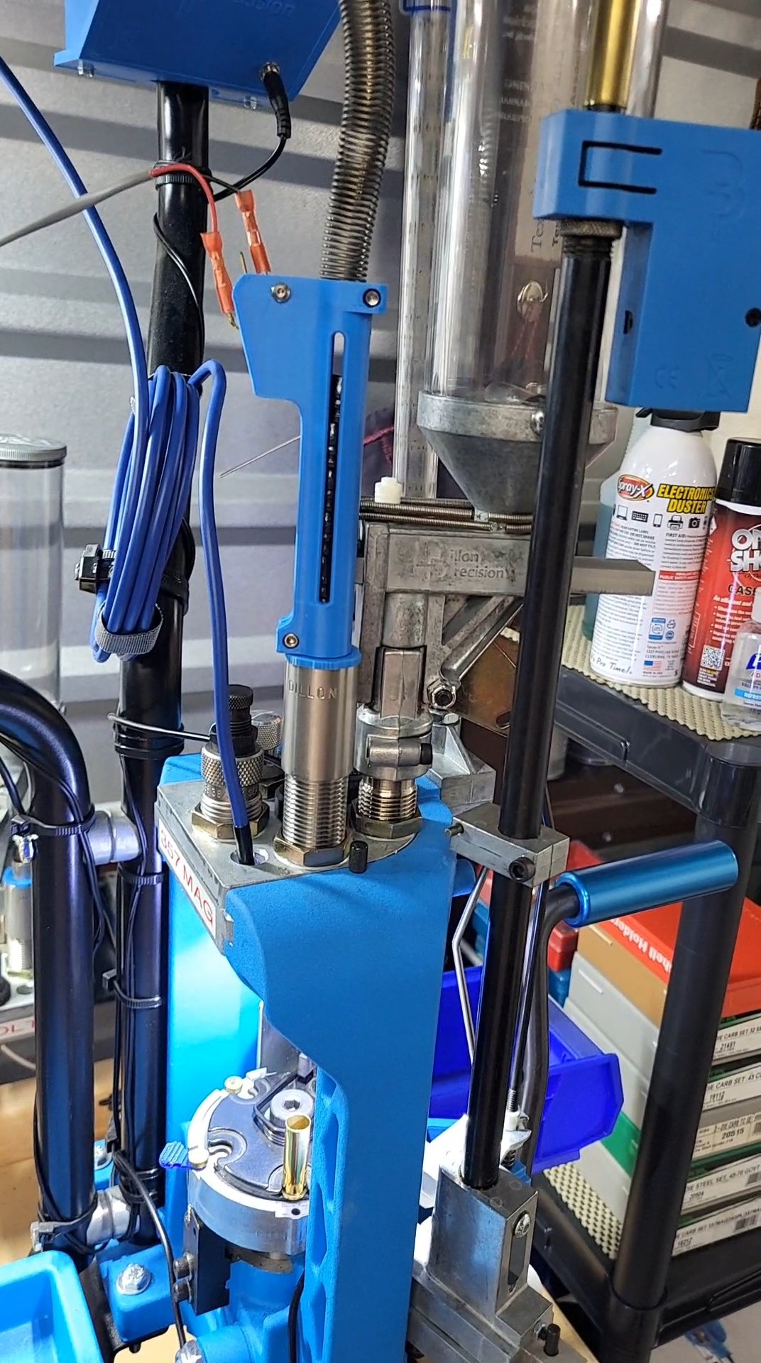

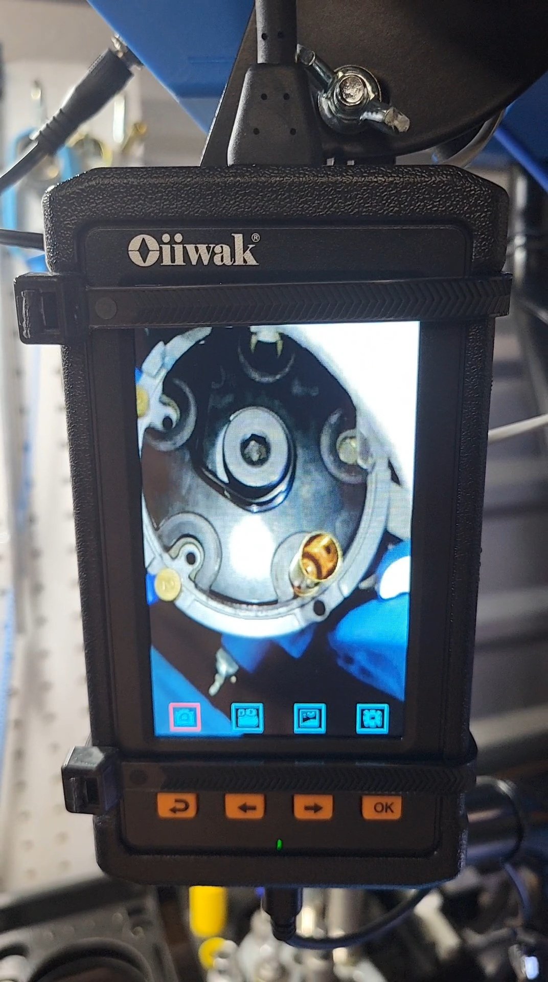

Nostrum Damus SASS #110702 Posted November 30, 2025 Posted November 30, 2025 (edited) I use my Dillon XL750 press to do volume loading of three calibers using three dedicated caliber-specific toolheads. In order to install a bullet feeder die in station 3 of each toolhead, I had to remove the Hornady Powder Cop powder check dies that were in those positions. I still wanted some sort of powder check, though, whether visual like the Powder Cop or automatic like the RCBS lock-out die. Either of those options required me to replace the standard OEM Dillon powder charge bar in each toolhead's powder measure assembly with a $50 Double Alpha Extra-Short Dillon Powder Bar, about $175 total after tax and shipping ... plus the cost of the three powder check dies. A BIG THANK YOU goes out to Hawk Eyes Hudson who suggested that a simpler and much less expensive visual powder check was possible: just add a fiber optic inspection camera to the press. Ta-da! For just 35 bucks on Amazon, the camera now lives on the press; the camera lens at the end of the fiber optic cable just sits in the small hole in the toolhead between stations 3 and 4. I can now easily see into the case after the powder charge is dropped and before the bullet is placed on the case mouth. Edited November 30, 2025 by Nostrum Damus SASS #110702 7 3 Quote

Cheyenne Ranger, 48747L Posted December 1, 2025 Posted December 1, 2025 assuming you had to drill the hole yourself? may try something like that on my SDBs cr 1 Quote
Nostrum Damus SASS #110702 Posted December 1, 2025 Author Posted December 1, 2025 (edited) 2 hours ago, Cheyenne Ranger, 48747L said: assuming you had to drill the hole yourself? may try something like that on my SDBs cr Drill which hole? The one in the tool head that I poked the end of the fiber down? No, that smaller hole between stations 3 and 4 is for the case powder check rod of the Dillon p/n 21044 Powder Check Assembly, which cannot be used with a bullet feeder without the extra-short powder charge bar as mentioned above. In case I didn't adequately make it clear, the problem is that the regular powder charge bar reciprocates out far enough that the bullet dropper die would interfere with it if installed in station 4; thus, the bullet feeder die must be installed in station 3, or else the Double Alpha extra-short charge bar must be swapped in and then the bullet feeder die can go in station 4. But if you do that, you must use an RCBS (or equivalent) combo seater/crimper die in station 5 because there are only 5 stations in the 750 tool head. And today I did one more thing: I drilled a hole through an appropriately sized rubber stopper and pushed the fiber optic lens tip though it, and now the fiber is snugly held in that hole without shaking or moving around. Edited December 1, 2025 by Nostrum Damus SASS #110702 1 2 Quote

Nostrum Damus SASS #110702 Posted December 4, 2025 Author Posted December 4, 2025 You guys are lucky! As my experience shows, you don't have to do anything wrong to load a cartridge without any powder in it ... if you don't have a powder check die on your press. I don't think I've actually seated any bullets on empty cases after I installed Hornady Powder Cops on all of my toolheads to prevent exactly that occurrence. The problem I currently face is that I chose the convenience and speed of loading with a bullet feeder on the 750 over the security and QC of using a powder check die -- so I am A LOT more worried about it because I can load nearly a thousand rounds per hour and could not visually (or any other easy way) check that the cases have powder in them before bullet seating, until now. I simply do not have the time or patience to weigh every cartridge after completion. I'm loading for two shooters shooting twice a month and we go through a pile of ammo most of those months. And I am only "semi-retired" ... 🤣 1 Quote
