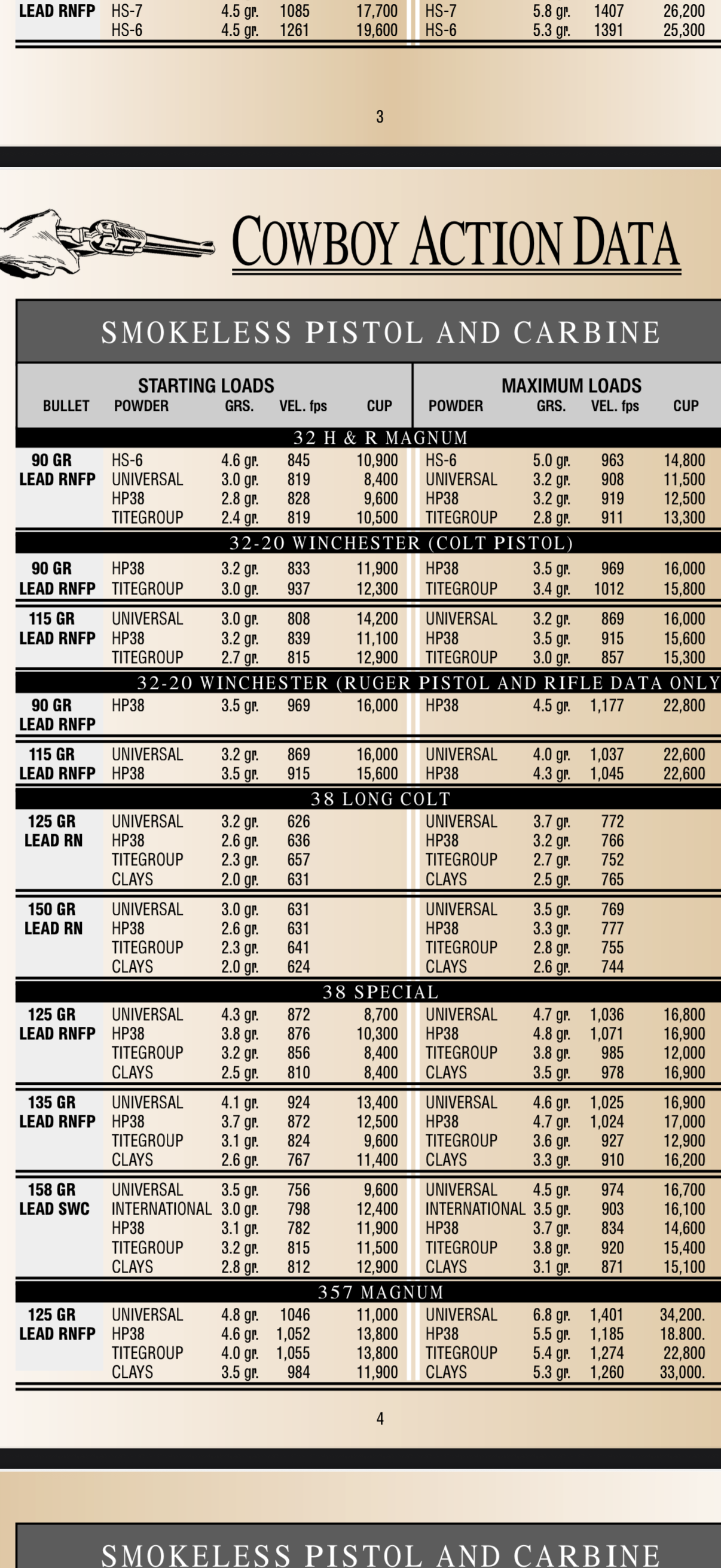

Leroy Luck Posted November 28, 2025 Posted November 28, 2025 Here’s some data for reference 1 1 Quote
Hawkeye Kid Posted November 28, 2025 Posted November 28, 2025 I have a 2nd Gen Colt conversion. It prefers a heavier bullet, been using 148 hollow base wad cutters. 2.7g Bullseye in a 38 special case or 2.8g TrailBoss in the 38 long colt. Titegroup at 2.5g . 1 Quote
