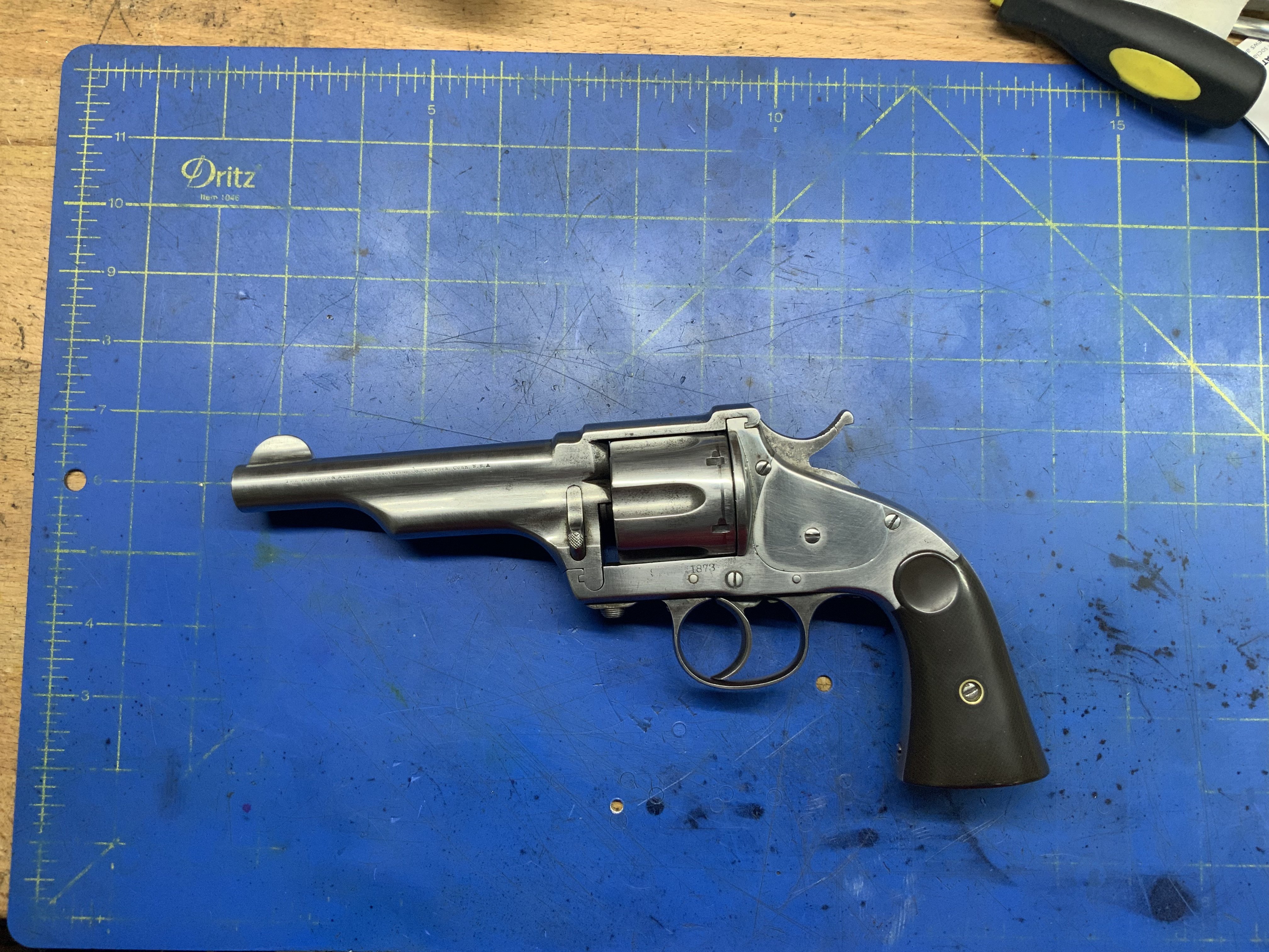

Lead Monger Posted December 12, 2025 Posted December 12, 2025 This fellow has .427 to .428 throats. 1 Quote
El Sobrante Kid Posted December 12, 2025 Posted December 12, 2025 10 minutes ago, Lead Monger said: This fellow has .427 to .428 throats. Beautiful MH! How does it shoot? I have been shopping for one for years but never found the right (for me) combination of condition and price. Quote
Lead Monger Posted December 13, 2025 Posted December 13, 2025 8 hours ago, El Sobrante Kid said: Beautiful MH! How does it shoot? I have been shopping for one for years but never found the right (for me) combination of condition and price. It’s not as tight as I would like and the half cock notch is damaged. I will shoot it a few times when I receive the 427 lube/sizer die I ordered. BP hand loads of corse. I have a little 32 that’s almost a twin. It’s a hoot in a side match. 1 1 Quote
