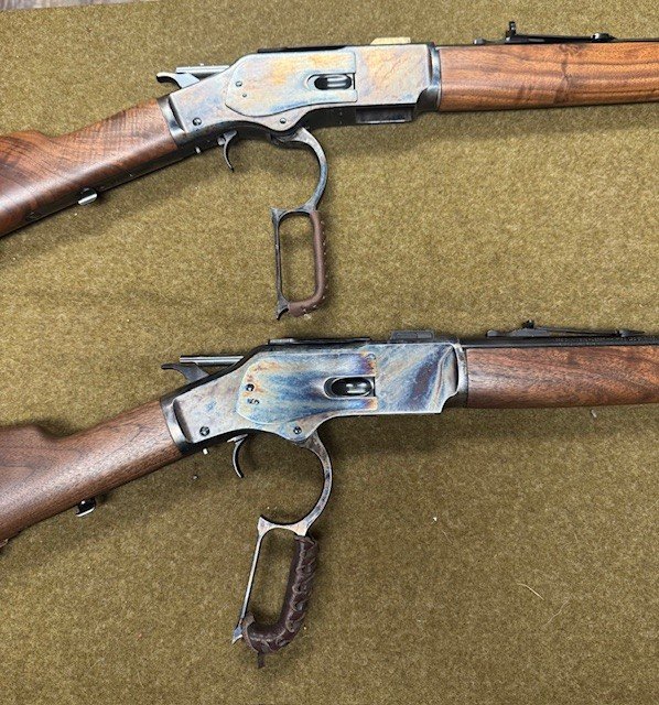

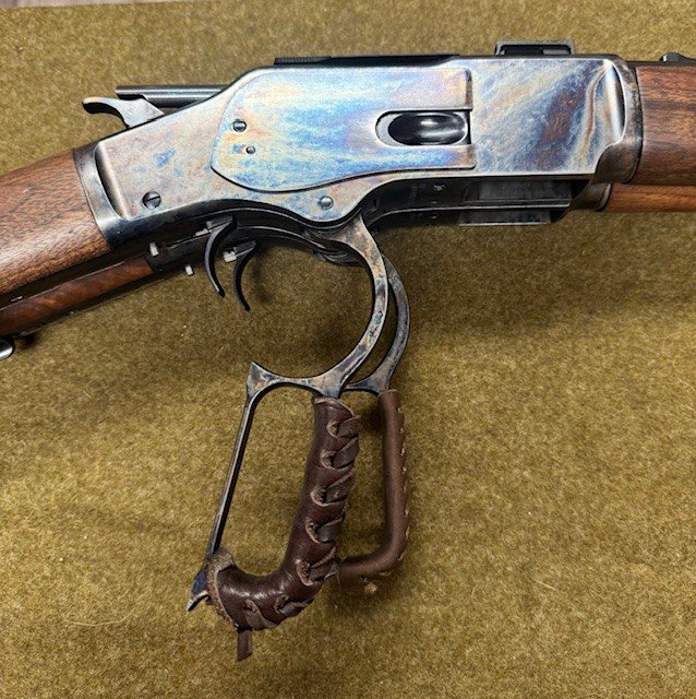

1st Sgt BearClaw Toklat Posted November 18, 2025 Posted November 18, 2025 For reference, the top Winchester is their standard model and the bottom one is the Competition carbine. The competition carbine has a shorter stroke. 4 5 Quote

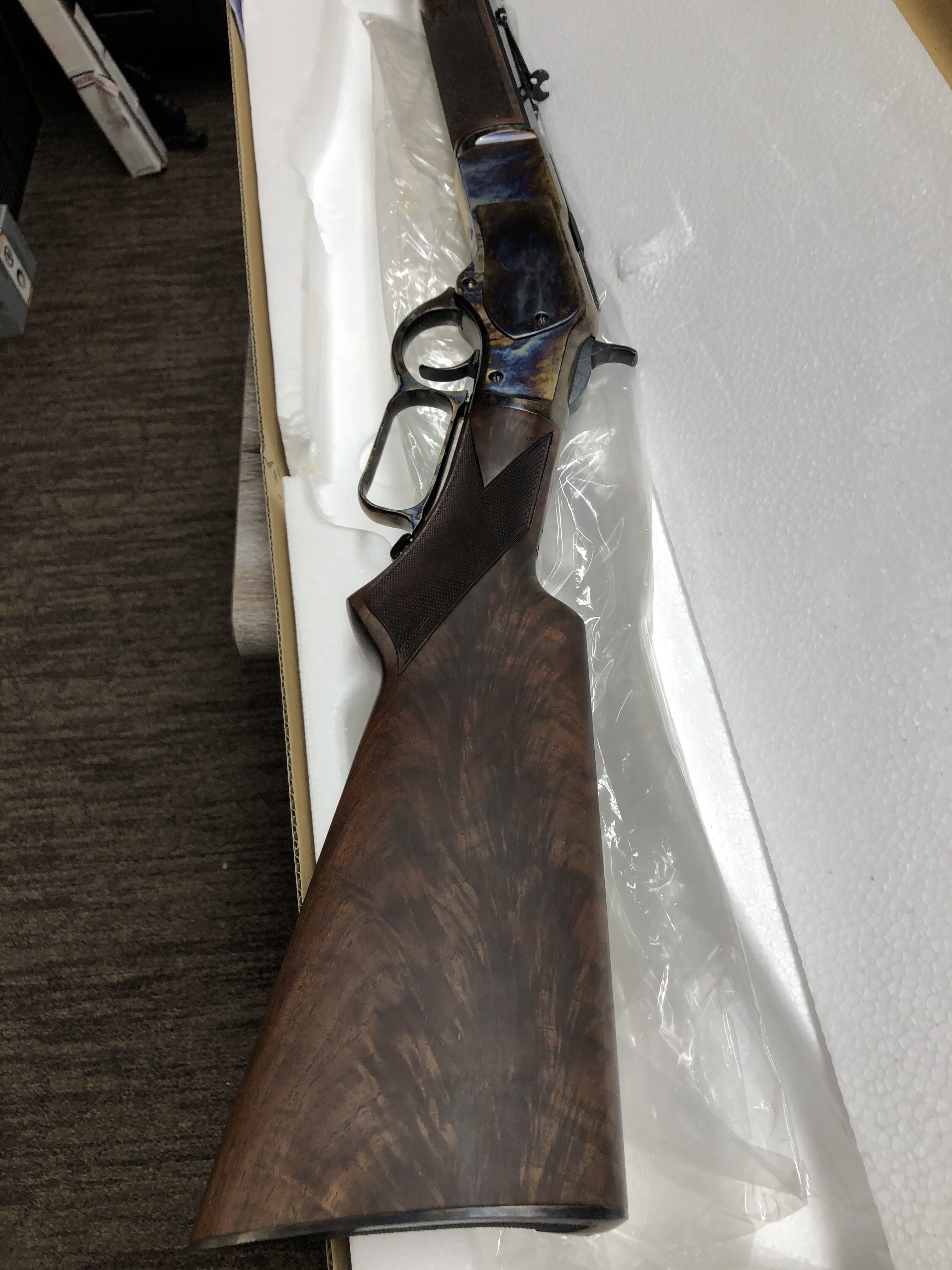

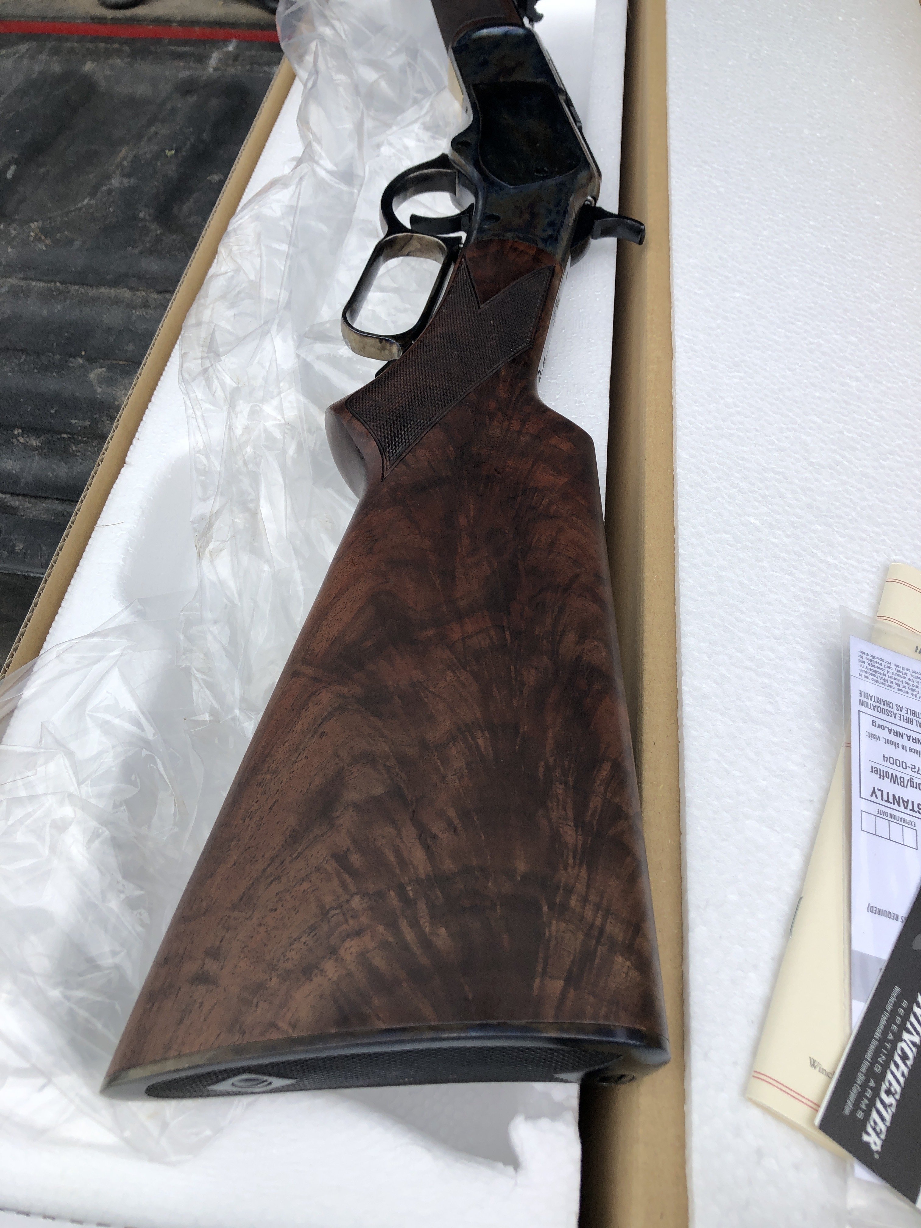

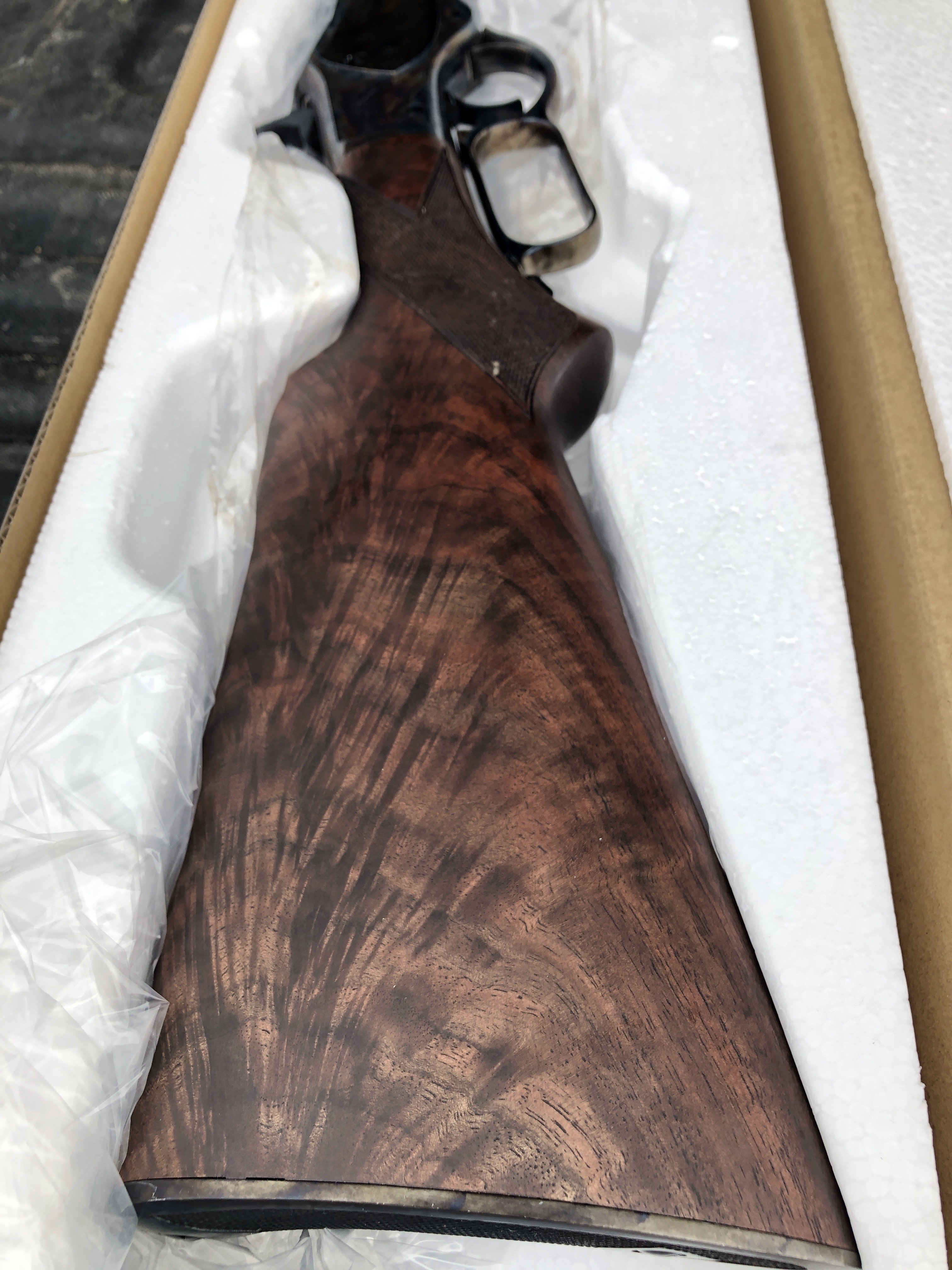

Fireball #7709 Life Posted November 21, 2025 Posted November 21, 2025 On 11/17/2025 at 3:28 PM, Waimea said: Winchester made by Miroku vs Uberti. I have heard and read that the new Winchesters are smooth right out of the box. Great but are they short stroked too? I have been poking around some gunsmiths' sites and found a lot fewer mods were available for the Winnies. Not sure if that means they don't need anything or other reasons. Those who have some experience with both, I would really like to hear your comparison. Thinking of going back to a straight stock vs deluxe grip too. They tend to run good "out of the box", but like virtually all mass produced firearms, can benefit from action work for competition use.(but then you know that) Are you going to get a super smooth, slick rifle from the factory? No. Plenty of folks have trouble getting that from their Uberti, after sending it to a gunsmith.(and you know that too.LOL) They are miles ahead of the Italians in machine work and quality of steel and wood though. They can have a few quirks, but fixes for those are known. There are at least 2 variations of stroke that are/have been available, one is a typical longer length, the other, close enough to the SASS rule minimum I don't notice.(seems stupid they offer both, but they missed the class on efficient manufacturing and poke a yoke principles apparently) Most aftermarket parts have come and gone and/or may be coming(low production runs), but due to the low demand, what is available, when it's available, is pricier. Factory replacement parts are a problem, but I have yet to break anything on the 4 I own and many parts like screws are mostly interchangeable with Uberti. Any parts problems I've seen, tend to stem from DIY'ers, DIYing something they should not have.... For your stock style dilemma, I offer a third option. Mirokus are available with a "shotgun style" butt stock on some models. It does not have a pistol grip, but has a higher comb, allowing a proper cheek weld. It is the same style you've seen me shoot on my Uberti's that I converted to, many years ago. Pictured is the one on my current main match Miroku gun(with factory short stroke links). Look at that wood!! *hand wringer note: this style stock was available from Winchester originally and is legal for SASS. 4 1 Quote
Waimea Posted November 21, 2025 Author Posted November 21, 2025 8 hours ago, Fireball #7709 Life said: They tend to run good "out of the box", but like virtually all mass produced firearms, can benefit from action work for competition use.(but then you know that) Are you going to get a super smooth, slick rifle from the factory? No. Plenty of folks have trouble getting that from their Uberti, after sending it to a gunsmith.(and you know that too.LOL) They are miles ahead of the Italians in machine work and quality of steel and wood though. They can have a few quirks, but fixes for those are known. There are at least 2 variations of stroke that are/have been available, one is a typical longer length, the other, close enough to the SASS rule minimum I don't notice.(seems stupid they offer both, but they missed the class on efficient manufacturing and poke a yoke principles apparently) Most aftermarket parts have come and gone and/or may be coming(low production runs), but due to the low demand, what is available, when it's available, is pricier. Factory replacement parts are a problem, but I have yet to break anything on the 4 I own and many parts like screws are mostly interchangeable with Uberti. Any parts problems I've seen, tend to stem from DIY'ers, DIYing something they should not have.... For your stock style dilemma, I offer a third option. Mirokus are available with a "shotgun style" butt stock on some models. It does not have a pistol grip, but has a higher comb, allowing a proper cheek weld. It is the same style you've seen me shoot on my Uberti's that I converted to, many years ago. Pictured is the one on my current main match Miroku gun(with factory short stroke links). Look at that wood!! *hand wringer note: this style stock was available from Winchester originally and is legal for SASS. Thanks for your post. I'm looking at that wood. IT'S GORGEOUS! And the shotgun style stock. Yep, love it. I am a DIY guy but so far I haven't messed anything up too badly...yet. I do not own a Dremel. I appreciate your words of wisdom. In the meantime those shiney open tops have caught my attention. 😜 1 Quote

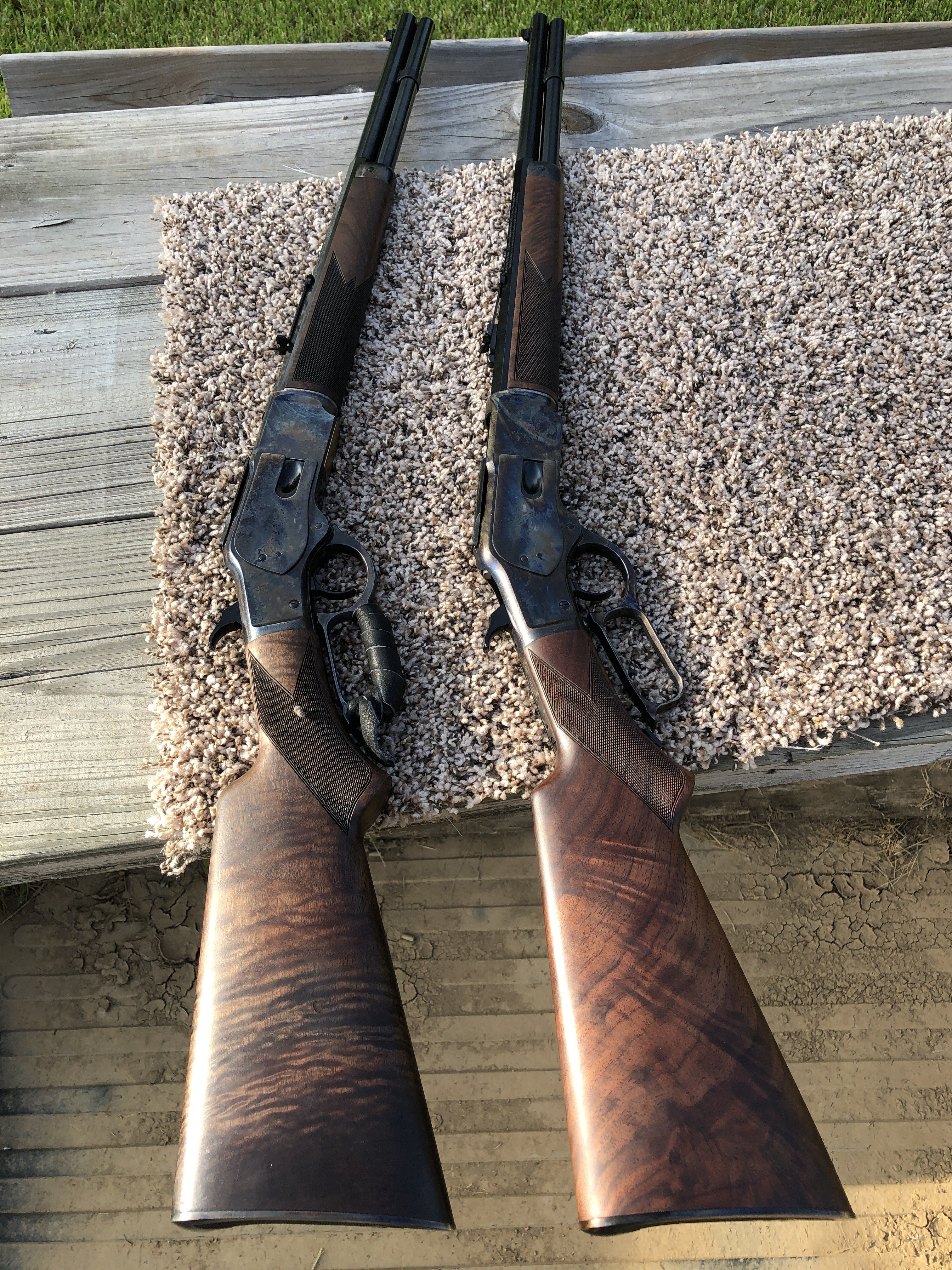

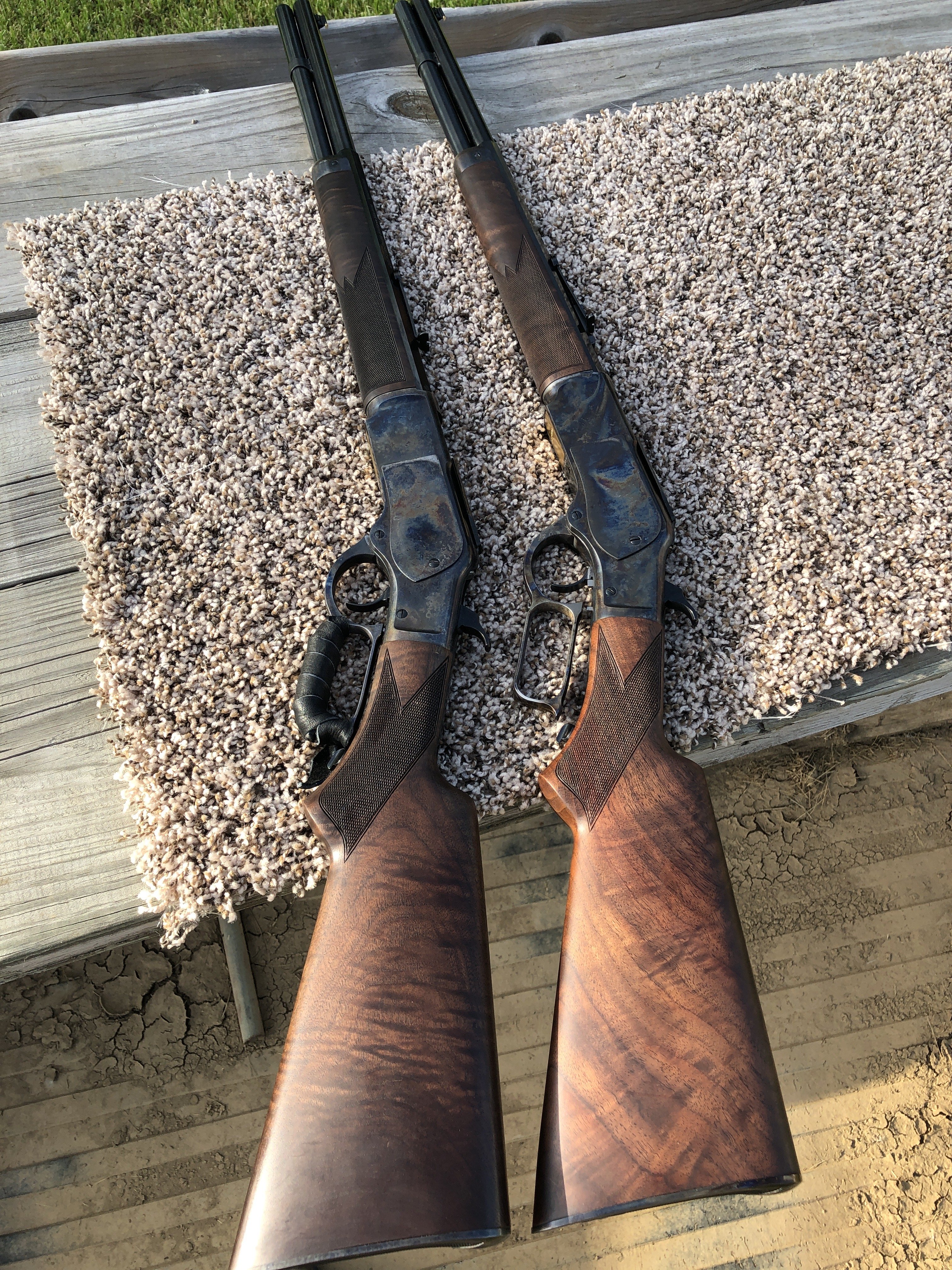

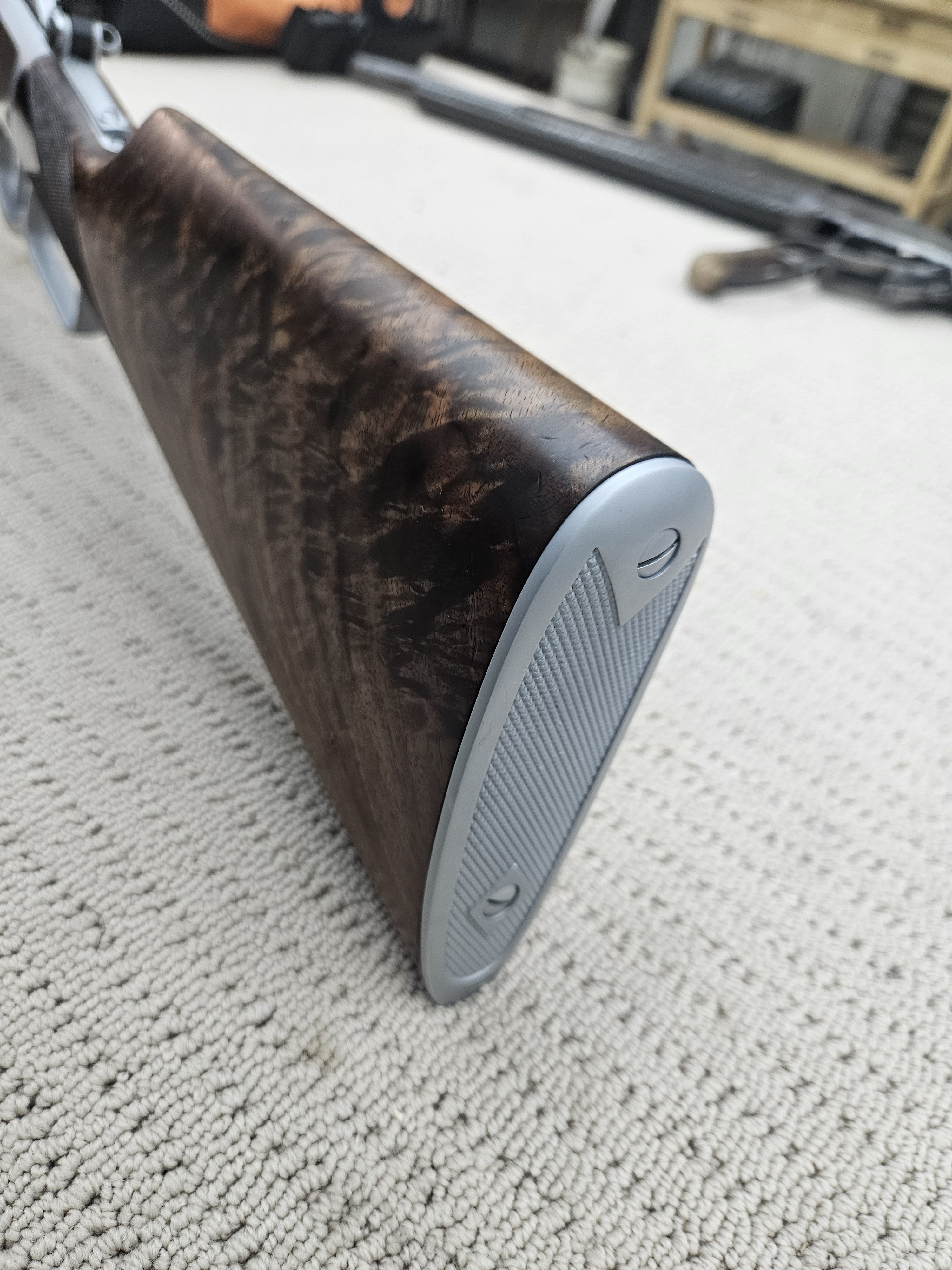

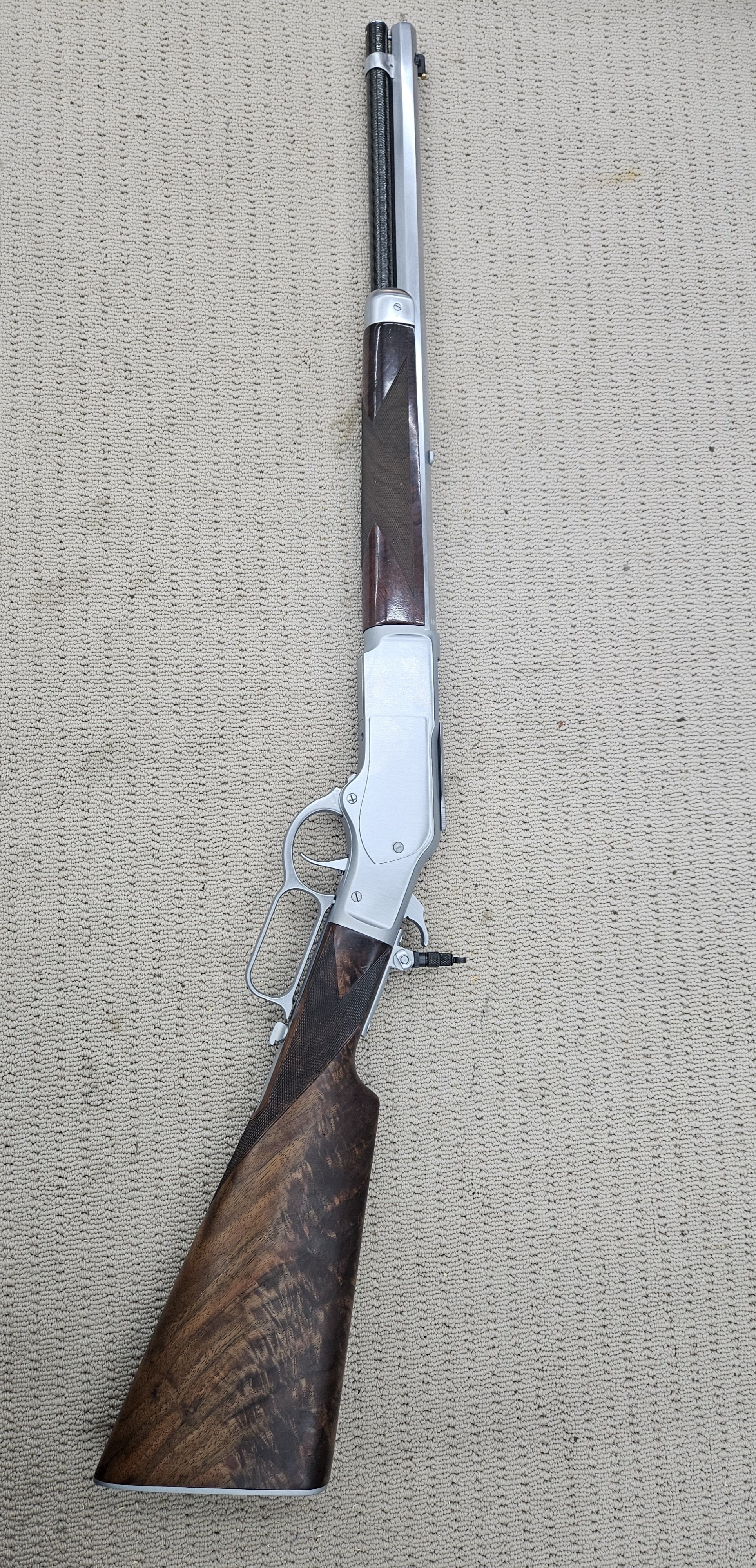

Three Gun Cole Posted November 22, 2025 Posted November 22, 2025 (edited) Short answer. After running Uberti’s for 15 years. Buy the winchester. Send it to Cowboy Carty. Run the heck out of it. Been running the snot out of the first Carty rifle that he did for me. 7 Years no breakdowns (Deluxe Winchester Sporting Rifle) I’ve never needed the backup that I had him build. the Winchesters are pretty too!!! IMG_4113_537.mov Edited November 22, 2025 by Three Gun Cole 5 1 Quote

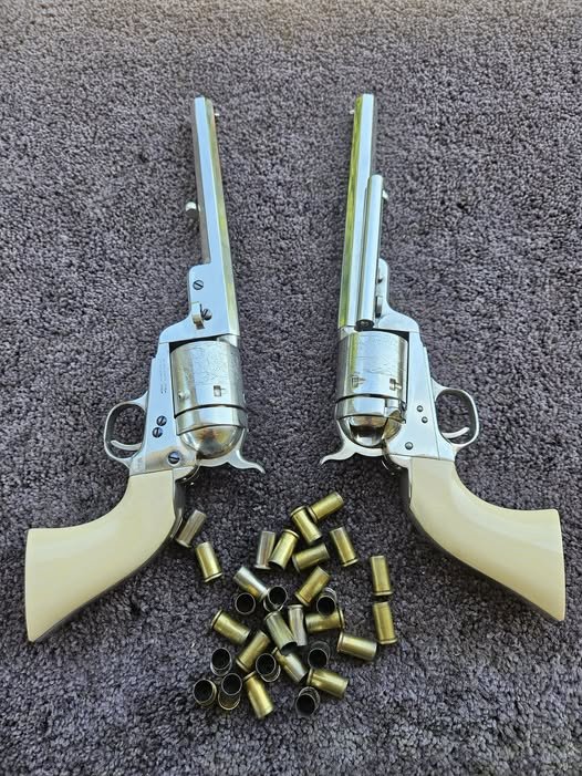

Fireball #7709 Life Posted November 22, 2025 Posted November 22, 2025 14 hours ago, Waimea said: Thanks for your post. I'm looking at that wood. IT'S GORGEOUS! And the shotgun style stock. Yep, love it. I am a DIY guy but so far I haven't messed anything up too badly...yet. I do not own a Dremel. I appreciate your words of wisdom. In the meantime those shiney open tops have caught my attention. 😜 you mean these?!😁 2 Quote
Waimea Posted November 22, 2025 Author Posted November 22, 2025 4 hours ago, Fireball #7709 Life said: you mean these?!😁 Ya big tease.😂 1 1 Quote
Abilene, SASS # 27489 Posted November 23, 2025 Posted November 23, 2025 13 hours ago, Fireball #7709 Life said: you mean these?!😁 Short Colts? Quote
Fireball #7709 Life Posted November 23, 2025 Posted November 23, 2025 (edited) 9 hours ago, Abilene, SASS # 27489 said: Short Colts? 38 special chambered guns, I was shooting up some old 38 short colt ammo that day. Edited November 23, 2025 by Fireball #7709 Life Quote
