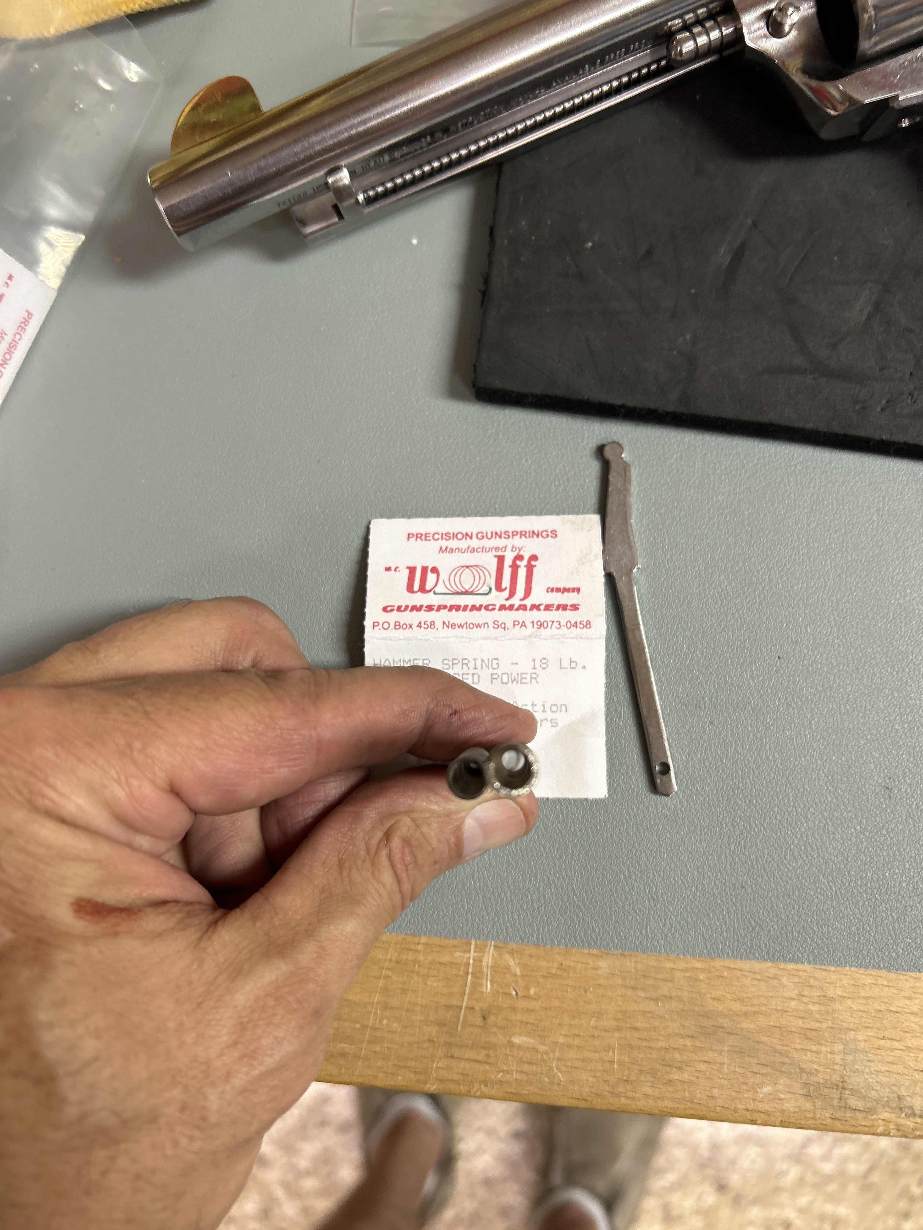

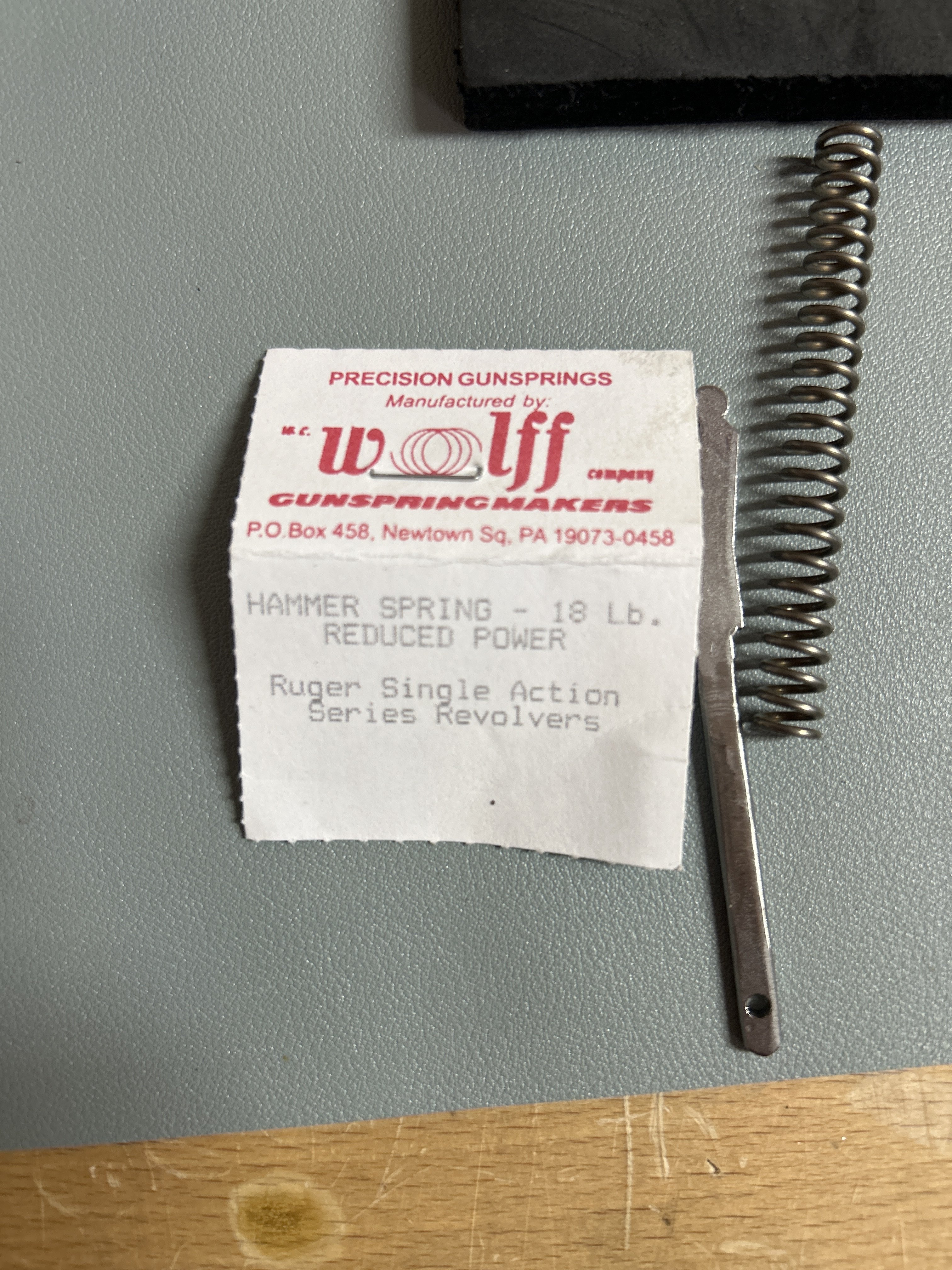

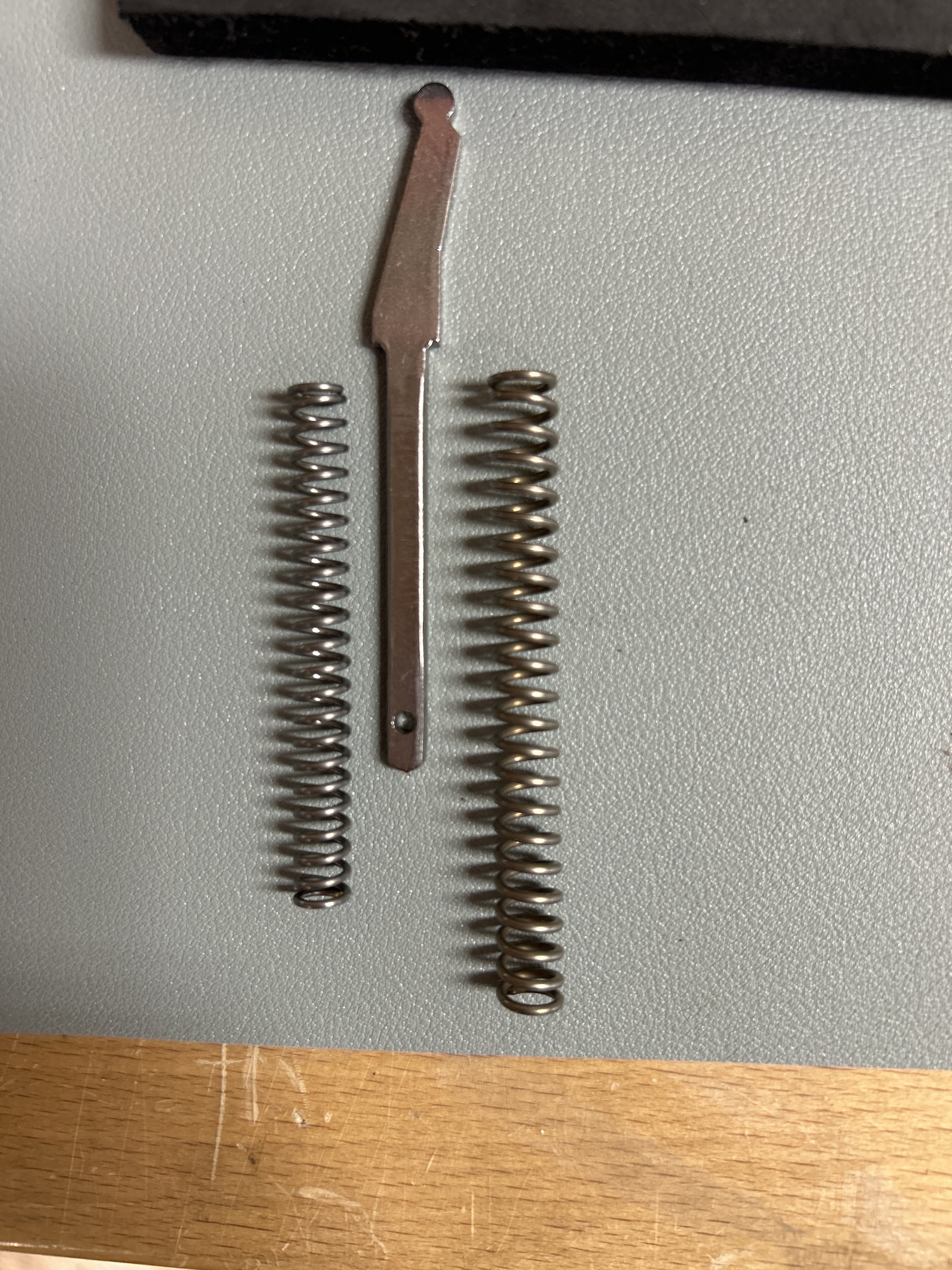

Tall John Posted November 18, 2025 Author Posted November 18, 2025 Well, I figured out my problem. Wolff shipped me the wrong hammer springs in one of my two spring packs Ruger I.D. 5.32mm wolff I.D. 4.78 mm Likely these smaller springs are for single sixes or something else. i opened the other spring pack I bought (same stock number and these are the same diameter as the Ruger and they slip right on! 1 Quote
The Original Lumpy Gritz Posted November 18, 2025 Posted November 18, 2025 8 minutes ago, Tall John said: Well, I figured out my problem. Wolff shipped me the wrong hammer springs in one of my two spring packs Ruger I.D. 5.32mm wolff I.D. 4.78 mm Likely these smaller springs are for single sixes or something else. i opened the other spring pack I bought (same stock number and these are the same diameter as the Ruger and they slip right on! The springs you received are for the Original Vaquero that came from the factory with 23lb hammer springs. NMV factory hammer spring is 17lb. Look at how different the length is..... You really need to call WOLF! Quote

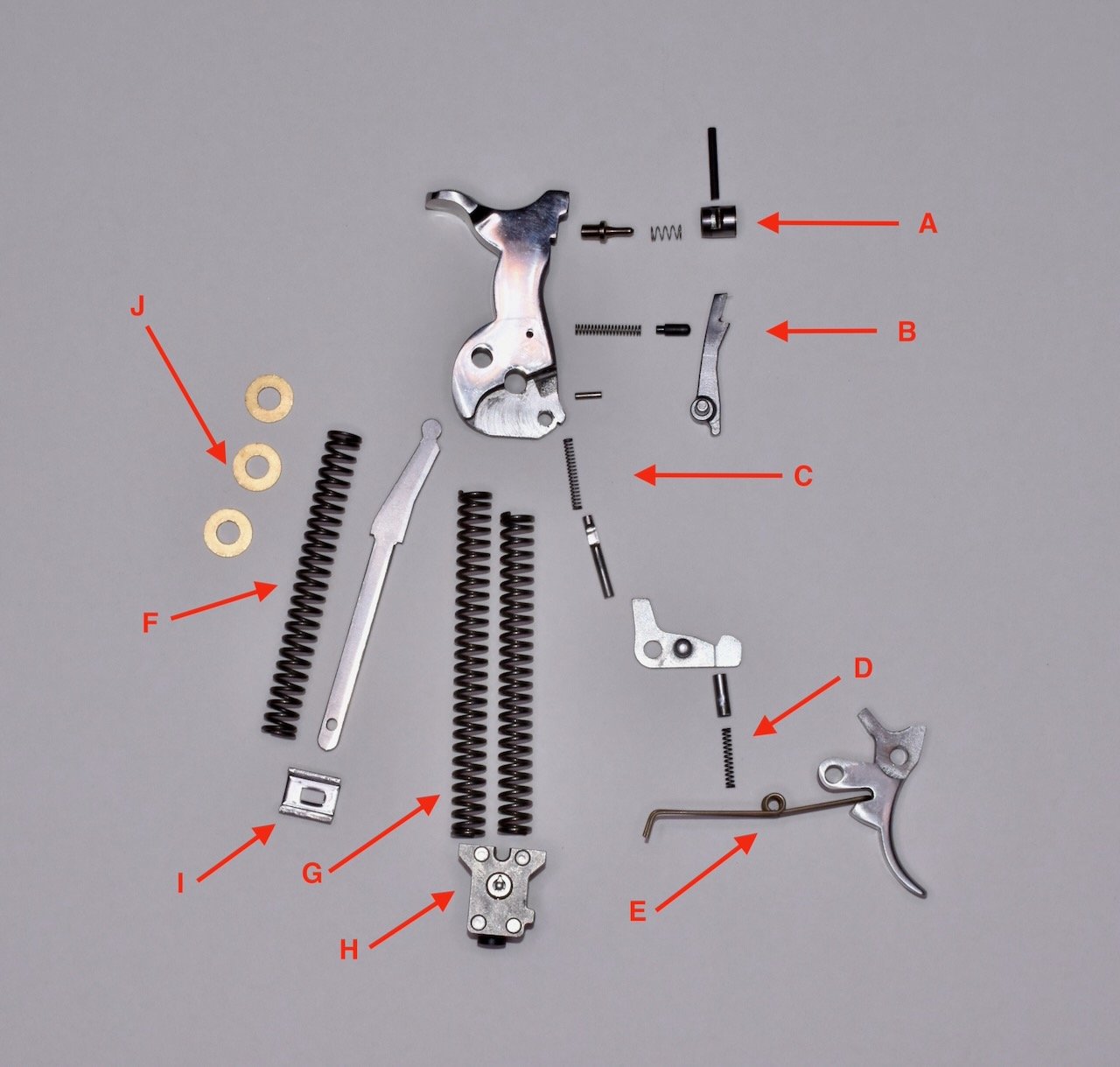

Larsen E. Pettifogger, SASS #32933 Posted November 18, 2025 Posted November 18, 2025 (edited) 23 minutes ago, The Original Lumpy Gritz said: The springs you received are for the Original Vaquero that came from the factory with 23lb hammer springs. NMV factory hammer spring is 17lb. Look at how different the length is..... You really need to call WOLF! The ID on the OMV, NMV and Single Six is the same. So let's just leave it as Wolf bagged a mystery spring. To make matters even more confusing when Ruger went from the OMV to the NMV the mainspring was shorter to make up for the space taken by the in-the-grip safety block. Current NMVs no longer have the safety block and use the old OMV length spring. H is the safety block and I is what is currently used and is the same as the OMV. Edited November 18, 2025 by Larsen E. Pettifogger, SASS #32933 2 Quote
The Original Lumpy Gritz Posted November 18, 2025 Posted November 18, 2025 2 minutes ago, Larsen E. Pettifogger, SASS #32933 said: The ID on the OMV, NMV and Single Six is the same. So let's just leave it as Wolf bagged a mystery spring. To make matters even more confusing when Ruger went from the OMV to the NMV the mainspring was shorter to make up for the space taken by the in-the-grip safety block. Current NMVs no longer have the safety block and use the old OMV length spring. I'll bet he received a NMV 'lock' spring. Wolff Gunsprings will make if 'rite'. Quote
Tall John Posted November 19, 2025 Author Posted November 19, 2025 (edited) called ‘em today. Replacements on the way! No charge! Great customer service from Wolff! Edited November 19, 2025 by Tall John Update 1 Quote
