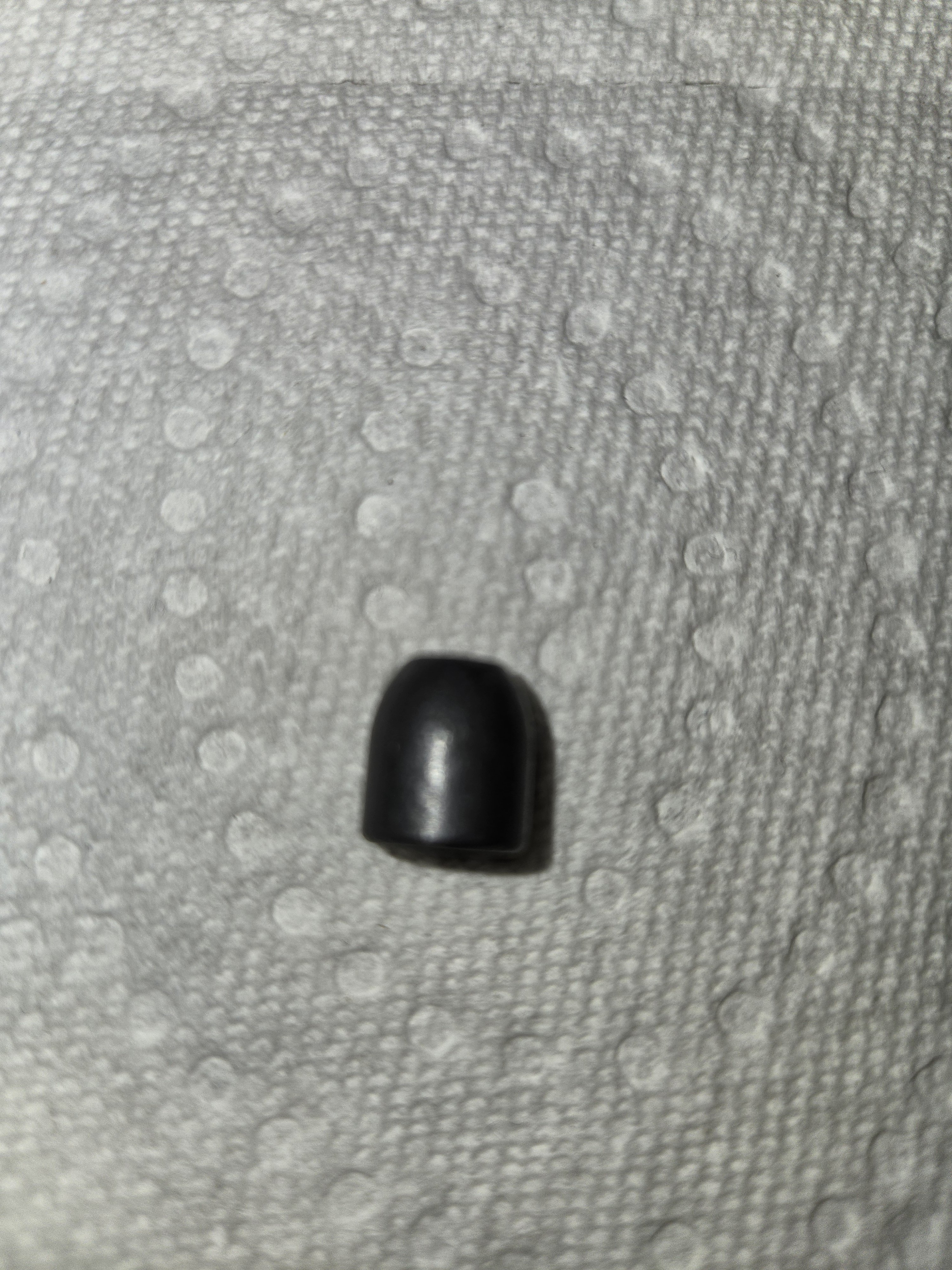

Beartrap SASS#57175 Posted November 11, 2025 Posted November 11, 2025 Especially with APP the bullet weight has a bigger effect on recoil than a couple grains of powder. Those little 95/96 grain pills will really reduce the recoil over 125 gr bullets and in a revolver overall cartridge length doesn't matter. There's no crimp grove, so you can seat them deep to reduce the amount of APP used. They're made by Bear Creek Bullets and I use them for the kids in my NS classes. 2 Quote

Done Gone, SASS #49052 Posted November 11, 2025 Posted November 11, 2025 3 different APP loads I’ve used. 1cc of powder with an 1/8” card wad from circle fly wads. Any 125gr bullet works fine. You can use 1.3cc with the 125gr bullet, with no wad or filler. Either of these loads work fine in rifle and pistol. I’ve also used the 1cc load with a 140gr dewc right down on the powder. The dewc is nice for hewvy knockdowns, but it won’t work in the rifle. 1 Quote
