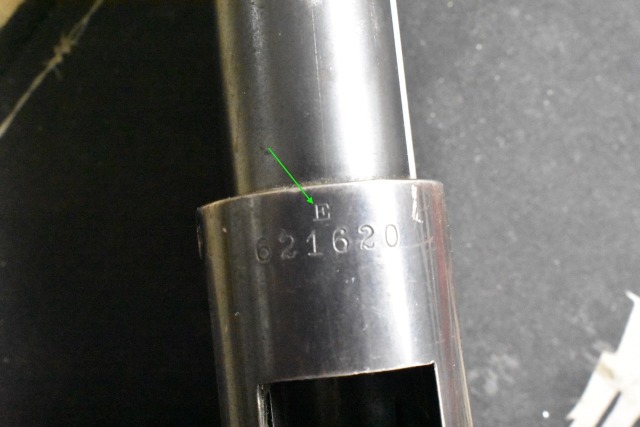

Larsen E. Pettifogger, SASS #32933 Posted November 9, 2025 Posted November 9, 2025 (edited) 97s will come with one of three prefix letters stamped over the serial number. C, D and E. (See photo.) Each higher letter has improvements. I would avoid the C models and look for an E if possible. The newest 97s are 70 years old. Part of the reliability issue is people buy junk thinking they can fix them up for competition. There were over one million made so look for one in as good of condition as you can find. The better the condition usually means the fewer things that need fixing. P.S. The days of "for cheap" 97s are long gone. Edited November 9, 2025 by Larsen E. Pettifogger, SASS #32933 7 Quote
