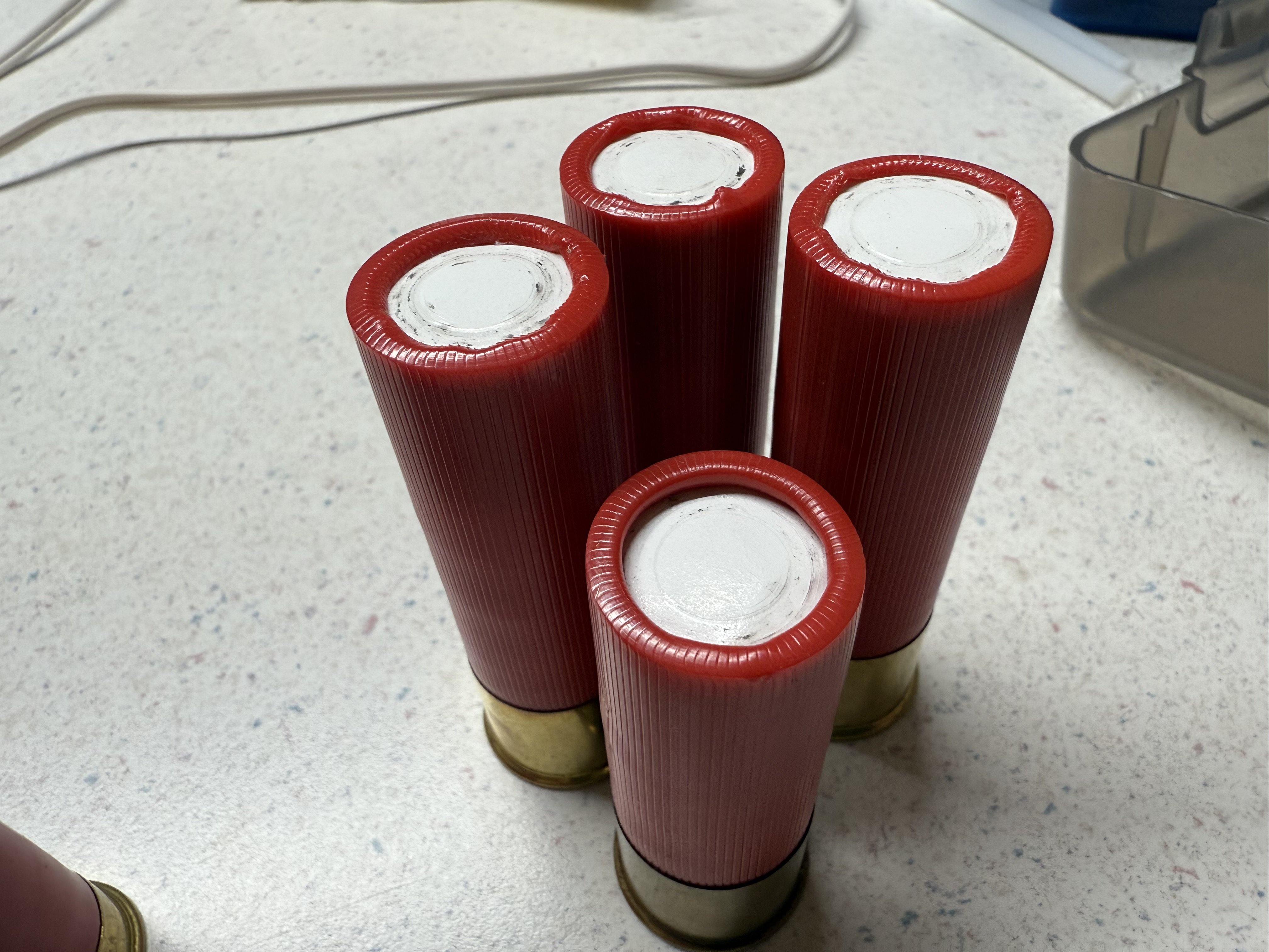

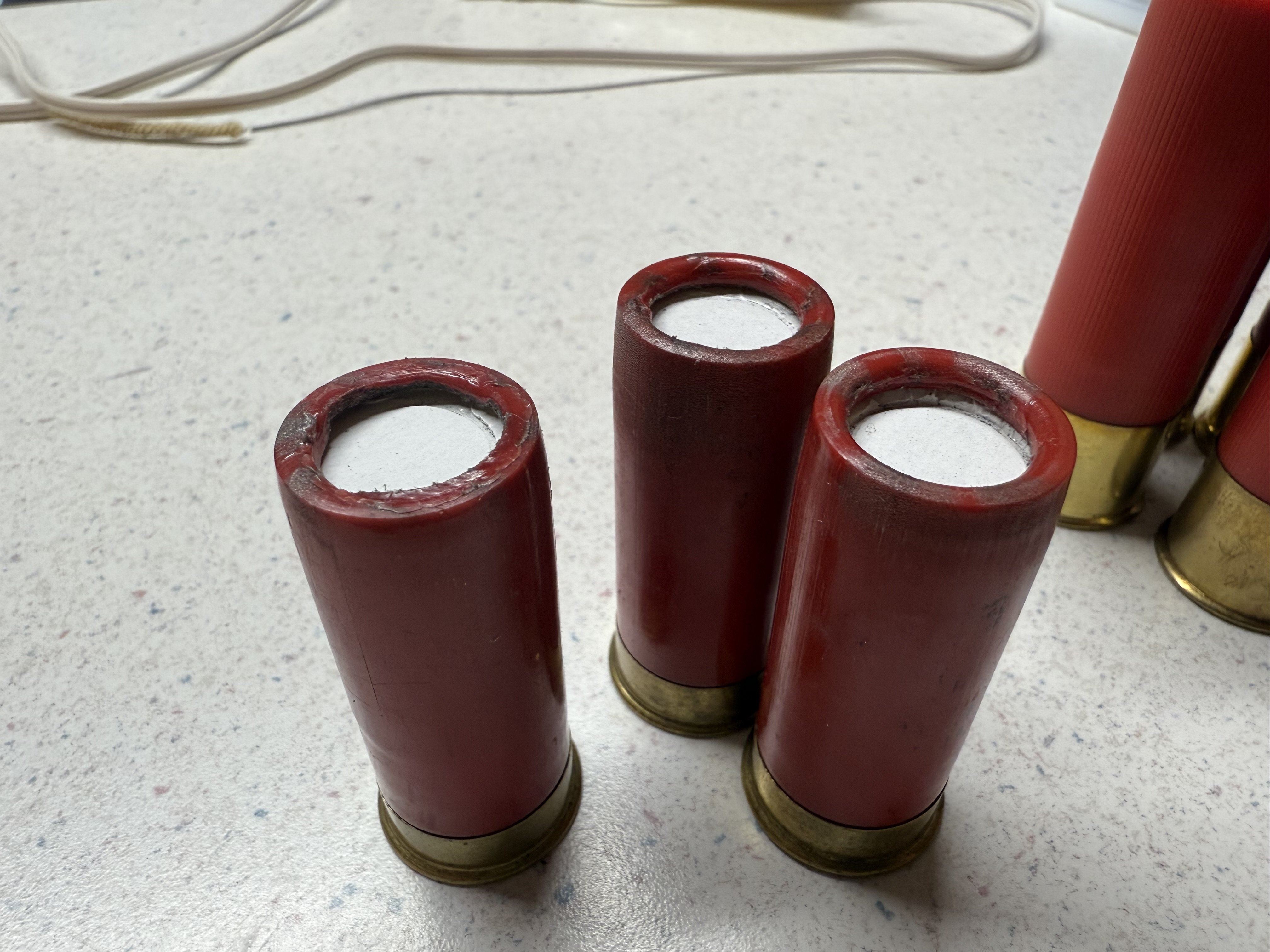

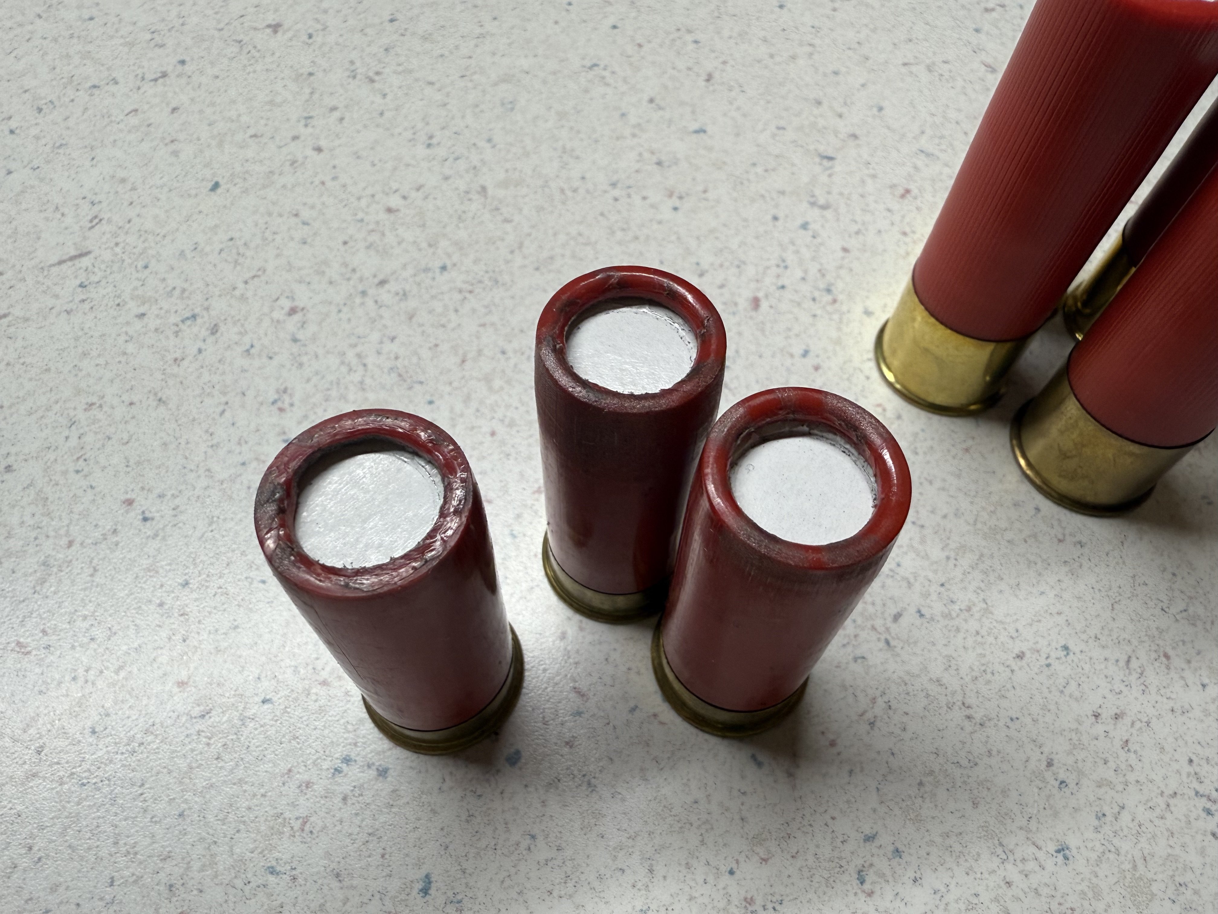

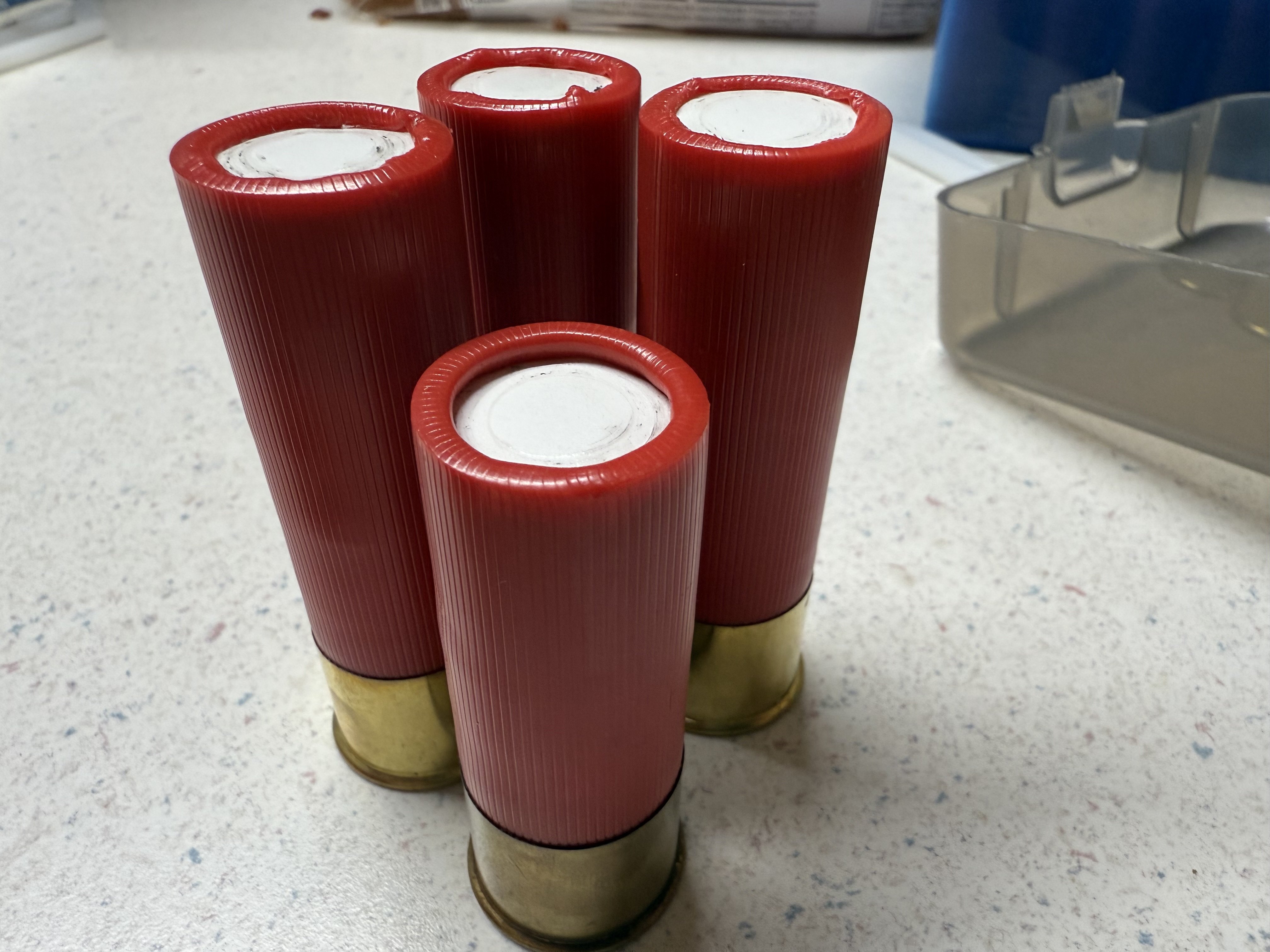

KatfishKid Posted November 7 Posted November 7 Trying to learn how to load shotgun shells by hand. I bought some 2 3/4" primed hulls to mess around with and I'm starting to wonder how much roll crimp is too much. The shell on the right has a more full column, but I believe its too long for my 2 3/4" chambered shotgun. The one in the middle is closer to the length of a factory shell, but the roll crimp looks extreme. Obviously trimming the hull would solve that, but I'm wondering if it's necessary? Quote
Boggus Deal #64218 Posted November 7 Posted November 7 You do realize a shell and chamber is measured by the fired length of the case. Not the crimped length. If you measure that factory load, it will likely come out around 2 1/2” long, roughly. Fired, it will measure 2 3/4”. Quote
KatfishKid Posted November 7 Author Posted November 7 Just now, Boggus Deal #64218 said: You do realize a shell and chamber is measured by the fired length of the case. Not the crimped length. If you measure that factory load, it will likely come out around 2 1/2” long, roughly. Fired, it will measure 2 3/4”. Well, I do now that someone explained it to me. Regardless, will a deep crimp cause issues I should be aware of? If not, if not, it'll save on component usage. 1 Quote
Boggus Deal #64218 Posted November 7 Posted November 7 Not having needed to roll crimp, I have no experience. My question would be is how well the long roll crimp would unfold. Personally, I would trim the cases to keep the crimp to a minimum. That deep of a roll crimp has to unfold 180° to open fully. If it doesn’t open fully and the shot column pushes past the fold, pressure may spike. 1 Quote

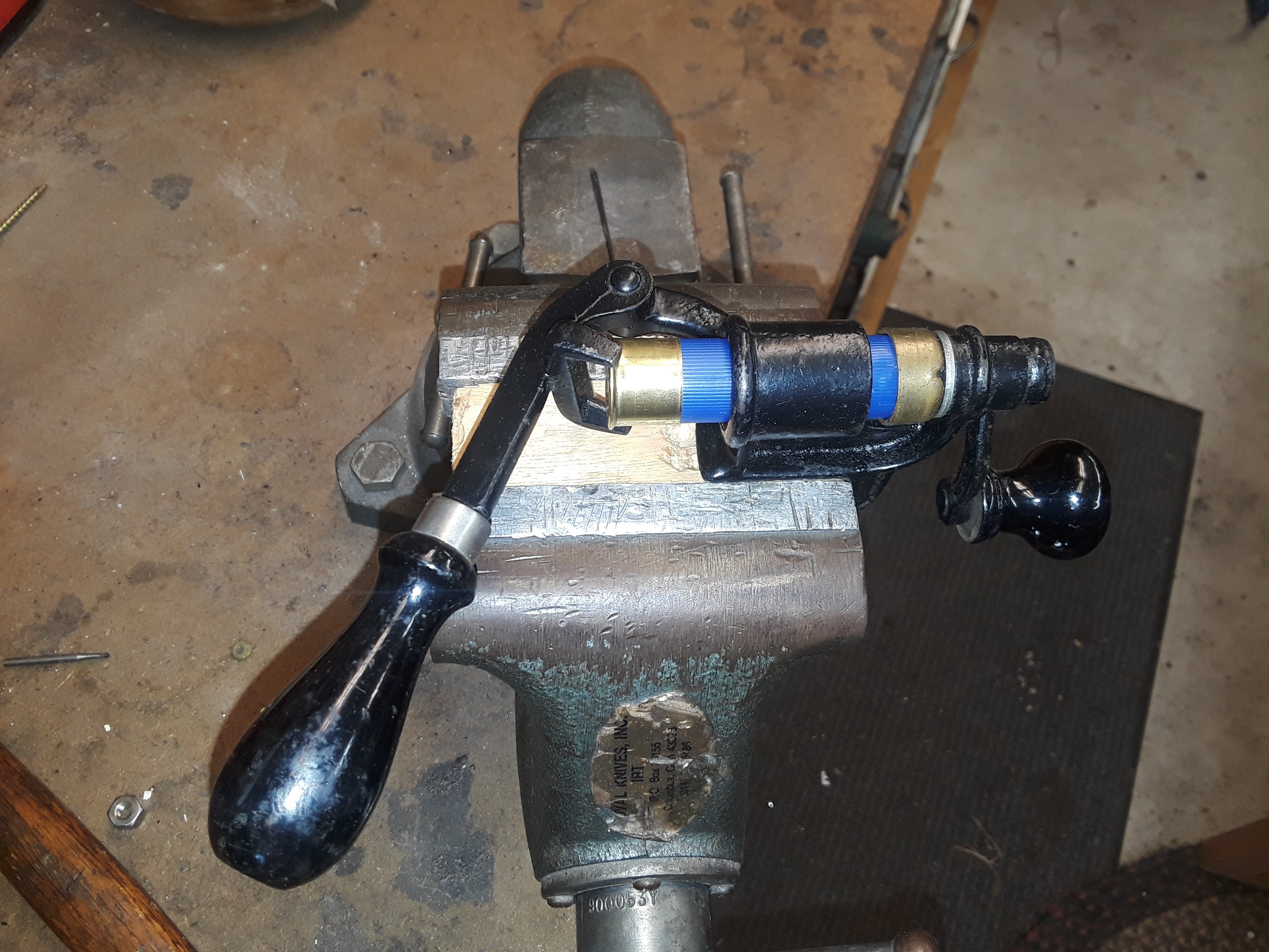

Eyesa Horg Posted November 10 Posted November 10 I had good results with one of the antique hand crank roll crimpers. Only issue was the over short card falling out sometimes when inserting into the crimper. Keep a bucket/ box under it. Next time I'll try mounting it vertical!! 1 Quote
KatfishKid Posted November 10 Author Posted November 10 1 hour ago, Eyesa Horg said: I had good results with one of the antique hand crank roll crimpers. Only issue was the over short card falling out sometimes when inserting into the crimper. Keep a bucket/ box under it. Next time I'll try mounting it vertical!! Yeah, I dumped 3 rounds worth of shot on the floor before I had the forehead slap moment and mounted it vertically. 1 Quote

Lucky R. K. Posted November 10 Posted November 10 4 minutes ago, KatfishKid said: Yeah, I dumped 3 rounds worth of shot on the floor before I had the forehead slap moment and mounted it vertically. You can also slip the overshot card into the hull to hold the shot while inserting the hull into the crimper. Lucky Quote
Eyesa Horg Posted November 10 Posted November 10 2 hours ago, Lucky R. K. said: You can also slip the overshot card into the hull to hold the shot while inserting the hull into the crimper. Lucky The issue comes when the card falls out before the shell is all the way in! Quote
Lucky R. K. Posted November 11 Posted November 11 21 hours ago, Eyesa Horg said: The issue comes when the card falls out before the shell is all the way in! If your card is the correct size it will not fall out. It will fit snuggly to the case walls. Lucky Quote
Eyesa Horg Posted November 11 Posted November 11 1 hour ago, Lucky R. K. said: If your card is the correct size it will not fall out. It will fit snuggly to the case walls. Lucky Except for those that don't!! 1 Quote
KatfishKid Posted November 11 Author Posted November 11 3 hours ago, Eyesa Horg said: Except for those that don't!! Yeppers. I found a lot of inconsistencies with shotgun loading components when it comes to sizing. Even using 11ga cards some of them just fall out or they're nearly impossible to get in without creasing/deforming. 1 Quote
Eyesa Horg Posted November 11 Posted November 11 51 minutes ago, KatfishKid said: Yeppers. I found a lot of inconsistencies with shotgun loading components when it comes to sizing. Even using 11ga cards some of them just fall out or they're nearly impossible to get in without creasing/deforming. If you're using a MEC , lay the overshot card in the wad fingers and use the wad ram to put it in the hull. It won't cause anything else to activate. Thank you Doc McCoy! Quote
