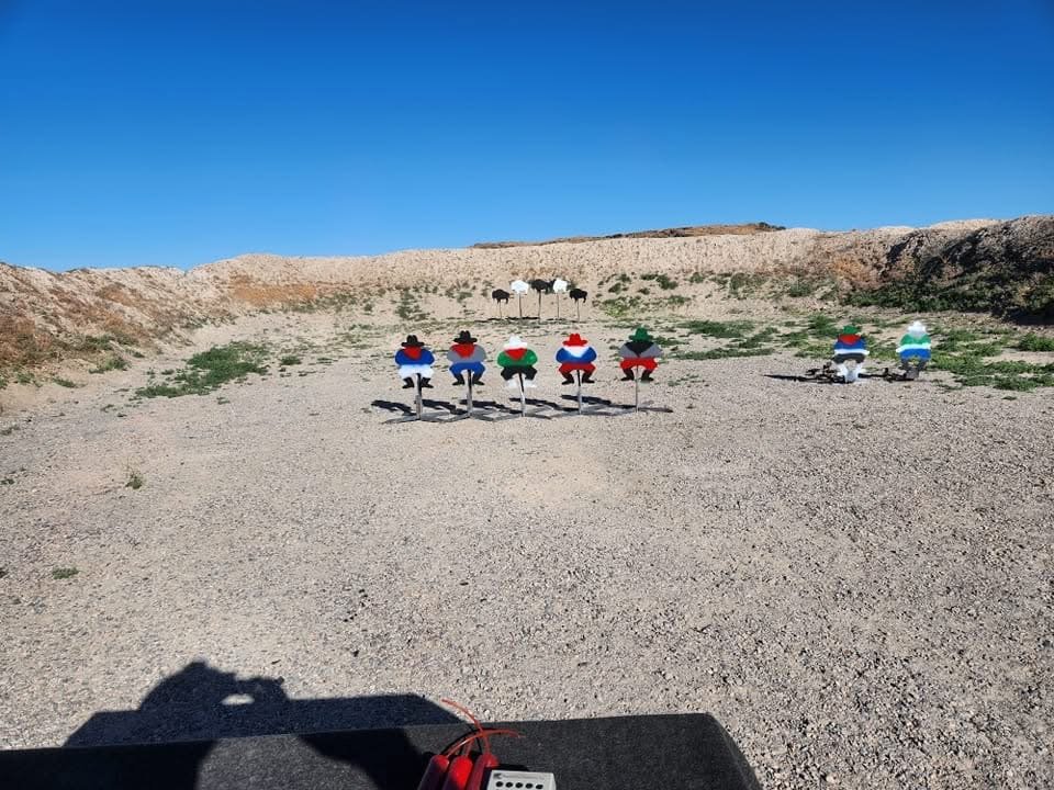

Dusty Driver Posted November 13, 2025 Posted November 13, 2025 On 11/11/2025 at 12:30 PM, Beartrap SASS#57175 said: You guys actually "aim" at SASS targets? A 40cm by 40 m (16x16in) target at 10 meters (34ft). Yea I use my sights. However, I get it. I winter in Texas where you have to be careful how far you lean forward. Lean to far and you hit them with the barrel of your revolver. 1 Quote

Texas Maverick Posted November 13, 2025 Posted November 13, 2025 (edited) 16 hours ago, Dusty Driver said: A 40cm by 40 m (16x16in) target at 10 meters (34ft). Yea I use my sights. However, I get it. I winter in Texas where you have to be careful how far you lean forward. Lean to far and you hit them with the barrel of your revolver. Now Dusty, we can start having you shoot the rifle targets with pistols and cody dixon targets for rifle ifn that makes you feel more at home. LOL We aim to please. TM Edited November 13, 2025 by Texas Maverick 3 Quote
