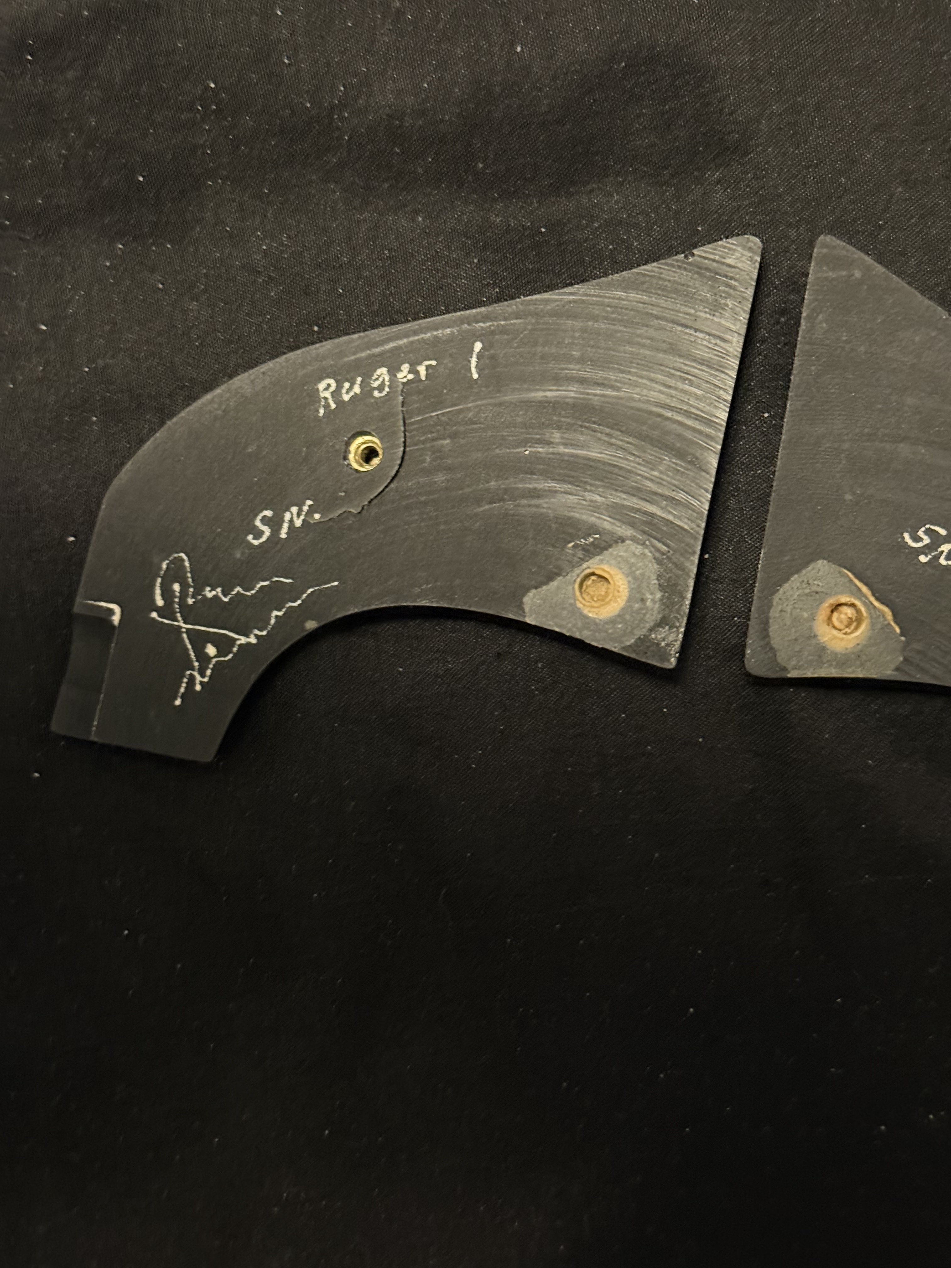

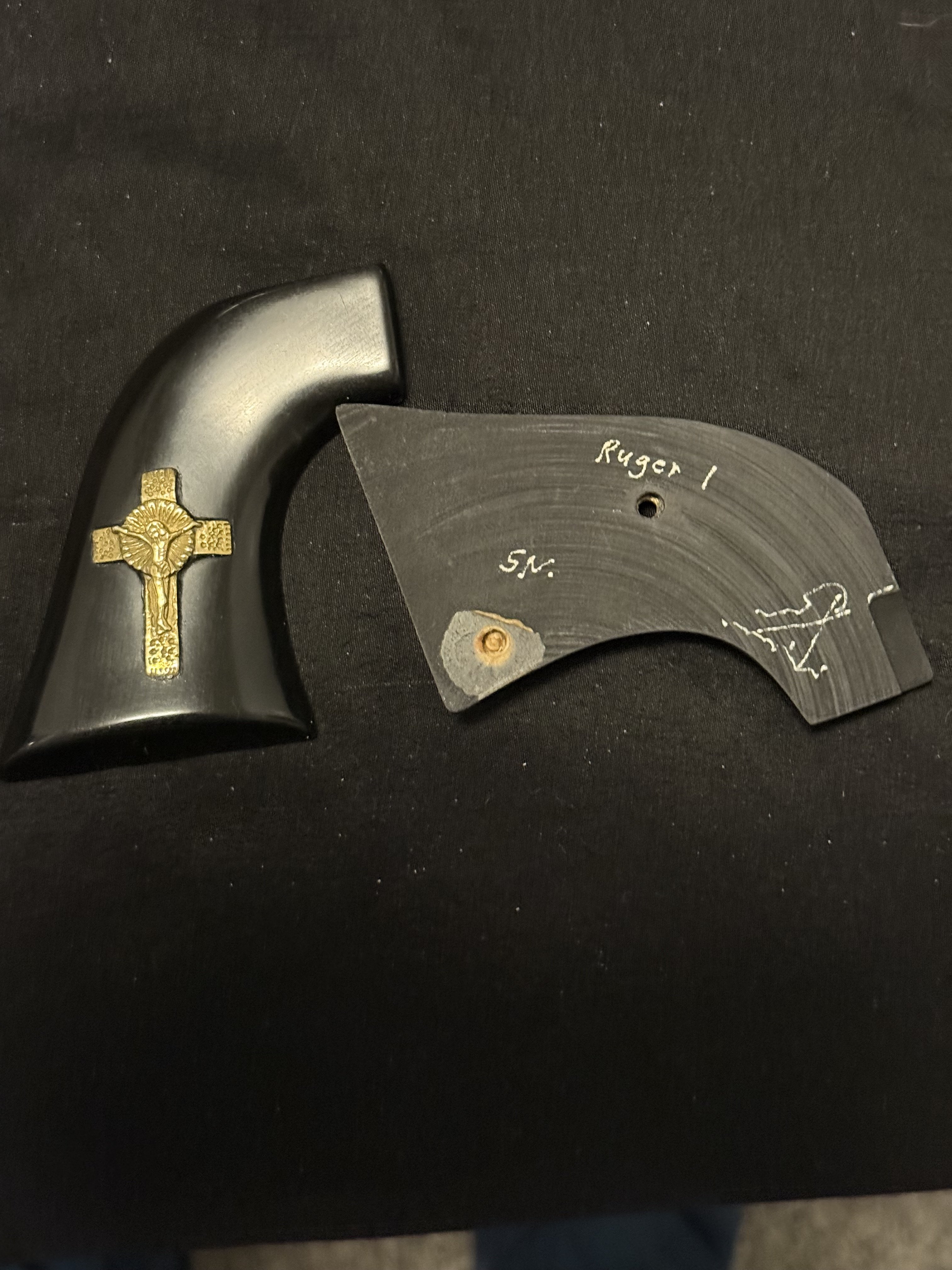

Chicago kidd Posted November 7, 2025 Posted November 7, 2025 I bought these grips a while back for my Ruger single six but I don't remember who made them can someone recognize the maker I'm trying to find the screw that holds then since I lost the orignal Quote
Cemetery Posted November 7, 2025 Posted November 7, 2025 Joe Perkins used to make Hand of God grips, was this him? https://classicsingleaction.com/contact/ Quote

Wild Willi Posted November 7, 2025 Posted November 7, 2025 Looks like the screws were over tightened it is going to be hard to remove the escutcheon with out messing up the grips 1 Quote
Rooster Ron Wayne Posted November 7, 2025 Posted November 7, 2025 7 hours ago, Wild Willi said: Looks like the screws were over tightened it is going to be hard to remove the escutcheon with out messing up the grips Probably better off putting some epoxy on it and knocking the broken peace back in place . Then Don't Over Tighten the screw ! Quote
Colorado Coffinmaker Posted November 7, 2025 Posted November 7, 2025 I use to make a sleeve to fit between the grip panels from ball point pen bodies (Bic) to prevent over stressing the panels when tightening the escutcheon screws. Quote
Wild Willi Posted November 7, 2025 Posted November 7, 2025 Best fix is to press the piece back in place after putting some epoxy on the broken out piece the get a thin metal washer and epoxy it over the hole hold this with a clamp until dry 1 Quote
El Sobrante Kid Posted November 7, 2025 Posted November 7, 2025 57 minutes ago, Wild Willi said: Best fix is to press the piece back in place after putting some epoxy on the broken out piece the get a thin metal washer and epoxy it over the hole hold this with a clamp until dry Don't forget to put a piece of waxed paper between the clamp and the washer. 1 Quote
