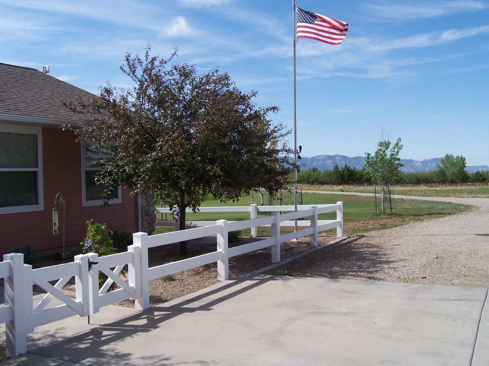

Dapper Dave Posted November 6, 2025 Posted November 6, 2025 No, not a new gun, holster, belt, reloading tool, nothing like that, just something I've kind of wanted for years, and never could get, until my loving wife bought a kit. Then I paid a soldier in need to get the foundation done. Concrete set for two days, and up she went today. Ain't she a beaut?

Dapper Dave Posted November 7, 2025 Author Posted November 7, 2025 Hmm, I didn't know that about grounding...but it's aluminum, not steel. We haven't had a lightning strike anywhere near the house or property in...I think decades. We do get some good thunderstorms once in a great while, but our usual problem is wind. Now looking at that link, I might not have gotten it quite deep enough, being about 2.5 feet of pole in the concrete, but we'll see. Maybe a couple of guy wires?
John Kloehr Posted November 7, 2025 Posted November 7, 2025 28 minutes ago, Dapper Dave said: Hmm, I didn't know that about grounding...but it's aluminum, not steel. We haven't had a lightning strike anywhere near the house or property in...I think decades. We do get some good thunderstorms once in a great while, Aluminum or steel does not matter, the ground potential is at the top of that conductive pole. Lightning is weird. But drive a copper ground rod 8" deep within a few feet of the pole and connect a thick copper wire to it. A rule of thumb, which does not quite match the science (I have a book on this). is to look up at something which you think might get struck. If it is less than 30 degrees off of straight up, then lightning can strike it and then you (don't stand under a tree or flag pole). If it is more than 60 degrees down from vertical, then lightning can strike you directly. At about 45 degrees, the object is more likely to be struck than you are and less likely to jump to you. Percentage odds, as under the most tightly controlled conditions, lightning is going to do whatever it does. I was outside once in a back yard and lightning struck the power pole in the neighbors yard, then "ignored" the ground wire on it and jumped to ground elsewhere in the yard. We found the burned patch of lawn and "glass" (dug it up, about a foot long) from the strike a couple days later.
