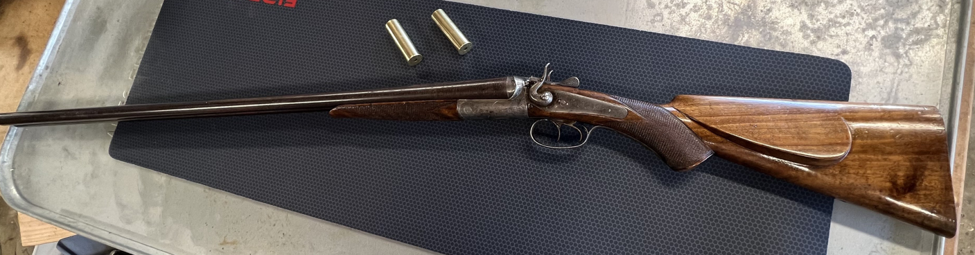

Hello pards,
I'm picking up a Belgian 16 gauge today from my FFL (thanks Dusty Morningwood).  I also received 2 boxes of 16 ga MagTech all brass shells from Ballistic Products along with what I believe are all the shot, wads, and cards I'll need.  I would like to open the floor to opinions on best loads for CAS.

Jiminy, I also picked up an older Belgian 16ga from Dusty, old enough to not be proofed for smokeless..  It is a great gun.  I have not used it in a match yet, but I did load up some brass shells.  They shot quite well at the range, kind of a soft load I guess.  only 16ga I ever shot so hard to judge.  Since it is well over a century and a quarter old, I dont feel the need to shoot hot loads in it.  Have not tried them against knock downs yet, but dont think I will have an issue.  Heck, the barrel is almost long enough to reach out and push them over.  My load was a 2.5 lee dipper of FFg (about 38 grains) and 7/8 oz 75 shot.  Same other components as you except I used Elmers Glue All rather than the waterglass.
