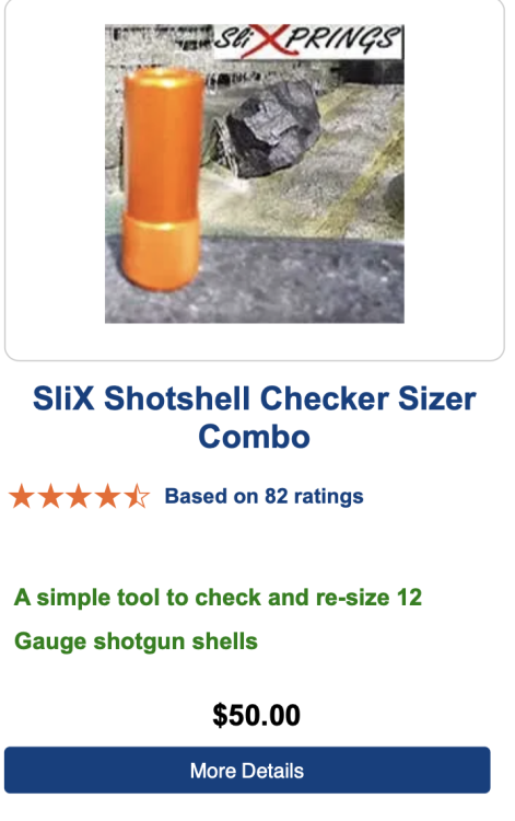

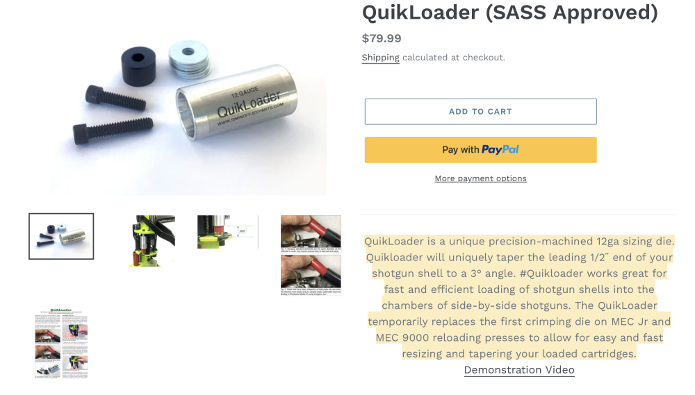

Tarheel Doc Posted November 4, 2025 Posted November 4, 2025 This is what I do with my shotgun shells. I use Remington STS for matches. I use the Cowboy Edge shotshell taper tool and then check every round before I shoot with a Slix shotshell checker. If they don't gauge I don't use them in my double barrel. I have not found that an empty shell won't shuck if I follow this method.
Chickamauga Slim Posted November 4, 2025 Posted November 4, 2025 +1 for the Average Joe Taper tool. Add Snake Oil John's shotgun chamber lube (Buffalo Snot) and you'll see a difference. (Scarlett sells Snake Oil John's elixir).
Waimea Posted November 4, 2025 Author Posted November 4, 2025 13 minutes ago, Tarheel Doc said: This is what I do with my shotgun shells. I use Remington STS for matches. I use the Cowboy Edge shotshell taper tool and then check every round before I shoot with a Slix shotshell checker. If they don't gauge I don't use them in my double barrel. I have not found that an empty shell won't shuck if I follow this method. From the Cowboy Edge website: "Shooters have seen improvement in both ease of loading and shucking shells." Bolding is mine. This is kind of where I was heading. Have you ever tried anything other than SKS?
SGT. ELI 35882 GUNFIGHTER Posted November 4, 2025 Posted November 4, 2025 The taper die won't help cheap shells shuck any better. I imagine if you put some in a shell checker they are out of spec and that's why they hang. I can run steel base Remington Gun Clubs or Estates in my SKB's and they shuck out great. STS and Nitro and old Winchester AA one piece are also great. My guns both hate new Winchester AA's.

Buckeye Pete, SASS # 29941 Posted November 5, 2025 Posted November 5, 2025 Waimea, I reload all of my shotgun shells with Winchester AAs that are in good condition, (read once or twice fired hulls). I use the cowboy edge taper tool and the last thing I do is wipe the plastic hulls down with WD-40. Rarely do I have a hull that sticks. I agree with the comments above that mention brass vs. tin bases weight and expansion properties. Also, I make sure that the extractor in my Stoegers move freely and my chambers are polished and wiped between stages. Good luck! Buckeye Pete

SouthwestShooter Posted November 5, 2025 Posted November 5, 2025 7 hours ago, Waimea said: From the Cowboy Edge website: "Shooters have seen improvement in both ease of loading and shucking shells." Bolding is mine. This is kind of where I was heading. Have you ever tried anything other than SKS? I wipe my shells with Armerall before I put them in my belt.
