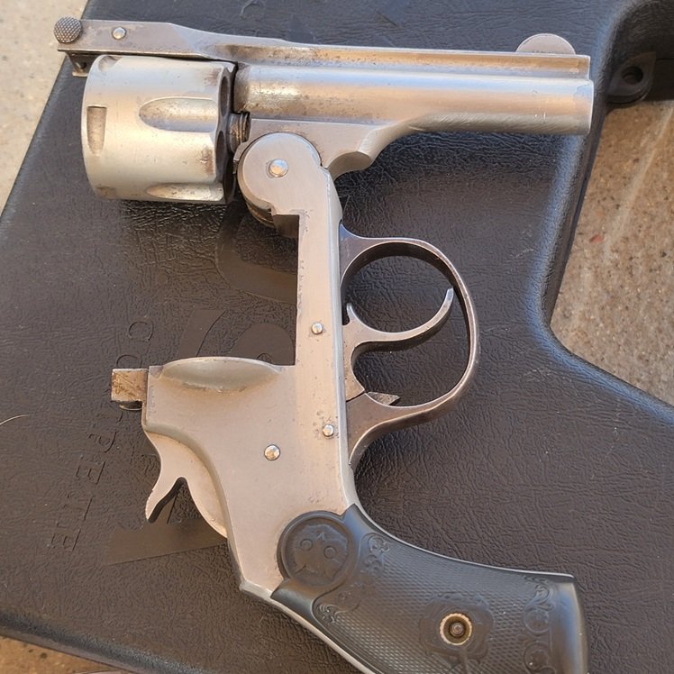

Dapper Dave Posted November 4 Posted November 4 Awright, I have done the dirty deed, committed the unspeakable sin...I used smokeless in a BP only revolver. BUT, only after the gunsmith who rebuilt them told me that he had already fired these guns with these loads. I did do some very reduced Bullseye loads in both this one and the solid frame H&R, and they worked. I don't think I will do it again, as I hate pushing things that have earned a right to NOT be pushed...but it can be done, and the loads were lighter recoil than some of the black powder ones I've done. As my buddy said, what do you think got fired in a lot of these guns when smokeless powder came out? That's why a lot of the old pocket pistols are loose, not from plain age, but being battered with smokeless ammo before anyone really cared about, ho, I don't know, not blowing their hands off? 4 Quote
Abilene Slim SASS 81783 Posted November 5 Posted November 5 That gunsmith is a moron. At a minimum that gun is being damaged further for no discernible reason. At worst, someone might be injured. Why take that chance just for the hell of it? 3 1 Quote
Dapper Dave Posted November 5 Posted November 5 I sincerely doubt he is a moron, you dont get where he is in life being stupid. The loads were mouse fart light, and he repaired that pictured revolver when it had been welded open for 50 or so years in a bar, rescued it among others. He handbuilt a bunch of interesting guns you've never seen before, and as I said, I used a few to prove the concept with loads lighter than my gallery loads. I also stated that I ain't gonna di it again, regardless of how safe or unsafe they are, as the guns weren't built for it. However, he is right in that while the United States was transitioning from black powder to smokeless powder, it is darn near 100% chance all of those surviving guns were fired at least once with smokeless loads, and not mousefart ones, either. Since I got the Victory Model, I can experiment with 38SW smokeless loads to my hearts content in a frame built to take it and then some. Quote
