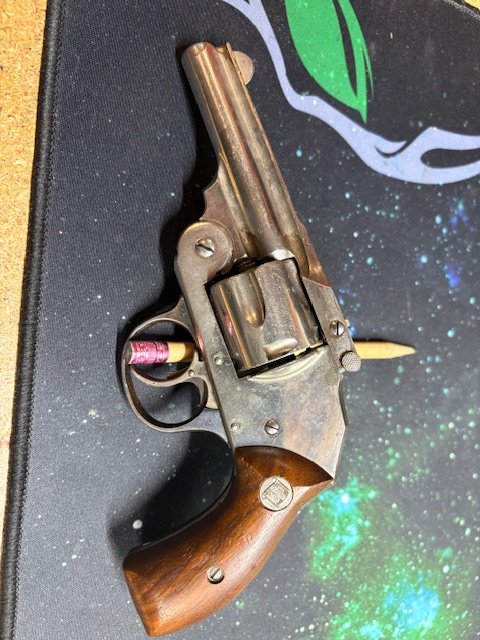

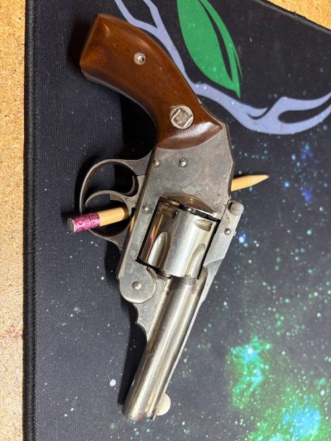

Jonathan Slim Chance Posted October 31, 2025 Posted October 31, 2025 I recently came into possession of an old pocket pistol and am looking for more information on it. It's an Iver Johnson Arms & Cycle Works Hammerless top break, Five shot .38 S&W. Other than the oddball Charter Arms grips, it's in decent enough shape, and it does function and fire. Any help on age, information would be greatly appreciated. Quote

El Sobrante Kid Posted October 31, 2025 Posted October 31, 2025 The two cross pins between the cylinder and the trigger tell you that it is a first or second model and not built to use smokeless loads. Quote

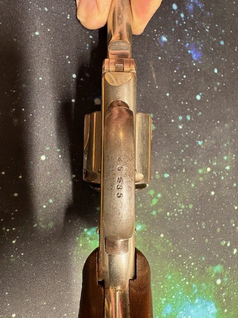

Garrison Joe, SASS #60708 Posted October 31, 2025 Posted October 31, 2025 7 hours ago, H. K. Uriah, SASS #74619 said: No one seems to have any of the factory records Not true. As I have posted here several times, the definitive reference to date and define an Iver Johnson pistol is the book by W E Goforth, Has a pretty complete serial number set in it. "Iver Johnson Arms & Cycle Works Firearms 1871-1993 " published by Gun Show Books of Hudson WI. ISBN-10 number is: 0-9787086-0-1 Like this listing on EBay from Gun Show Books themselves: https://www.ebay.com/itm/174200101382 But don't go pay THAT price! Usually pretty easy to find used at a lower price. I'll look up in my copy to see if the OP gave enough pictures to exactly identify the production year.. First thing right off the bat, it is a Black Powder era gun, due to the long cylinder locking slots (these are the easiest way to tell). I read the serial as 46495 (tell me if that is not correct). That could make it an 1894 Large Frame First Model. Or an 1895 Large Frame Second Model. To tell the difference between the two, I would need the exact wording roll stamped into the rib of the barrel. It will contain the company name and several patent dates (from the 1800s). Post up the roll mark and we can find out. Several other things are different between First and Second models, but spotting those differences involves looking at specific parts of the gun that a new owner may not really understand where to look. good luck, GJ Quote

Garrison Joe, SASS #60708 Posted November 1, 2025 Posted November 1, 2025 (edited) Serial number has been posted already. IJ put prefixes on the trigger guard number if the serial number had one....and it seems complete (not partially ground off). If the poster really wants more info, he should post a clear picture of the rib markings! good luck, GJ Edited November 1, 2025 by Garrison Joe, SASS #60708 Quote
Nostrum Damus SASS #110702 Posted November 2, 2025 Posted November 2, 2025 5 hours ago, Garrison Joe, SASS #60708 said: Serial number has been posted already. IJ put prefixes on the trigger guard number if the serial number had one....and it seems complete (not partially ground off). If the poster really wants more info, he should post a clear picture of the rib markings! good luck, GJ Respectfully disagree. Numbers on trigger guard, letter prefix ONLY on grip frame. But of course I could be wrong -- maybe IJ just forgot to put the B prefix on the trigger guard of my 1912 Iver Johnson .32 S&W Safety Automatic Hammerless Revolver, Third Model, 1st Variation, serial number B67506. 1 Quote
Rooster Ron Wayne Posted November 2, 2025 Posted November 2, 2025 Im not 100% positive. But I think it wearing Charter Arms grips . Rooster Quote

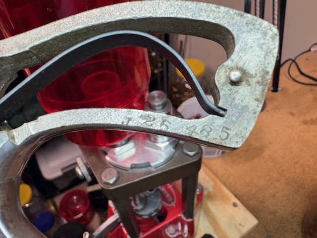

Jonathan Slim Chance Posted November 2, 2025 Author Posted November 2, 2025 OK, in answer to the questions: I read the serial number on the trigger guard as 26485. It appears to be hand stamped as the figures and depths appear to be irregular. The stamping on the grip frame look like J 26485, so the numbers agree, with the addition of the 'J' The top rib is marked "Iver Johnson Arms & Cycle Works, Fitchburg, Mass, USA". No other marks are in evidence. It is a leaf spring gun, as seen on the first grip frame picture attached. And yes, it is wearing Charter Arms grips, as included in the initial posting description ("...Other than the oddball Charter Arms grips..."). I'd like to find a set of correct grips, but at this point the CA grips are serviceable. Hope this information is helpful. Quote
Garrison Joe, SASS #60708 Posted November 2, 2025 Posted November 2, 2025 (edited) OK, with a J 26485 serial, that is a 2nd Model (Black Powder) Hammerless Large Frame IJ. Made in 1904. Per the Goforth listings. I stand corrected about the trigger guard serial number. Goforth does indeed say that the beginning Letter Mark (the production lot) is omitted from the trigger guard stamping, but included on the left side of frame. The bottom of the grip frame at one time would have had about 5 Patent dates on it, running from 1886 to 1896. But, if the grip frame was ground to match new grips (those Charter Arms), those rollmarks would be gone. Be very cautious of shooting any smokeless powder load, even "factory" 38 S&W cartridges. The top latch and the cylinder are both fairly weak. The usual damage occurs to the top latch, where it gets battered to where it does not make a strong lockup on the latch lock post coming up under the rear sight area. And avoid using Hoppe's bore solvent (or other cleaners with ammonia) on this gun, as the nickel plating on these guns is easily bubbled and flaked. Your plating looks just about 100% - NICE. Don't often see these in this nice a cosmetic condition. good luck, GJ Edited November 2, 2025 by Garrison Joe, SASS #60708 Quote

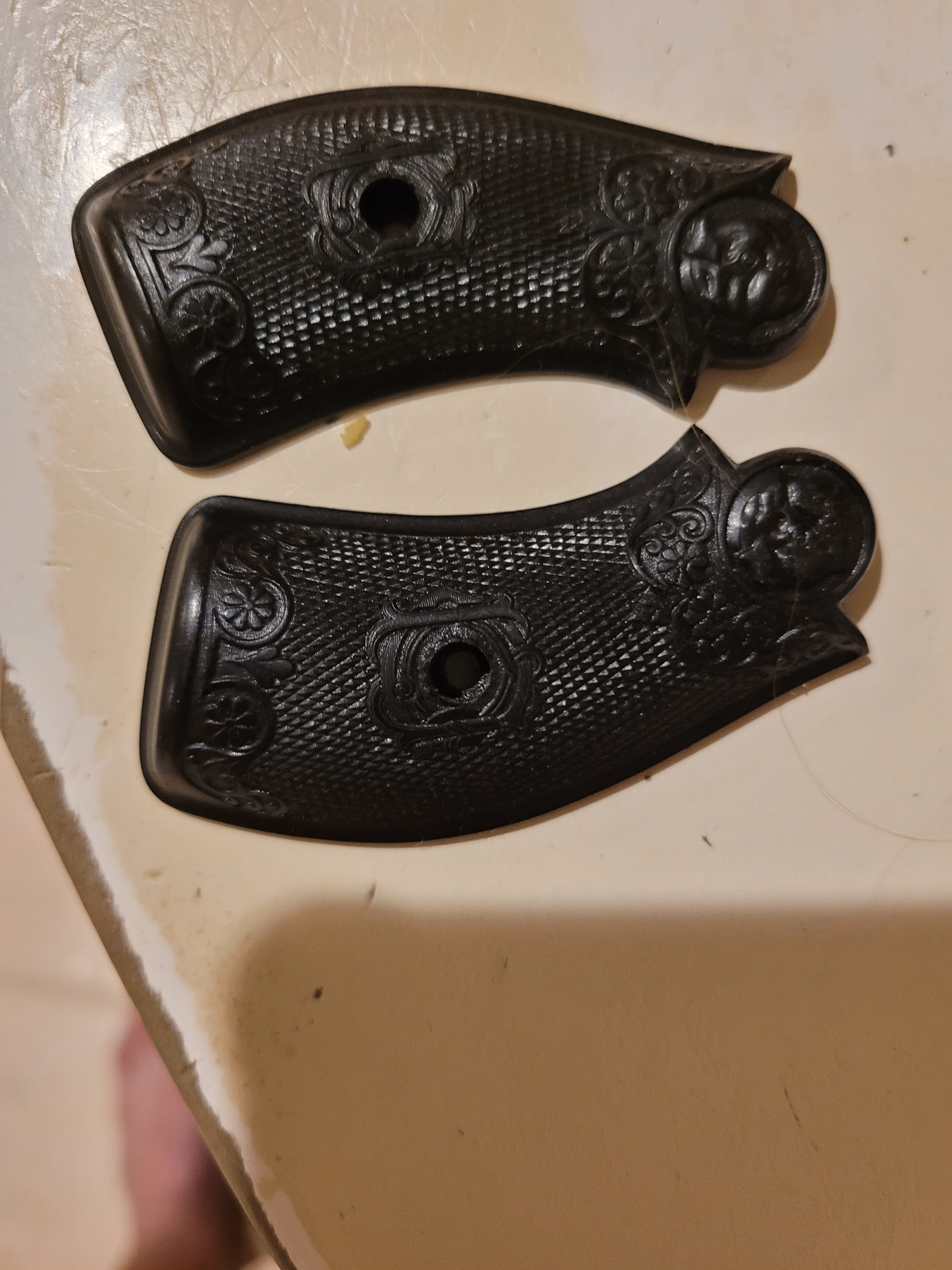

Rance - SASS # 54090 Posted November 4, 2025 Posted November 4, 2025 Hopefully not to confuse cowpokes?? But what pistol has the Owl head pictured on the grip.. Owl head pointing one direction designates black powder only.. Owl head pointing the other direction designates any powder.. I thought they were Iver Johnson.. I have one in 32 cal. Quote
Garrison Joe, SASS #60708 Posted November 4, 2025 Posted November 4, 2025 Owl heads are on the top break Iver Johnsons. Looking toward cylinder - black powder just about ready to explode in there. Better watch out! Away from cylinder - nothing to see, it's smokeless powder. No smoke, no flame, just a speedy slug. Owls not on this specimen because grips were replaced with a wood Charter Arms set of grips. The gutta percha composition of the IJ grips meant they were broken if dropped or used to club an opponent. Ouch. good luck, GJ 1 Quote

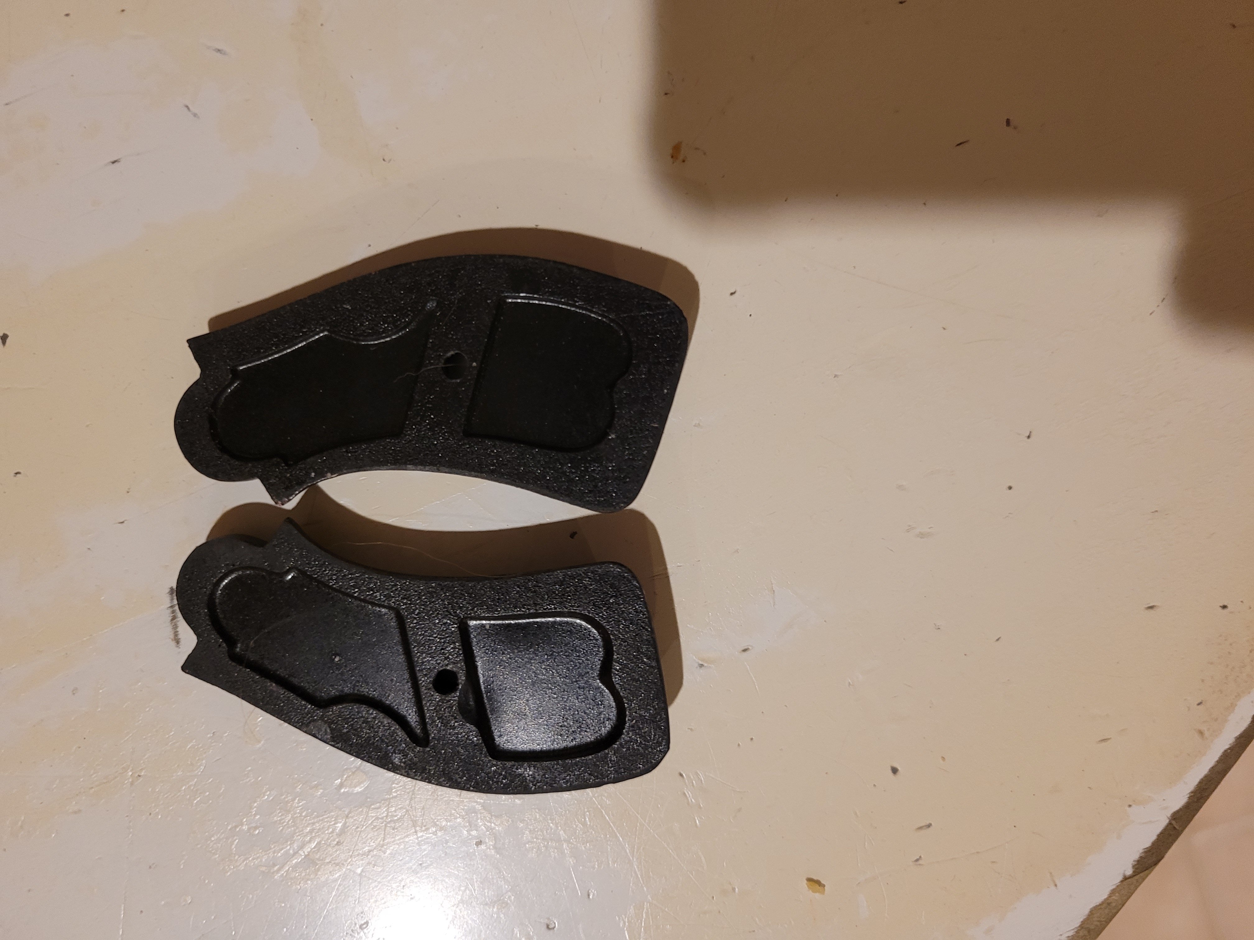

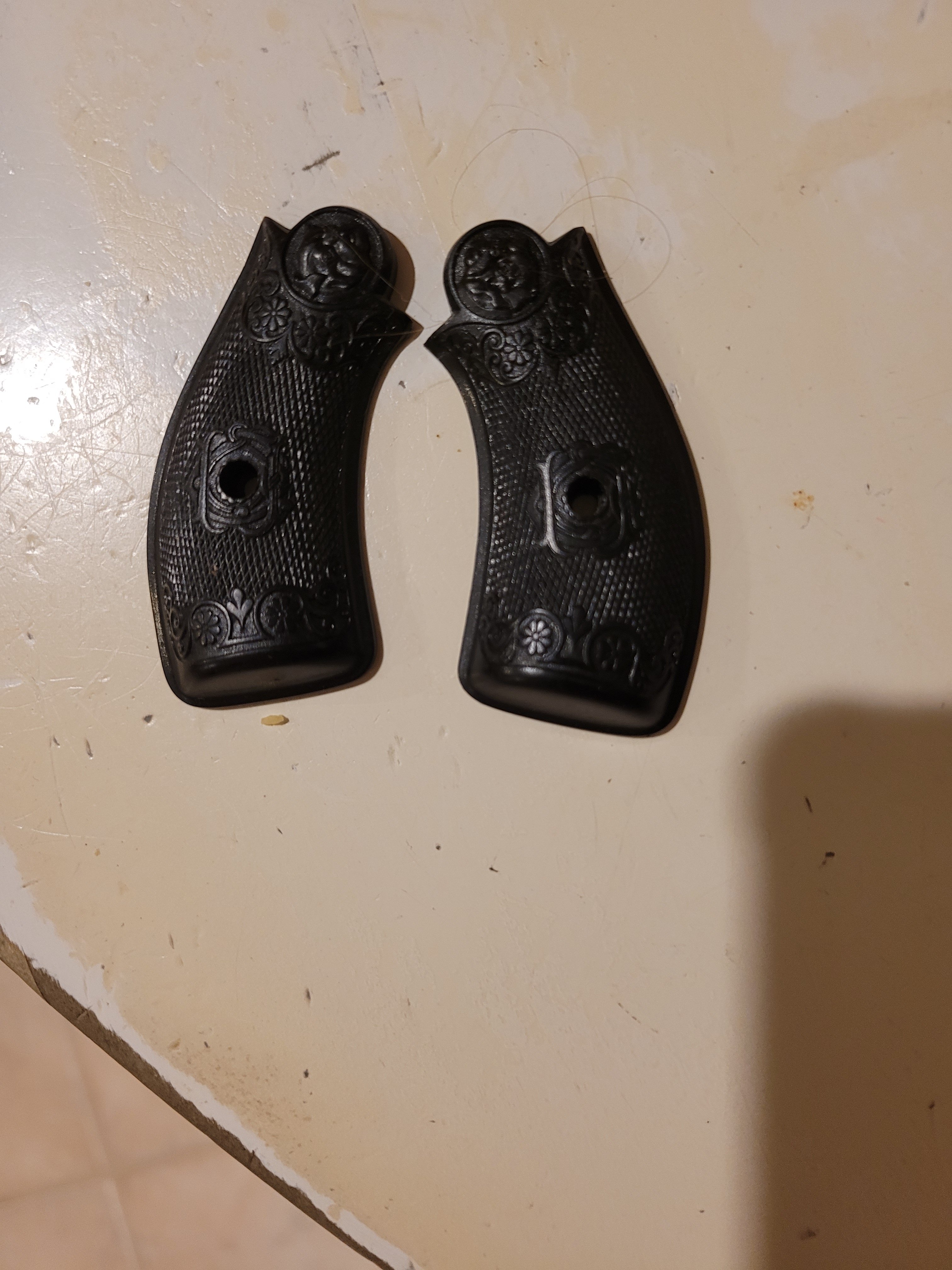

Joe LaFives #5481 Posted November 4, 2025 Posted November 4, 2025 I happen to have a pair of grips that you can have for shipping 1 Quote
Jonathan Slim Chance Posted November 4, 2025 Author Posted November 4, 2025 10 hours ago, Joe LaFives #5481 said: I happen to have a pair of grips that you can have for shipping That is a right fine offer, and I'd be a fool to not take it (and, other than what my wife says, I'm not normally a fool). I'll take 'em. PM to follow. 1 Quote
