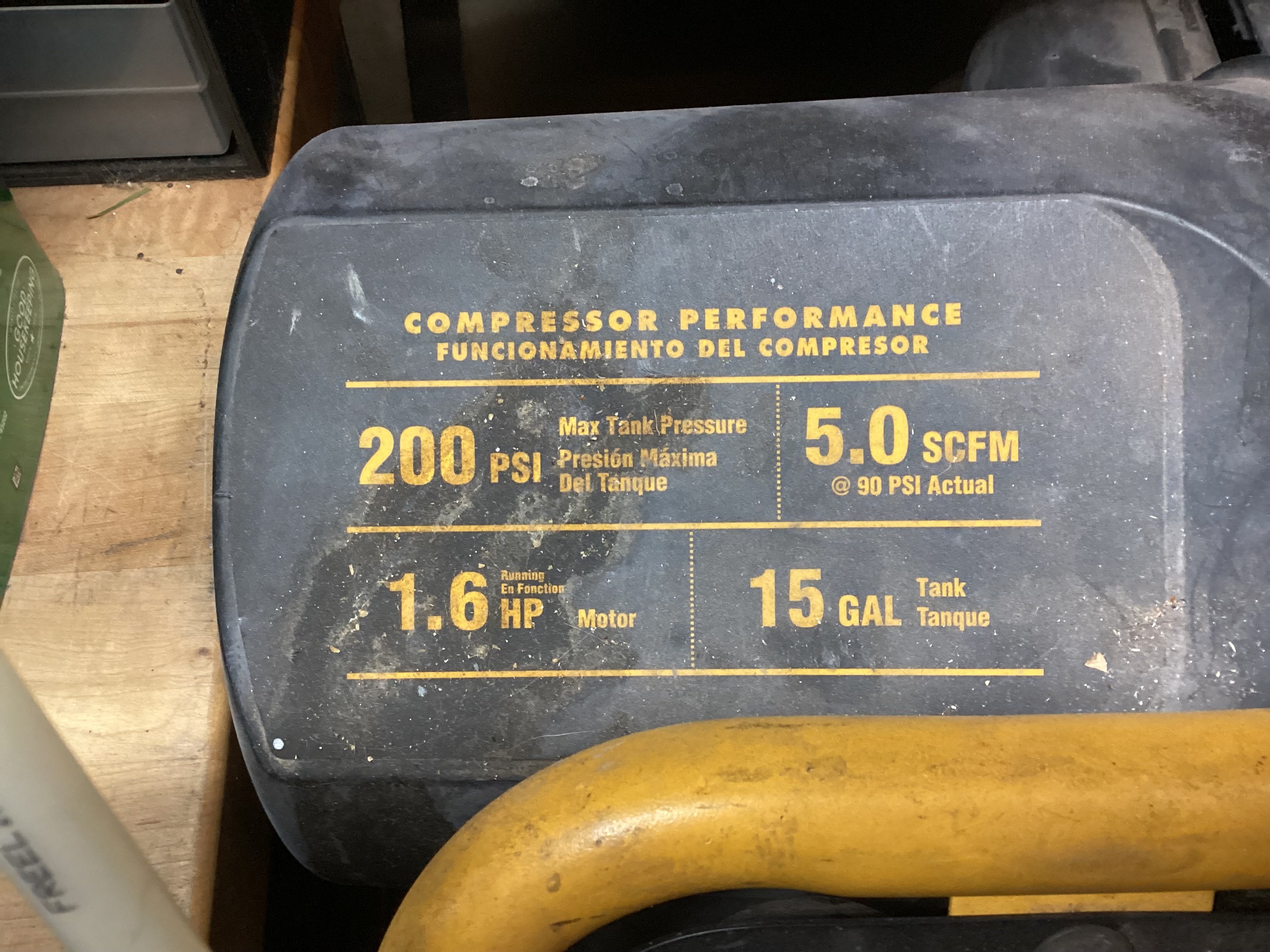

SHOOTIN FOX Posted October 30, 2025 Posted October 30, 2025 Dewalt shop air compressor. Diving compressor can go to 3500 psi. Quote
