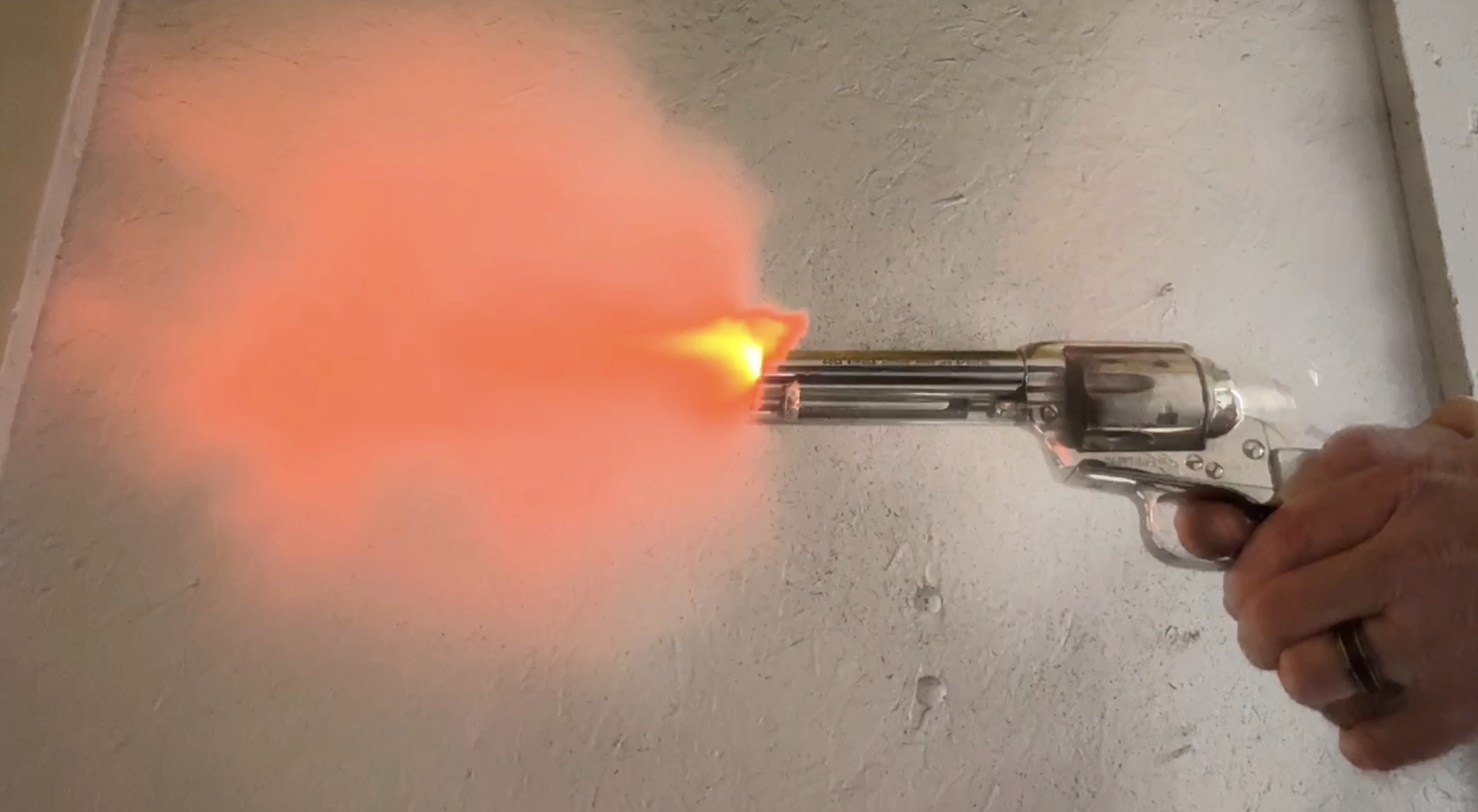

DukeSoprano Posted November 26 Author Posted November 26 Tried it today in .44 Special, It does have a tad more kick them my Trail Boss load! 1 Quote

Rooster Ron Wayne Posted November 28 Posted November 28 On 11/26/2025 at 6:08 PM, DukeSoprano said: Tried it today in .44 Special, It does have a tad more kick them my Trail Boss load! I dont believe that pic is from your loading of APP . APP smokes like mad but it dont make flames . Im a little confused with this pic ? 1 Quote

DukeSoprano Posted November 28 Author Posted November 28 2 hours ago, Rooster Ron Wayne said: I dont believe that pic is from your loading of APP . APP smokes like mad but it dont make flames . Im a little confused with this pic ? Yes it is APP 3F Quote

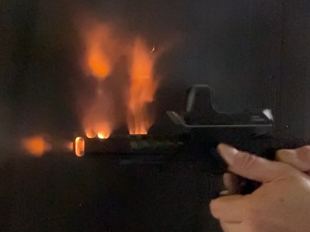

DukeSoprano Posted November 28 Author Posted November 28 You may not see flames, but if you record shots and play them back at 1% Speed, you actually see what more than the naked eye can. Here is a pic of one of my USPSA Open guns shooting 38 Super Comp, I do not see flames when I am shooting it. Quote
