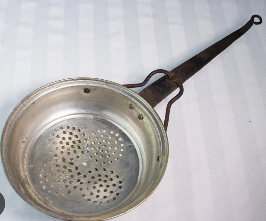

Texas Joker Posted October 21 Posted October 21 Takes a copper "hat" that's been pierced like a zester. It's more involved than this but you put coals on rim of the hat and pour molten lead into the hat. It drips through the pierced dimples and falls . The farther it falls before landing in a cooling pool the more uniform the shot. Then ther is cold rolling as described above. Also casting for various Buckshot sizes. 1 Quote

SHOOTIN FOX Posted October 22 Posted October 22 I made literally tons of shot while I was making it for SASS shooters. The combination of alloy, temperature, drop height, coolant temperature and consistency all factor into the success of the operation. Not an exact science, but definitely critical steps to consistent shot. Only had 1 complaint over 15 years and that was too much powder in The bottom of the jug, (graphite). Fix 3 Quote
