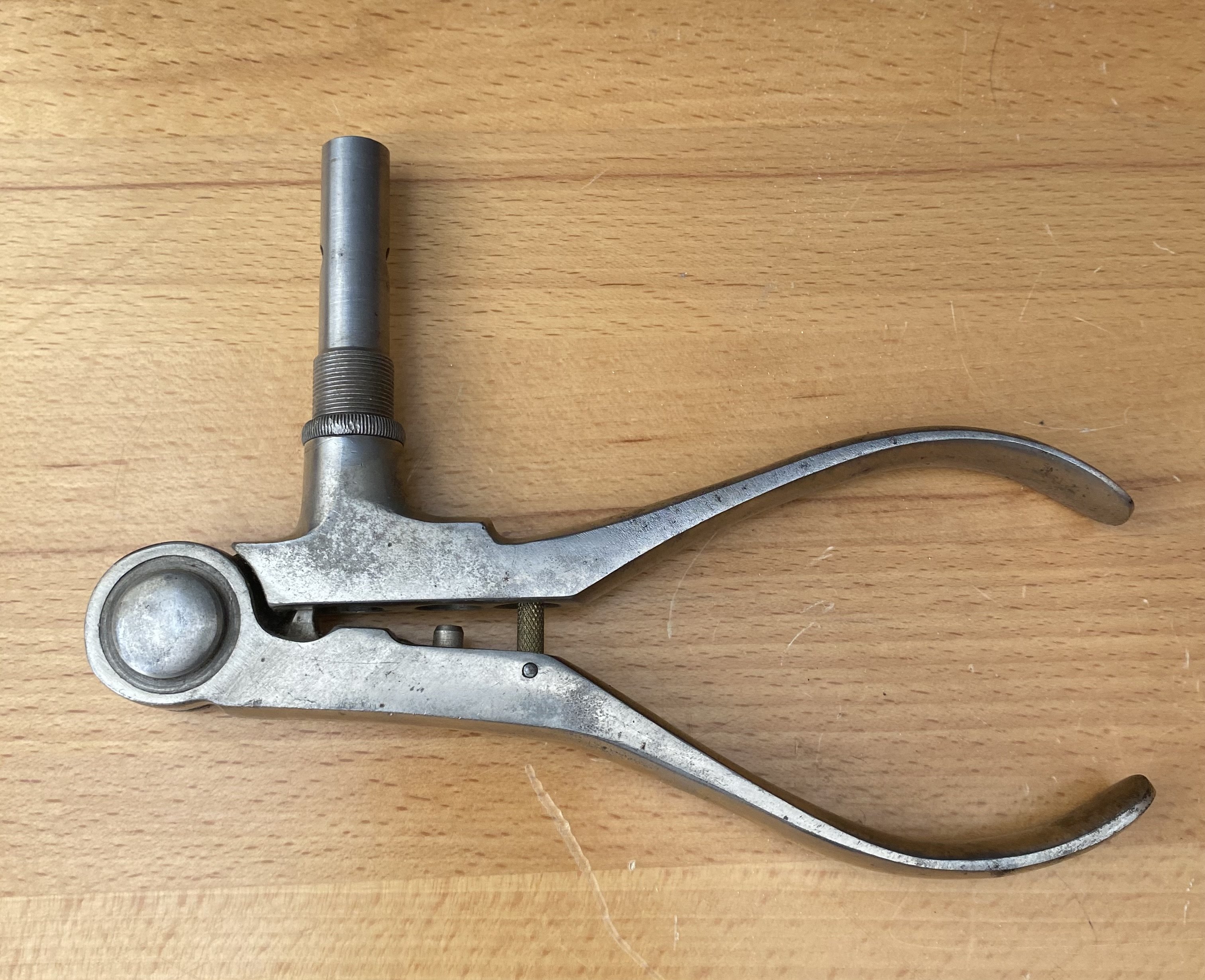

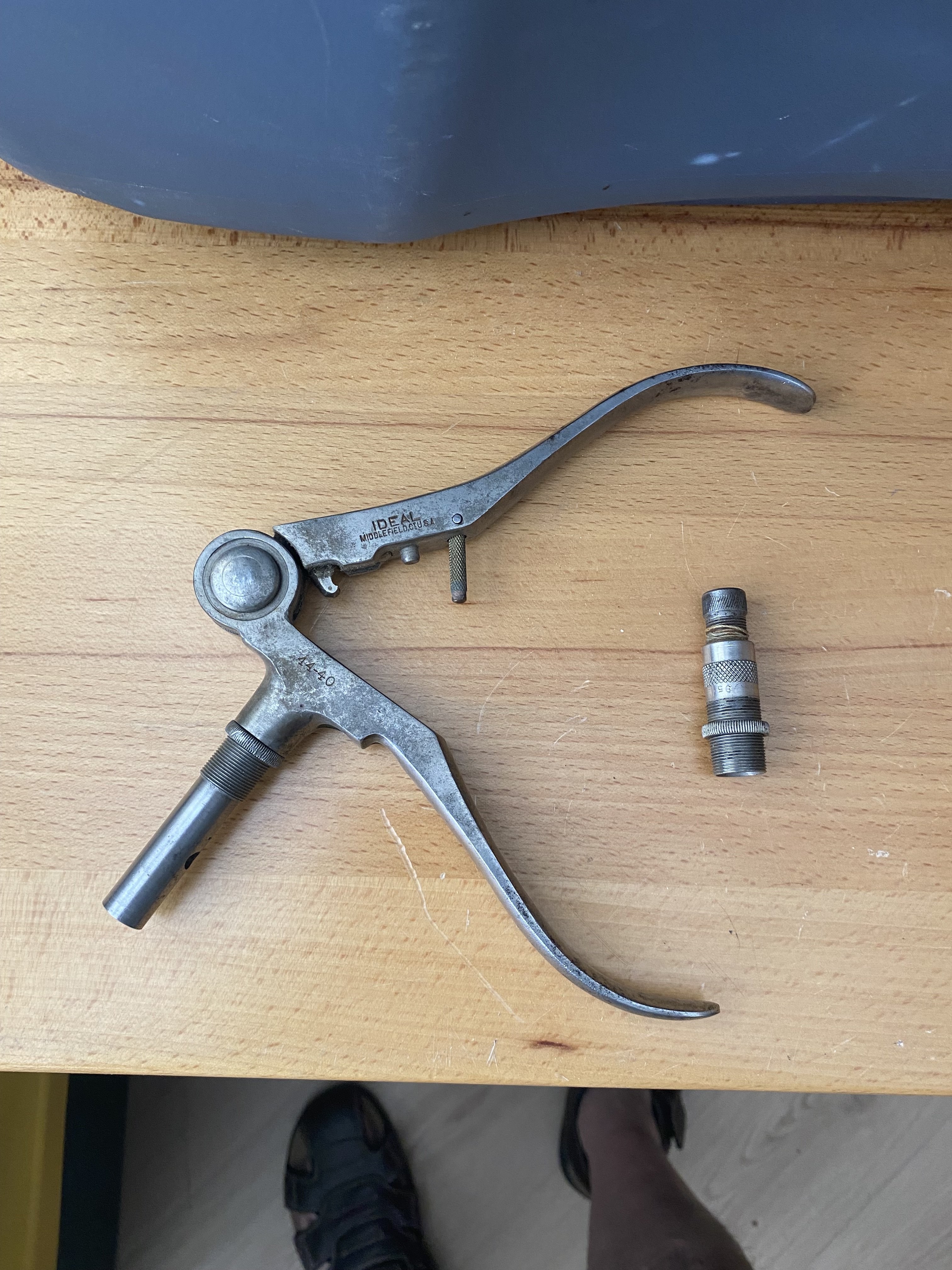

Mezcal Charlie Posted October 19, 2025 Posted October 19, 2025 Is anyone using an Ideal hand loader for reloading black powder? I picked this up thinking about getting in touch with my inner cowboy but it’s hand intensive and hard on the arthritis. Still, it’s a genius piece of engineering. Quote

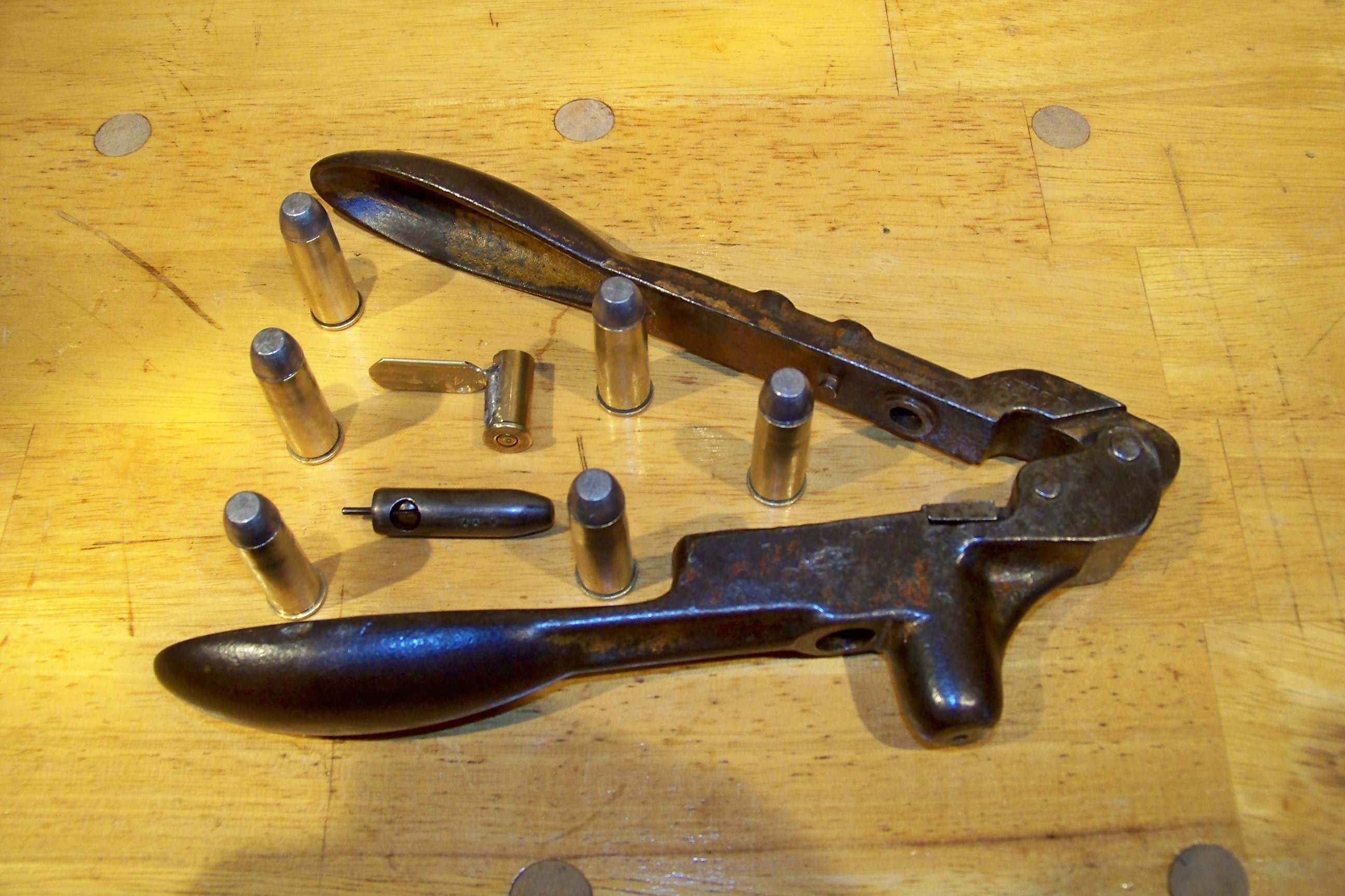

Injun Ryder, SASS #36201L Posted October 19, 2025 Posted October 19, 2025 I have used this Winchester reloading tool for 44-40 but only for "test" purposes. 2 Quote
Edward R S Canby, SASS#59971 Posted October 19, 2025 Posted October 19, 2025 My late father gave me a similar one made by Lyman. It works but even slower than a single stage press. Lack for full-length resizing limits its usefulness. Arthritis prevents me from ever using it again. 1 Quote

Laramie Posted October 19, 2025 Posted October 19, 2025 When I was a kid that’s what my dad reloaded everything on. He had 25/20, 32/20, and 7mm Mauser dies. If I remember, there were two sizes of the tool itself. Depending on case diameter. I probably should still have them somewhere. Laramie 3 Quote

Vail Vigilante Posted October 20, 2025 Posted October 20, 2025 Use a modern tool. If the old cowboys that used those pliers style tools were alive today they would probably tell you the same thing. 3 1 Quote
watab kid Posted October 21, 2025 Posted October 21, 2025 i gotta agree with VV here , those were a PITA to use 1 Quote

Mezcal Charlie Posted October 26, 2025 Author Posted October 26, 2025 On 10/19/2025 at 9:42 AM, Injun Ryder, SASS #36201L said: I have used this Winchester reloading tool for 44-40 but only for "test" purposes. Very cool. The winchesters are rare and very valuable. I’m going to make a point to load a few just for the experience and then take along for the ideal of not running out on the trail😉 Quote

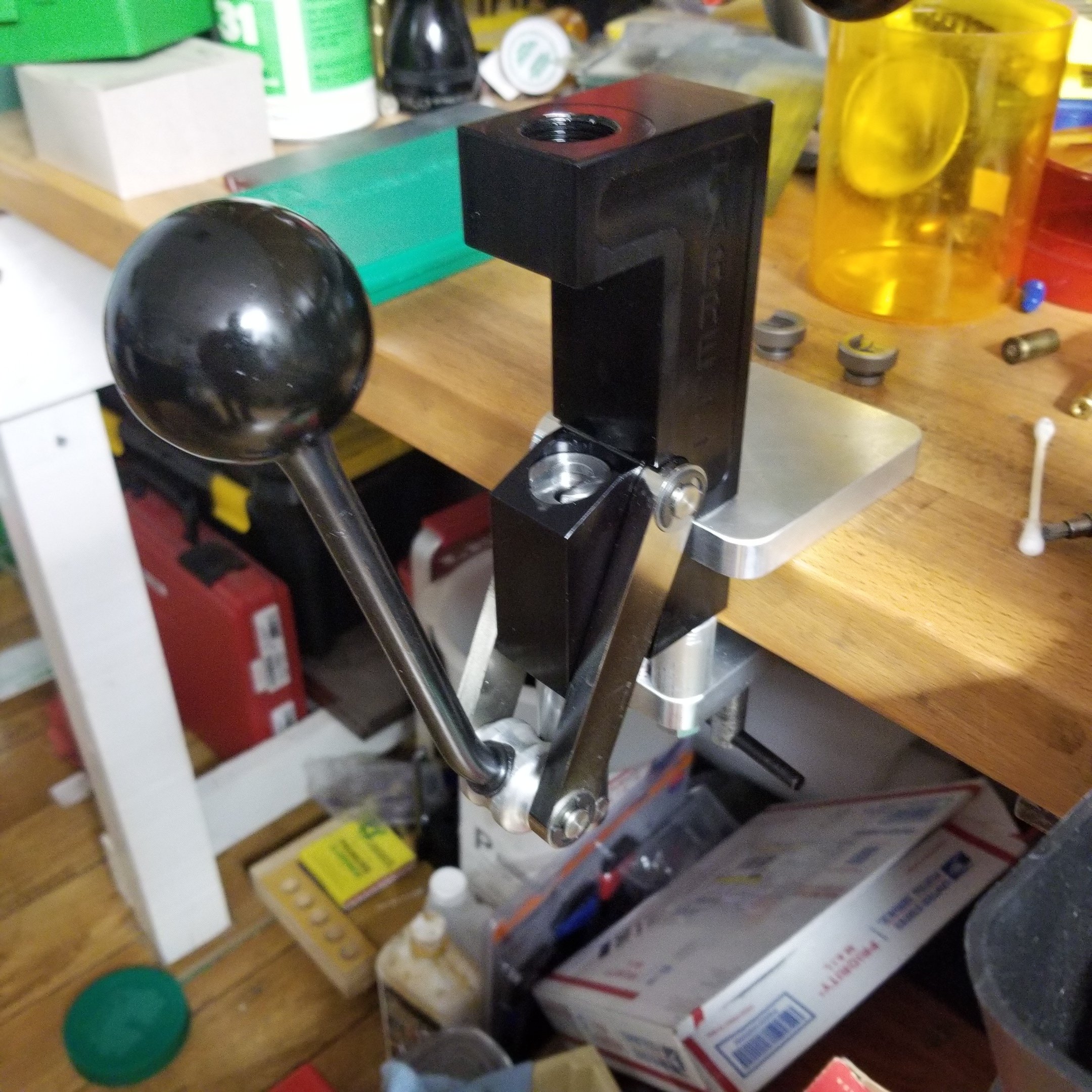

"Big Boston" Posted November 1, 2025 Posted November 1, 2025 I've never loaded any volume of ammo with these tools, but I have reloaded quite a few calibers with them. It's more of a hobby or interest or addiction. Until you actually load with them that you realize how involved it can get. I have a set of dies and the last gen of tong tool. The issue is that the 310 tool was a neck size tool, and with 44-40, the body has to be dealt with as well, if you shoot multiple guns (chambers). I ended up sizing the body in a 30-06 sizer, the hammer in style from Lyman. I had an idea to put together a complete reloading set that was light and somewhat portable. I lost interest in the venture, but I did come up with a practicable solution. To make the concept useable, I bought a small Harrell press, and decided to use 7/8 carbide dies to size and use the tong tool to do the rest. The plan was to use a Harbor Freight Gerstner knockoff tool box and just assemble the tools I needed. They are a historic tool, but if you have a pair and spare 550 setup, it's real hard to get excited about loading ammo with them. Practical 310 tool use for the 44 WCF.pdf BB 1 Quote
