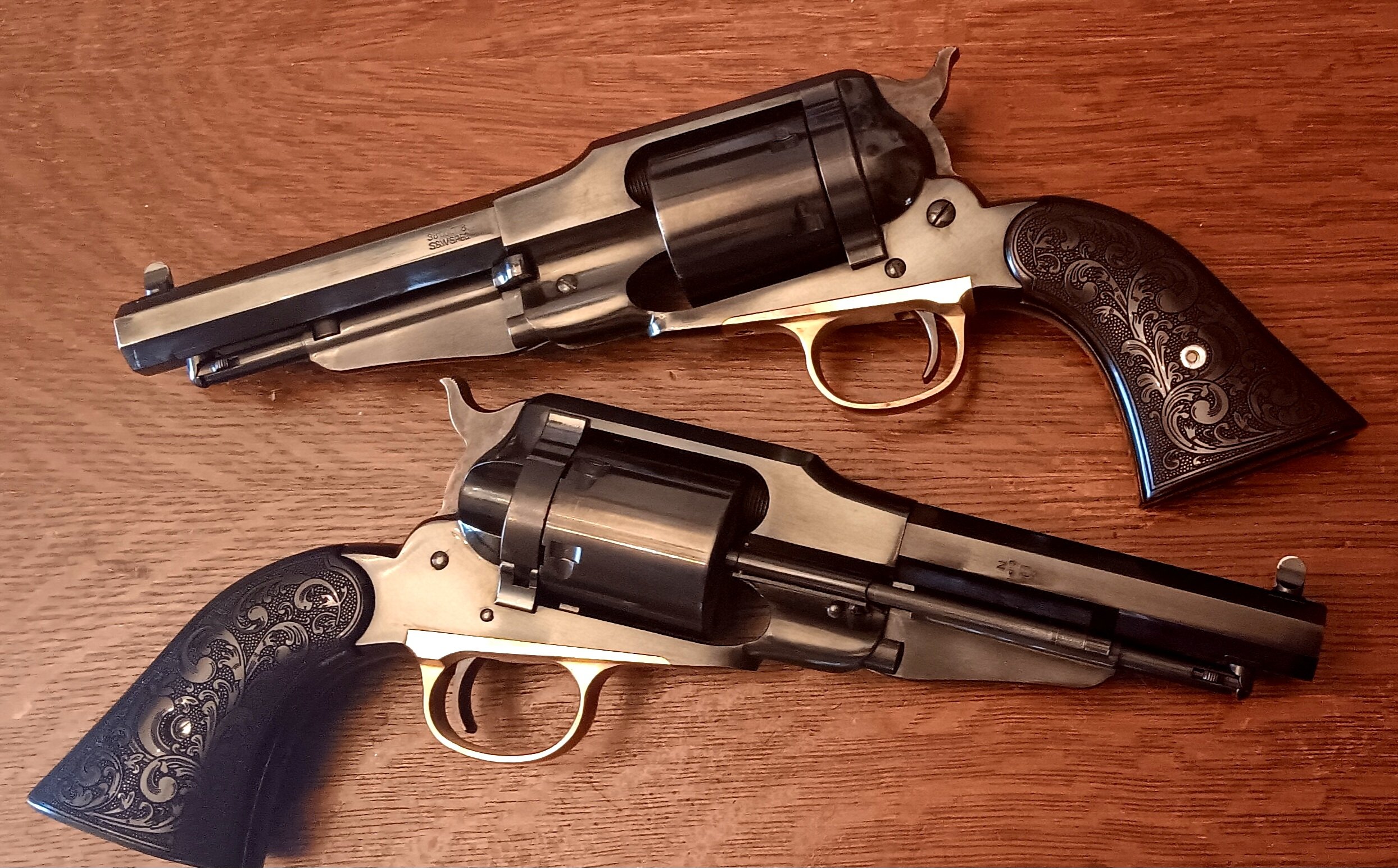

Abilene, SASS # 27489 Posted October 17, 2025 Posted October 17, 2025 (edited) I have a pair in 5 1/2" and I like them a lot. Shot 4 clean matches in a row earlier this year with them. These .38's are very heavy even with the short barrels. The ejector is fiddly to use but works. I put Arizona Custom grips on them that are thinner and grippier than stock. edit to add: I have a variety of holsters and these only fit about half of them, due to the "sail" under the barrel. Edited October 17, 2025 by Abilene, SASS # 27489 6 1 Quote
