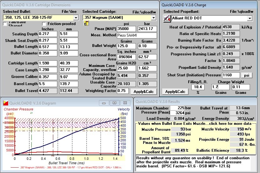

El Chapo Posted October 15, 2025 Posted October 15, 2025 I can run it through Quickload if you tell me what bullet it is and barrel length. I have a feeling it's going to be below 3 grains, maybe more below that than any of us would be comfortable loading. Quickload is an incredible piece of software. If you really want it to be precise, measure the water capacity of your sized cases and it can be fine-tuned from there. Quote
Nostrum Damus SASS #110702 Posted October 15, 2025 Author Posted October 15, 2025 1 hour ago, El Chapo said: I can run it through Quickload if you tell me what bullet it is and barrel length. I have a feeling it's going to be below 3 grains, maybe more below that than any of us would be comfortable loading. Quickload is an incredible piece of software. If you really want it to be precise, measure the water capacity of your sized cases and it can be fine-tuned from there. Thanks, I'll get in touch if I want to try that. Quote
Blackwater 53393 Posted October 15, 2025 Posted October 15, 2025 2 hours ago, El Chapo said: I can run it through Quickload if you tell me what bullet it is and barrel length. I have a feeling it's going to be below 3 grains, maybe more below that than any of us would be comfortable loading. Quickload is an incredible piece of software. If you really want it to be precise, measure the water capacity of your sized cases and it can be fine-tuned from there. I’d like to take you up on that offer! If I send you the information by PM, can you run a couple of loads for me? Quote
El Chapo Posted October 15, 2025 Posted October 15, 2025 (edited) 1 hour ago, Blackwater 53393 said: I’d like to take you up on that offer! If I send you the information by PM, can you run a couple of loads for me? sure, send me what you can and I'll try to get it done before I get on the road to Bordertown. I'd be curious to see how it compares to real-world chrono data. Make sure you send me as much information about your bullet as you can, and a COAL, cartridge, powder charge, and what barrel length you want me to test. Edited October 15, 2025 by El Chapo 1 Quote

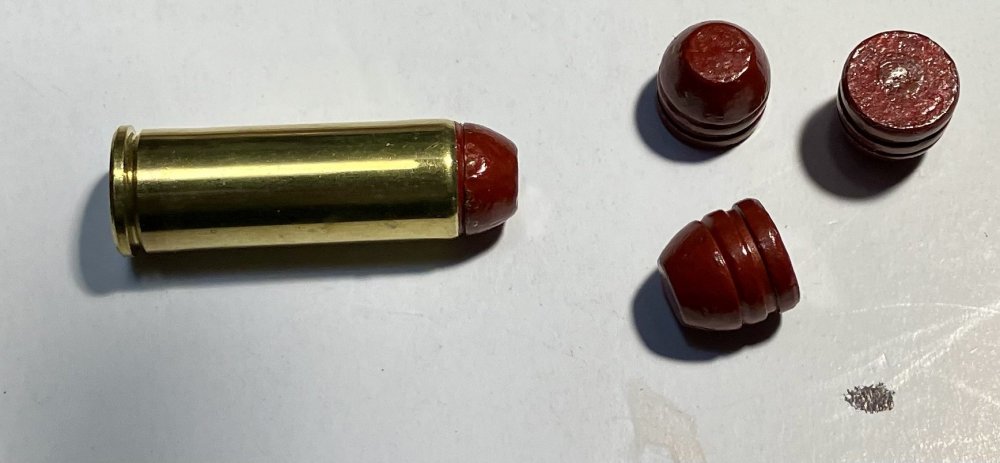

Blackwater 53393 Posted October 16, 2025 Posted October 16, 2025 (edited) El Chapo! PM sent! Can’t get any photos onto the PM, so here’s what it looks like. If this and the measurements I gave you will help, maybe we can get close… Edited October 16, 2025 by Blackwater 53393 Quote

El Chapo Posted October 17, 2025 Posted October 17, 2025 (edited) To answer the original question: According to Quickload, in a .357 Magnum case with a 125 grain Lee RNFP, 1.7 grains of Red Dot will make 493 fps out of a 5.5" barrel for a power factor of 61, assuming a COAL of 1.590". I would not attempt this, pressure is 3,264 PSI. But that's the answer to the question you asked. Edited October 17, 2025 by El Chapo 1 1 Quote

Sedalia Dave Posted October 17, 2025 Posted October 17, 2025 2 hours ago, El Chapo said: To answer the original question: According to Quickload, in a .357 Magnum case with a 125 grain Lee RNFP, 1.7 grains of Red Dot will make 493 fps out of a 5.5" barrel for a power factor of 61, assuming a COAL of 1.590". I would not attempt this, pressure is 3,264 PSI. But that's the answer to the question you asked. Does that take calculation take into account cylinder gap? Quote
El Chapo Posted October 17, 2025 Posted October 17, 2025 2 hours ago, Sedalia Dave said: Does that take calculation take into account cylinder gap? You'd have to ask the guy who programmed the software that question. That person is not me. 1 Quote
Still hand Bill Posted October 17, 2025 Posted October 17, 2025 9 hours ago, Sedalia Dave said: Does that take calculation take into account cylinder gap? Probably not. I have not tried QL with pistol cartridges, just rifle. For subsonic rifle loads it does not work well. It overestimates velocity by quite a bit. Seems drag from the bullet to barrel is not accounted for correctly at slower speeds and low pressures. It may work fine for pistol loads, but it does not for slow rifle loads. 1 1 Quote
Blackwater 53393 Posted October 17, 2025 Posted October 17, 2025 (edited) Thanks to El Chapo for his help! That program is news to me! I’ll be getting a copy of it soon. The info he shared with me was reassuring. Edited October 17, 2025 by Blackwater 53393 Quote

Blackwater 53393 Posted October 24, 2025 Posted October 24, 2025 I got the opportunity to test fire the loads that I discussed with El Chapo and found that they worked very near to the predicted outcome. I was unable to chronograph them, but they looked, felt, and sounded very much like other examples that I have test data on. They shot to point of aim and there was no evidence that they might be unreliable. I’m planning to get the QL program in the near future. 1 Quote
