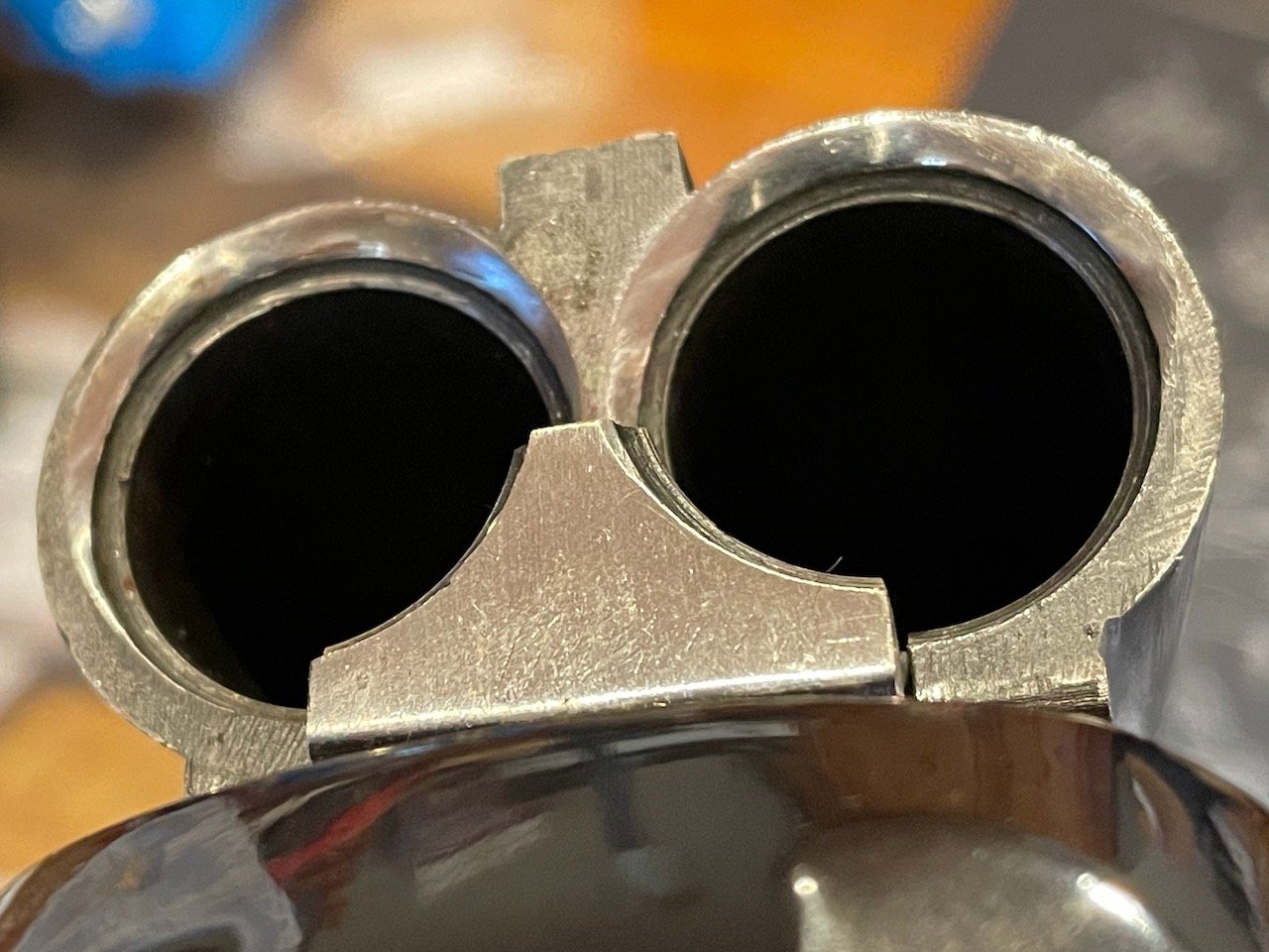

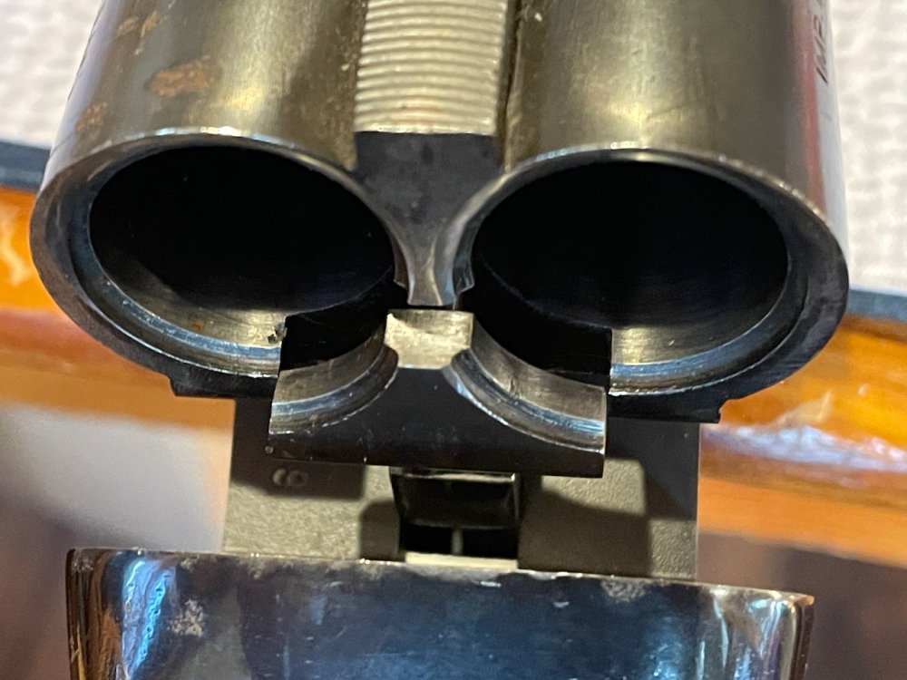

John Kloehr Posted October 15, 2025 Posted October 15, 2025 Finally remembered to get some pics while I was by my safe. Workmanship is not mine but from what I understand this is reasonably right. Just the top edges beveled. the step on the bottom half and the extractor is untouched (well, I do see now one got knicked. I suspect Dremel. And looking even closer now that I have big pics, I think I could go a bit further and take out some of the step in the top half. Even as it is, it helps. 1 Quote
