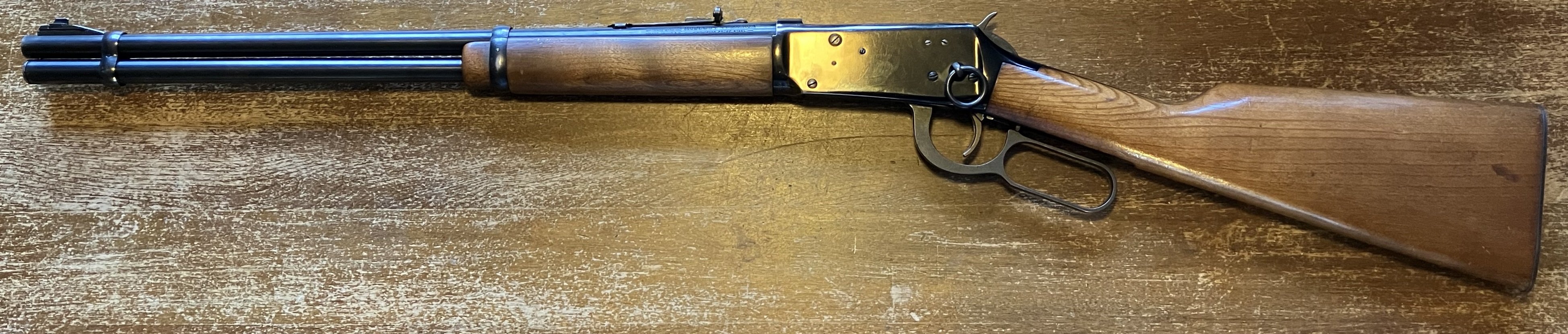

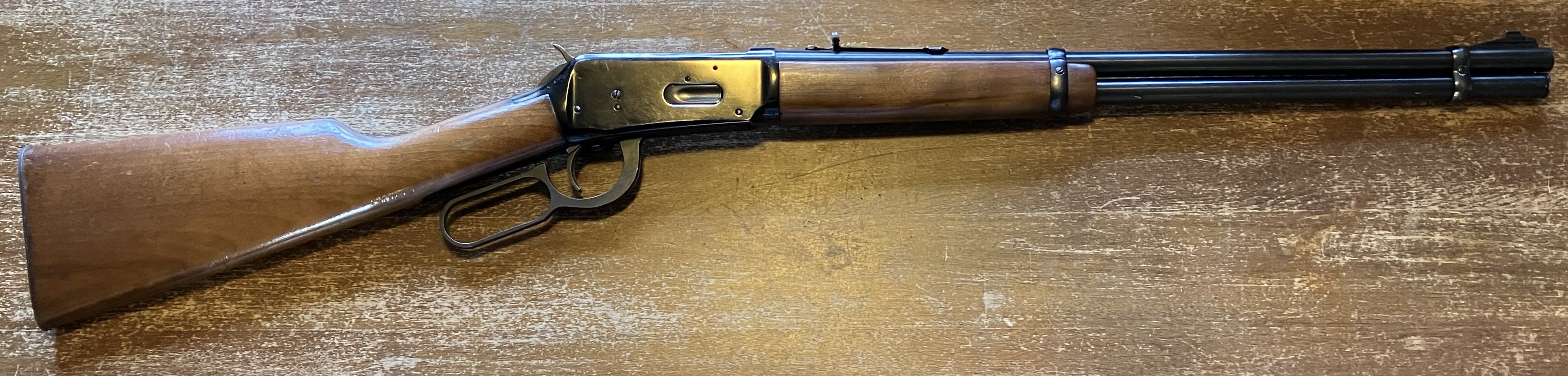

Stopsign32v Posted October 14, 2025 Author Posted October 14, 2025 14 minutes ago, H. K. Uriah, SASS #74619 said: My .44 Magnum 94. You needing to move that thing on? 😉 1 Quote
H. K. Uriah, SASS #74619 Posted October 14, 2025 Posted October 14, 2025 8 hours ago, Stopsign32v said: You needing to move that thing on? 😉 Heh heh. No. It was hard enough to FIND it. To lose it would be a tragedy. Quote

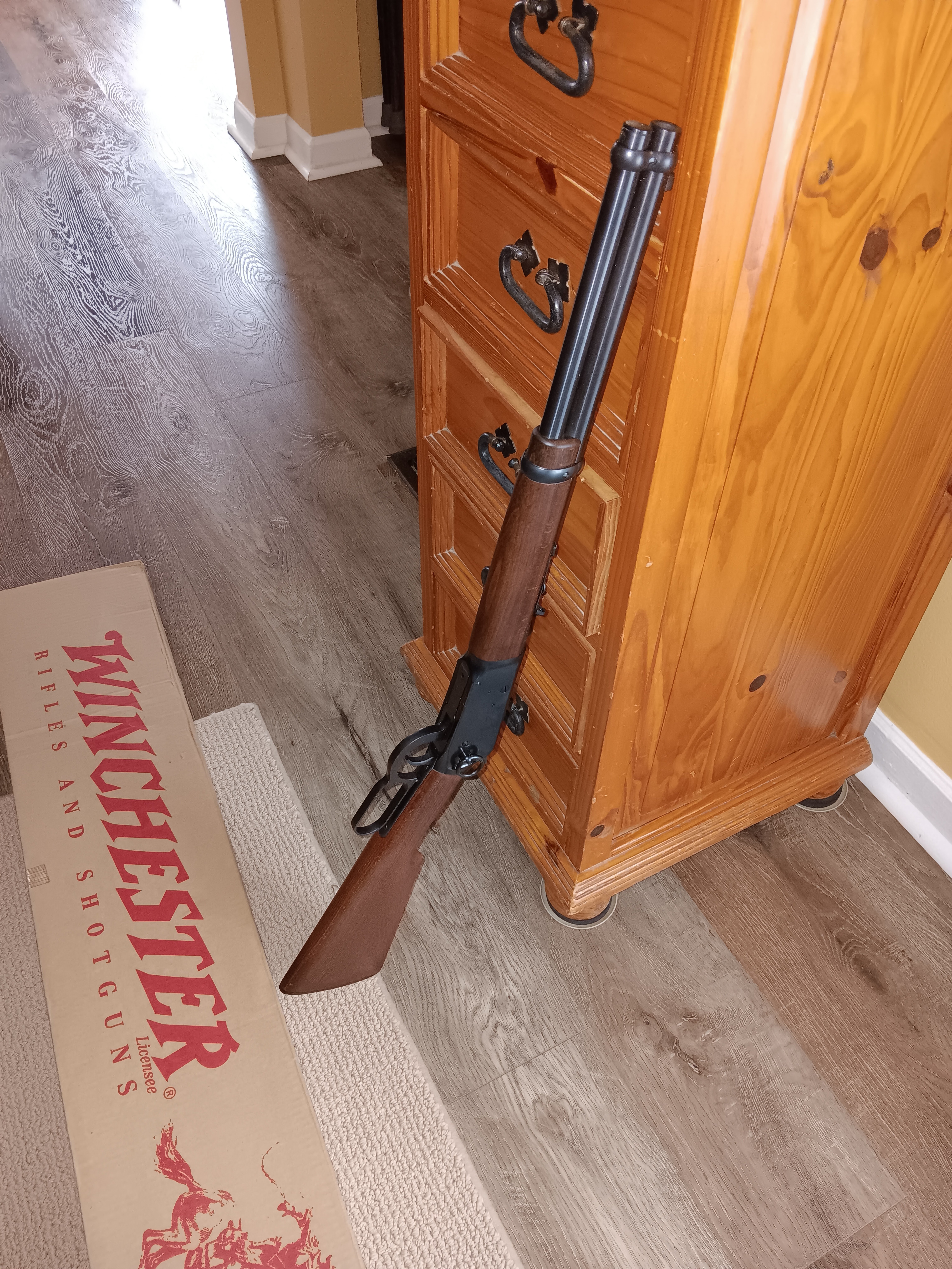

Rooster Ron Wayne Posted October 14, 2025 Posted October 14, 2025 I bought a New in the box un-fired 94 44 mag this year . Its a Trapper Model. Love it ! Quote
